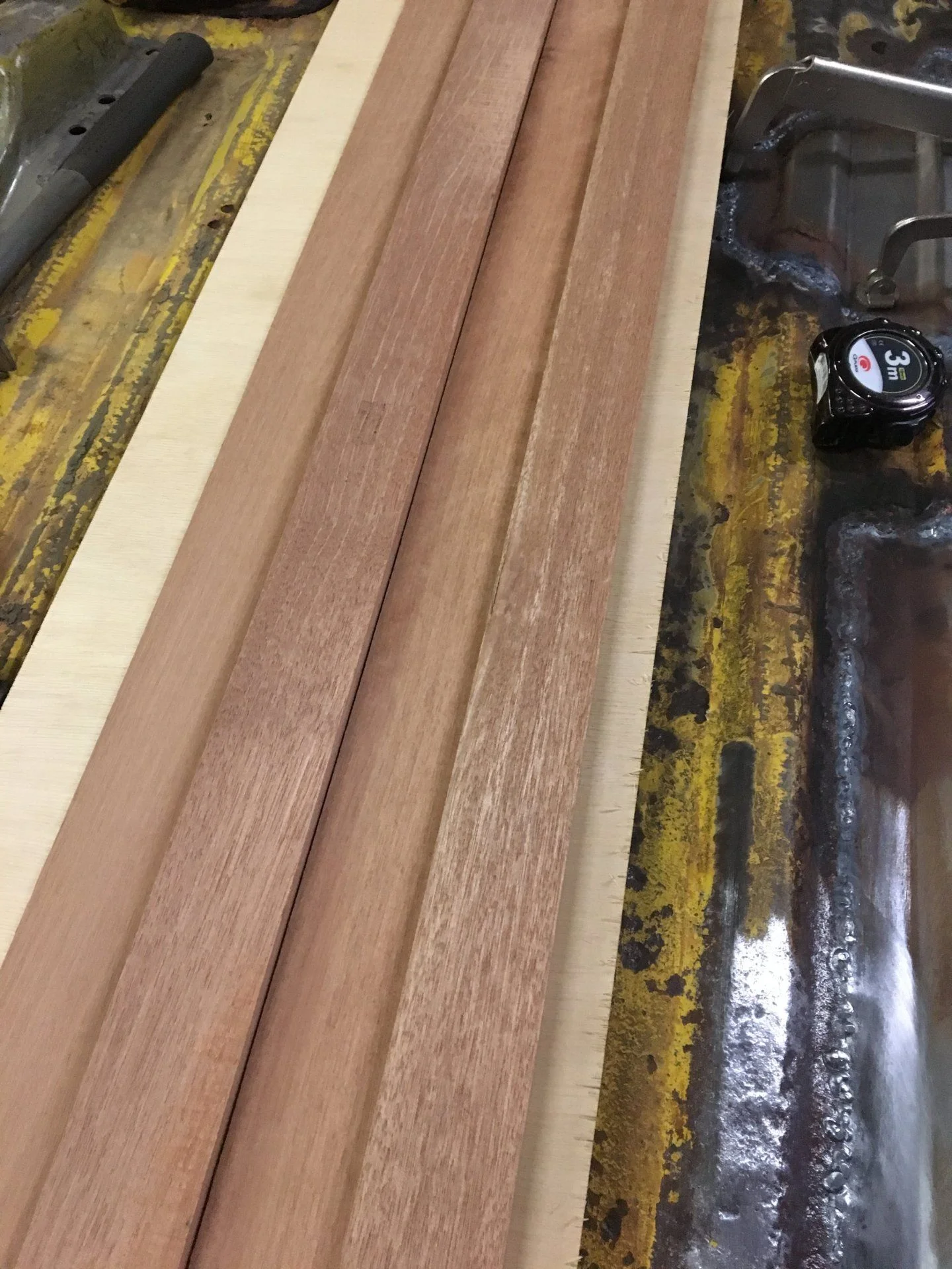

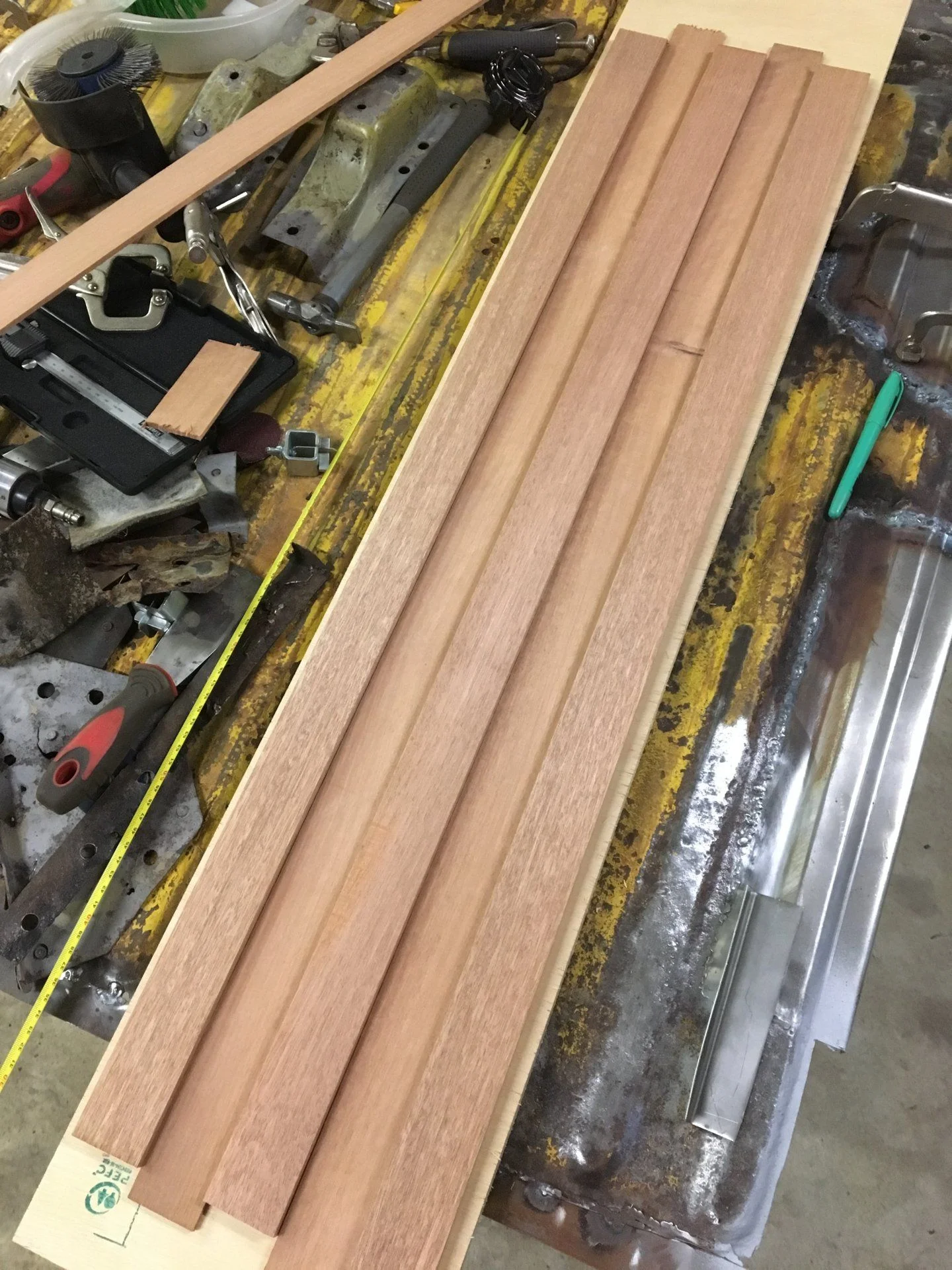

Got some wood to create a template for the ribs.
View attachment 1593726 View attachment 1593727
I’ve had a bottom plate cut and got some strips of hard wood.
The lower one's are still to wide and the higher one's need to be shaped in the negative of the ribs.
I want to try to make the entire panel at once.

I will just try to get the shape in like this, if it doesn’t work I will go for plan B or C. Both involve buying tools.:doh:
I’m using standard hardwood and a plywood base.
The wood will be shaped to the ribs, not sure yet how to hammer the shape in, thinking of making a wooden hammer shape to slowly drive the steel into the template. After the first rib is made the first track works as a guide for the second one to be hammered in.
I just hope the wood is strong enough to last the entire panel.
Going to make a test piece first to see how much extra steel is needed for the ribs.
