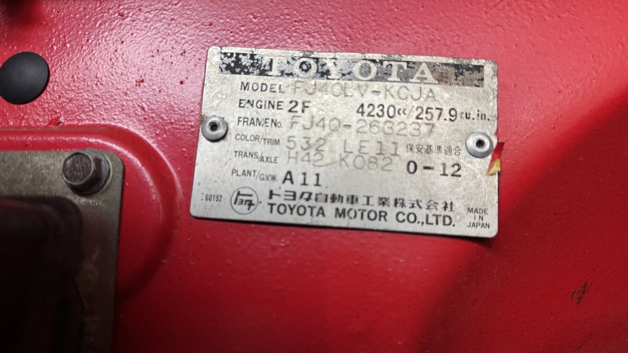

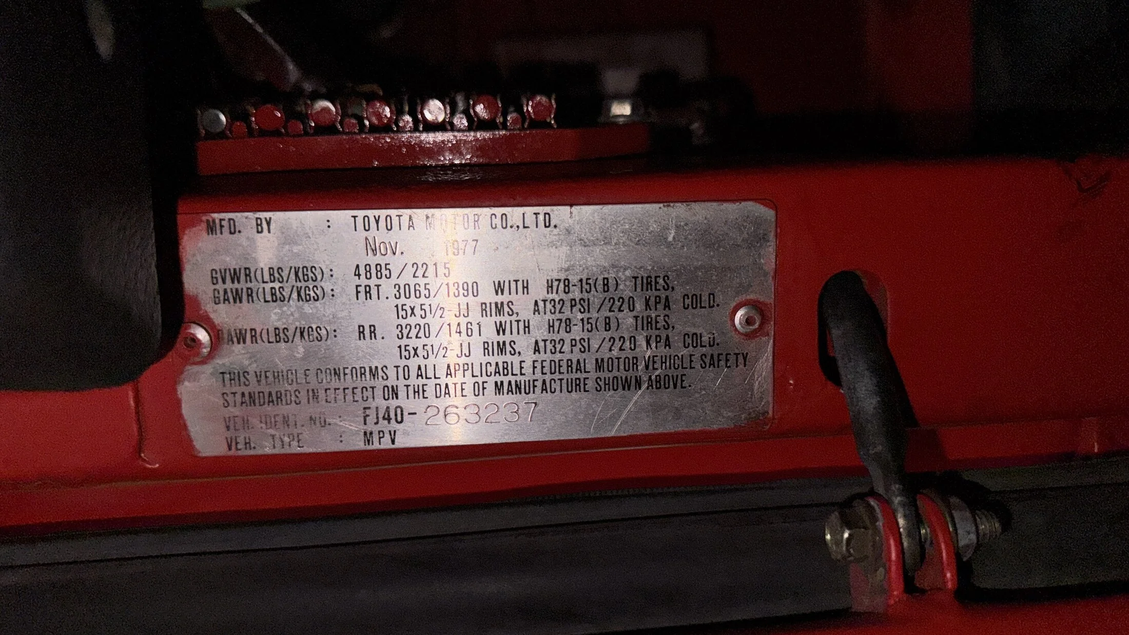

The frame number being covered up might be why it was sold to a SC dealership.
NCDMV will have their guy go out and check the frame number and all the other data plates before issuing a tittle/registration for an out of state vehicle. Not sure if they do this for an in state vehicle purchase.
Might be worth while to see what you have under that non original bedliner on the frame.
Yeah I may sand off the paint and see whats underneath this weekend. Will keep y'all posted.

The vin goes with the frame
If I used my frame (1974 fj40) and stuck a 1984 Fj40 LX body on it … it would still be considered a 74’ as the frame is stamped and that is a 74’
¨It’s odd they’d reattach the old tags onto the frame (or maybe not?)¨
they removed the tags from the 78' and attached them to the 71' body
the frame is stamped .... not a tag... since they cant change that unless they cut out the section or grind and re-stamp (illegal) it stays a 78´
Heres where it is stamped:
Pic from Sor.com
Confirmed the frame matches the VIN and tag. Leads me to believe the running gear and frame are original but the body is a ‘71.

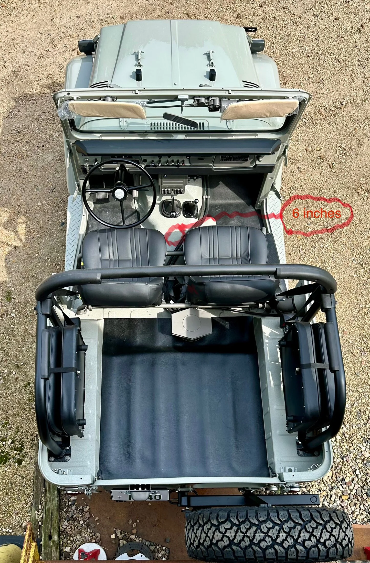

This is a good kit for mounting buckets in the older models
I did some research on this but wondered if he still made them. The post started almost 15 years ago. Seems like the most straightforward option. Crazy that no one has really made a bolt on conversion for <‘72 bodies.
