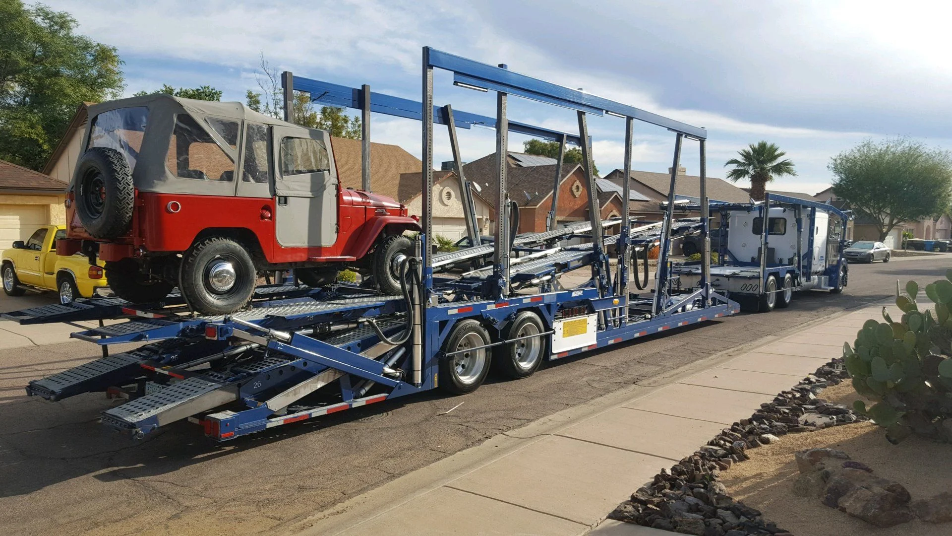

I'm in Virginia, he and the truck were in Phoenix. A quick hit on the @Riverrunner website and I had a truck picking it up 2 days later.
Estimate was a week, but she arrived a day early today, with a nice 60 having shared the ride
