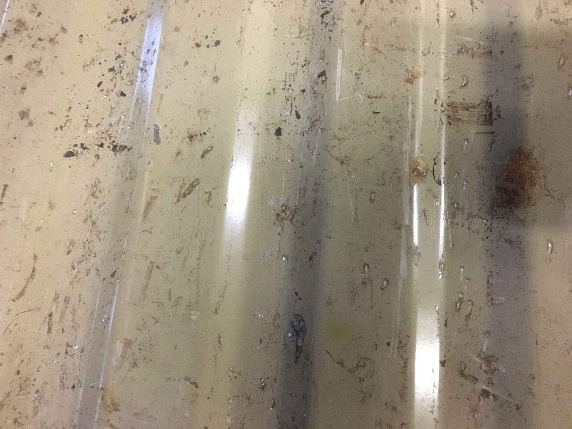

Cleaned the old undercoating from the bottom.
Primer looks like new underneath.

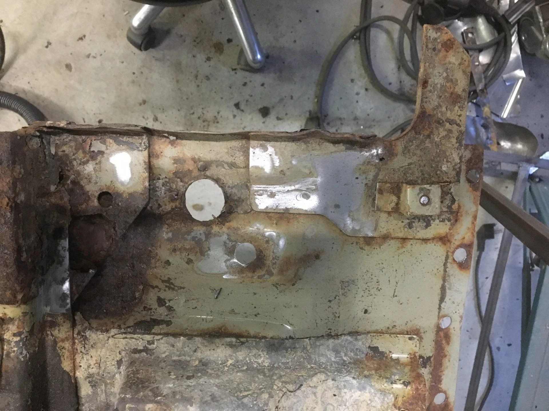

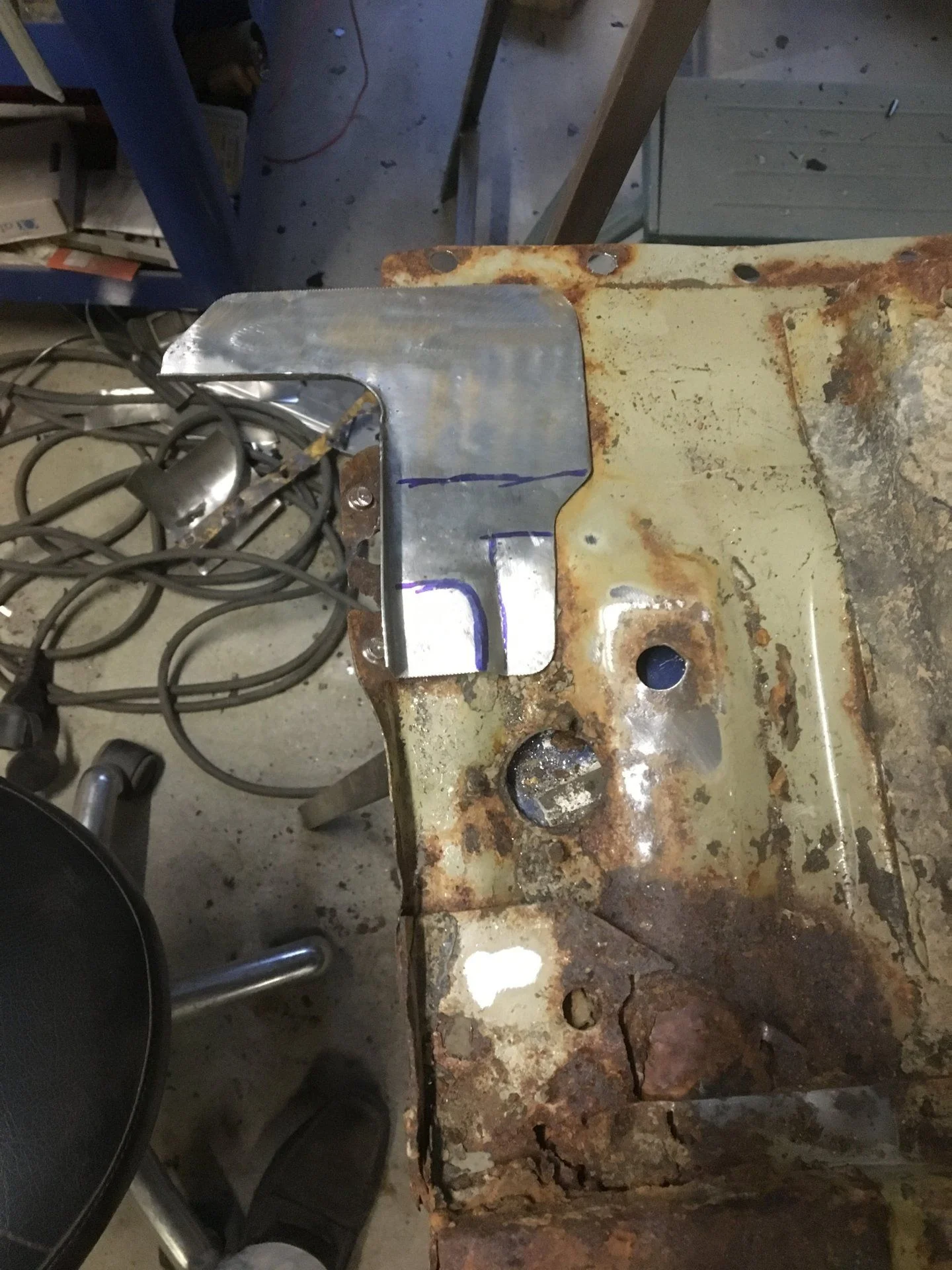

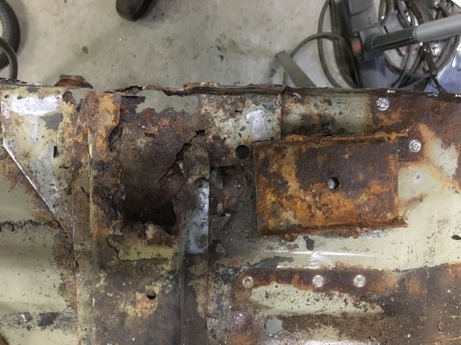

This corner piece is still intact unlike the other side which is completely gone.
Going to mirror this one.

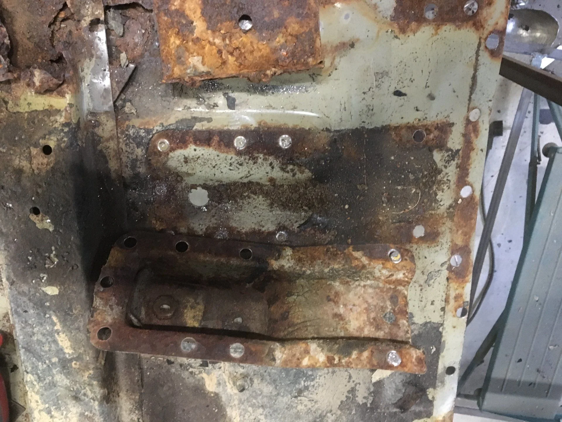

Weird to see, holes right next to original primer like new.

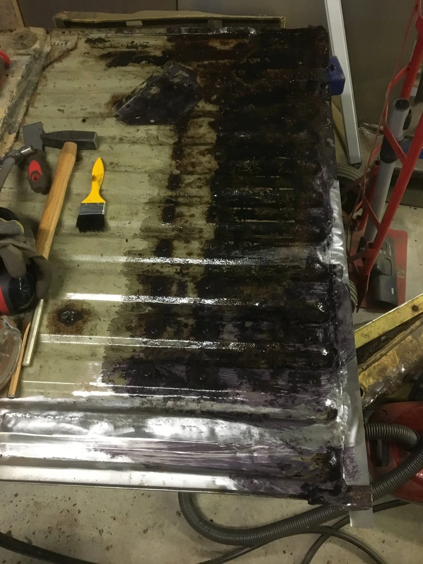

Treaded the back with rust converter.
Did you use Corroseal? Looks similar to what I did this past week. Didn’t have much trouble with the Corroseal until I put it on a little too thick.
I used a product called Brunox, it converts rust and seales the area with an epoxy primer.
In this case I’m going to take most of it off again, just using it as a binder and track layer, makes it easyer to see where what is. And at the same time convert the corrosion in that area. This stuff needs a thick layer to work propperly.

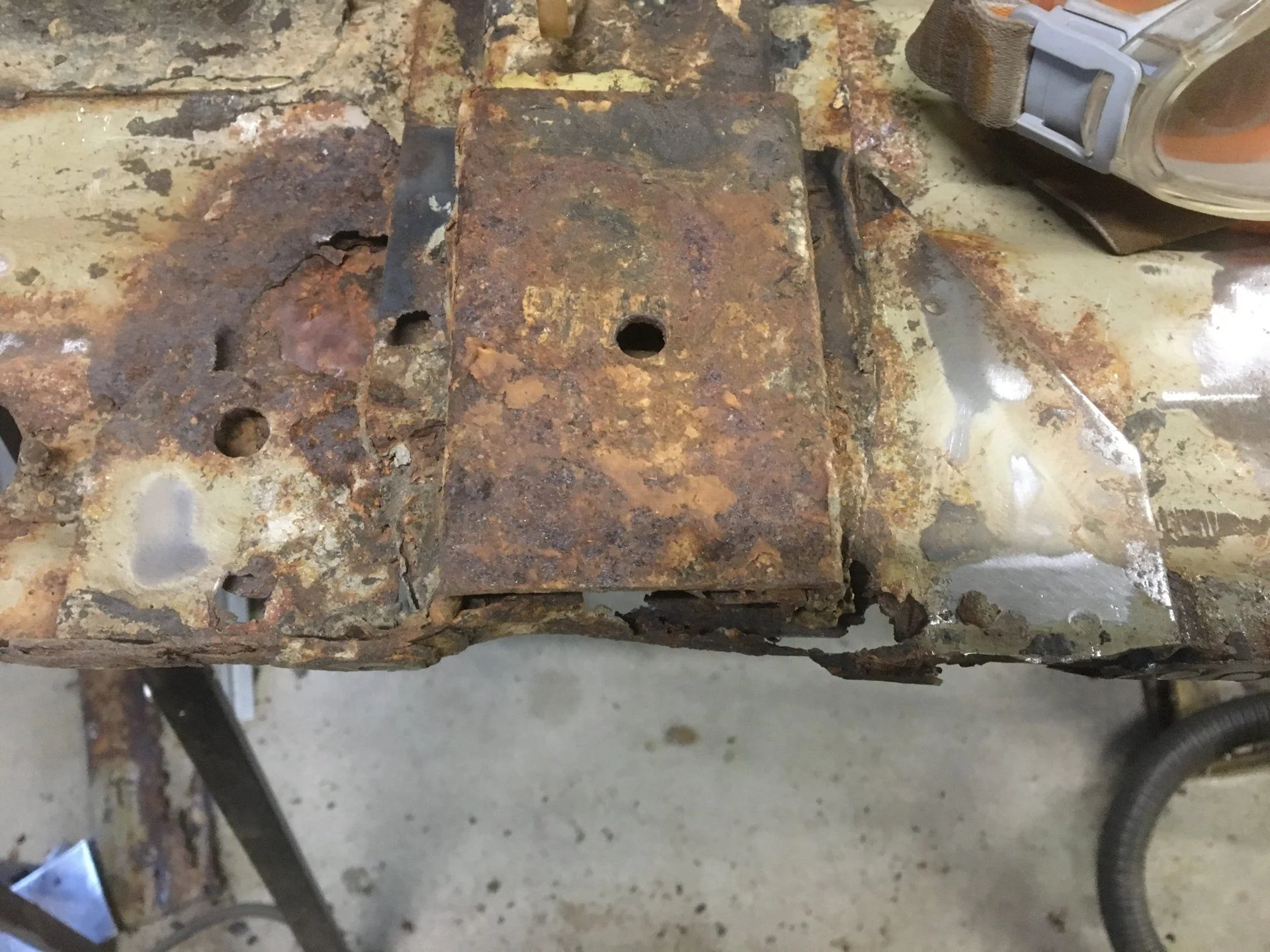

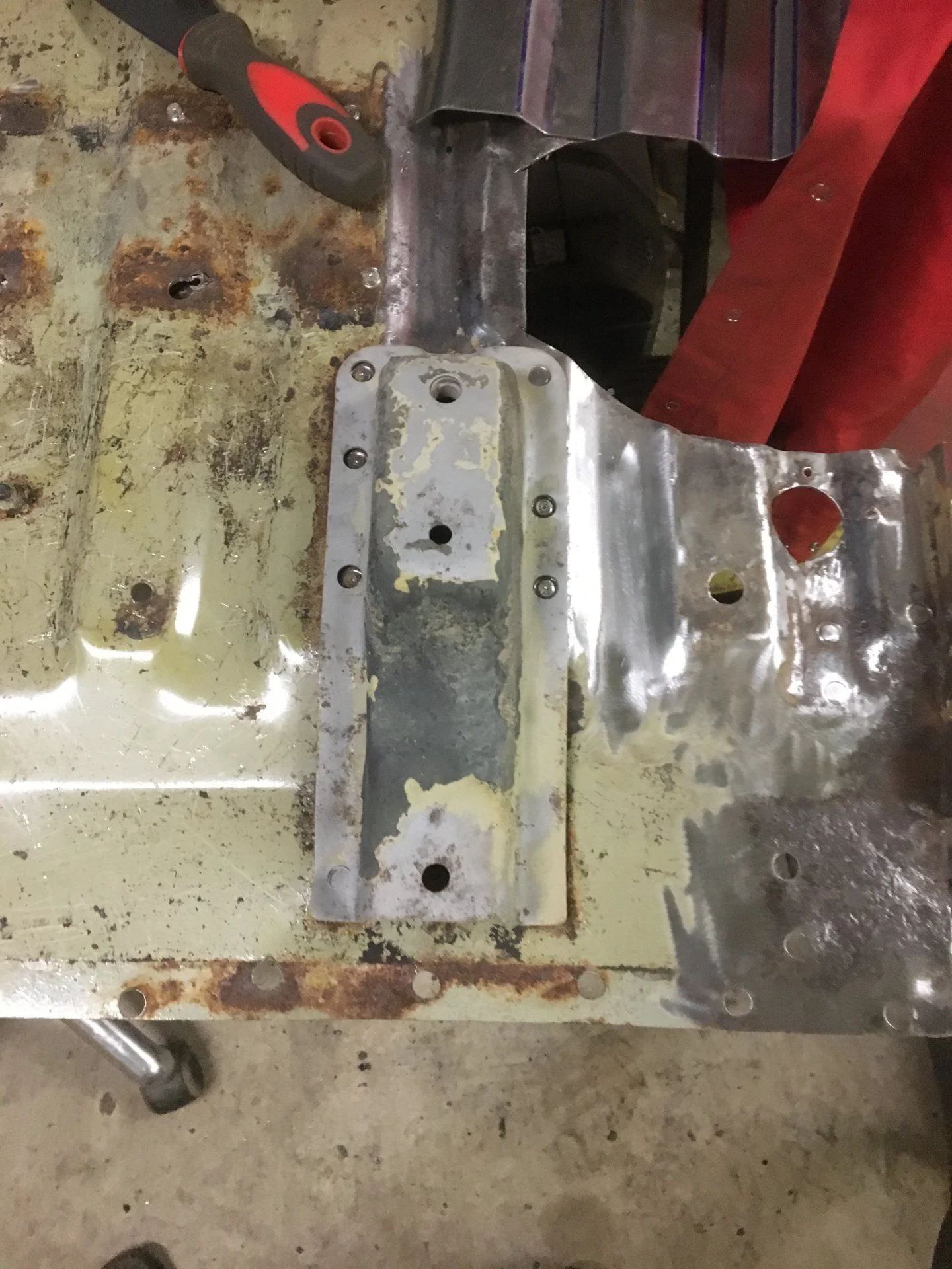

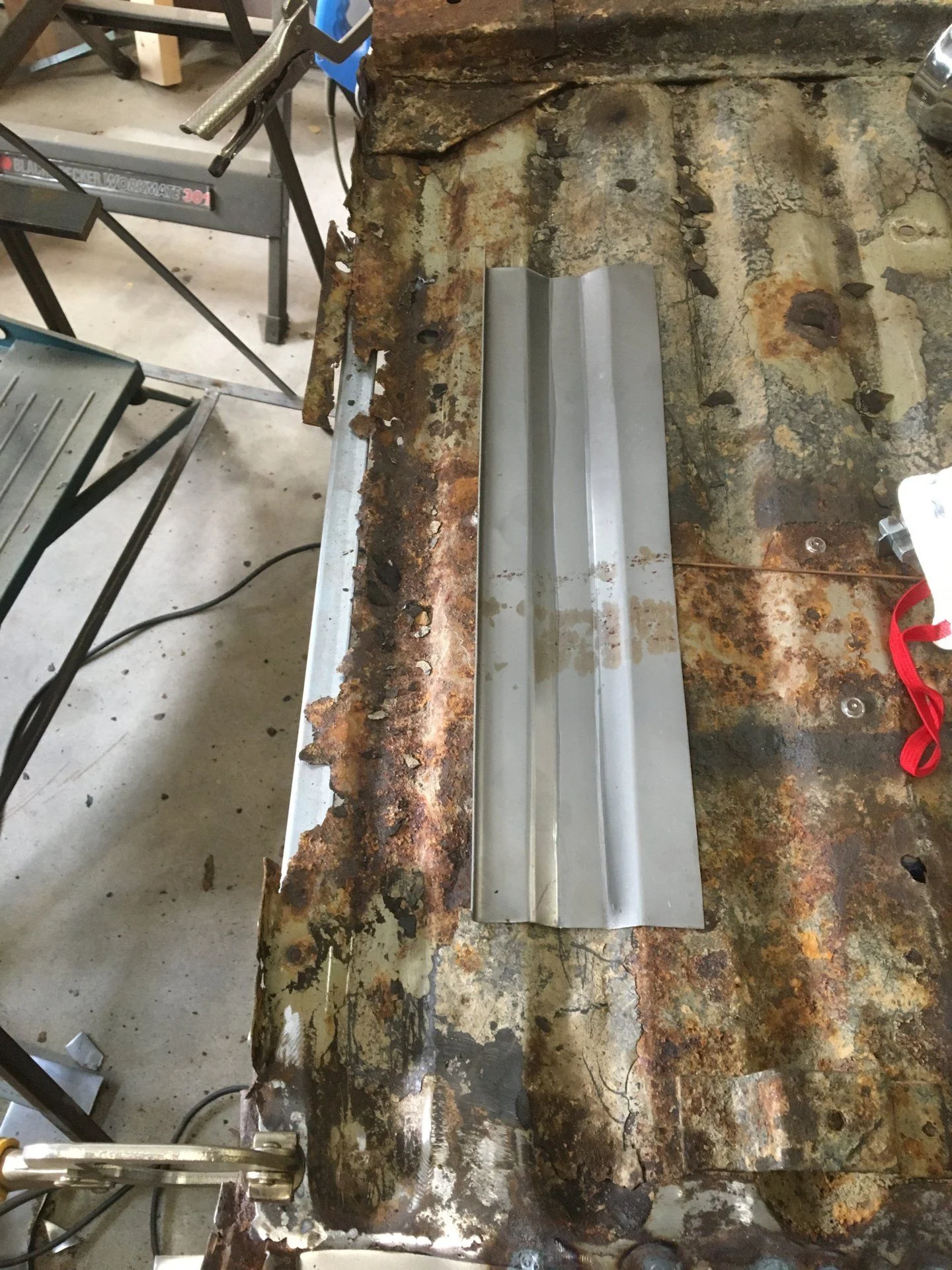

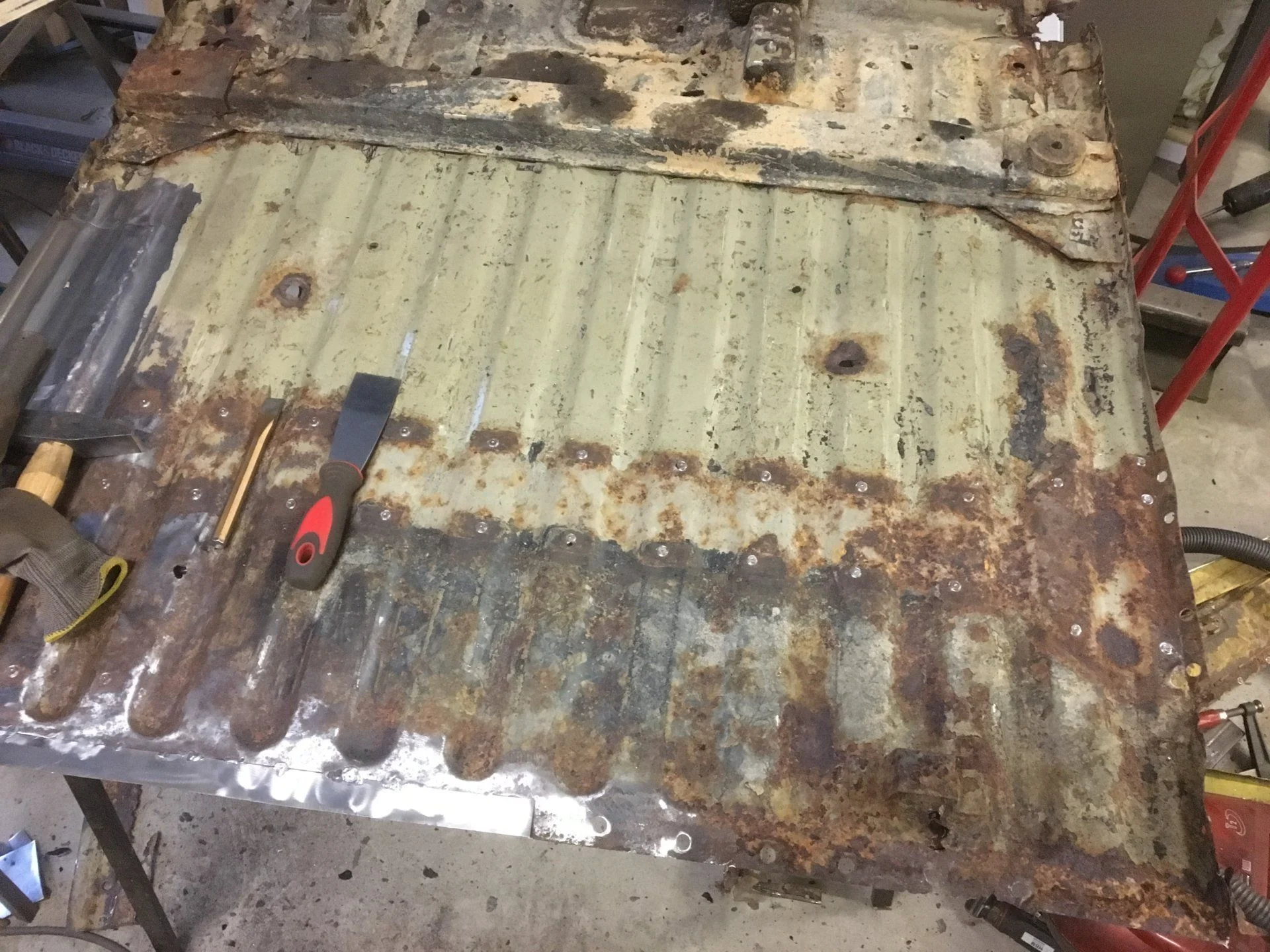

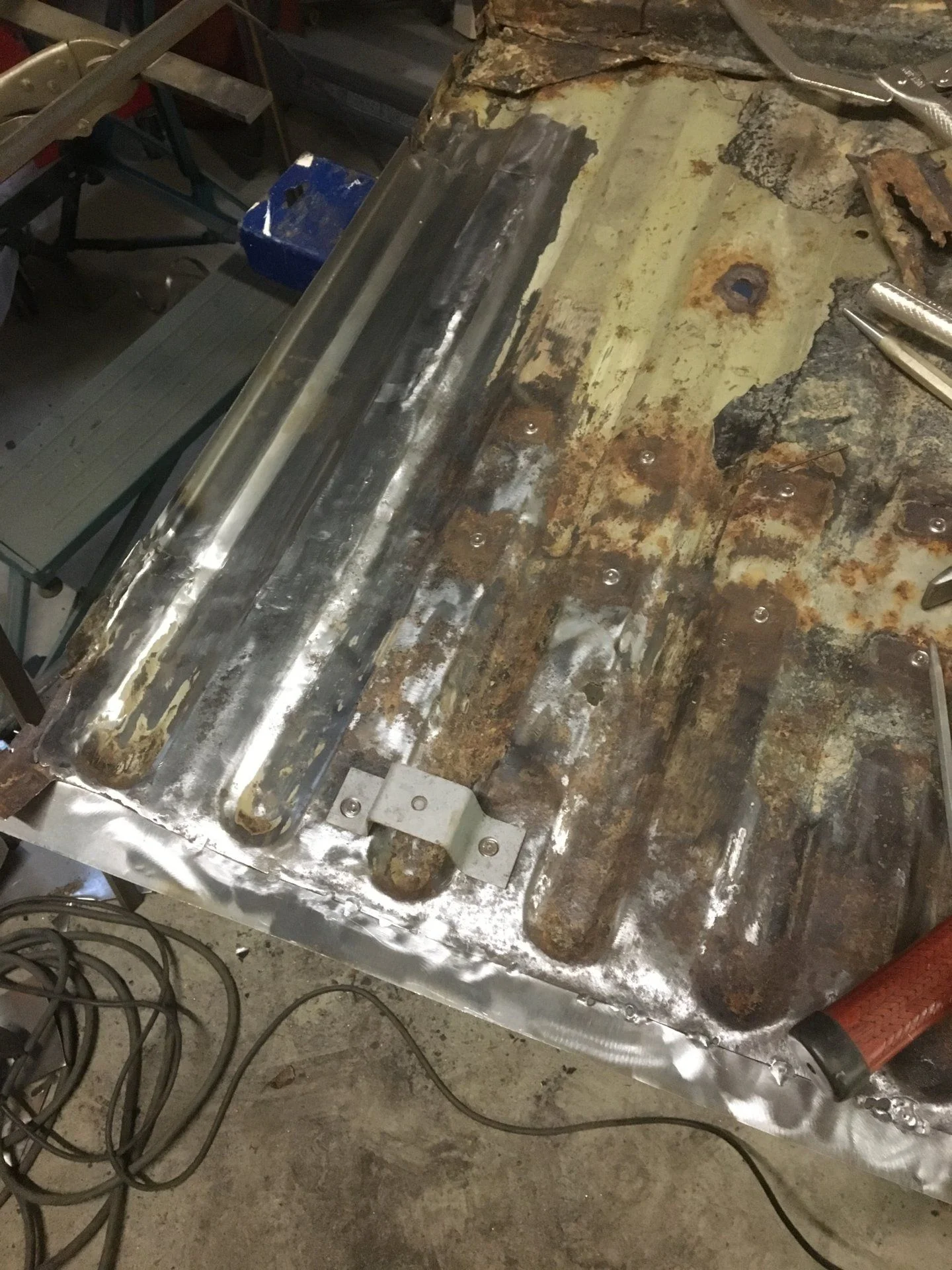

The mid section of the floor is clean, just some dents and holes made by the PO that need to be fixed.

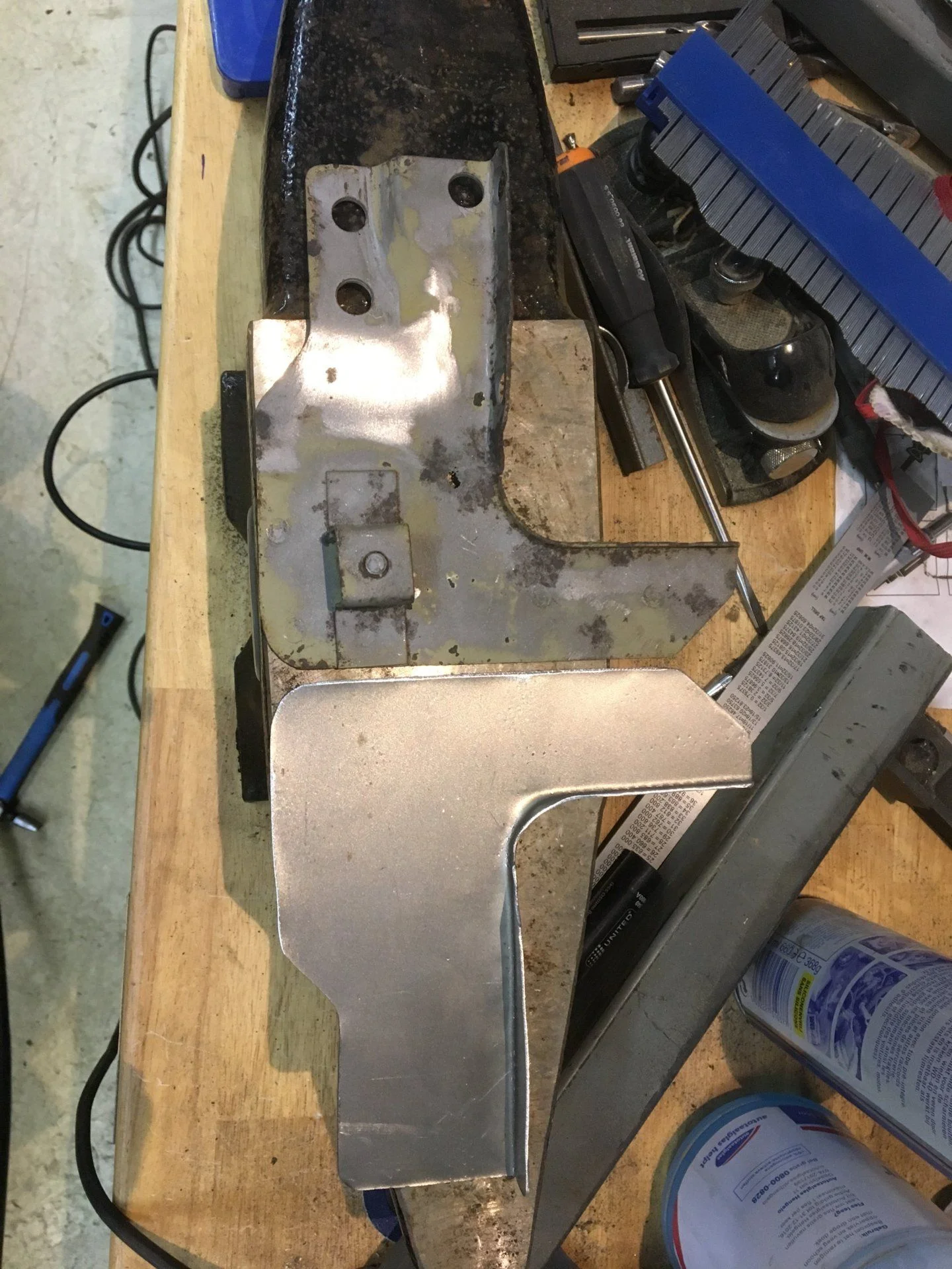

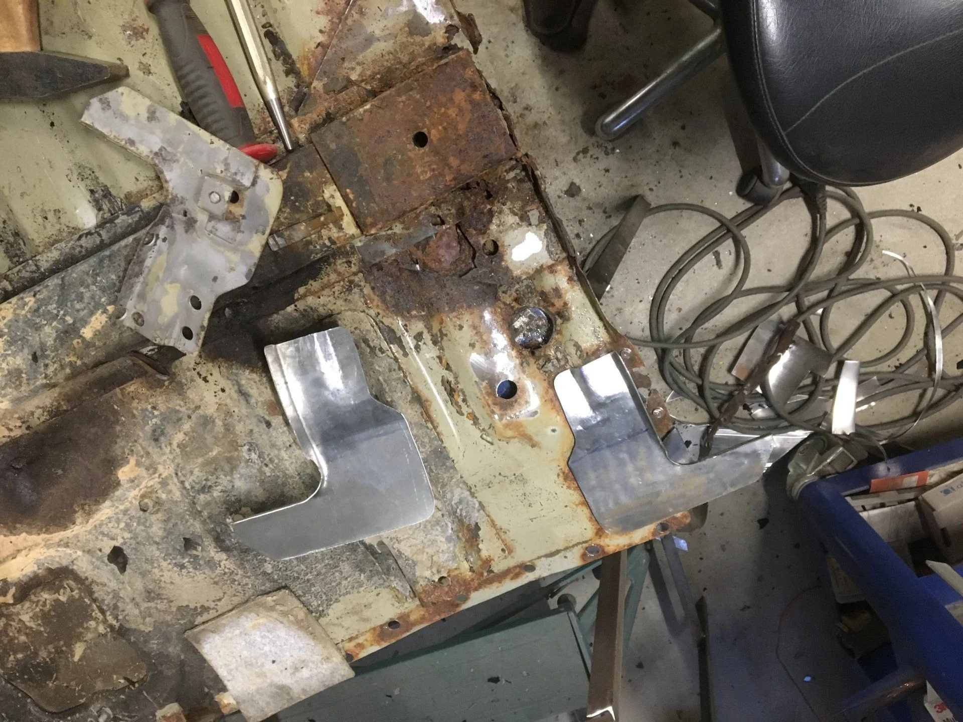

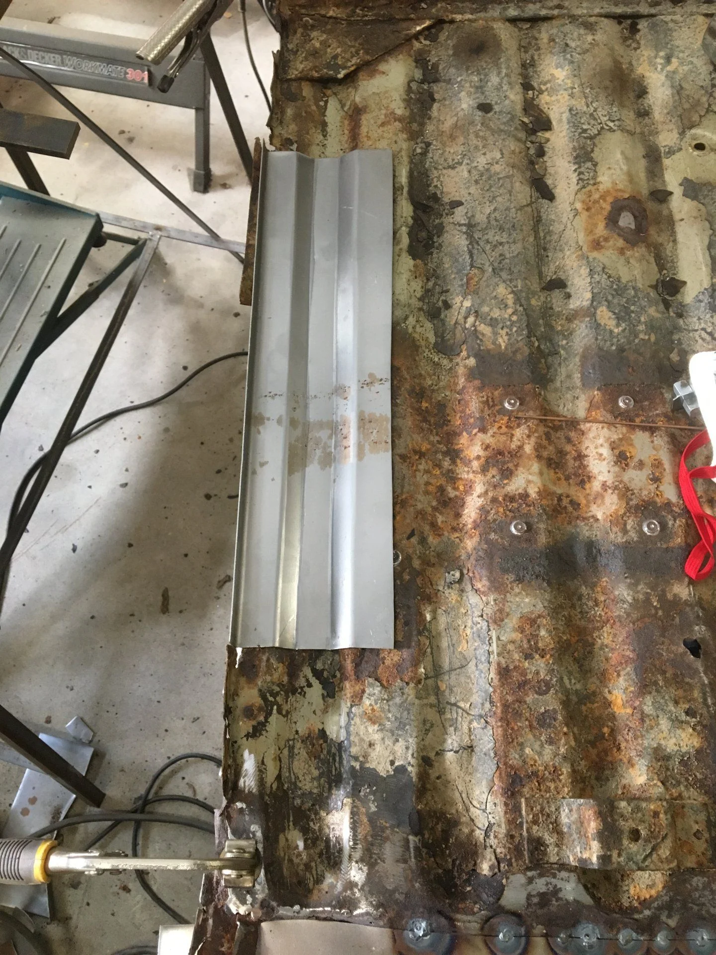

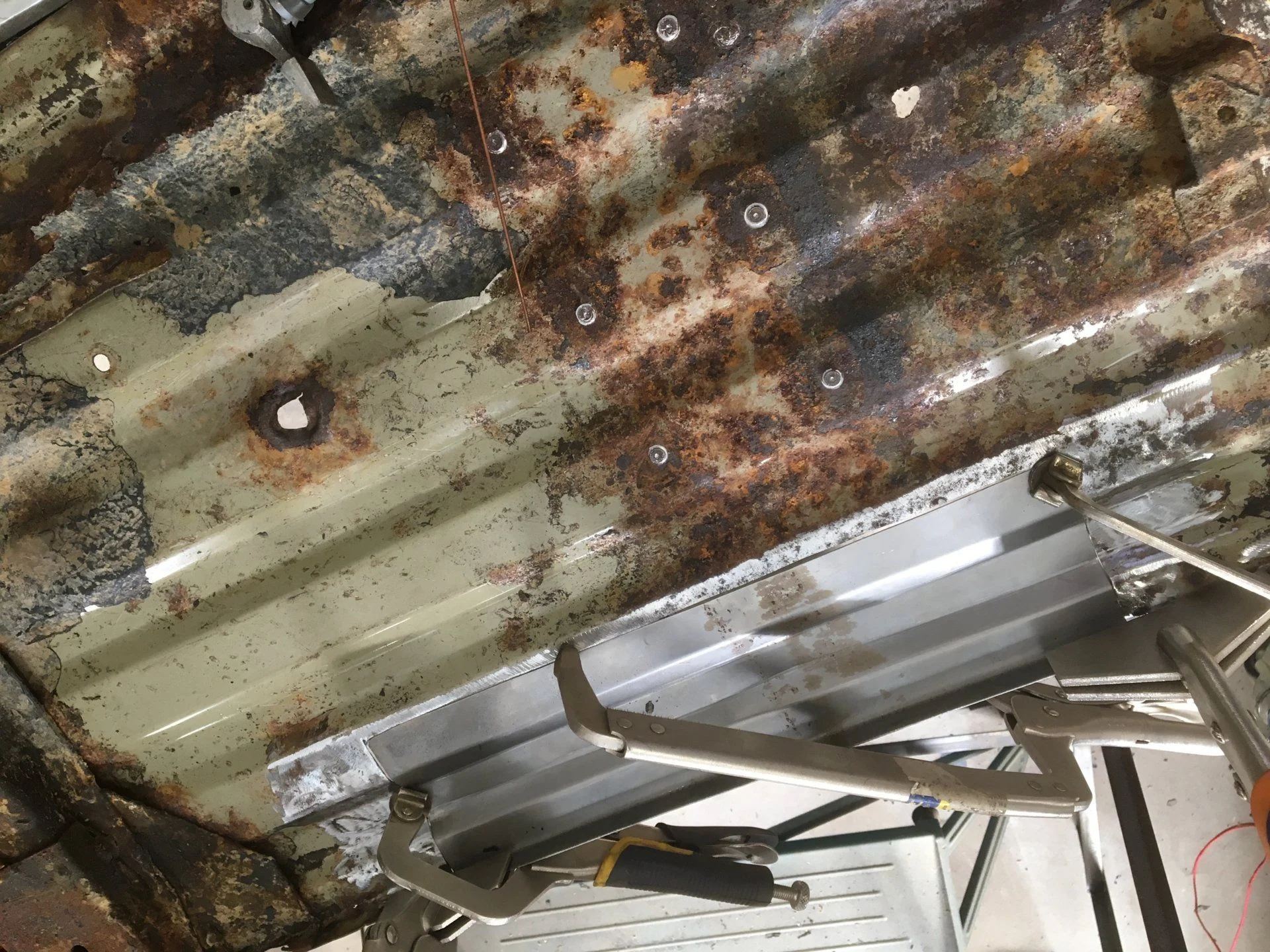

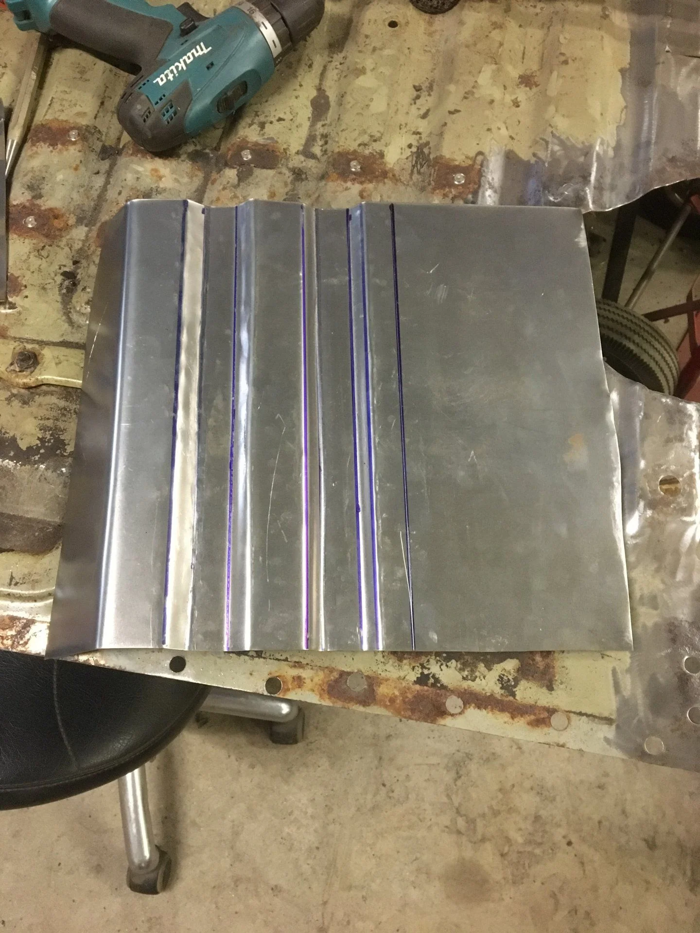

The right one step by step.

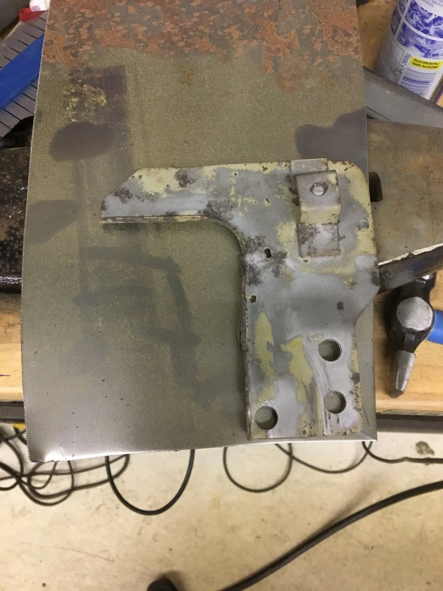

First the flat sheet.

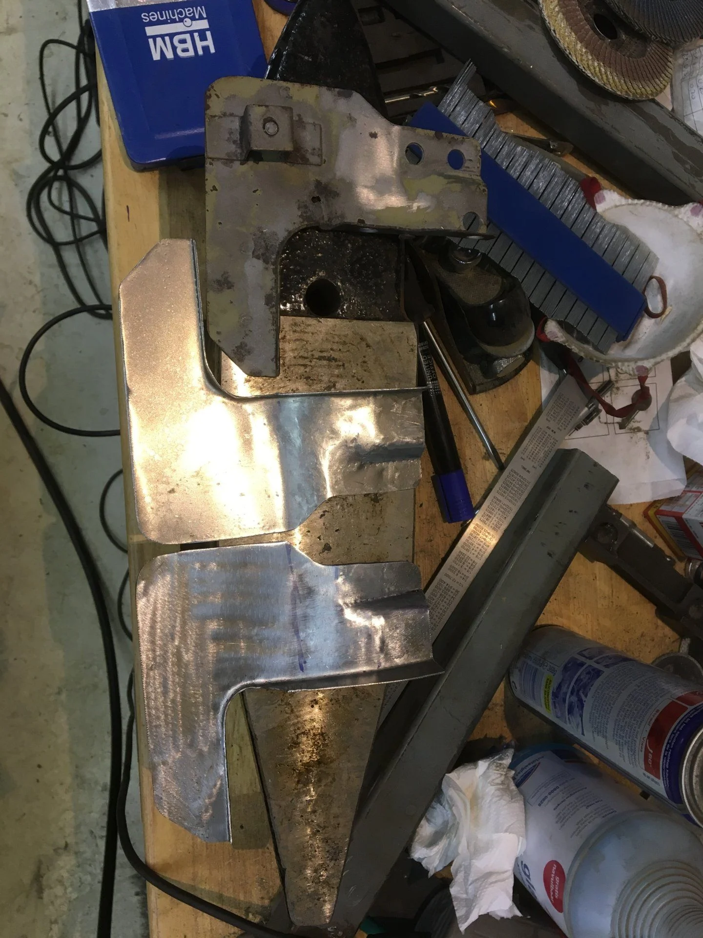

Contours tracked from the part taken from the car.

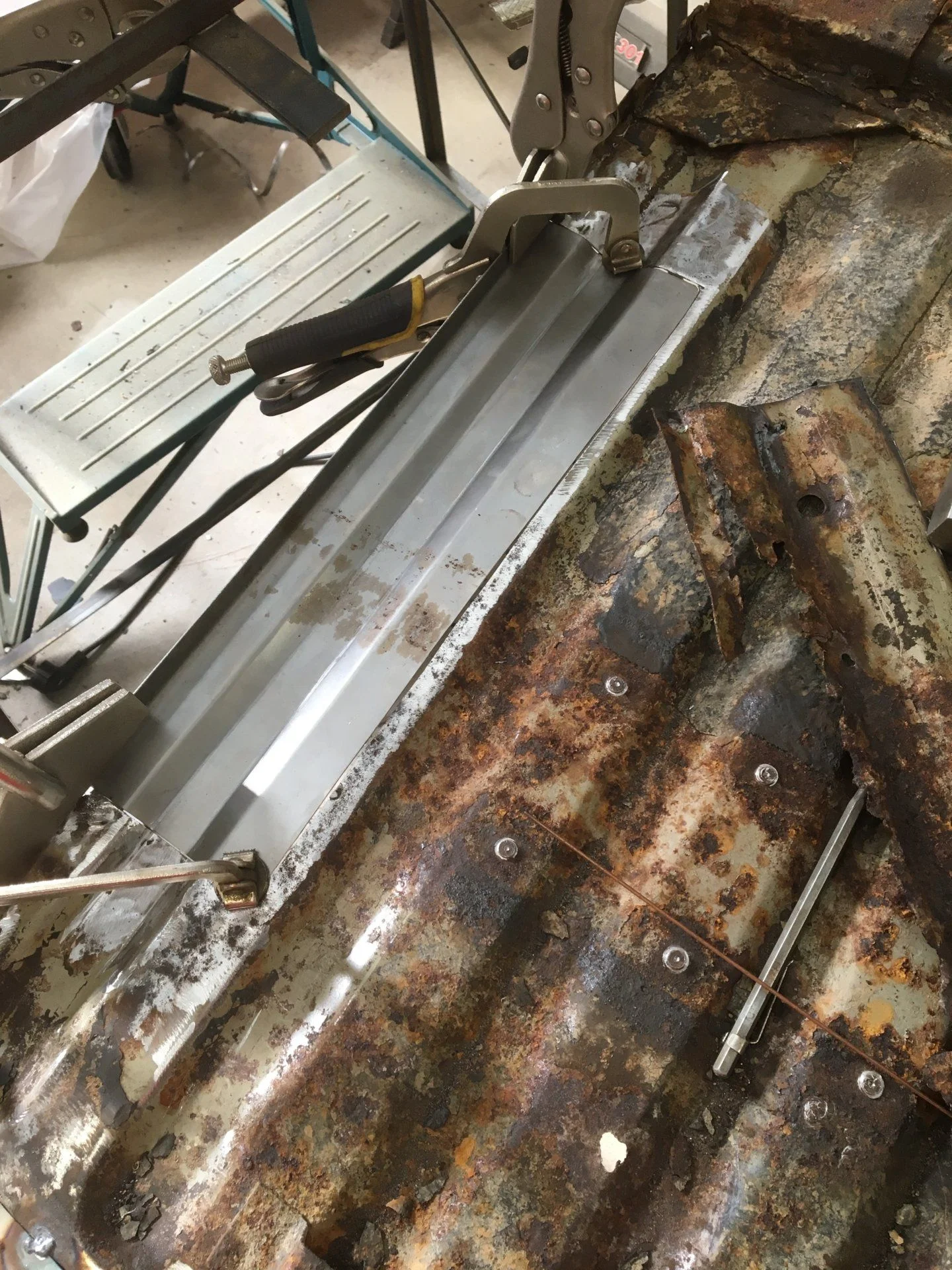

Roughly cut
Shaped and bend

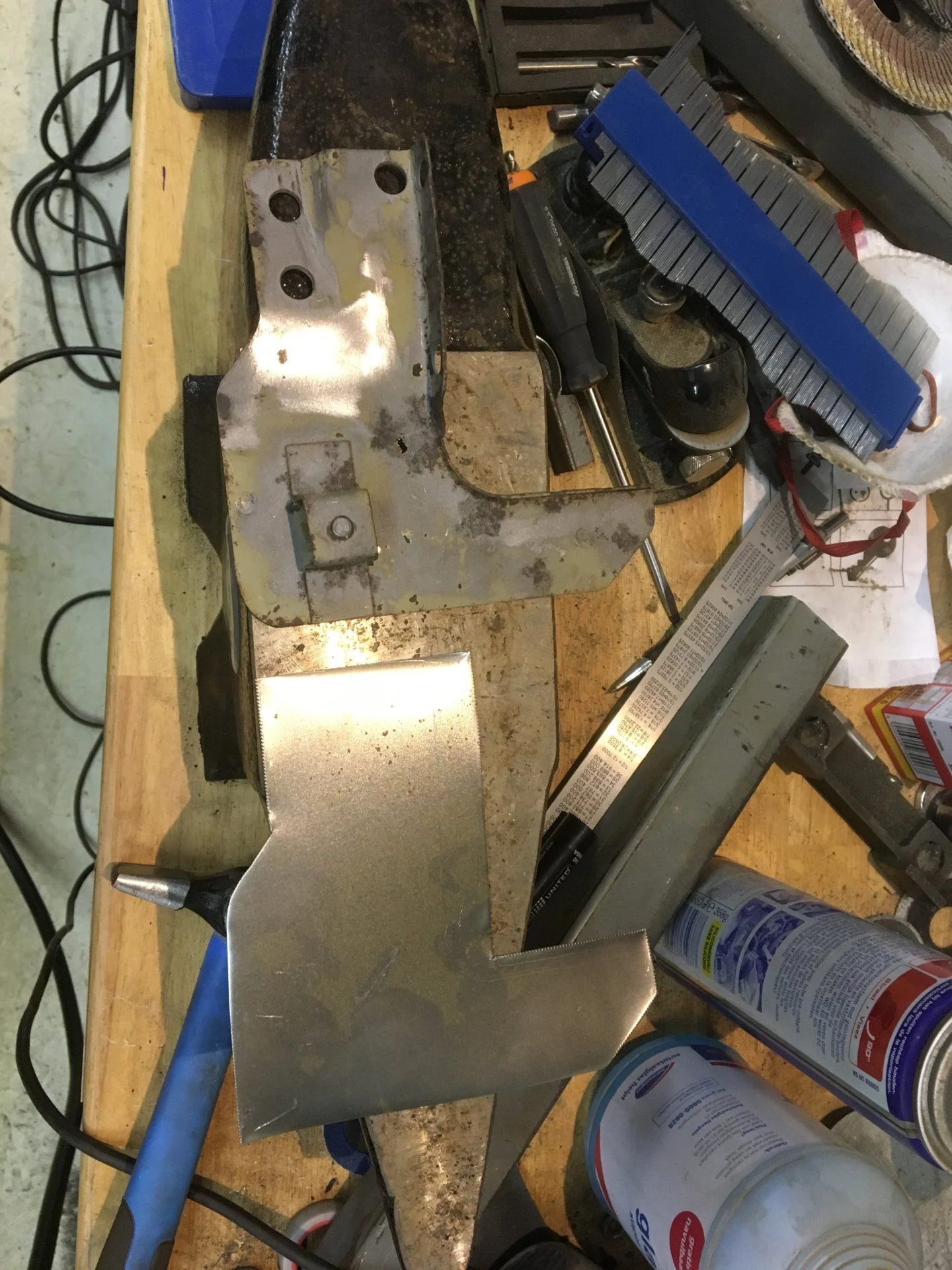

Drawn up the shapes to make

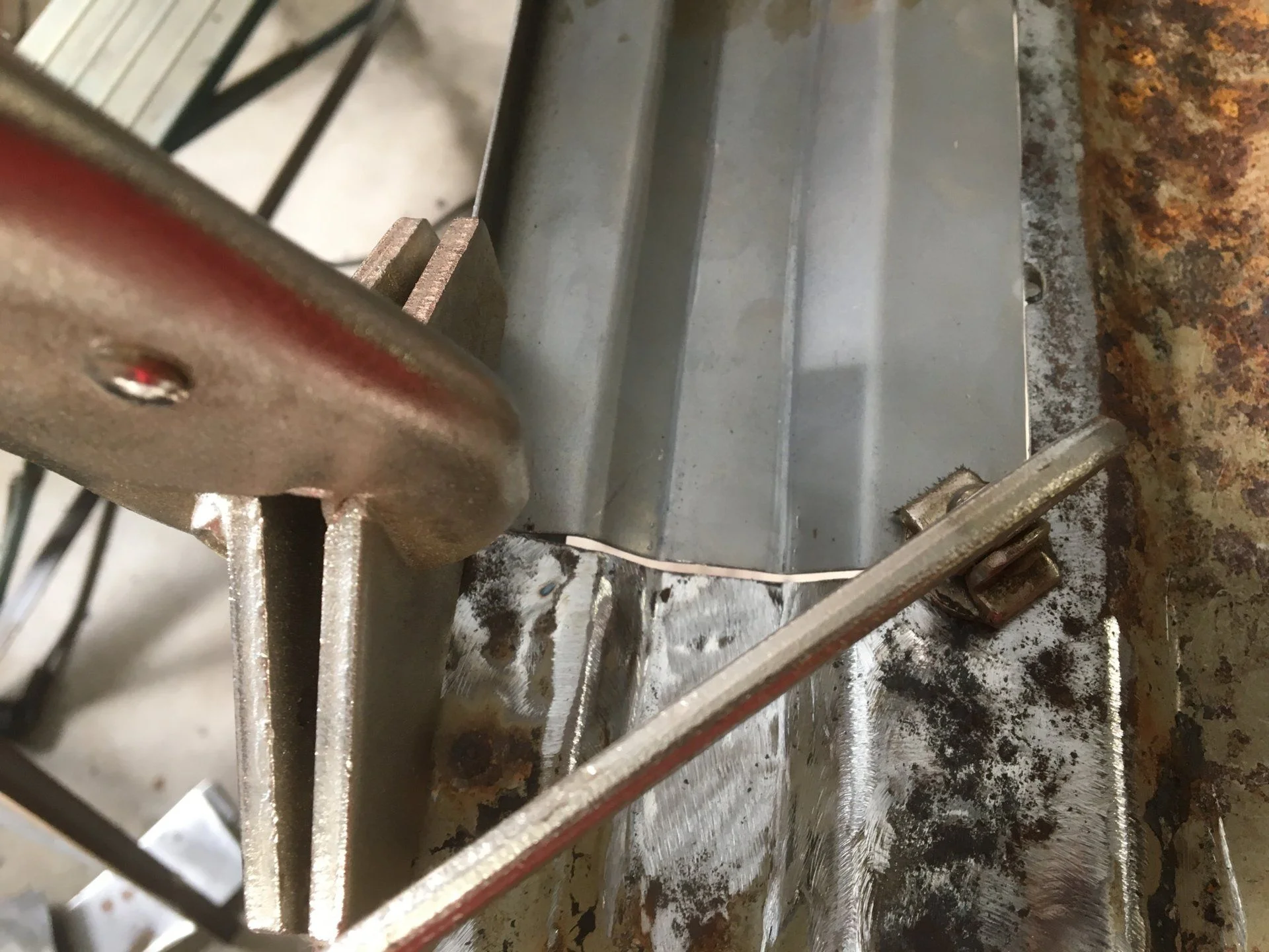

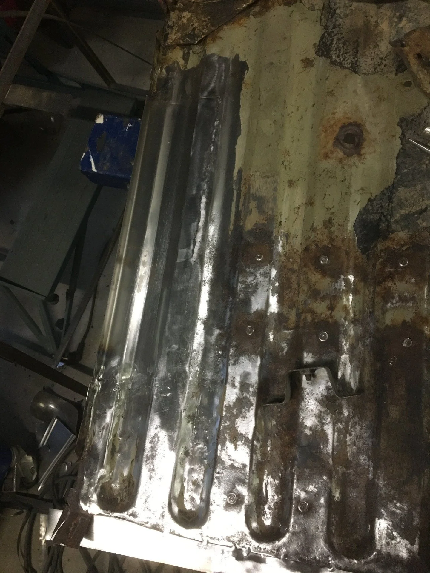

And the bends made, left and right together.

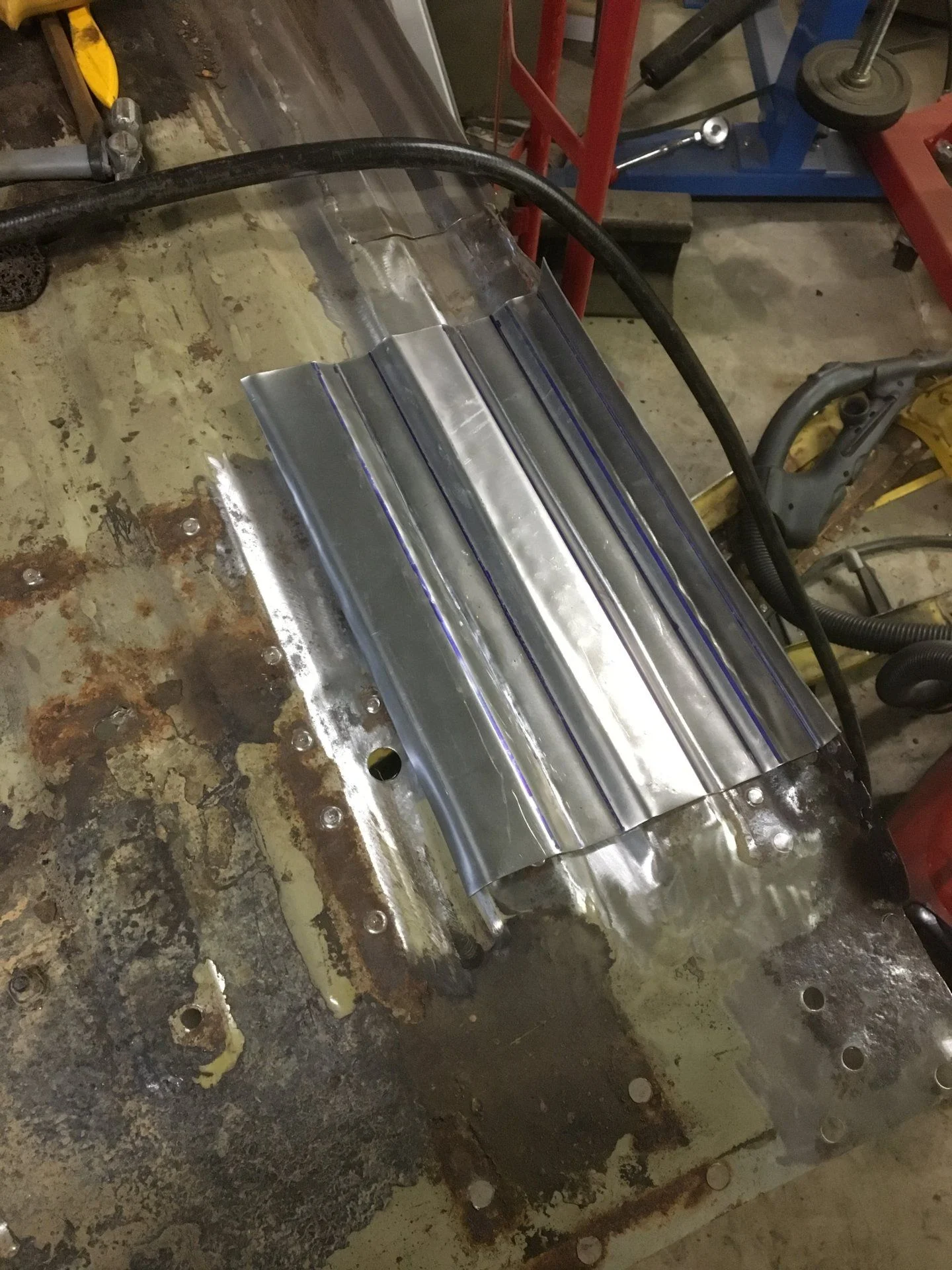

One in position and the other one next to it.

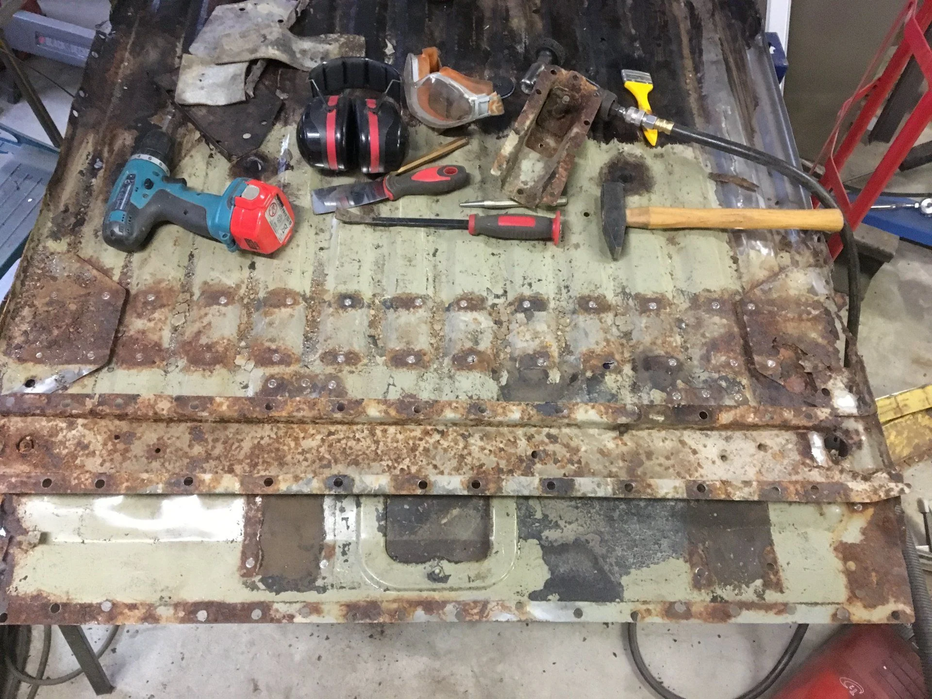

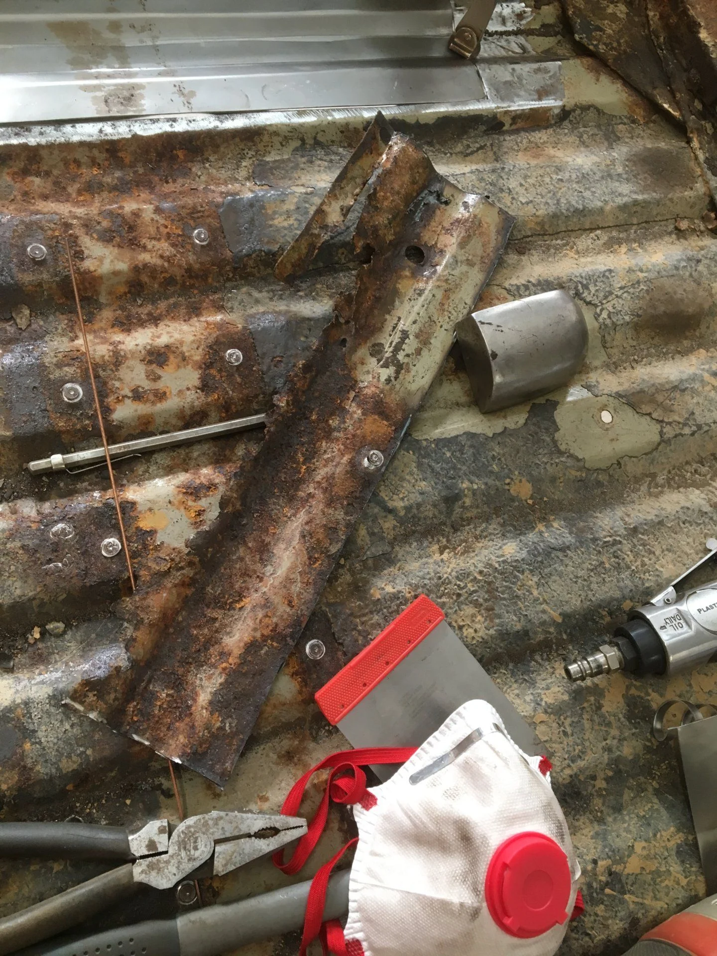

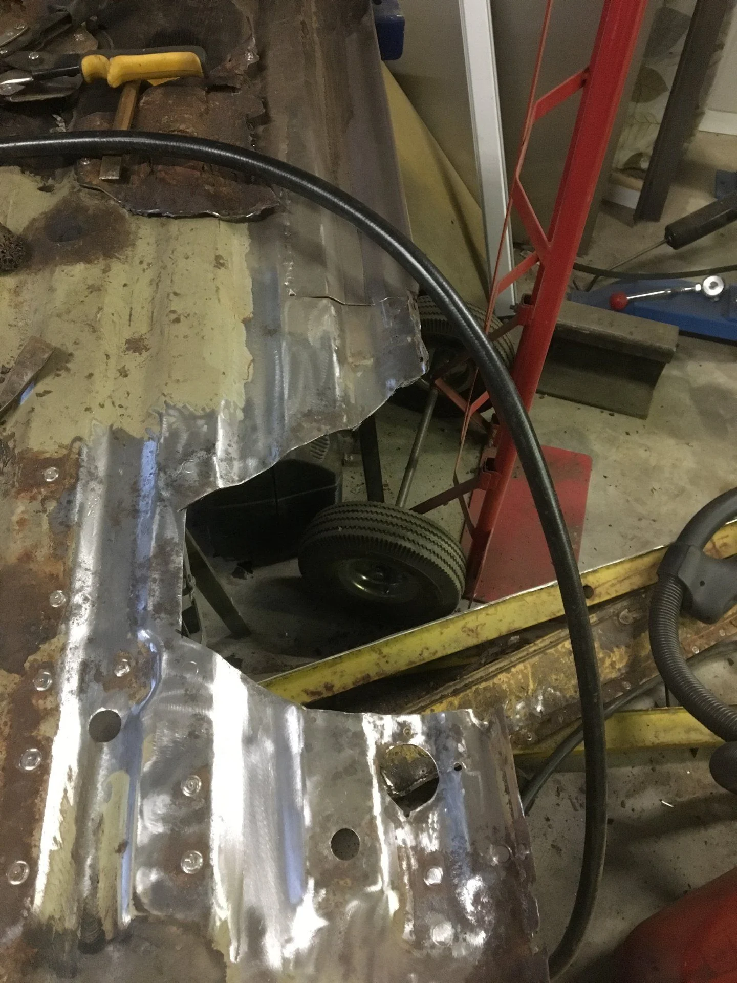

Further tearing down the floor.

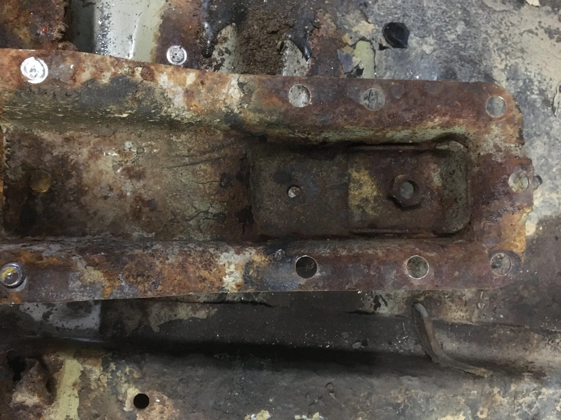

Typically everywher there is steel on steel there is rust.
Including the underside of the floor braces
