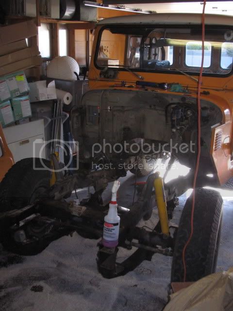

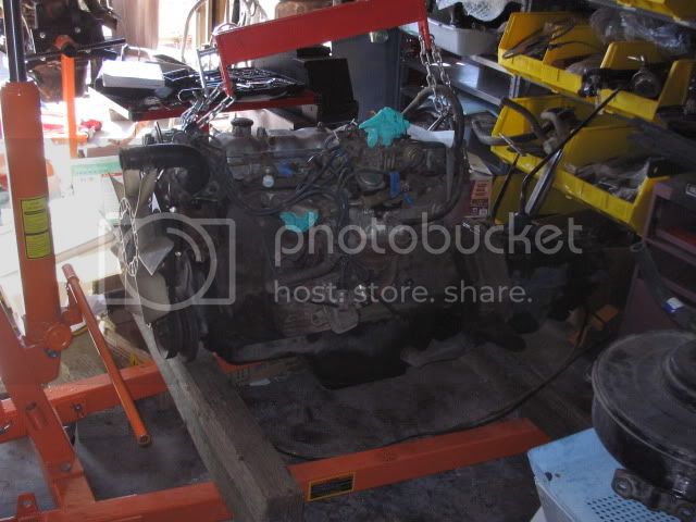

However, non of that matters if I don't have a place for the 1HZ to go. Guy and I pulled my entire drivetrain today.
On the do list next is, cut off old steering box mount, weld up power steering mount, and then engine mounts. After that drop in 1HZ and pull the body so I can continue work on the frame and start working some much needed sheet metal. (quarters, and rear sill, nothing too bad)

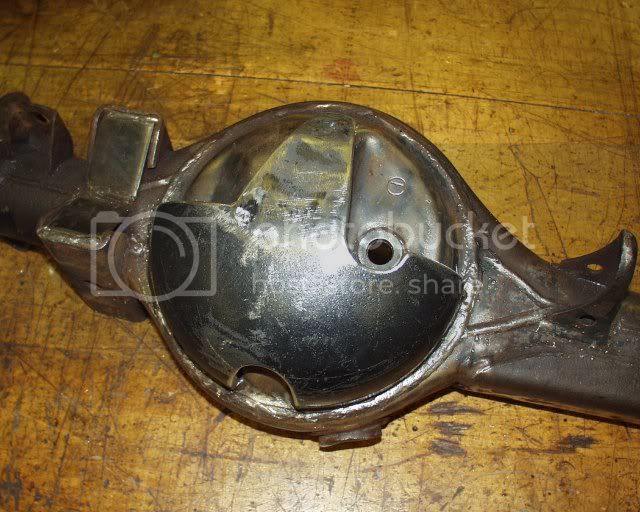

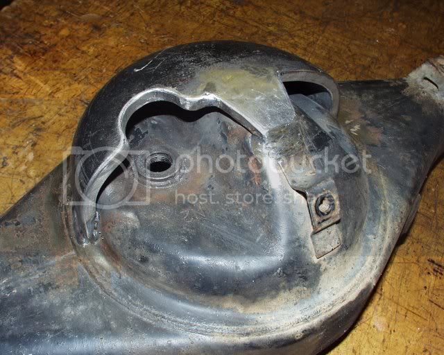

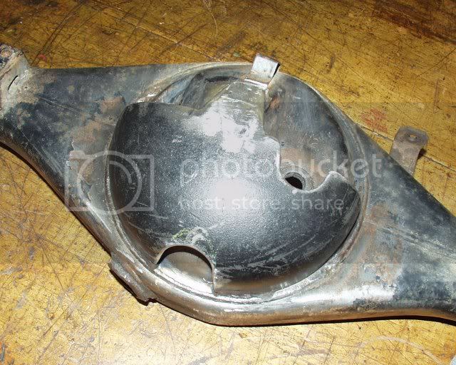

While thinking on this project and my axles to be more specific I was thinking a little armor on them wouldn't be a horrible idea. I know I had to do some grinding just to drain my front diff. Thoughts?
Well I do have that 2F just sitting there, just have it tuck and roll out the back. :hillbilly:
i would say sky is the limit. my 80 series stock just has the ring welded to the housing around the drain plug. i put in the allen key head plugs and have messed up that ring some on some rocks, but the plug is unscathed and easy to take out still. i sure you could dream up other skids and such to weld on before you powdercoat the whole housing ;)
For the front of the diff housing, a 8" or 10" fire hydrant pipe cap welded on would be a good skid plate. They're typically about 1/4" thick and strong as all get out. There should be some threads about this mod in the 80 section.
If you have the axle out and easy to weld then weld on a ring around the drain plug like the 80's come with but make it a deeper one, about 5/16" high should be just about the right amount of overkill.
Thanks for the information. I found this example that I like a lot and if I weld up the ring and then have it taper down from there I think my axles should be safe from anything I get them into.
