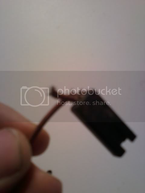

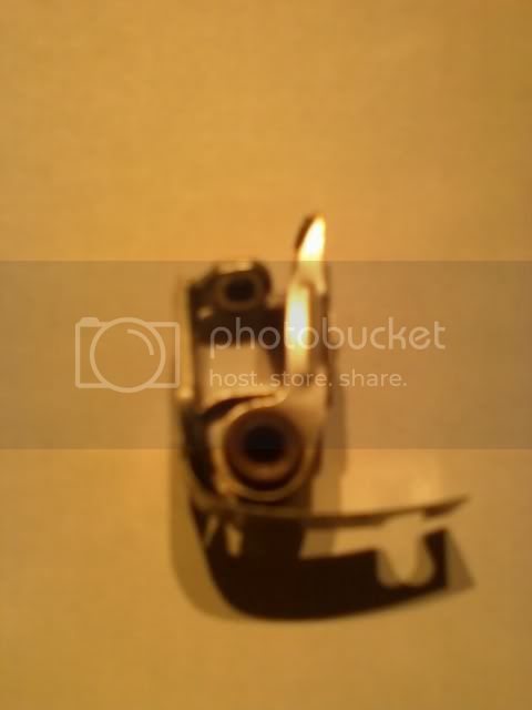

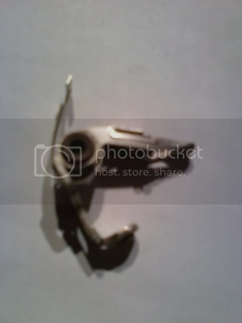

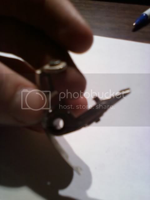

I am lost on what these pieces are. The wire piece fell off today when I was cleaning the undercarriage and knuckles with a pressure washer in preparation of rebuilding axles, suspension, and PS. At some point it looked like there should of been two wires. The odd looking metal piece I found a while ago in my glove compartment or pocket as some would say. I found it after having the windshield folded down.
Wire
Metal Thingagmagigga
Source3 your right those are old my old points. I had forgotten I had put them in my glovebox. I stopped my Cdan and the red wire thing is for my brake master cyclinder. Which makes since seeing that my brake light doesn't come on. So I have some rewiring to do tonight.
The wire goes on the brake m/c for the idiot light--a post under each reservoir.
IMO I wouldn't spend the $$ on OME for a 40, I'd buy Skyjacker. I've ridden in both and I don't think the OME is that much better.
OME is going for now because it is currently sitting in the garage. For the wire does anyone have the tool or special technique to get the wire free from the clip so I can rewire the clips and have my idiot light work for the first time sense I have owned the vehicle.
You should be able to slip a really skinny, small, flat blade screw driver between the outside of the metal terminal and inside the plastic housing to release the terminal from the housing. Look real close to see if you can find where there would be a slight protrusion from the terminal engaging a boss or rib on the plastic housing. Insert the screwdriver from the end opposite where the wire is coming out. The next challenge is being able to pry open the tabs that hold the wire to the terminal such that you can reuse it to secure new wires to and then insert it back into the terminal housing.
What Marc said for getting it out. I might have terminals you can crimp on new wire. After you get the old one out post up and I'll let you know.

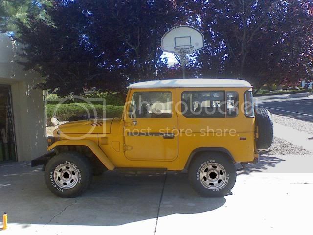

Today I got my 33" skinnes on my FJ60 rims. I really like how they turned out. It barely clears my garage door in its normal up position. Skinnes offer so much less resistance than 10.5" when I drove it for the first time I'm thinking power steering isn't a must have, but I'm still going to do it because it makes sense to do.
Also I went to the boneyards with Dan and found some really cool parts. I ended up picking up a cable hood latch, so I am going to play with that and see if I can get that to work. By having that it just offers one more level of security in my car as long as my hardtop is on.
Of course I took a picture of how it looks in the exact same spot I do. :D
