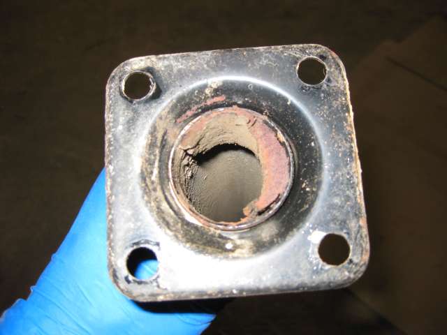

Something else I thought of this morning driving to work - Even if you keep your 40 column, take it out and replace the bushing at its base. It's probably mostly disintegrated anyway. I think IPOR and/or Kurt at Cruiser Outfitters sells a bearing to fit. Or you can find one yourself.
Or he can get the OEM part at work...
Oh, didn't realize it was an OEM part. Thanks for the info!
Our 40 column didn't have a bearing or bushing at the bottom, it just relied on the rag joint to support it. The 55 column did have a bearing.
The plot thickens! (and I need to know the deal, because my 45 needs the same solution).
Dan
Maybe it was gone? Mine looked like this, and this is how they usually look from what I've seen:

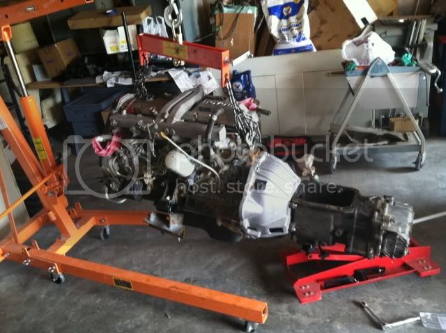

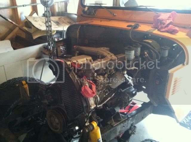

Today was a good day. My 1HZ is currently mounted up to my 40, and I finished cutting out all the old mounts. Overall, I am happy with its placement, but there is some tweaking that needs to be done to make sure everything lines up. Once that is done I will pull the temporary mounts and weld up some new ones that are spot on.
Fitting a 1HZ in a forty is a snug fit to say the least, but will be super sweet once done.
Here are a couple pictures. I will post more pictures once everything is fitted 100%.
(drool!)

Nice engine hoist, tranny jack and a leveler...:hhmm:
Sweet, nice progress man. Get that smelly pig on the road!
Its the only way to do it. The tranny jack also allows me to control the front to back and side to side pitch, which makes it super easy.
The plan right now is to lift everything back up and pull the current mounts off and bolt on a piece of plate steel to the insulator and get everything exactly how I want it, and from there make a template off the plate. I also want to have my power steering box, heater, and tunnel cover in place before I burn in new mounts.
Its a super snug fit with everything. I attached the fan and fan clutch and it barely fits with the radiator. Interestingly the fan clutch doesn't sit down all the way down on the old water pump, but will on the new water pump I have. :confused:
Be aware that your fan will flex a lot. There was some research on this in an old thread in the 80 section but I believe it was around 2", maybe more. The fan may not make contact at idle sitting in the garage; more likely 300 miles from home and 50 miles from pavement at 4,000 RPM which makes a big mess of things that get in the way. They've been know to create new dangly bits.
-Mike-
And it's not just air. Drop the hood into water and watch that fan propeller forward. Ask Onur.
