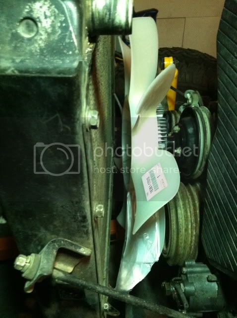

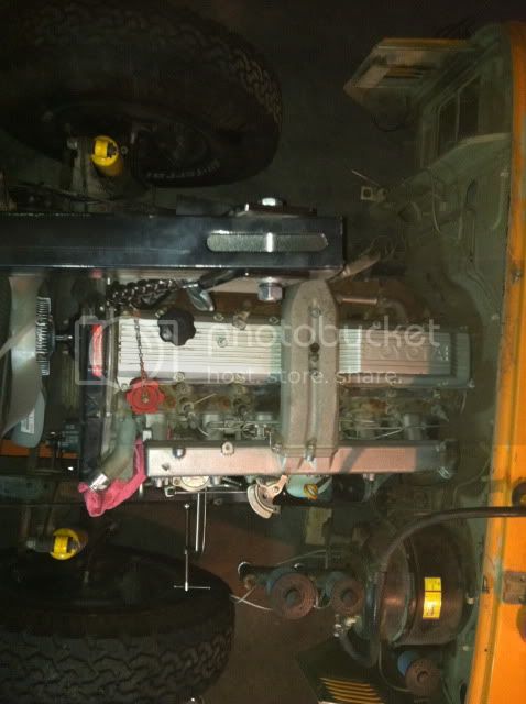

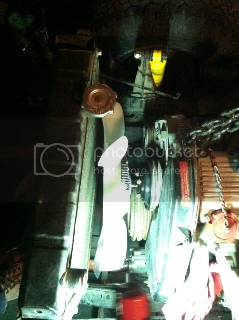

I just finished getting my test mounts tweaked enough that I am happy to start making some final mounts, so I am buying steel tomorrow afternoon. Here are some fitment pictures. The engine will get pushed back about a 1/2" to 3/4" to help clear the fan more. Everything else is lining up great. :D
Nice!
Is it just me, or is your radiator cockeyed in the shot from above, or is the whole engine?
Dan
The engine is the one that is cockeyed in the above picture I took it slightly crooked, so it makes the engine look straight. The engine has a slight kick to the left with a slight downward slant.

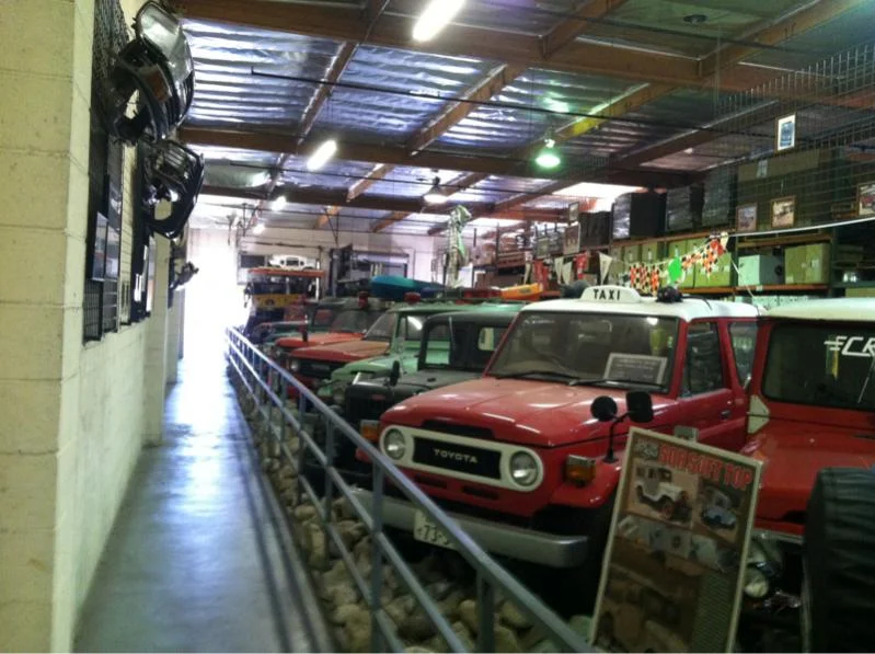

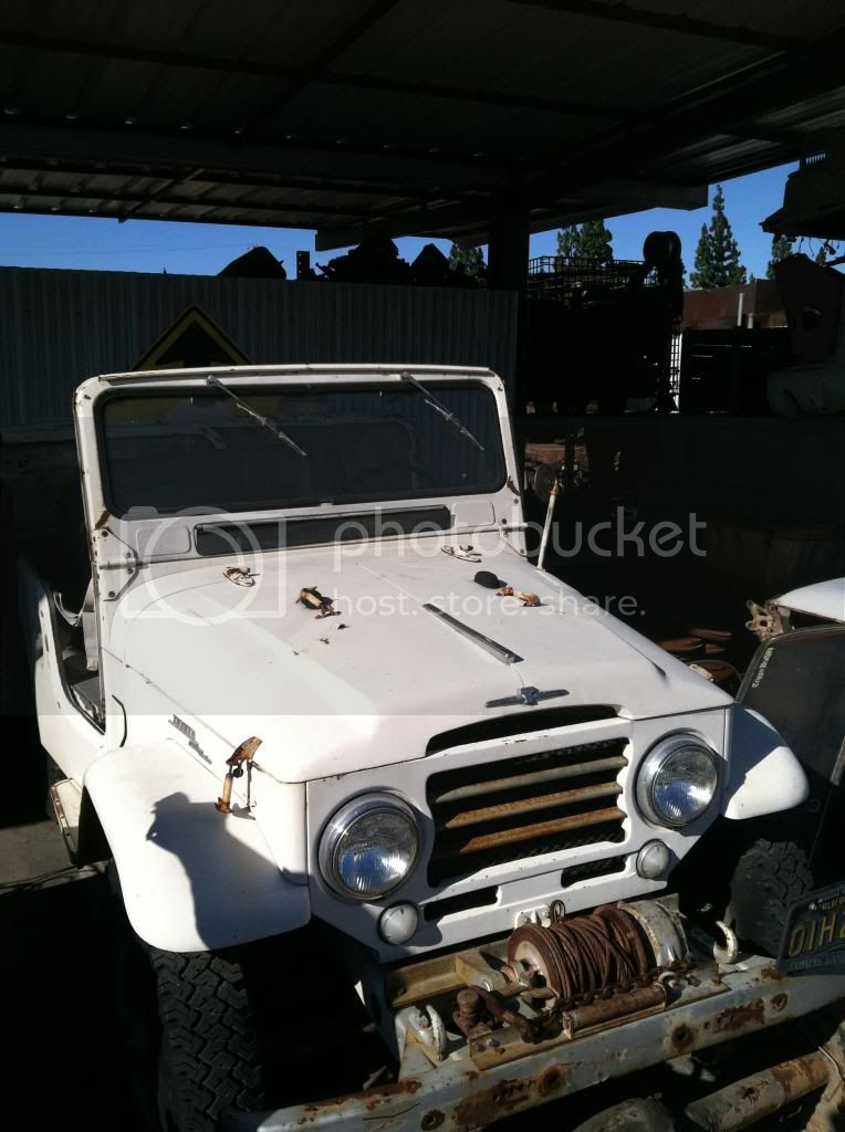

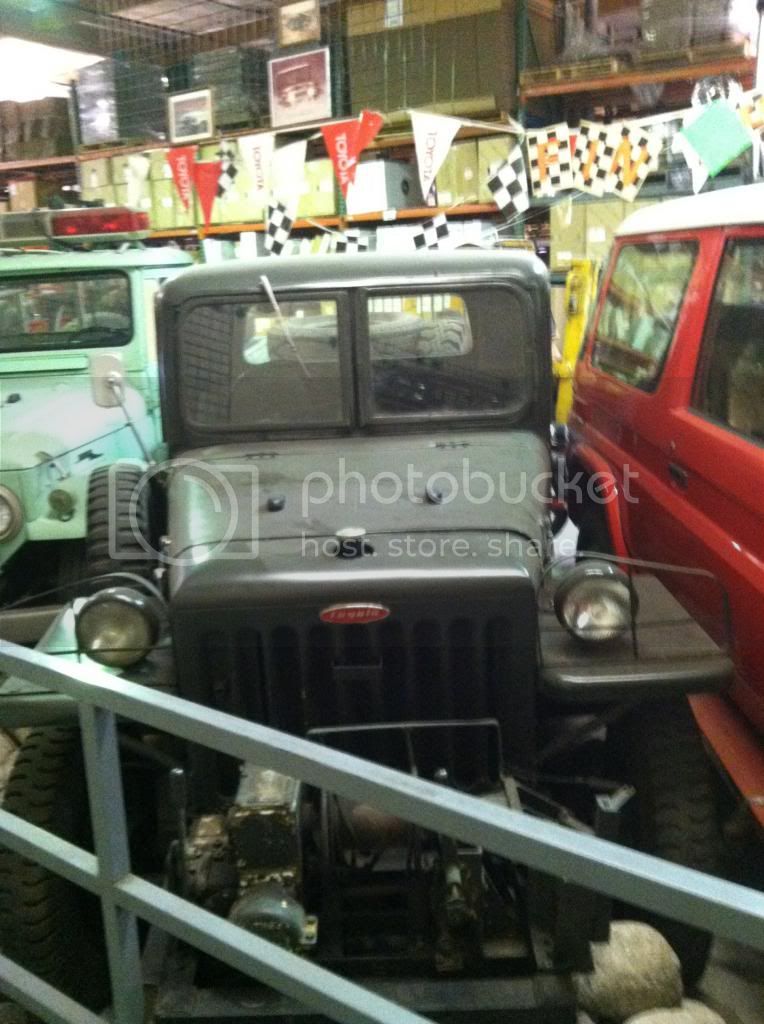

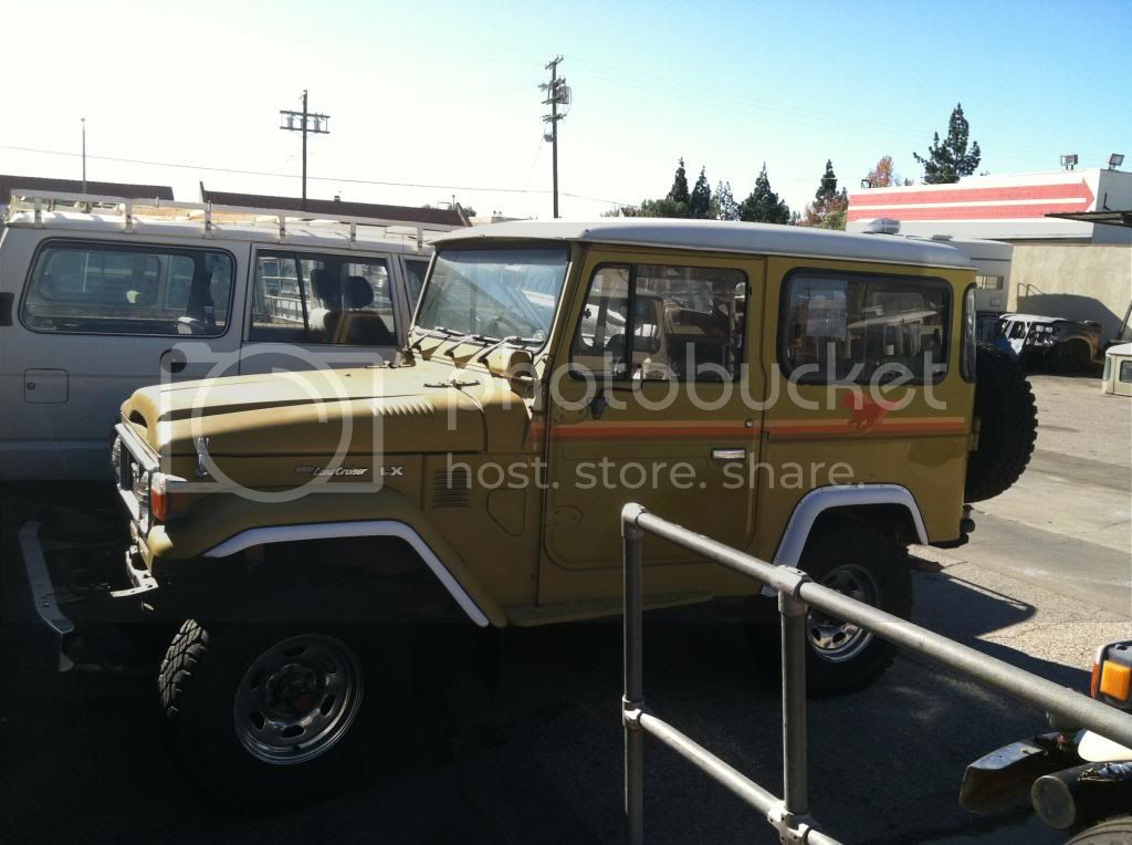

Just a little update on this project. I picked up the diesel decals from Spector when my dad and I extended our lay over in LAX. We looked at Spector, Icon, and Sciarc (architecture grad school). I only got one picture from Icon because we were a bit busy trying not to run into anything while we stared. Enjoy the pictures.
I will try to get more pictures up later.
There are some cool looking oddball cruisers in that collection. Do you know what model that taxi is? I have seen one of those posted before but I can't remember what it was. PX10 or something like that?
