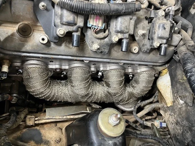

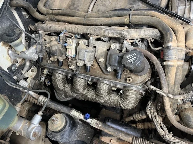

My wrapped headers lasted 10 years but I'm going to cast iron manifolds now. Much neater under hood too. A mate has fabbed up stainless dump pipes out of 2.5 mandrel bend to connect to the old system under floor in front of the cats.

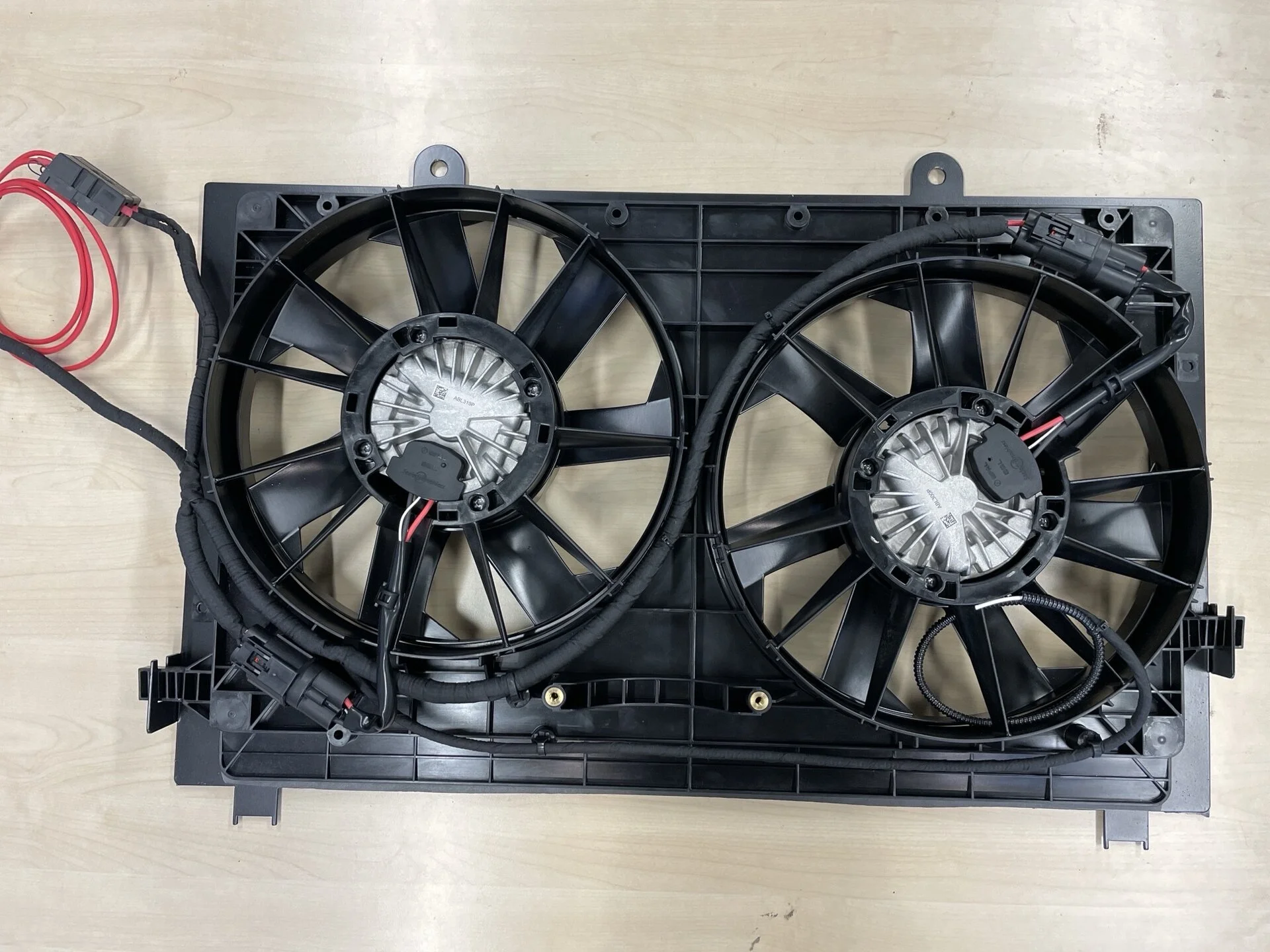

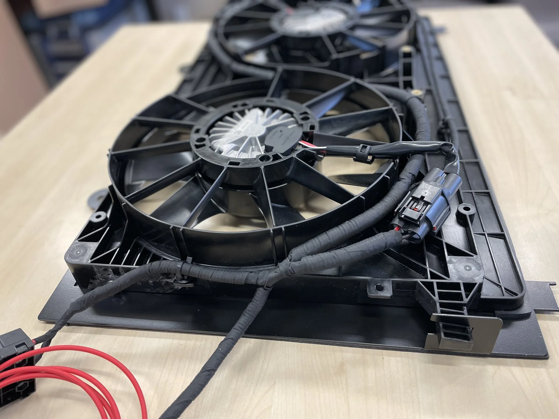

can you please give me the part number for the fans or what was the donor car ?
So that’s a kit that Torfab made for me. Its a custom shroud for the 80 series radiator. It’s not in his website so me makes them to order. About $800 I think.

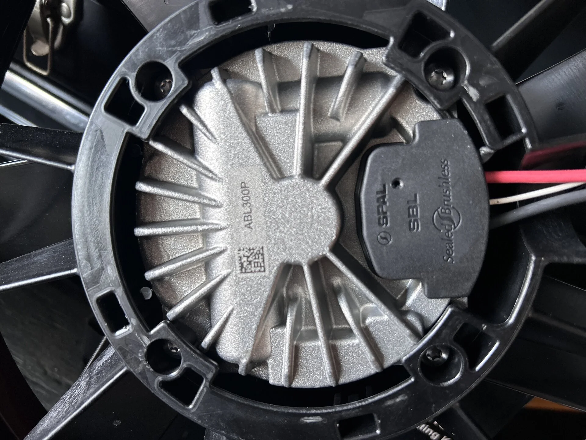

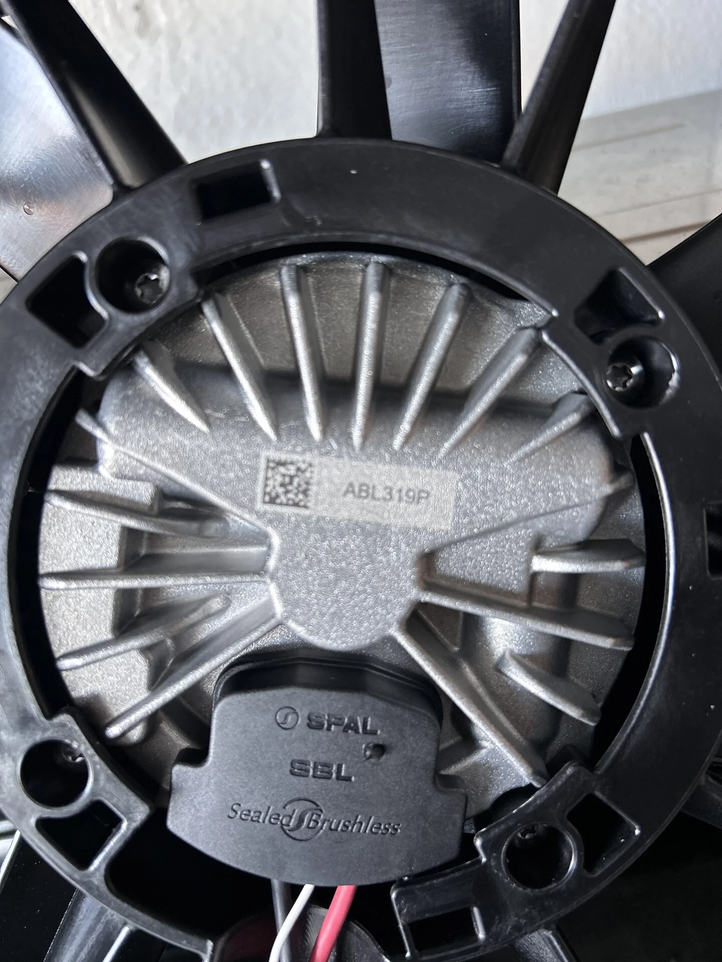

Here are the part numbers from the fans
View attachment 3612019View attachment 3612020
Thank you. Did you figur out how to do aC lines and are you going to use Toyota a/c pressure sensor or you going to add GM ?
The SwapTime harness uses the factory GM AC pressure switch and all it needs to run the compressor is a 12v signal. He includes a labeled wire so that part is easy. On the AC lines I found a guy who does mobile work and he is going to come to the house and make me a set of custom lines using the Toyota and GM ends to mate the two.
Mitch sells the GM pressure switch if it didn’t come on your donor engine.

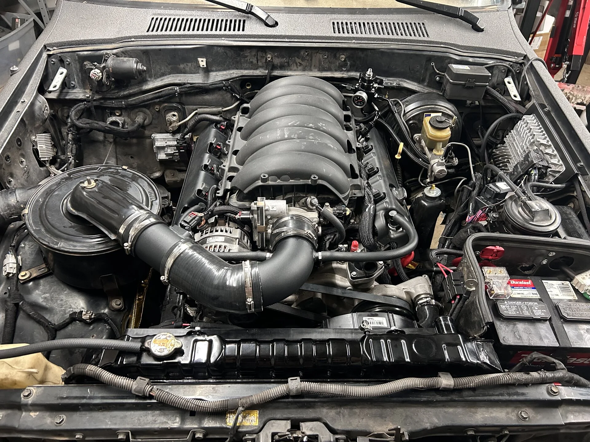

Looks like the swaptime is making this swap really simple. 👍
Looks awesome 😎

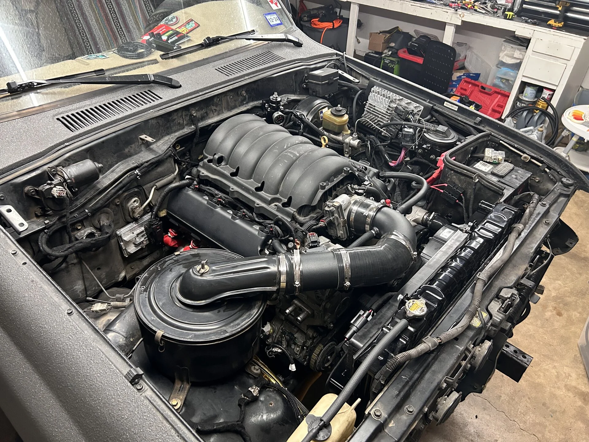

Do you happen to have a picture that shows how you did power steering hose connection? Also charcoal canister where you connected on the engine side ?
Looks awesome 😎
The power steering I just converted to 6AN I’ll try to get some pics. The charcoal canister “vacuum” line I’m T-ing into an oil catch can between the PCV valve and intake.
