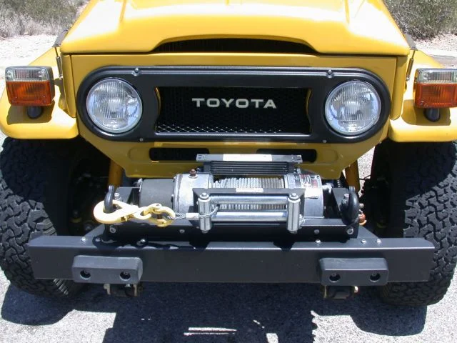

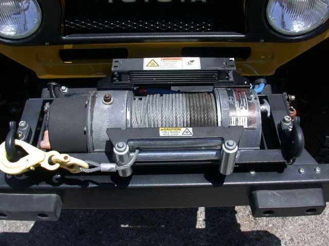

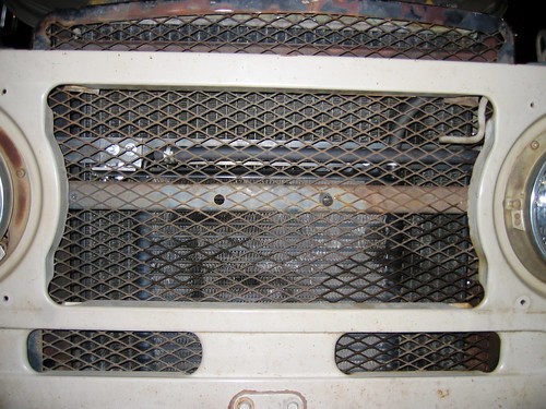

I run Setrab oil & power steering coolers on my rigs. Plenty of sizes available & compact. Got mine from www.bakerprecisionbearings.com .Here's where I mounted mine on the :pig:

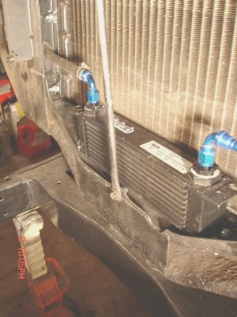

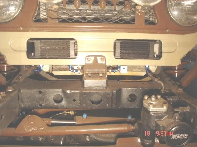

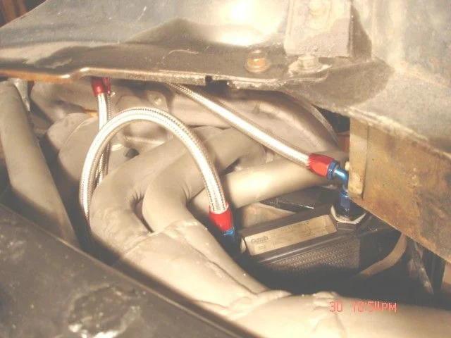

I use a Setrab cooler. Very high quality and performance.
Setrab Coolers

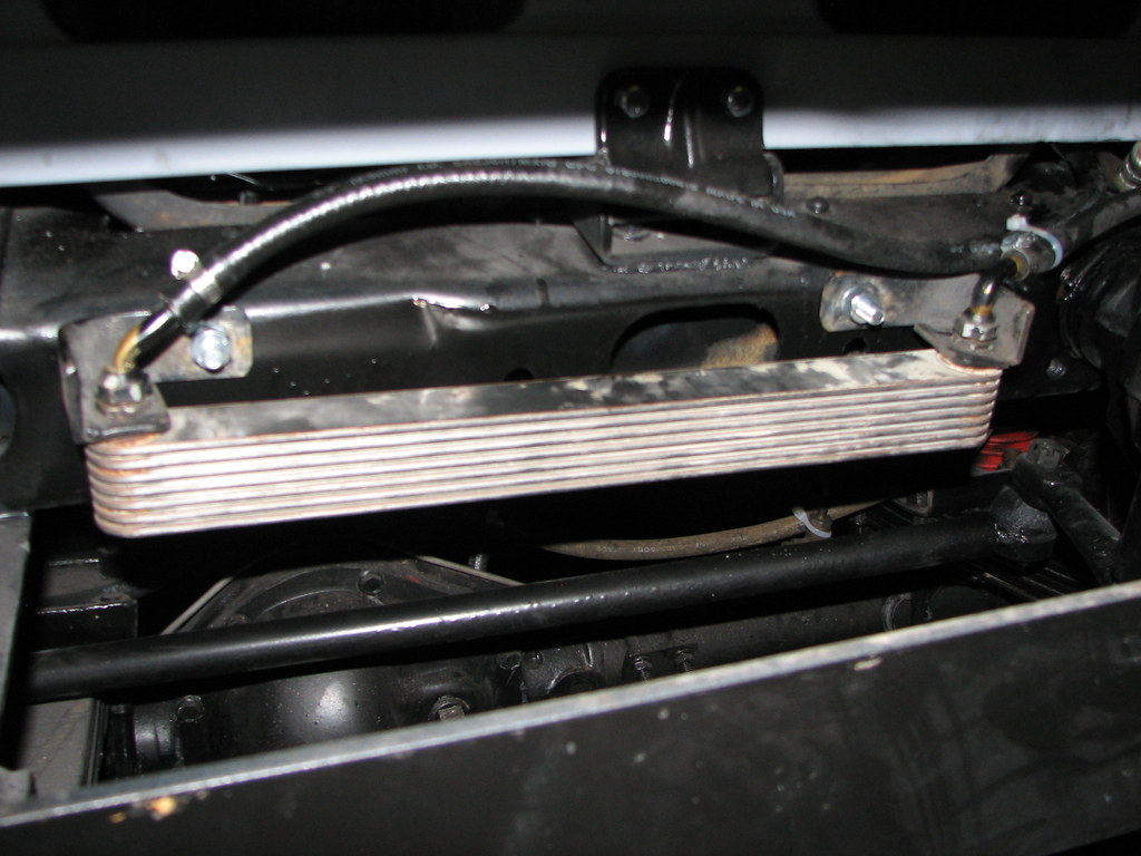

Dude--That's brilliant. I gotta go see if I threw out my old radiator.
Here is mine, I had an old FZJ80 radiator and thought the trans cooler would be useful.
