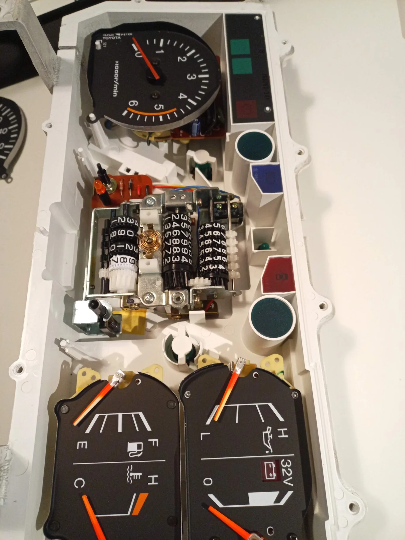

Speedo is rumbling and grumbling, especially in the cold. Time to attempt a fix. But its -20C outside, so I'm starting with the cluster, and its now inside the house. Going to try some tips from @EscapeWagon62 's excellent thread from his 60 series, referenced here:
Also, giant shoutout to whoever suggested two spoons to pull the speedo needle. Can't find the reference now, but it worked brilliantly! SPOON man!
(Yes, the speedo needle wrapped around and snapped off. The piece was resting in the bottom. And no, I wasn't actually going THAT fast).

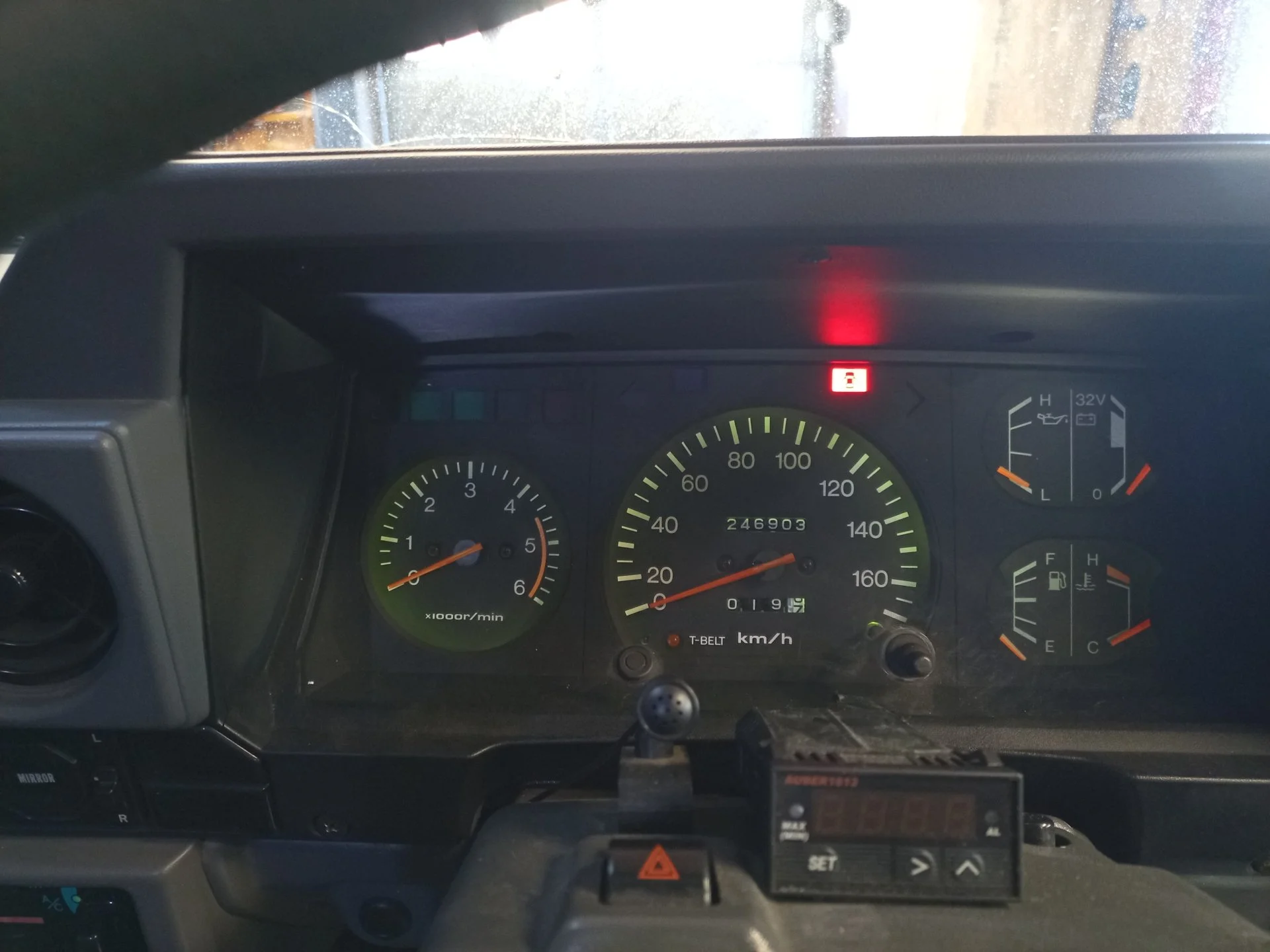

Sunday's drive was quiet at the speedo level, so I cautiously reassembled, and stabbed my re-repaired speedo needle back on again. I'm going to have to look at sourcing one someday methinks. But also found two burned out bulbs which explained why my cluster was a little dim at times.
Much better!
Today I'm hoping to attach the other end of the compressor harness to the switch...
Put some miles on the speedo (with needle reattached) and am happy to report back that so far, jumpiness is gone, and so is the noise. And I managed to get the needle back on correctly, since its still optimistic by 10kmh, and I feel great that I'm "going the speed limit" unless someone's following me and bursts my illusion over the radio. :)

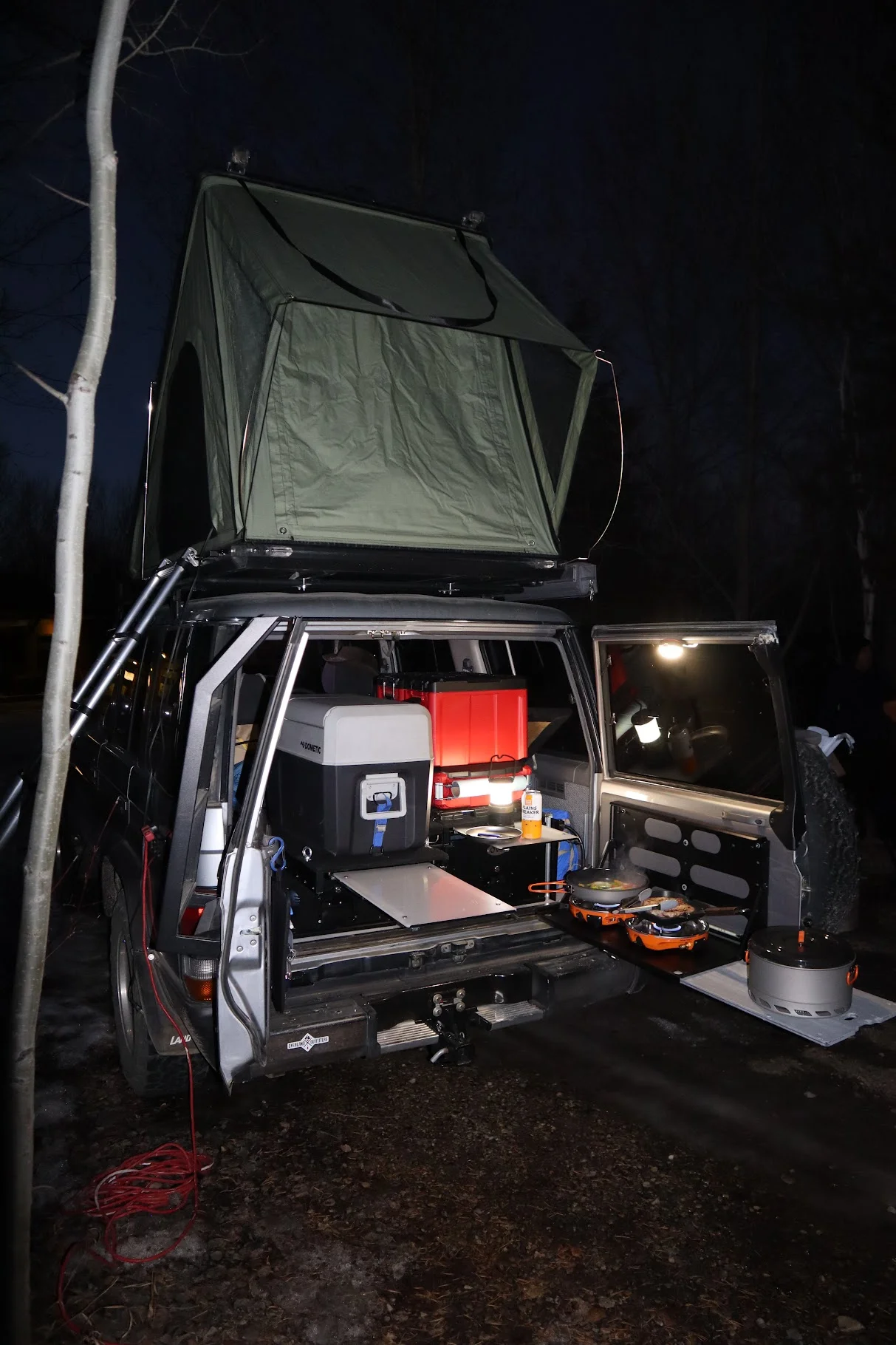

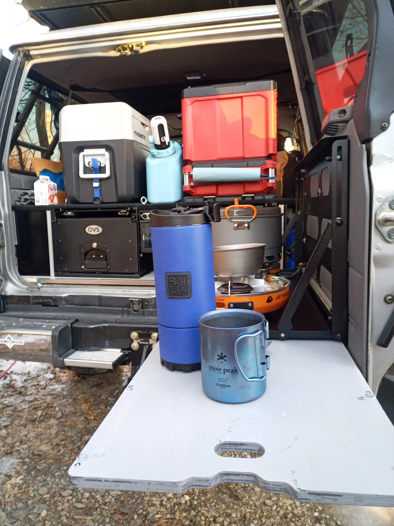

Got a chance to try out my ever evolving kitchen and storage setup last weekend too, and its starting to feel like I'm getting there...
Looking pretty posh there Phil, nice setup, and glad it is working out well for you! I really like thems milwaukee lego containers from the depot. I have made a mental note of them for when I am done moving and will start working on the trailer again in the spring. Happy you are getting out! 👍

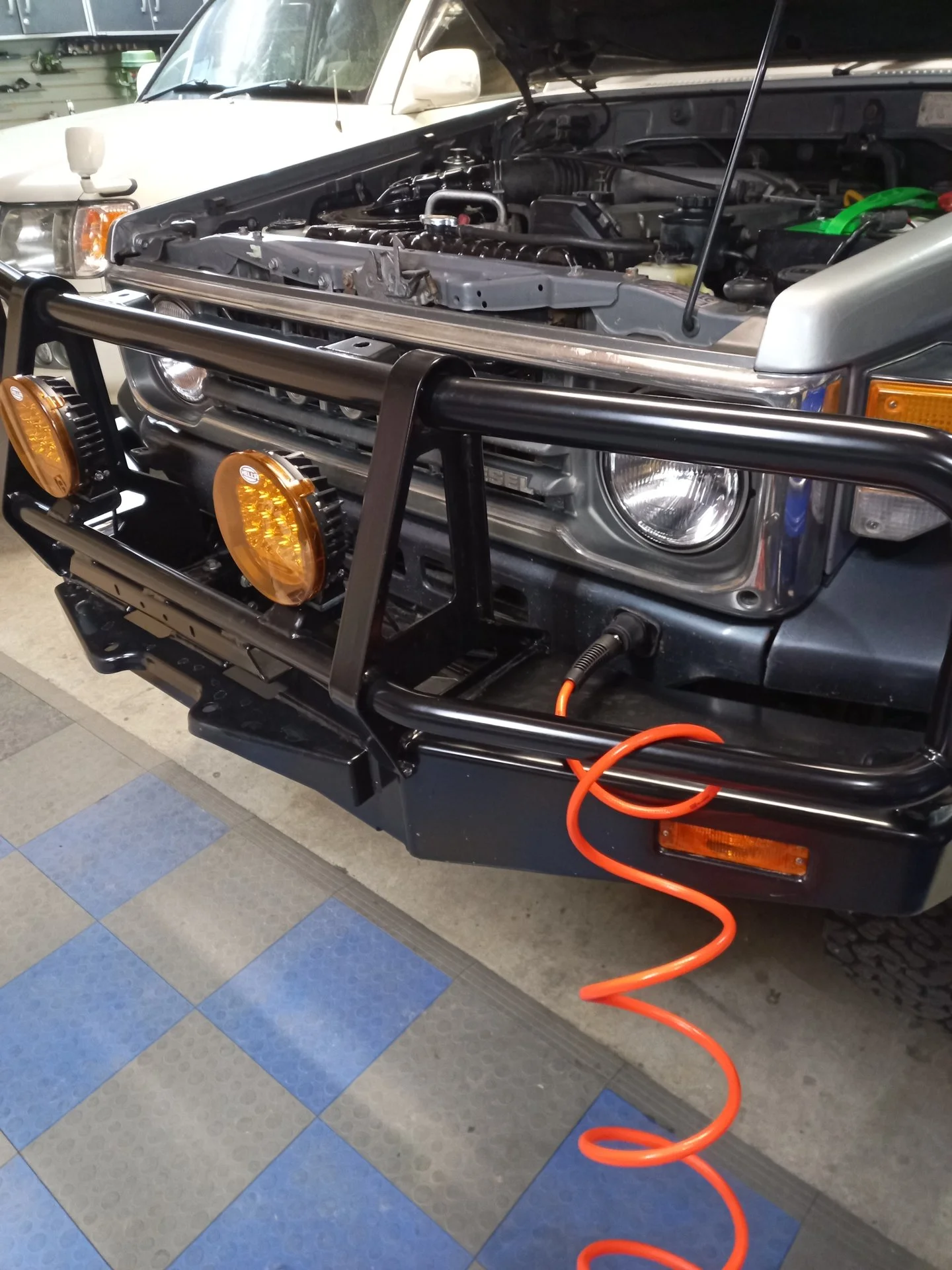

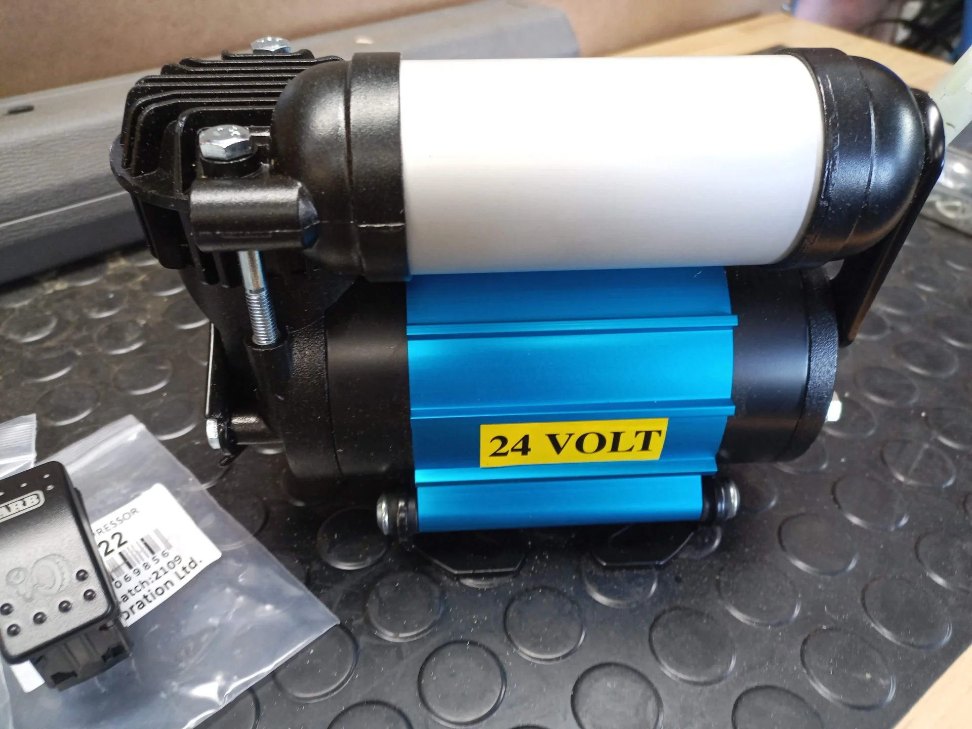

Hooked up and finished off the ARB compressor install today. Used an elbow and a short length of hose to plumb the quick connect through the lower valence in place of a headlight washer.
Couldn't get it to work at first. Rechecked everything and realized I had reversed two wires on the through the firewall harness (you put the plug together after you poke it through). Fixed that and still nothing. Of course the reversed wires had blown the 5.amp fuse in the harness. Once I figured that out, it worked like a charm. Chased down a few leaks and now it holds pressure indefinitely.
I am redoing the cigarette plug on the dash so it's switched 12 v from the rear battery, so I used the 24v (ignition switched) power to fire the compressor relay. And while I was there, I used the outlet's light lead to light the new ARB switch.
Edit: I did buy the ARB air up kit. The quick connect alone was worth it, and a nice airline too.

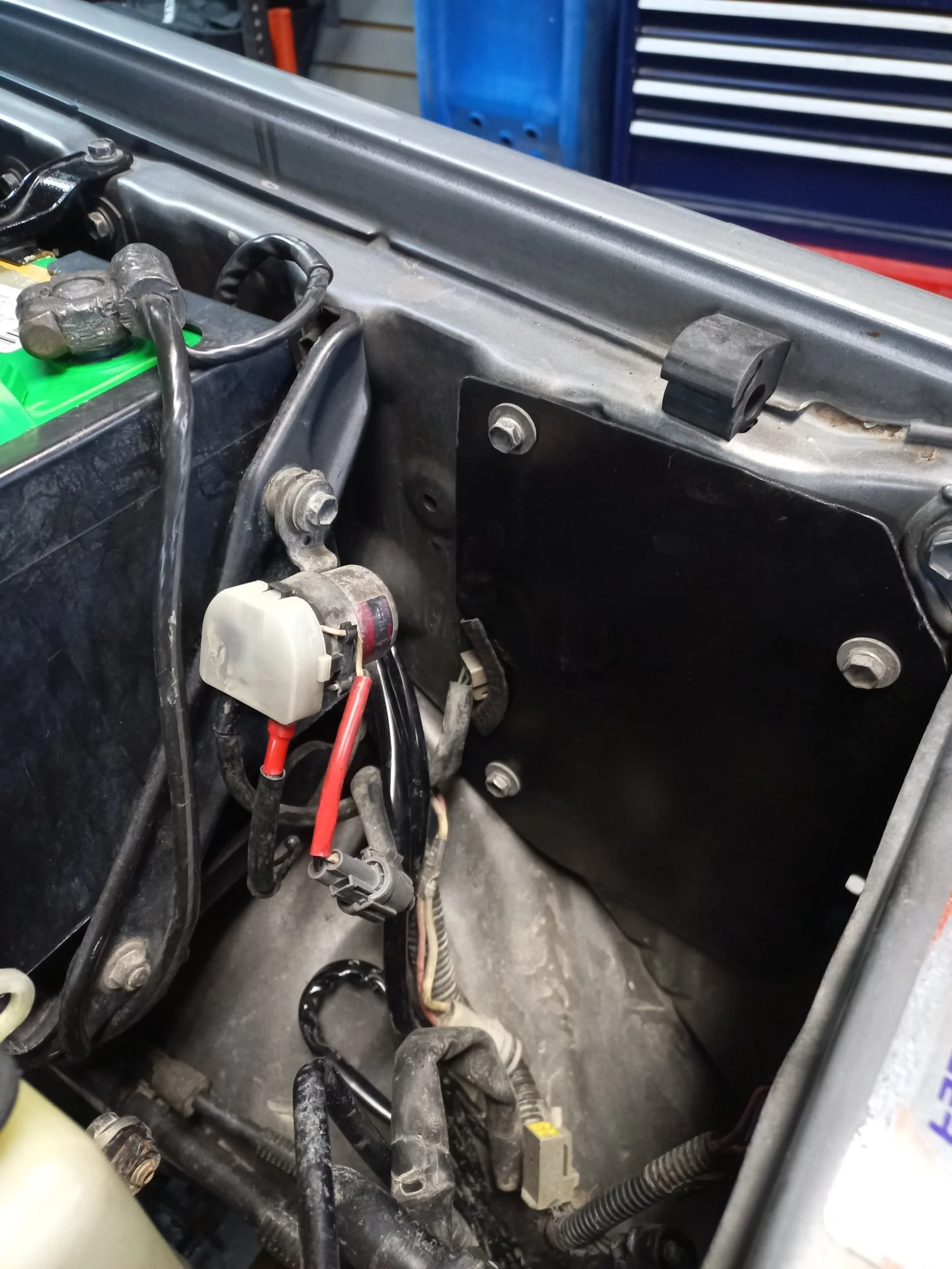

Just a few notes on the 24volt hookup:
Pay careful attention to your battery positions, and note which battery is "1" and which is "2" according to the instructions. The 12v and 24v hookup sequence is side by side in the supplied literature. There are some differences.
ARB supplies a nice sealed harness, but there is some bulk to it, so be prepared to deal with the excess. The fender cavity behind the batteries is as good a place as any.
Also, the relay is looking for 24volts to switch it on - tapping the in dash cigar socket is a simple source for ignition switched power. I used the socket's light circuit to light the switch too, so it lights up with the rest of the switches when the lights are switched on.
