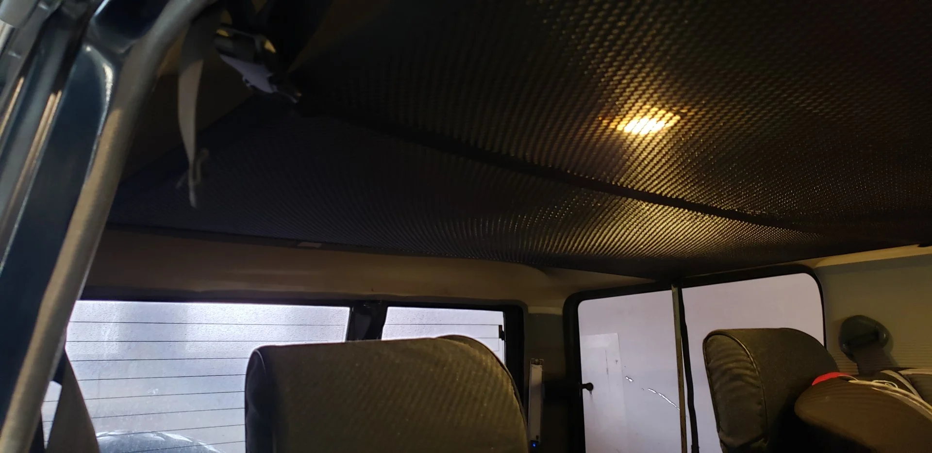

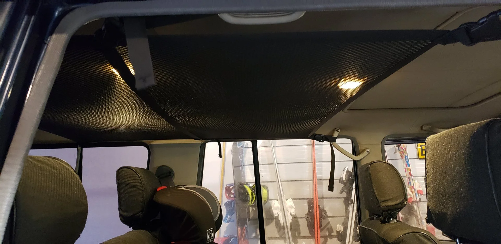

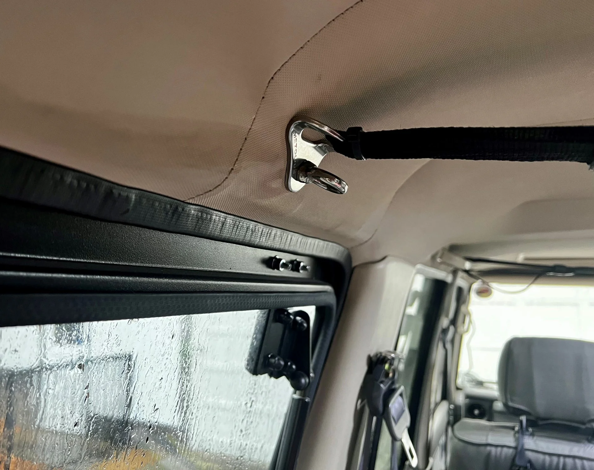

That'd be great. I'd also love to see how you attached the net. That was the trickiest part for me.
Milwaukee packout is available at Home Depot - you got it. Specific configurations will possibly need to be ordered but plenty of sizes are available. They are quite pricey, but having them in hand, I think they're worth it? That's subjective I guess?
Cool thanks. I was kicking around the cruiser today trying to sort out the two tiny t2 like bulbs in the dash for the heater control unit and ashtray and found a dewalt tool kit that is similar and connects to others similar to itself. I suspect same concept and will look closer at it.
As for the net, i snapped a couple pics. I really like the rock bolt idea as well but find my net works to cover approx 60 percent of the roof and any more would be a hinderance.
As suggested, i also have fly rod holders that i substitue that are made of webbing to go in place of said net when appropriate.

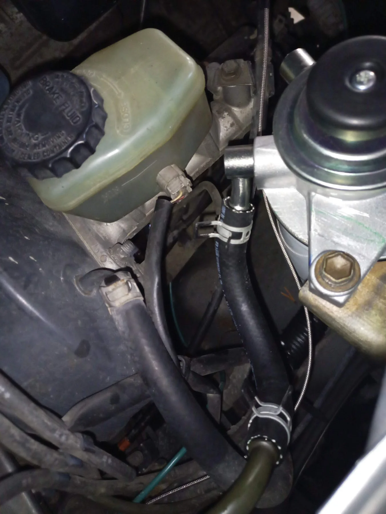

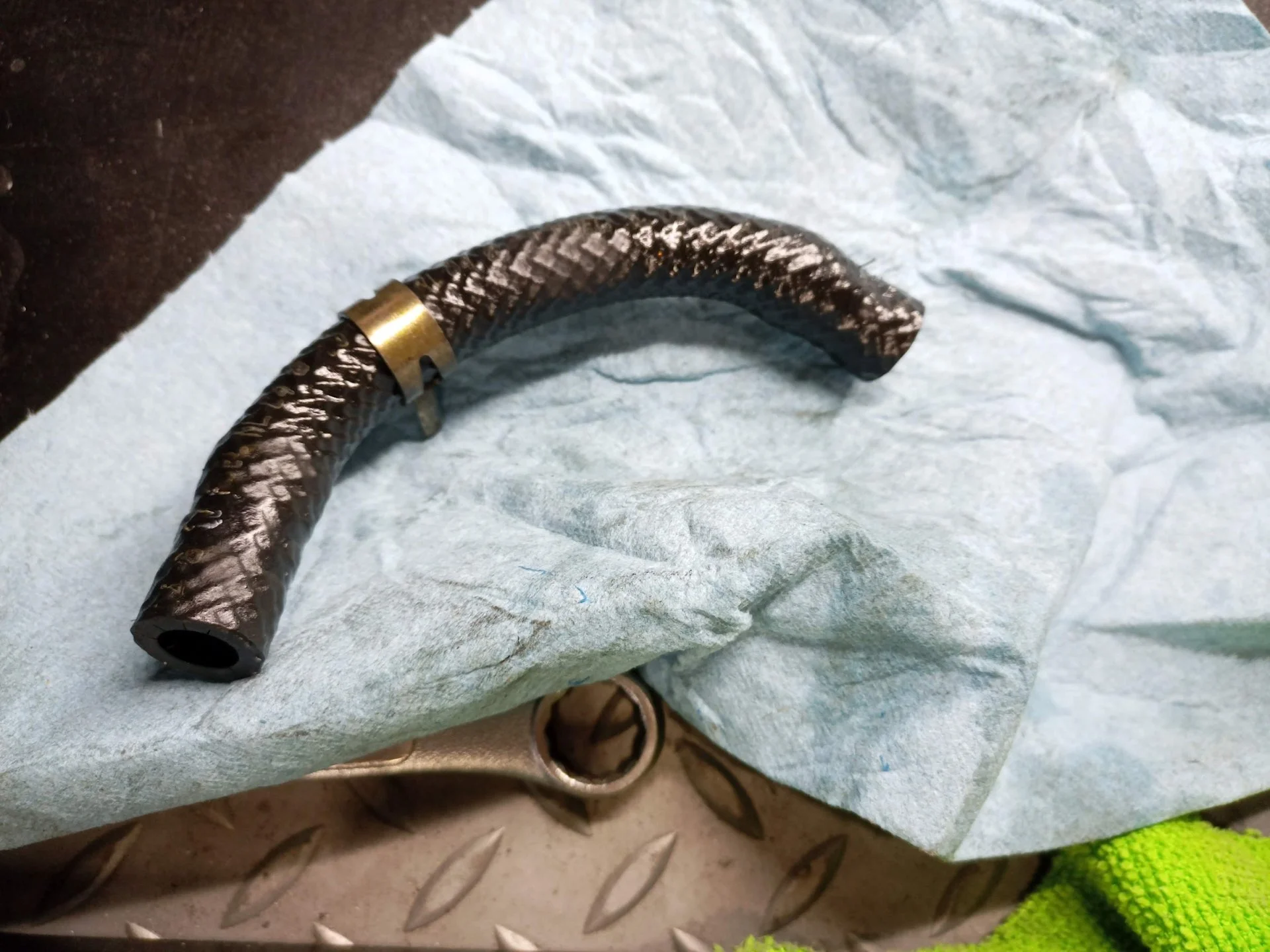

Well, I spoke too soon, AGAIN. Today a cold start took a few extra cranks, then smoke. A drive revealed the same old thing - hesitation above about 2k rpm, and white smoke. I only took it around the block, and then brought it home. The short hose from the filter to the hard line looked a bit suspect. Perhaps its sucking air in over night?
I replaced this one with new hose and new clamps.

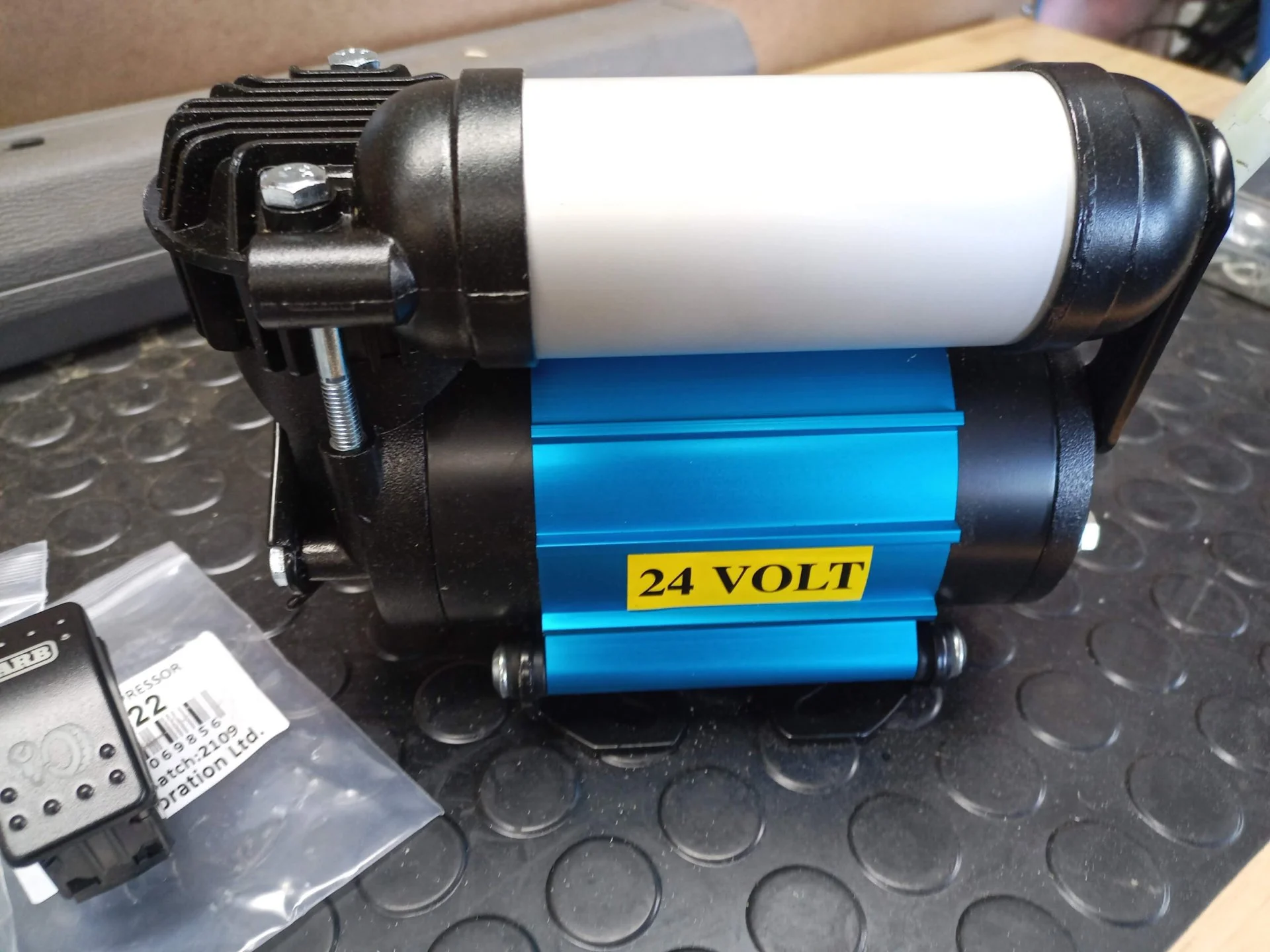

So, back to fun stuff! Moving to the front for a change. After being back ordered since boxing day, my new compressor finally arrived.
It is the CKMA24 model, which is faster due to the yellow sticker.

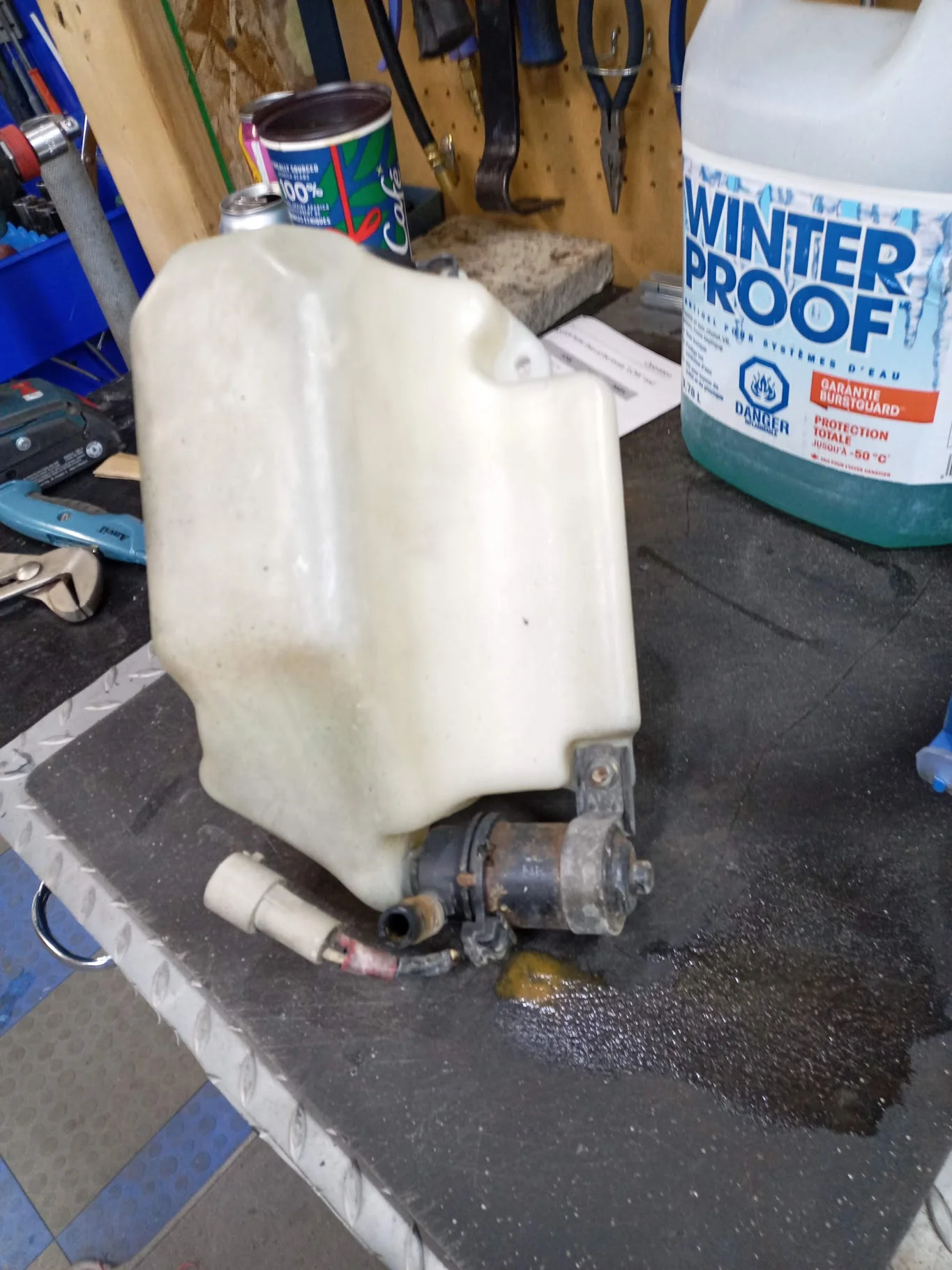

My headlight washers have been non-op since I got the truck, and my winter/wet drives are few and far between, so out came the jug/pump, and it looks to be a nice place to mount the compressor. Protected behind the headlight, away from the exhaust heat, and there's a wall with factory captive nuts to use where the HL-washer jug just vacated...
CAD template first (cardboard aided design)

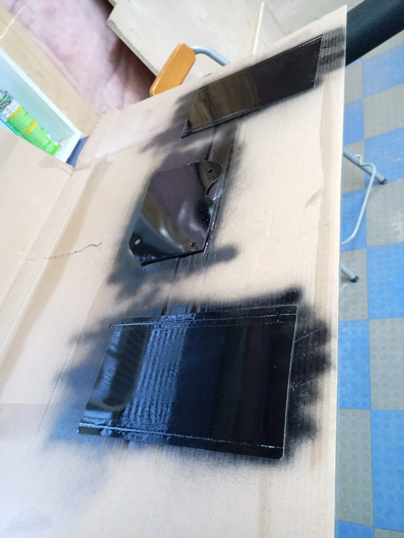

Then it was time to precisely shape and mould some exotic materials into a custom damped compressor mounting base. But I got lazy, and put the grinder to some steel sheet... Here it is, temporarily bolted in place. More massaging needed in this pic. And of course holes to mount the compressor base to it.
Then onto the paint booth... er... table. (about time to spray the vertical pieces for my rear cargo area too, so they joined the party.)

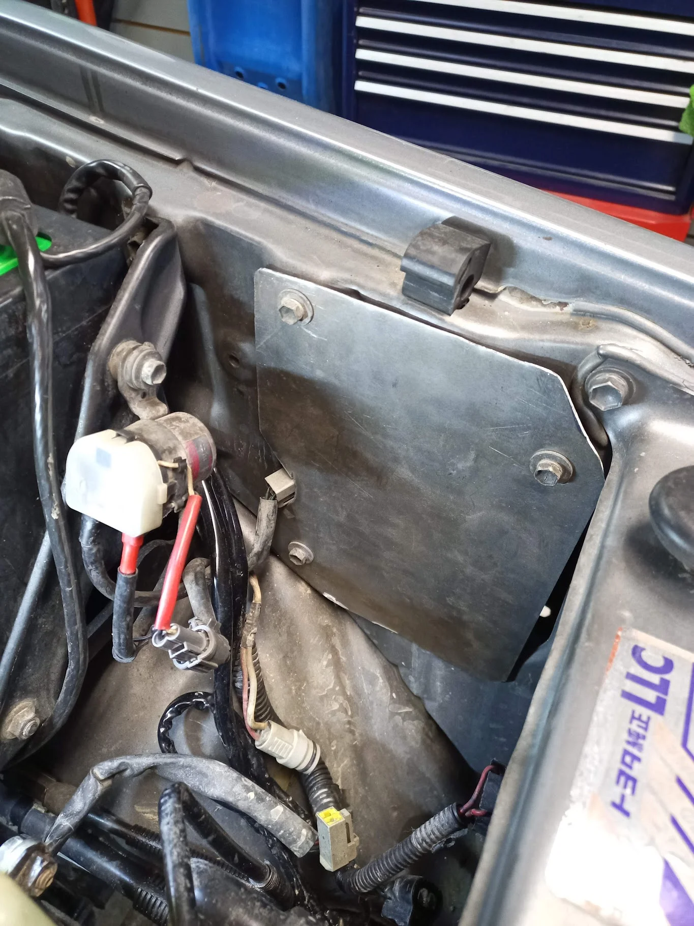

While the paint was drying, I attempted to discern what those crazy Aussies had cooked up with that wiring harness. Man alive. Having parts of the air locker harness branching off here and there made it more complicated than my application demanded, but someday...? Anyways, once I deciphered the 24 volt hookup witchcraft, I put all the wires temporarily in their proper places, threw the switch, and managed to get the compressor to make some noise. It even hissed at me! Saucy thing!
Next step will be running fat wires through tiny orifices, and making a home for the switch, in the center console. But at least I've got a good idea how to put it all together now, and it should be pretty easy to bolt to my mounting plate. Then I just need to decide how to route the air line. I'd like to be able to access the quick connect without raising the hood, but we'll see.

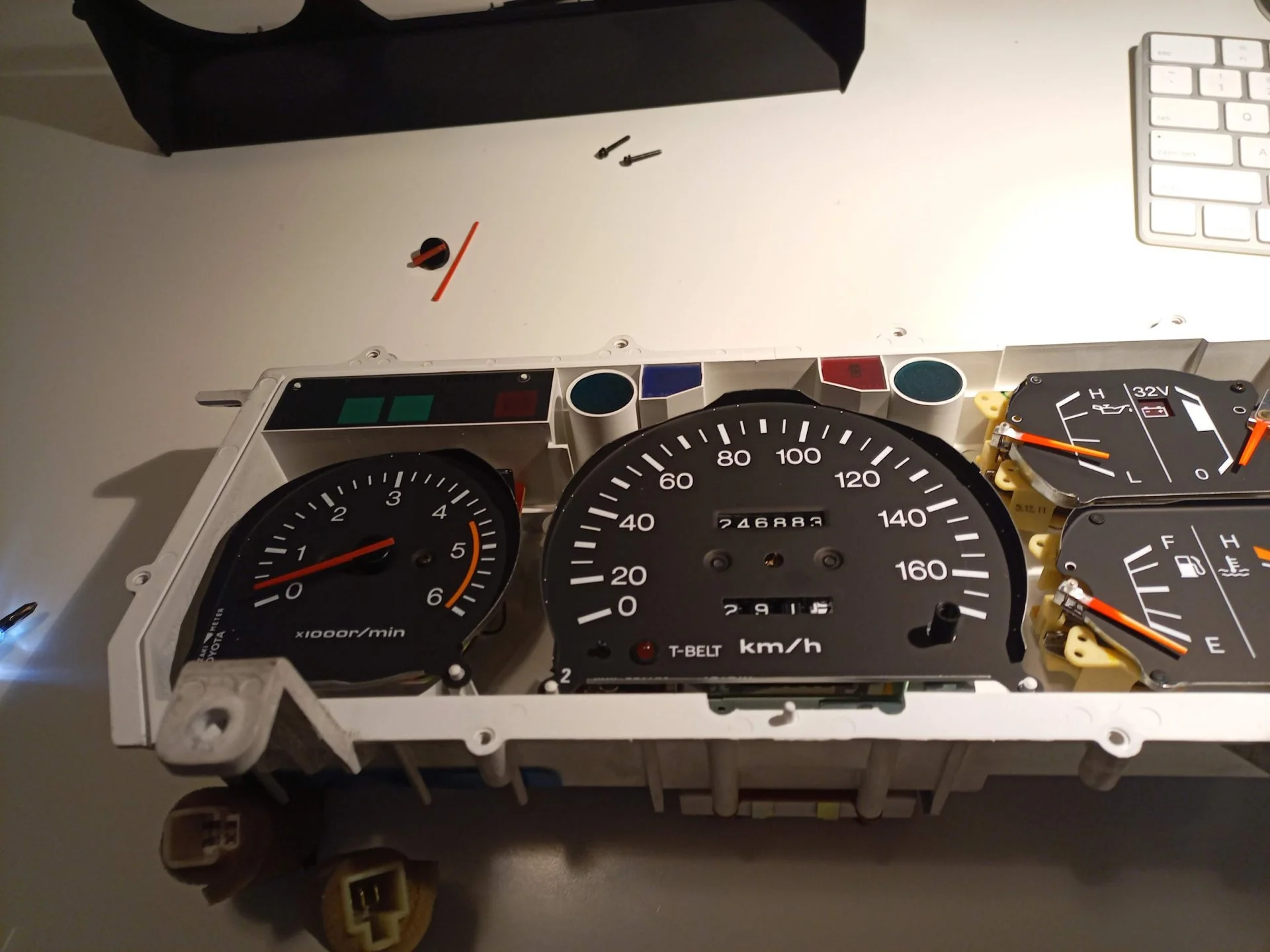

Speedo is rumbling and grumbling, especially in the cold. Time to attempt a fix. But its -20C outside, so I'm starting with the cluster, and its now inside the house. Going to try some tips from @EscapeWagon62 's excellent thread from his 60 series, referenced here:
Also, giant shoutout to whoever suggested two spoons to pull the speedo needle. Can't find the reference now, but it worked brilliantly! SPOON man!
(Yes, the speedo needle wrapped around and snapped off. The piece was resting in the bottom. And no, I wasn't actually going THAT fast).
EDIT: @coldtaco spoons FTW! Thanks again!

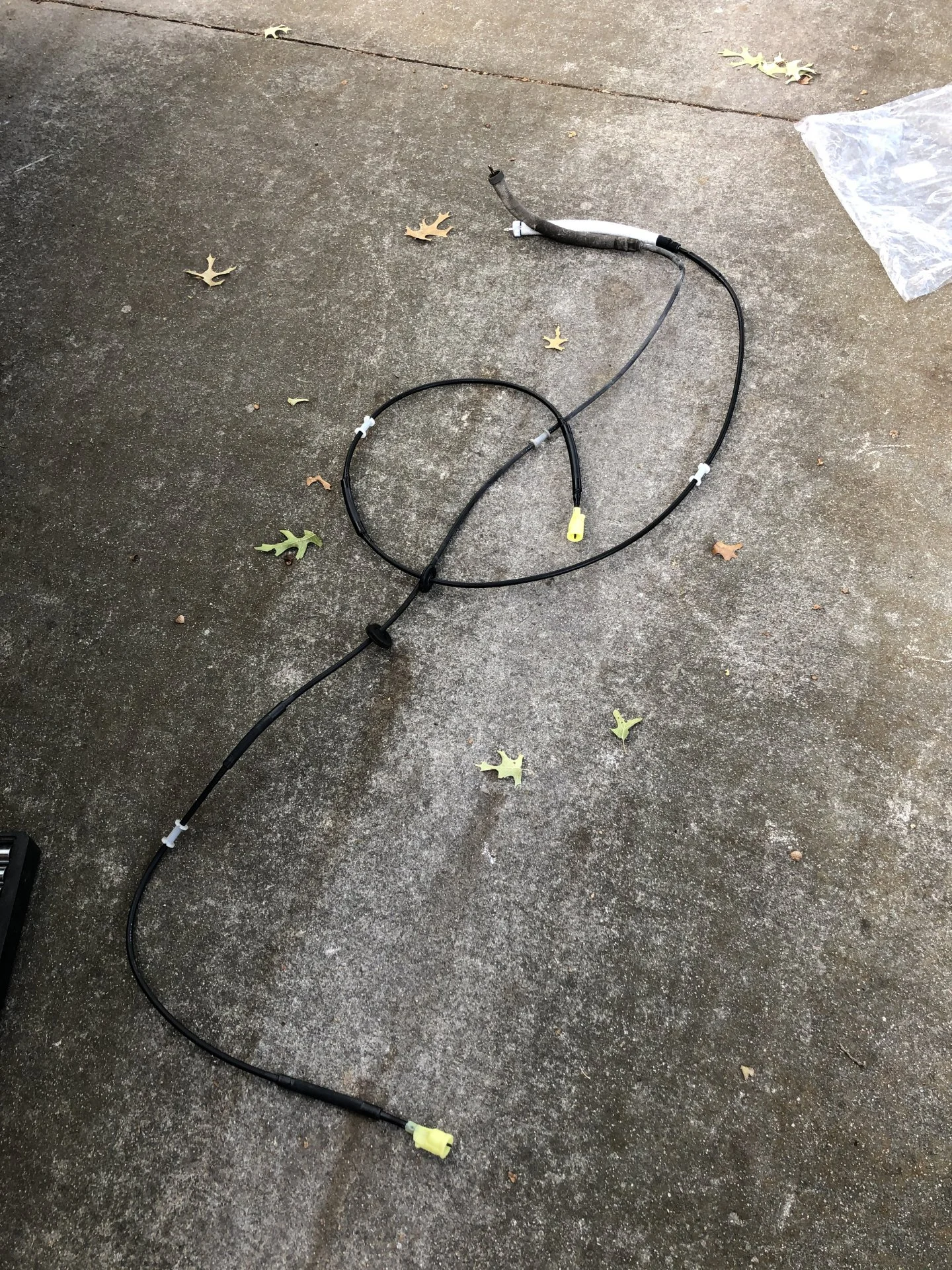

My speedometer has been complaining about the cold too, but I'm pretty sure (perhaps just hopeful?) most of the noise is coming from the cable down along the transmission tunnel. I tried lubricating it with an 18-ga needle oiler but was unsuccessful; the cable really needs to be removed to properly lube it. Really hoping I don't have to tear into my cluster, but if I do I'll know where to come for info. Best of luck fixing it!
I had a jumpy needle with a lot of noise in my HZJ77. Replacing the speedometer cable that goes from the transmission to the cluster with a new OEM cable fixed the problem. Not a fun job.
