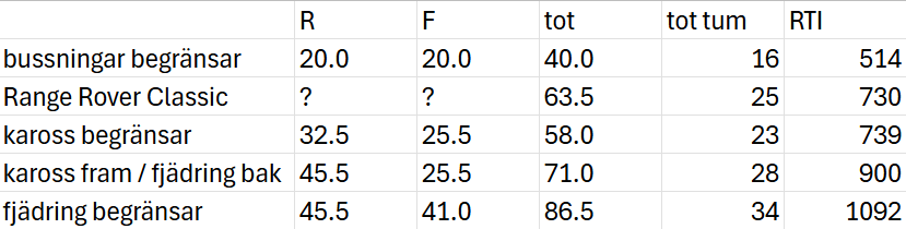

In my quest to get as much suspension travel as possible I've also achieved a lot of theoretical articulation. I put together some numbers in a chart and ran them through a ramp travel index calculator:
I don't know how much sense it makes when you don't know Swedish and isn't the one who made it. Ask if you're curious, I started explaining each one but that would've ended up long enough to qualify as a novel.
