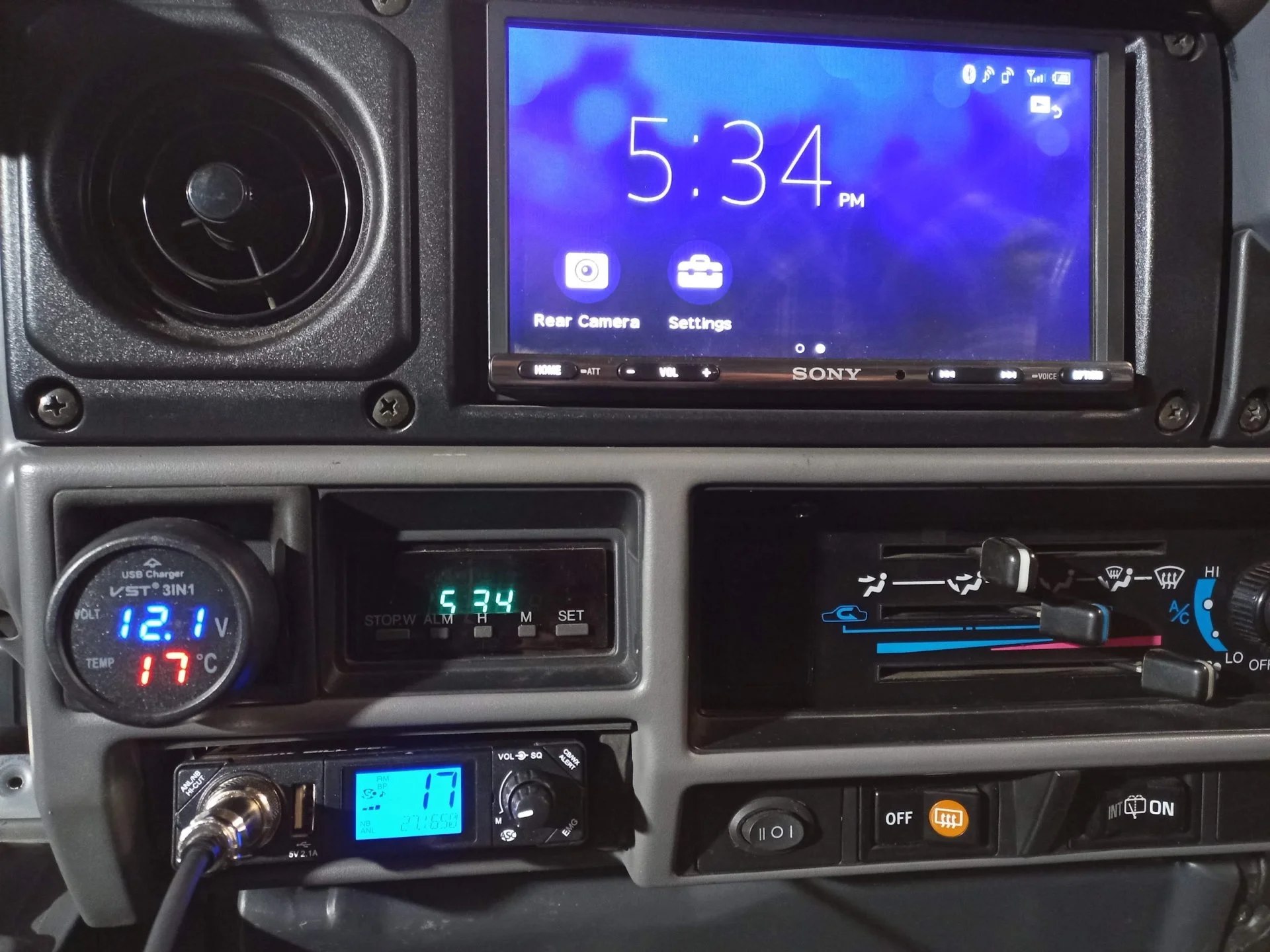

Sometimes 24 volts messes with my head. But today was a day to confirm that what I had mapped out in that messed up head would work.
My goal was to power my CB (yes, I know, but there are guys in my group that still run them, and its a tiny unit) and the 12v socket in the dash via my rear battery. This would be easy except I wanted it switched, so it wouldn't stay on when the key was out. So here's what I did:
1. Disconnected the cigarette lighter socket. Use the switched power instead to open a 24 volt relay (pin 30)
2. Hooked the CB and (now powerless) socket to pin 87 on the relay
3. Sent a fused connection on my rear 12v battery to pin 30.
4. Grounded the relay at 86.
I figured a 24volt relay would be appropriate, since the 24v power source was what I was using to open and close. The rest is simply passed through. At least that was my theory.

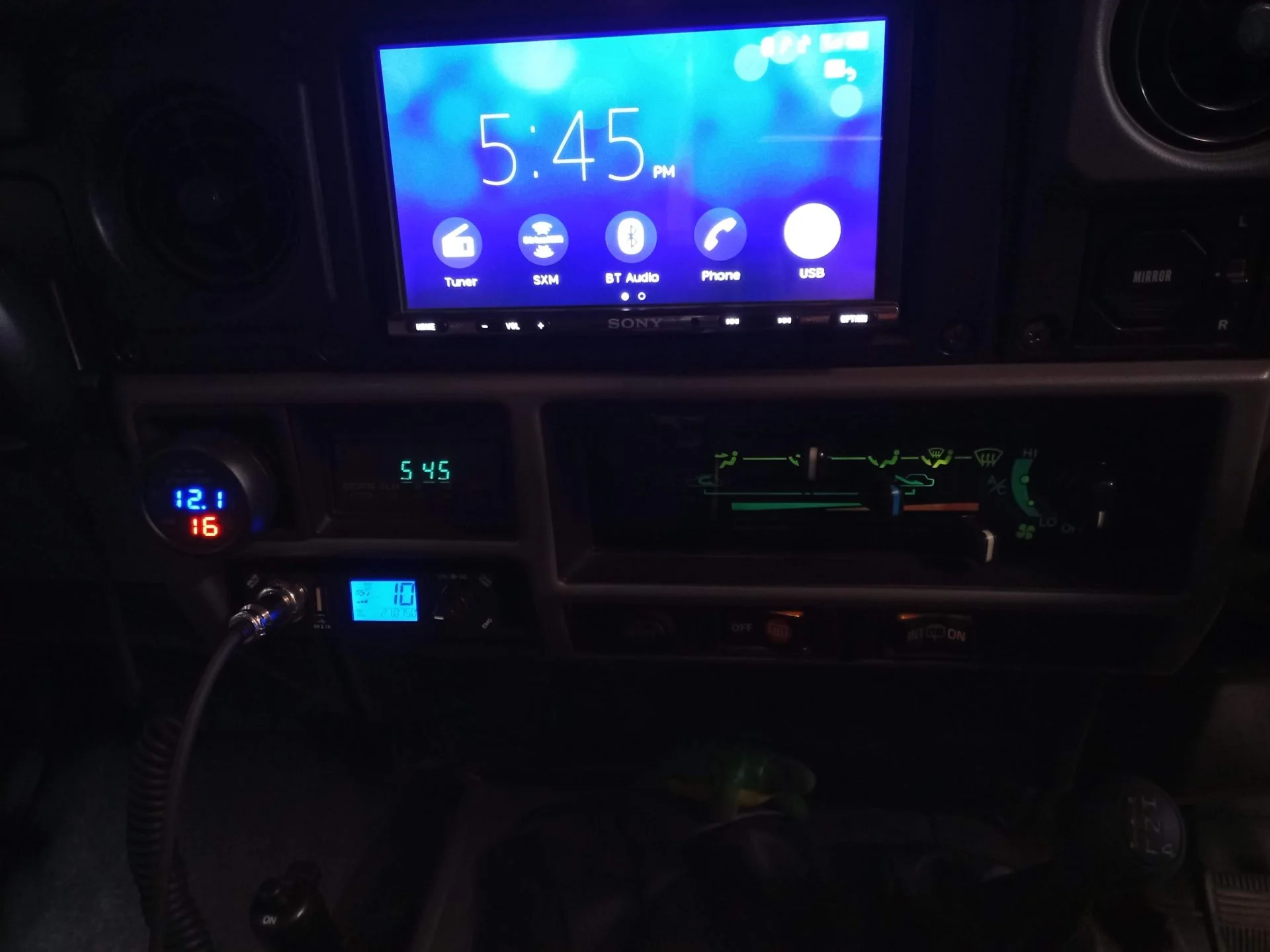

The result, with key on:
My tiny "President Bill" CB (occupying what used to be the ashtray) powers up, and my heretofore 24 volt socket now reflects the state of charge in the rear battery, plus the cabin temperature, plus a USB outlet. (Yes, my rear battery is getting low - its been on its own for a long time. Soon it will be getting some love from a 24->12v converter).
So I'd call this a win. Except I better not take up smoking.

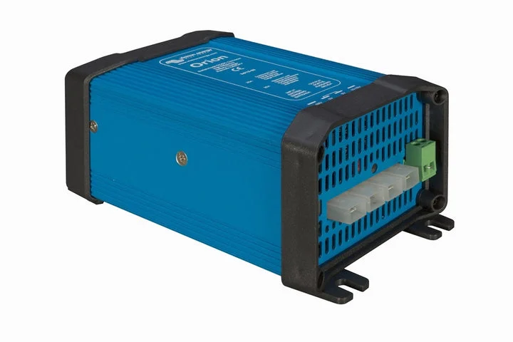

I'm curious, what's the exact type of your Victron charger, please?
Cheers Ralf
Yeah, I'm not a great welder at the best of time, so I'd rather avoid any impromptu sessions. LOL.
Here's my unit:
Volts.ca link to Victron Orion 24/12-25A dc to dc
I do wish it had a more heavy duty terminal style lug hookup, but at least it's compact, and for 10 gauge wire is perfectly adequate. Let's call this a light duty setup, and it will be viewed and used as such. I don't really want to pull any more away from the stock charging system than is absolutely necessary. Once I pony up for some flexible solar panels, this thing should be a much less prominent member of the system.

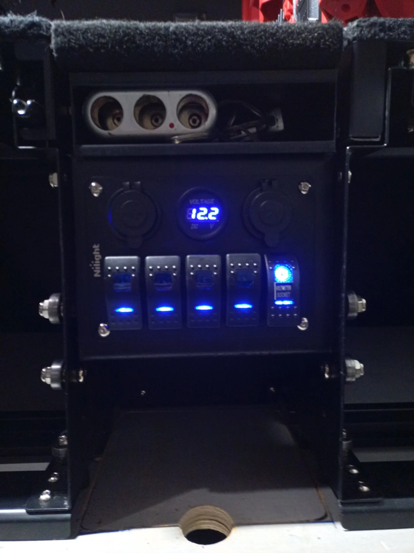

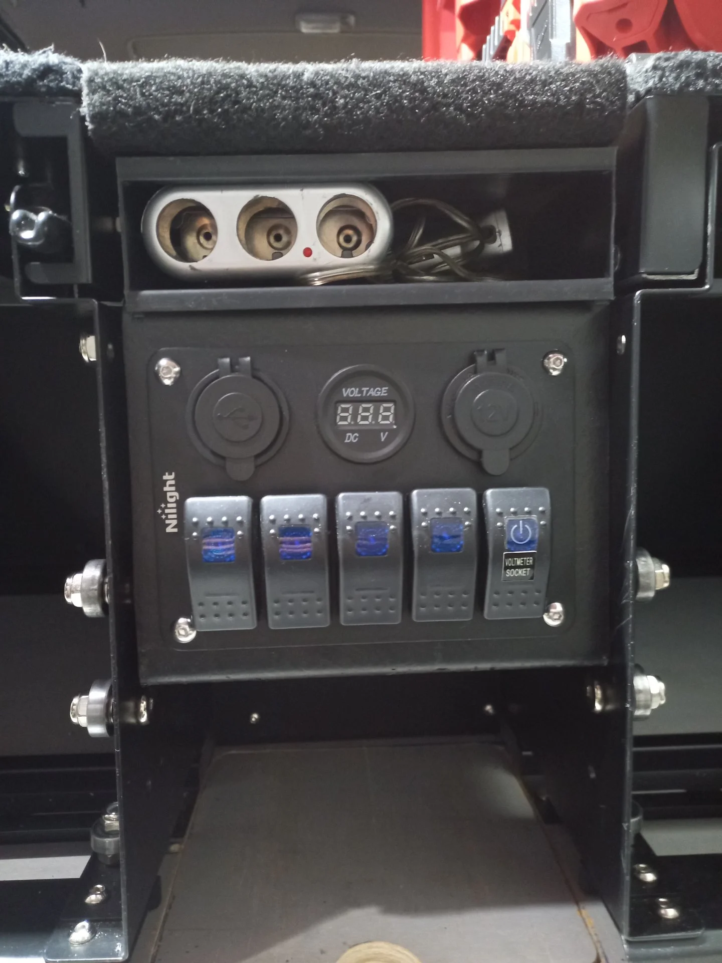

1. The switch panel at the back... This is sitting between the two drawers, and the top lifts up to access the electrical goodies (ignore the multi socket 12v plug in the pocket - just stored there). This is the switch panel in its "off" state, such as when the truck is parked for a while.
I hooked this up so that the right-most switch turns on the voltmeter, usb socket, and 12v socket, as well as the resting LEDs in the switches.
Like this:

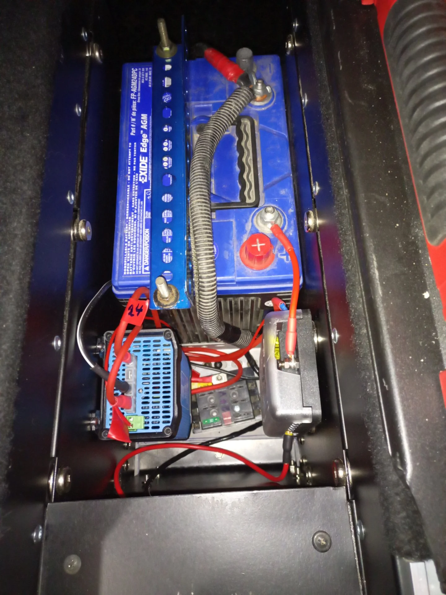

Time to look under the cover.
Okay, admittedly there are few circuits yet, but lots of room for expansion.
LHS has the 24->12v converter. On the deck is the small 24v fuse panel. RHS hosts a larger 12v fuse panel.
Any wire coming in that is 24v is labelled such. Just in case. Probably didn't need the 24v fuse panel, but it doesn't hurt. The 12v panel is a 12 gang, and allows for grounding as well.
I still have some more circuits to add, but for now I'm happy with the setup. It'll be nice to be able to finally charge up the AGM Exide again, without having to put it on the charger when I get home.

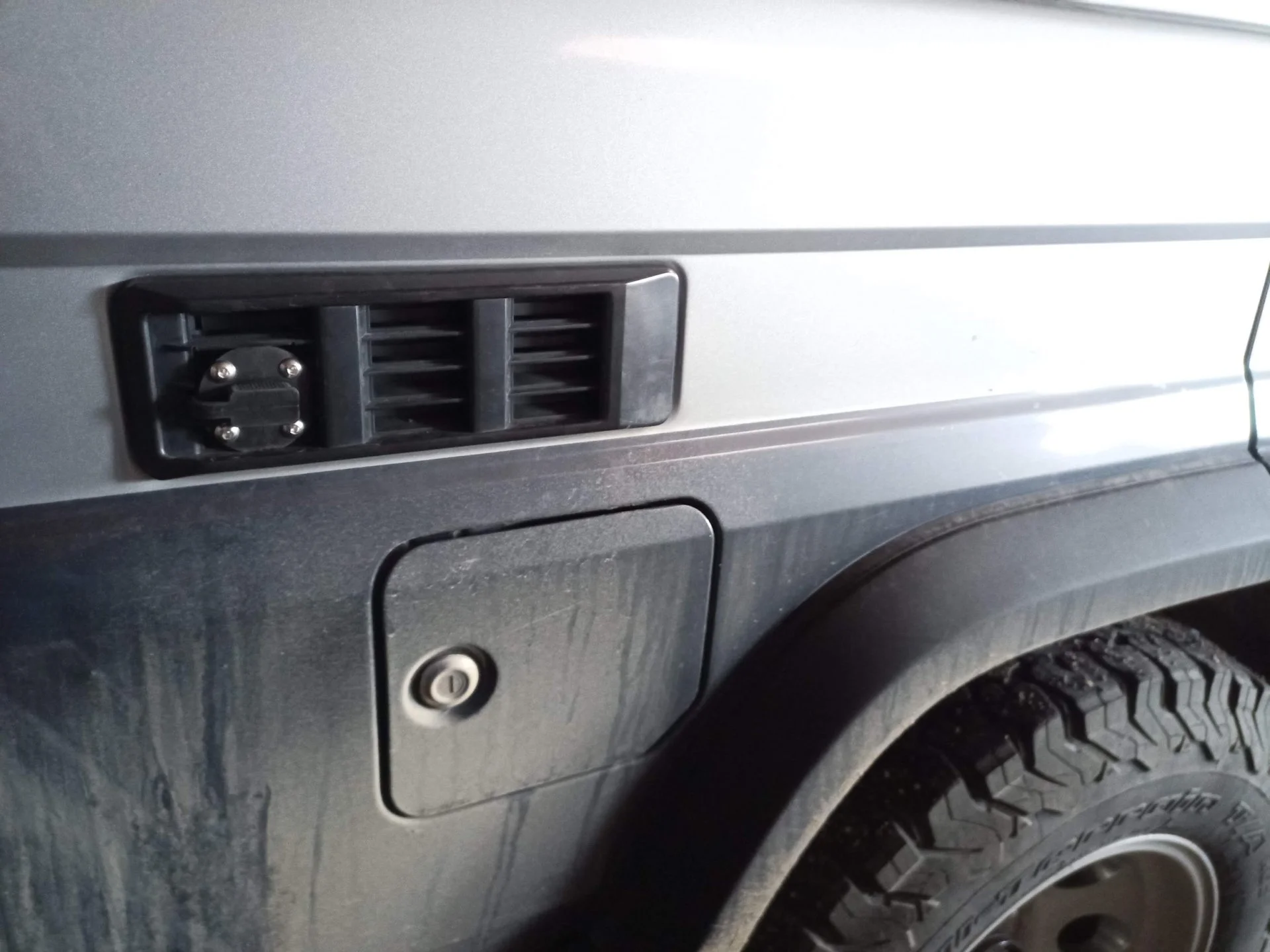

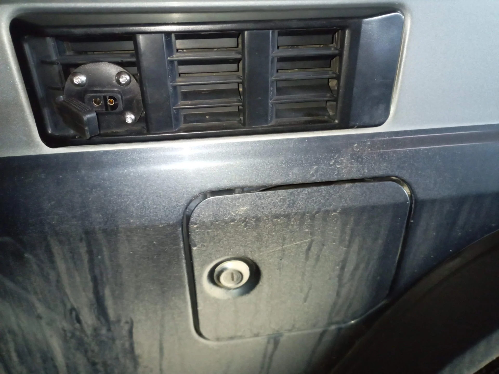

In the same electrical vicinity, I made a cheap/dirty 12v power access port today. I'm almost embarrassed to show it here, given the other options I've seen, but mine cost under 15 dollars, so I guess it has something going for it? I pulled the exterior vent louvre/grill thingy, and (after confirming that they are still avail new) I did some trimming with my dremel to the point where I could route an SAE port in through the vent. Used a hose clamp on the back side to keep it secure, and routed the wires under the trim and down inside and out at the bottom by the carpet, where it can snake under the drawer and join the party at the fuse box. I'll probably switch this one too, so I can turn the awning lights or rooftop tent power on and off easily. But here's how it looks. Not super pretty, but functional, and the way the wire is routed, the vent should remain 100% factory functional...
Yes truck is dirty dirty...
That's a great idea. An Anderson Powerpole outlet would be another good option there depending on one's preferred connector.
For now I only need this to power my awning lights and a usb up to the RTT, so very little draw overall. But I'll see how it goes. I do like how little the intrusion is with an SAE plug.

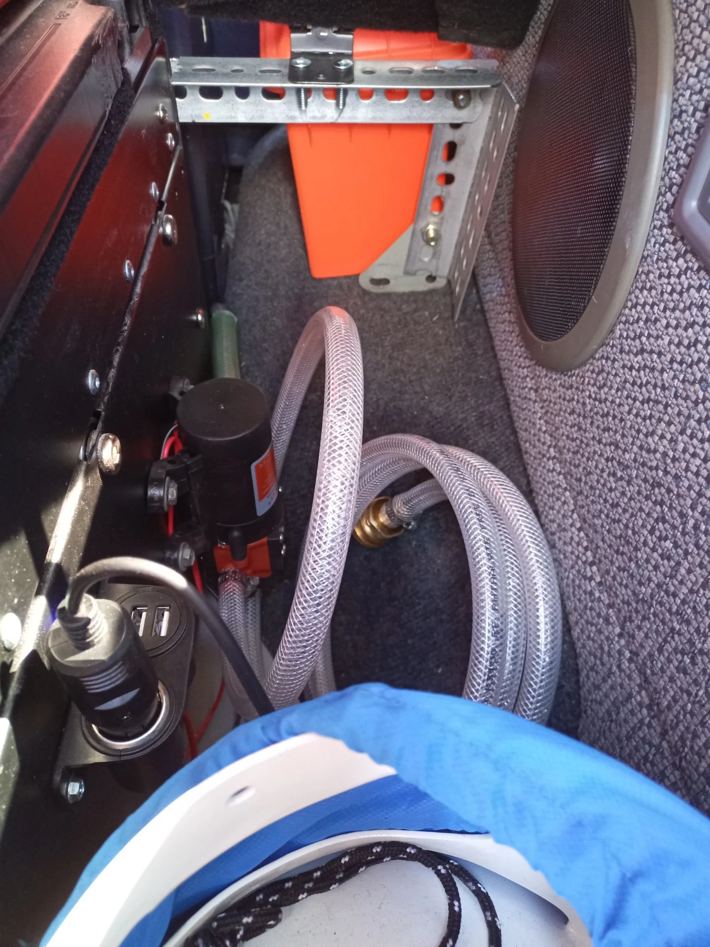

I did get back to some mods this week, and finally installed my water pump. Here's a sneak peek...
