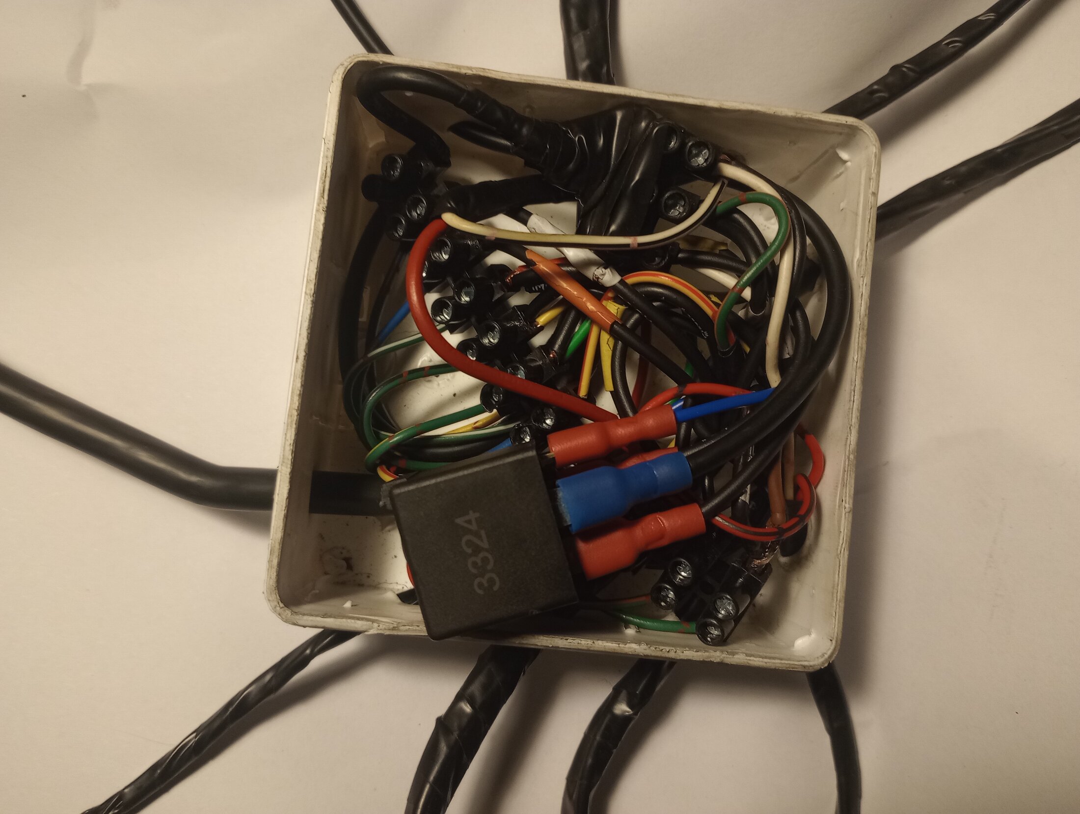

The old loom with all tape removed. I had several reasons to remake it: some wires were broken, I can't reuse the rear light plugs and the trailer plug was very badly installed.
Got the pins figured out (hopefully correctly).
And put all connections in an ip65 box with individual wires to everything. The relay is for the trailer fog light, in case I use the pin for something that uses more power than a 21w bulb, like halogen work lights or charging a caravan battery.
I then tried to double check the pins by checking for voltage on the plug on the car, but turns out neither of the ground pins are actually connected to ground. So, I get to chase loose contacts behind the dash tomorrow. How fun...
Apparently there's a ground in the rear loom that I had forgotten I had cut off, and the two ground pins are for grounding stuff along the loom from the dash to the back. So, I added a ground, temporarily installed it and somehow everything works as it should. In fact, everything I've been able to test except the headlight washer, glow plugs and the dash lighting (possibly, might also just have been too bright outside for me to notice it) have worked perfectly. I still have to test the trailer plug, rear door stuff and reverse lights.

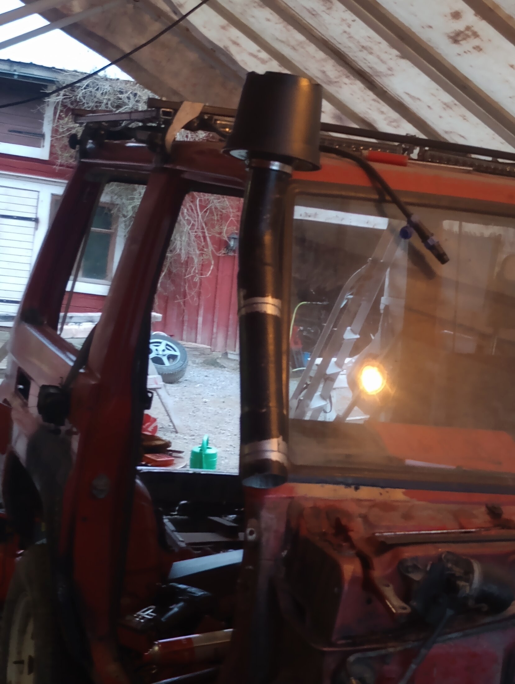

The snorkel is also taking shape. I'm using the exact same desing as my dad used to have on his Range Rover: some galvanised drain pipe, the cheapest "sport" air filter available and a plastic flower pot.

I then continued with the snorkel. Mounted it with rivnuts and started replacing the silicone at the seams. I already mentioned that it's the same design as on dad's range rover, but it's also the exact same pipe. I've got a new air filter and flower pot for obvious reasons though.

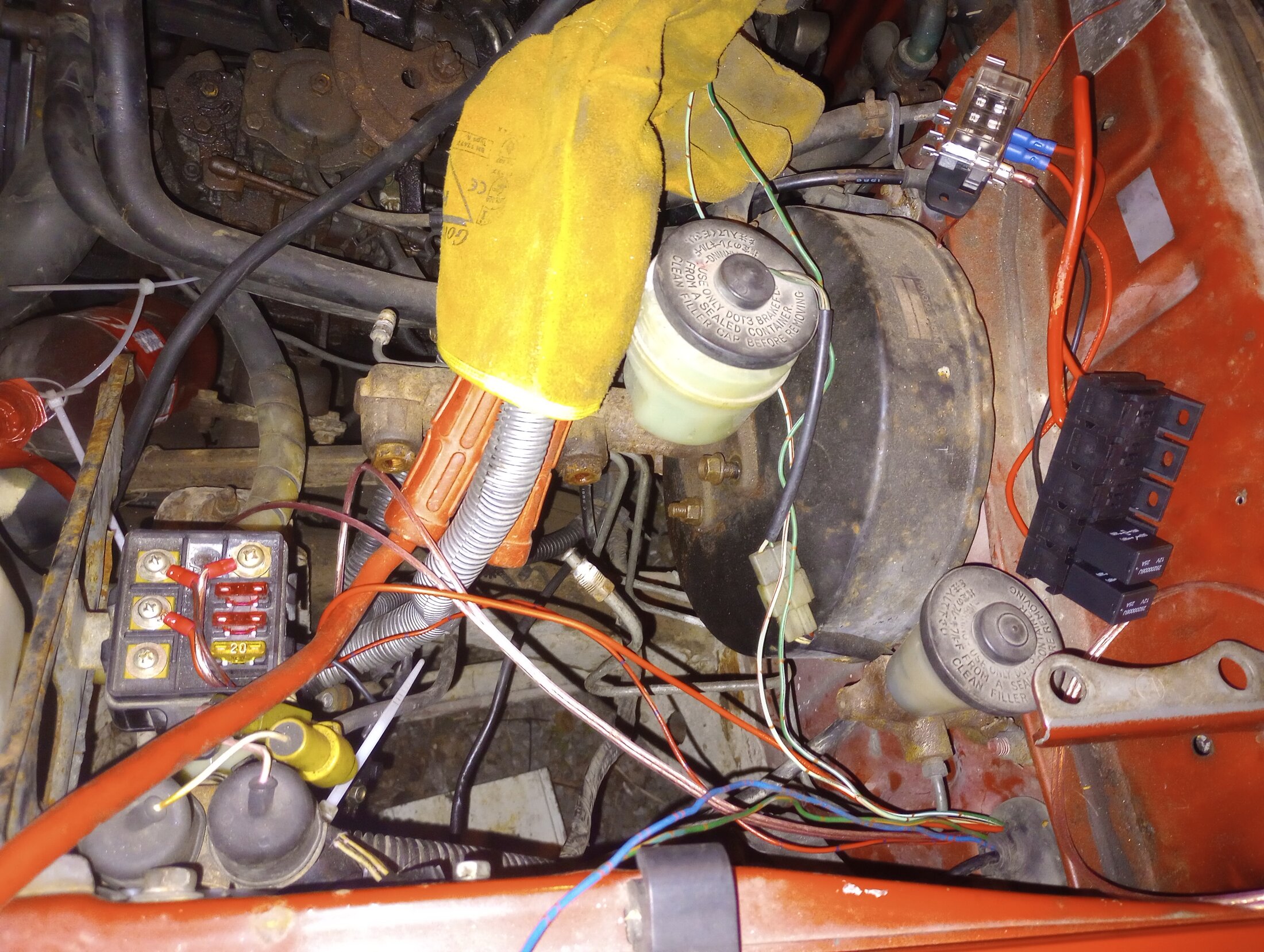

As I had some boundaries of the engine bay laid out I put some thought into the placement of the batteries and the air tank. I currently have two 60Ah batteries for it, but 95Ah batteries would fit in the stock battery holders. What is stock / what does other twin battery Toyota owners have? 120Ah is already a lot for a car, 190 is getting ridiculous. If I also count the 95Ah battery I have planned for the trunk I'd get a maximum total of 285Ah. Would be useful for winching with a dead engine, I suppose. Over half an hour of winching at full load with my five ton electric winch.
Got started on the accessory wiring this weekend. Yesterday I sketched up a wiring diagram...
...and today I went shopping for supplies and started connecting stuff.
There's five relays and four fuses, plus the three in the power outlet box. I have 800 watts of extra lights alone (three 100w halogens, two 100w LEDs, six 18w work lights, one 55w work light, two 55 or 100w fog lights), so the two 10A and one 20A fuses in the power outlet isn't quite enough. 800w is getting close to the alternator capacity though, so I might downsize the halogens a bit to 2x100 or 3x55.

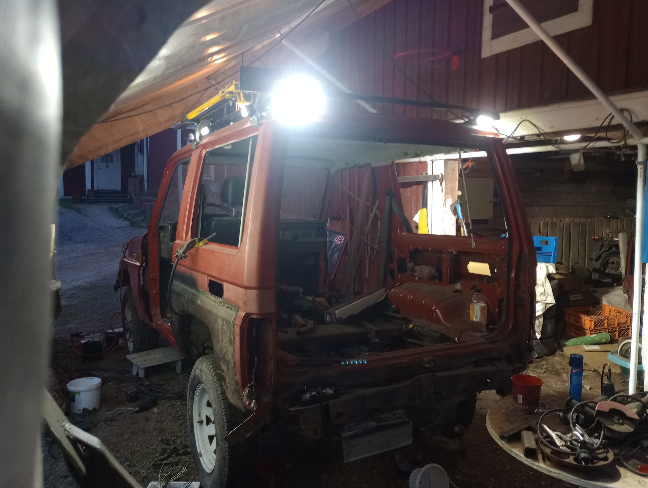

This far everything has worked on the first try. By "everything" I mean the work lights. The halogens and fog lights have no place to be mounted yet, I've lost a connector I need to wire up the LED bars and other parts of the car needs to get a bit more done for the rest of the wiring.

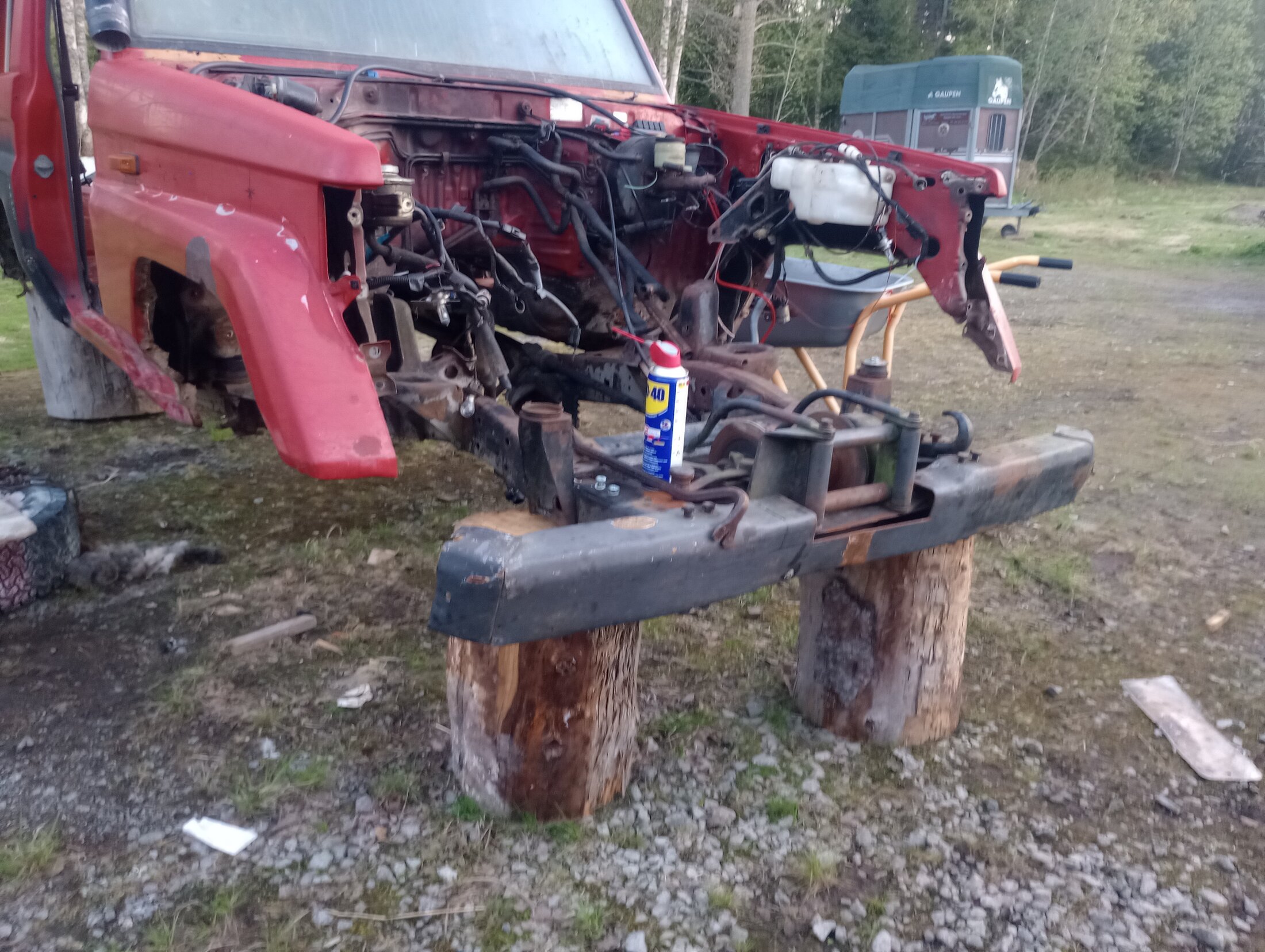

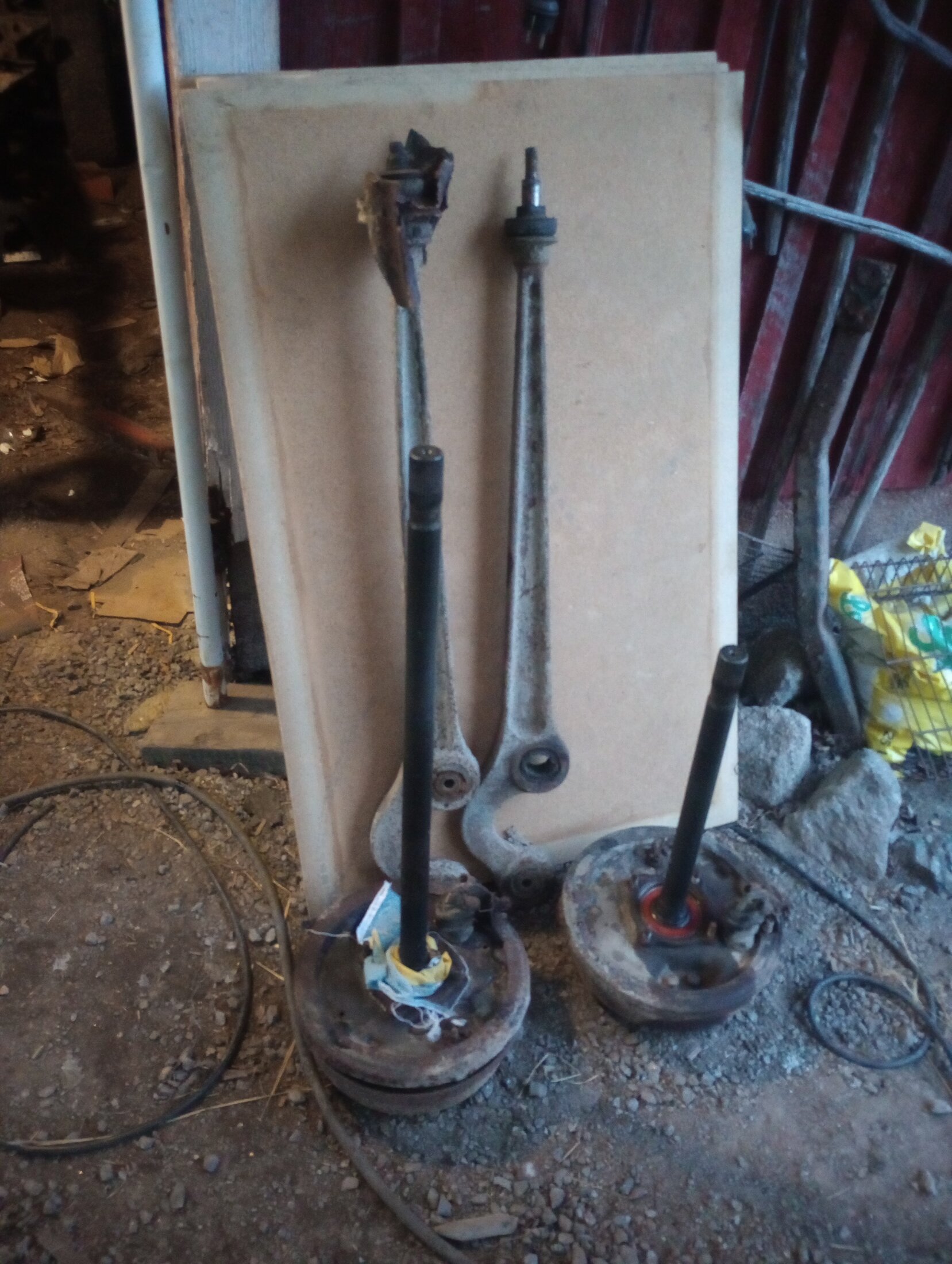

I've booked a tractor with front loader to come pick off the body tomorrow, so today I've been working on disconnecting everything between the body and frame. Some body mounts had already done the job for me...
...but even the ones I had to remove normally were surprisingly easy.

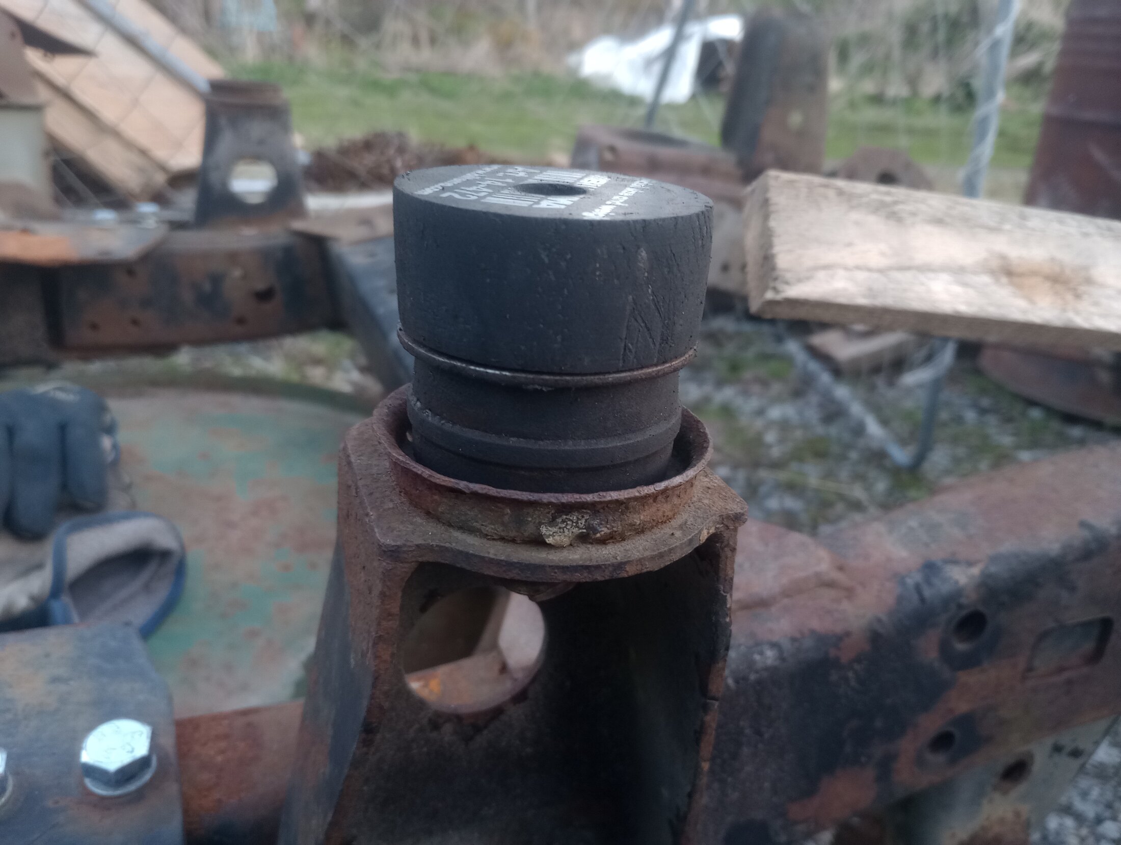

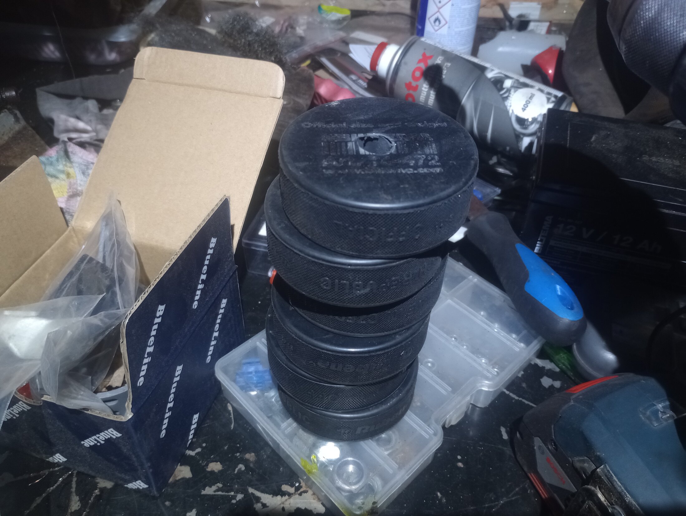

To be able to engineer the suspension and rear bumper properly I need the body and frame on the right distance from each other. I'll install a small body lift, mostly to get the radiator out of the way of the pto shaft and to get the fuel tank a bit more protected. If I were to buy spacers from 4x4parts they would cost me 180€, so I decided to go to Biltema and buy eight hockey pucks for 20€ instead.
Two of them had to be made a bit smaller to fit the front mounts...
...but the rest just had to get holes drilled through.
The two rearmost mounts are also smaller diameter, but I think the full puck should fit.

Today is the day when I finally got the body off the old frame.
I put it down on the new frame with the body lift spacers in place so I'll be able to engineer suspension and rear winch/bumper mounts once I get the axles off the old frame.

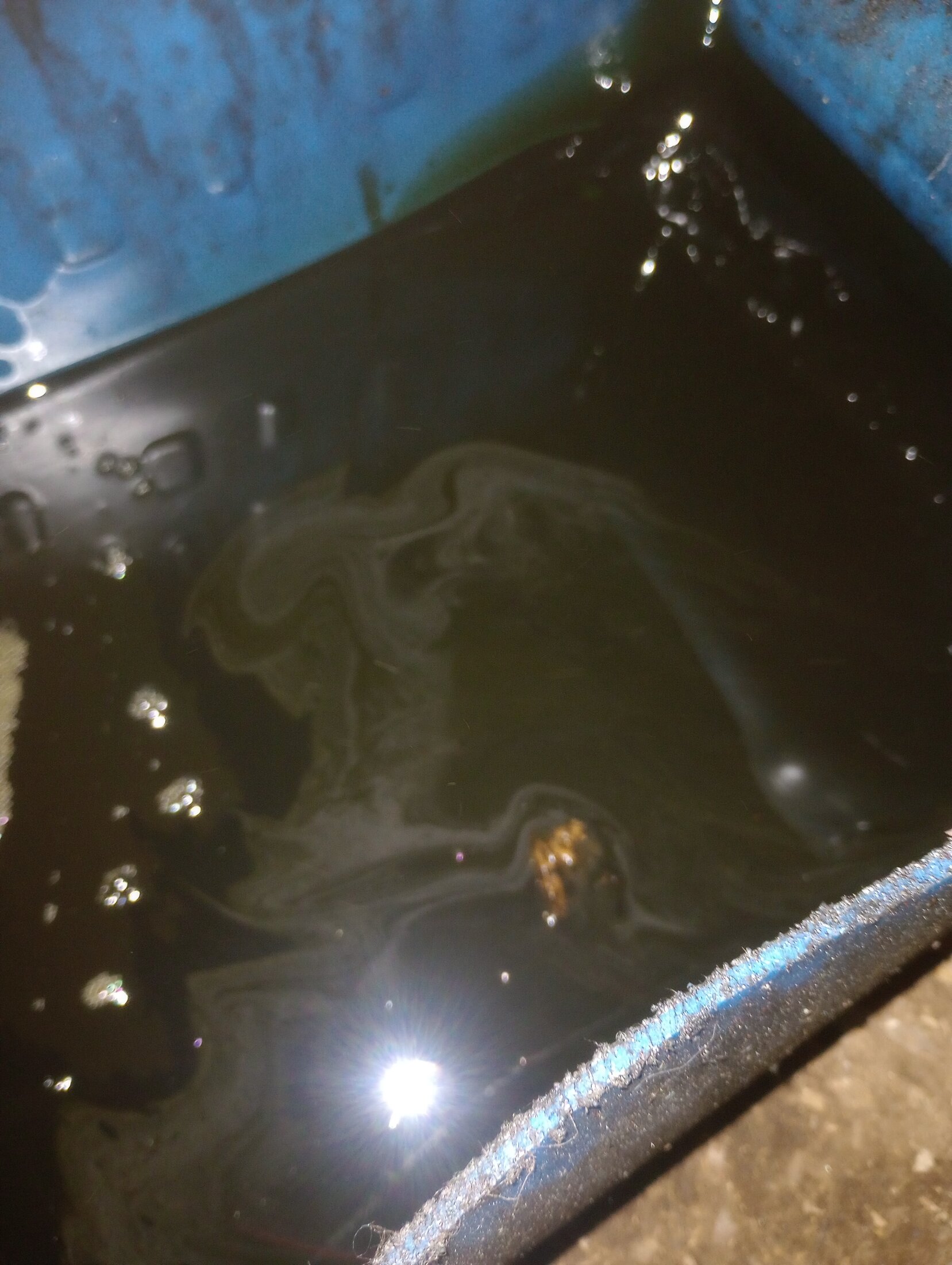

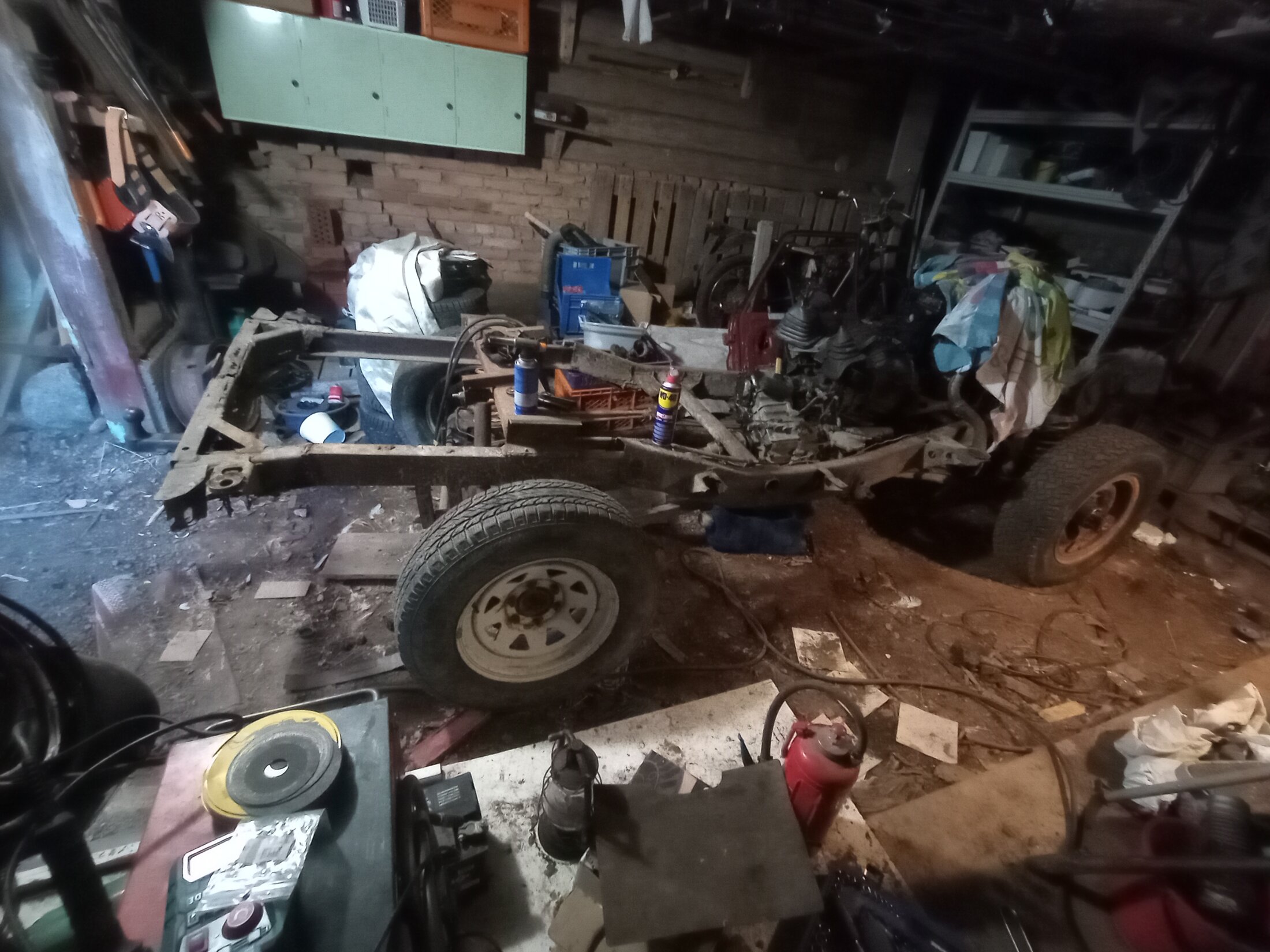

Yesterday I got the old frame rolled indoors, and today I got started on disassembling the transmission.
The oil was very dark and kind of green. I'm sure that's absolutely fantastic. At least it smelled like transmission oil.

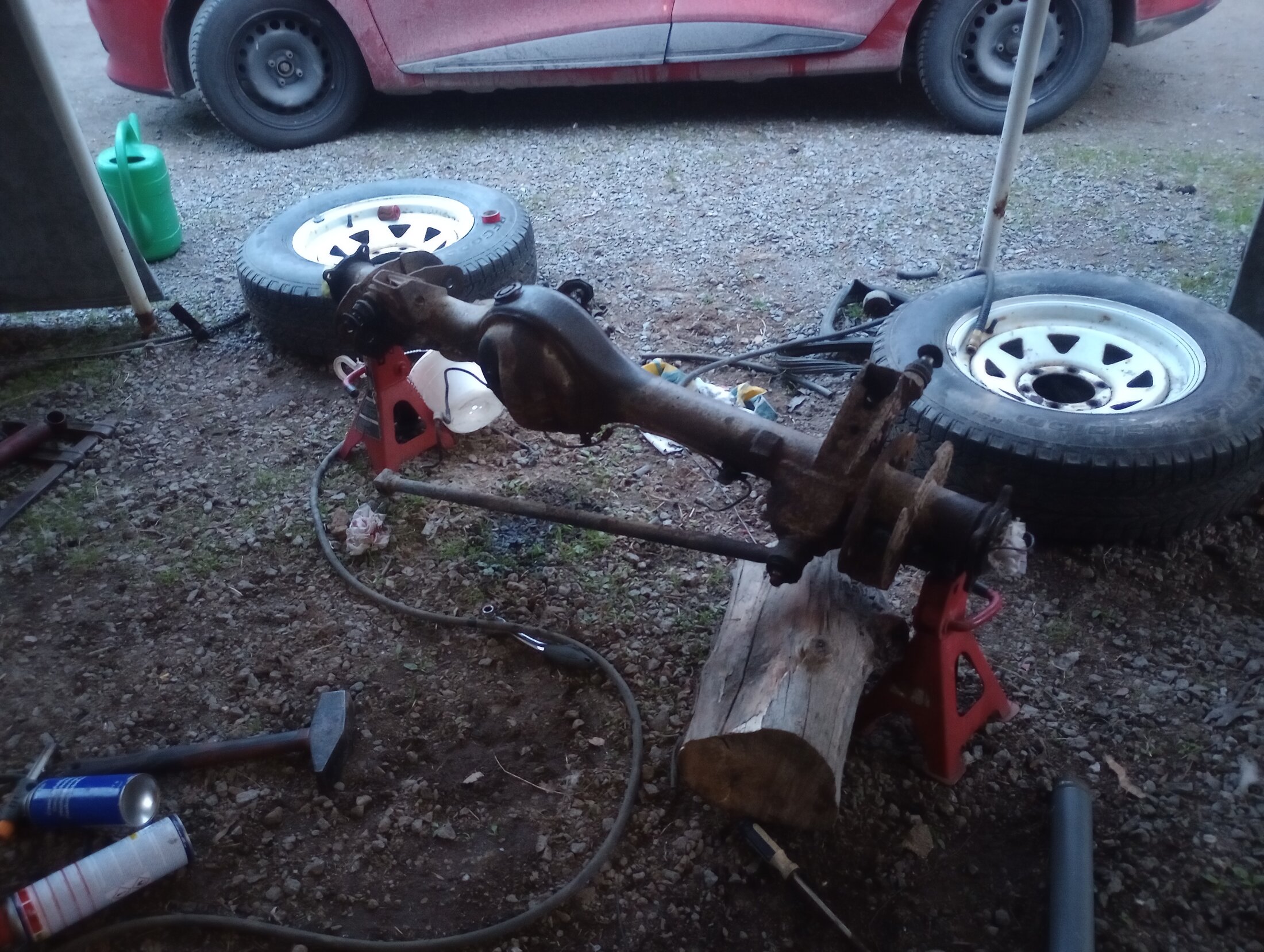

I then started working on the rear axle. It is a limited slip, but currently it slips quite a lot. After battling some rust I managed to get the carrier out...
...and after 16 more bolts I had the diff out and the ring gear removed.
Note to self (this is the only place I can be sure I find my notes): the pile of parts next to the vise were on the ring gear side of the diff.
