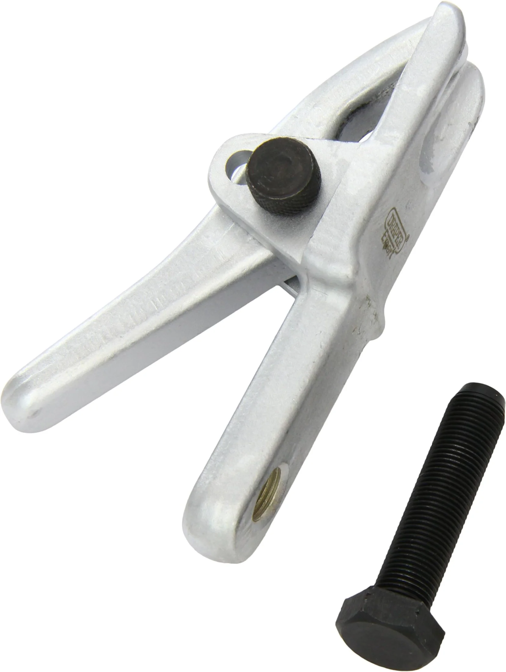

I've found these tie rod puller tools to work very well. Get it well seated, crank it down tight and then whack the end over the bolt section of the ball joint with a hammer.

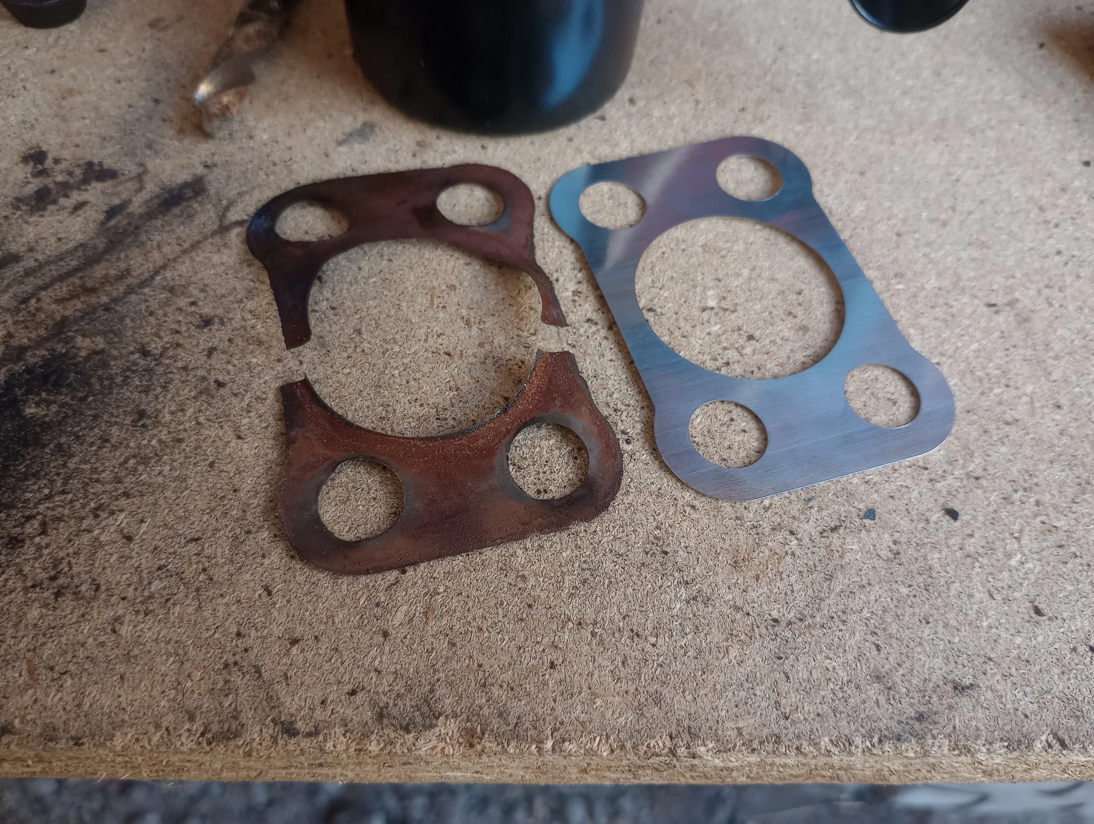

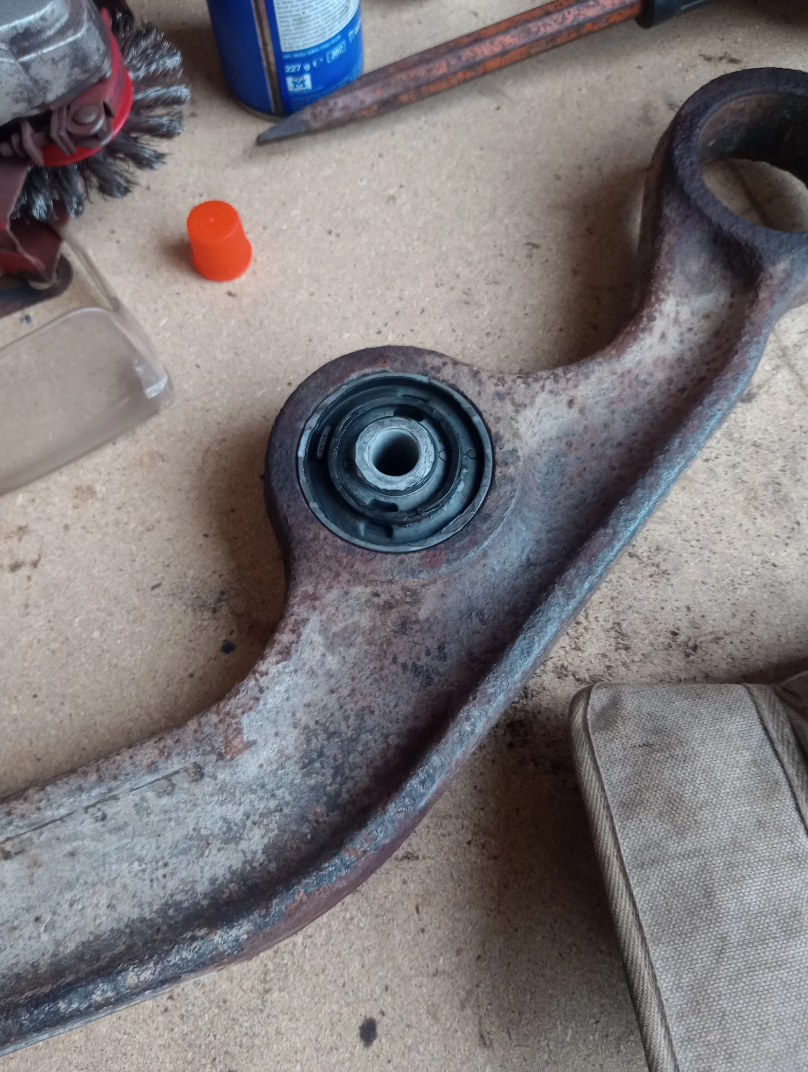

New shim arrived yesterday, so I got to put the arm back in place. I noticed the bearing felt really terrible, and I couldn't get it out to inspect and clean, so I'll be doing a full birfield rebuild including bearings at some point.

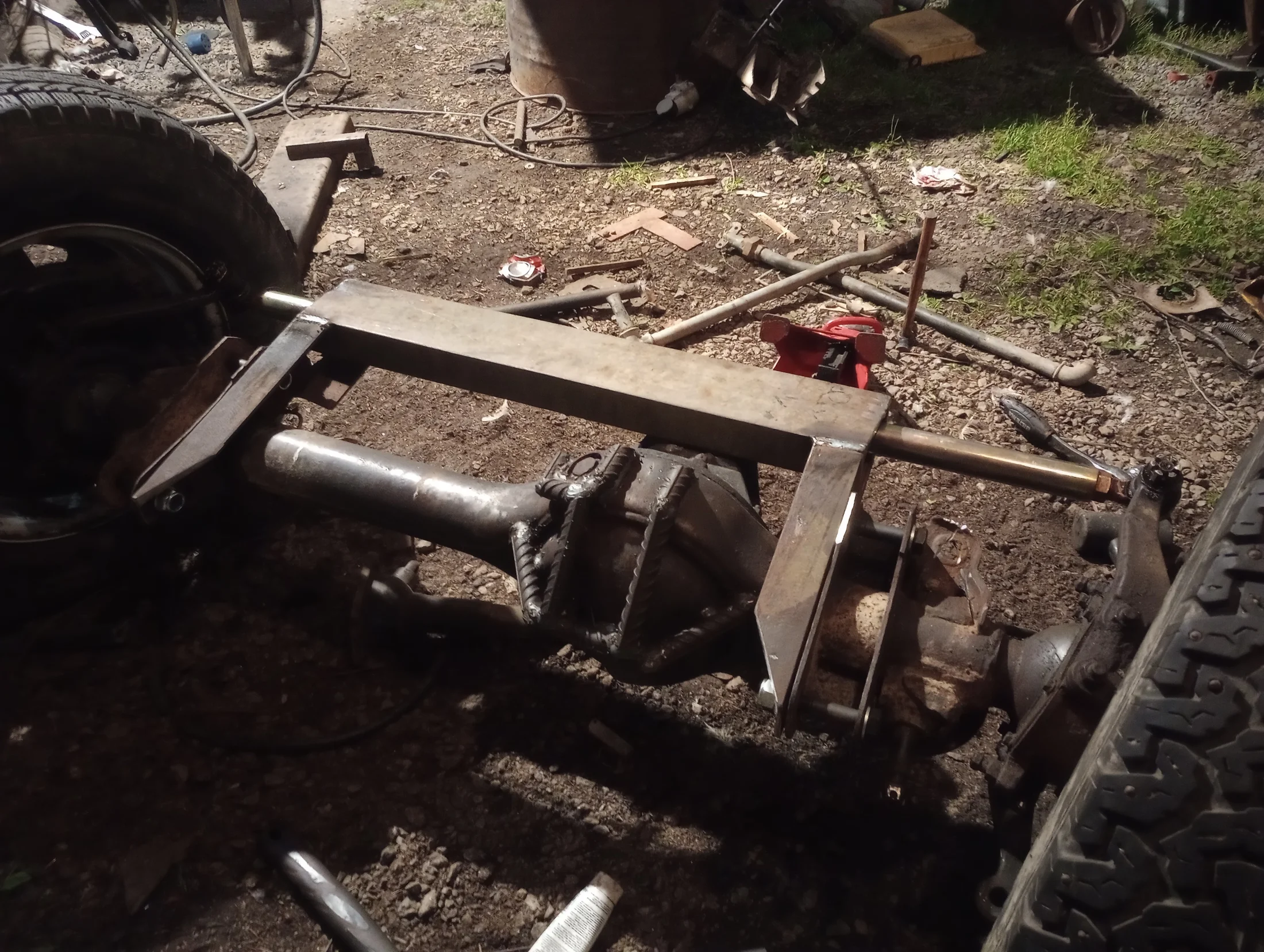

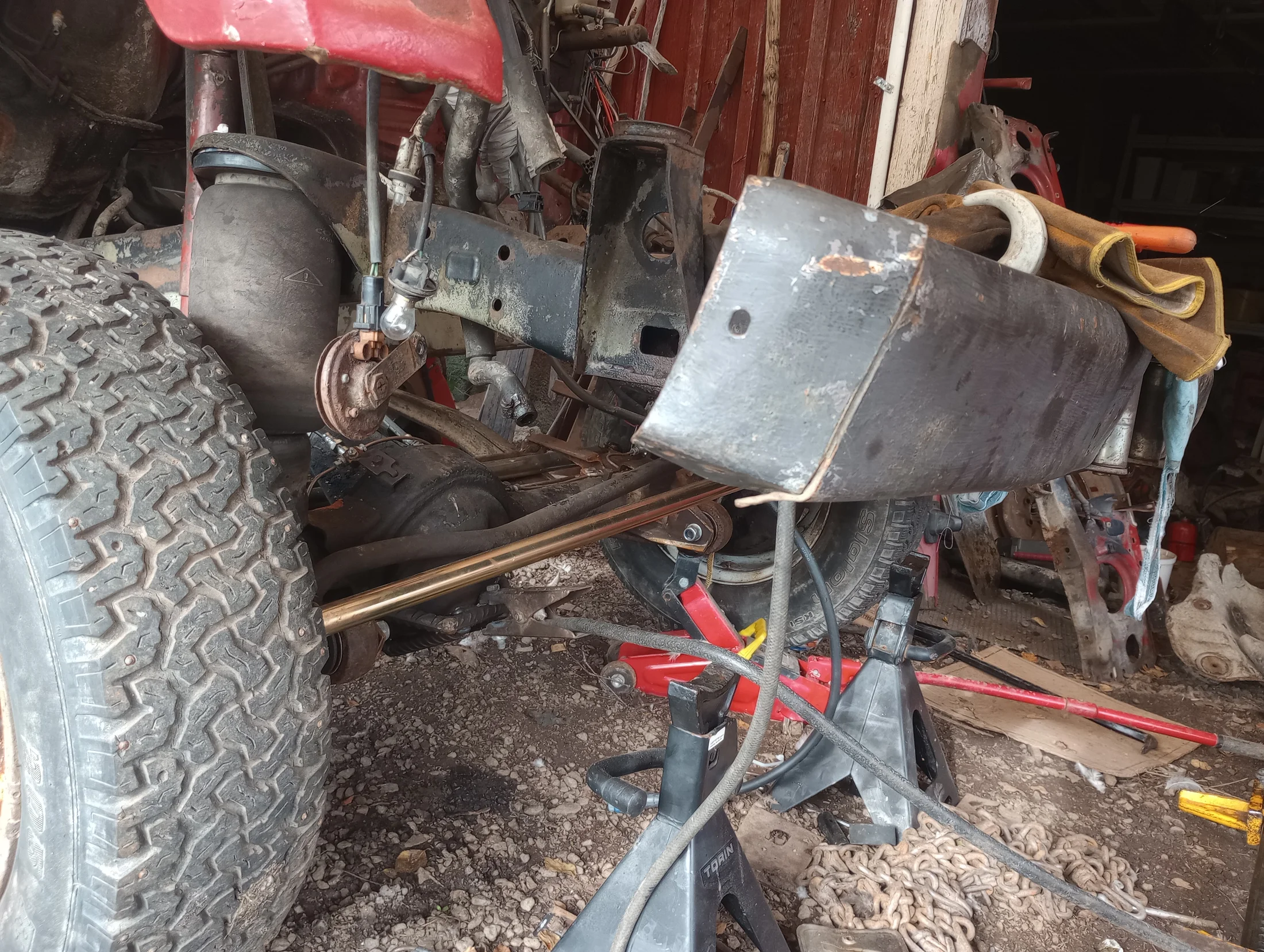

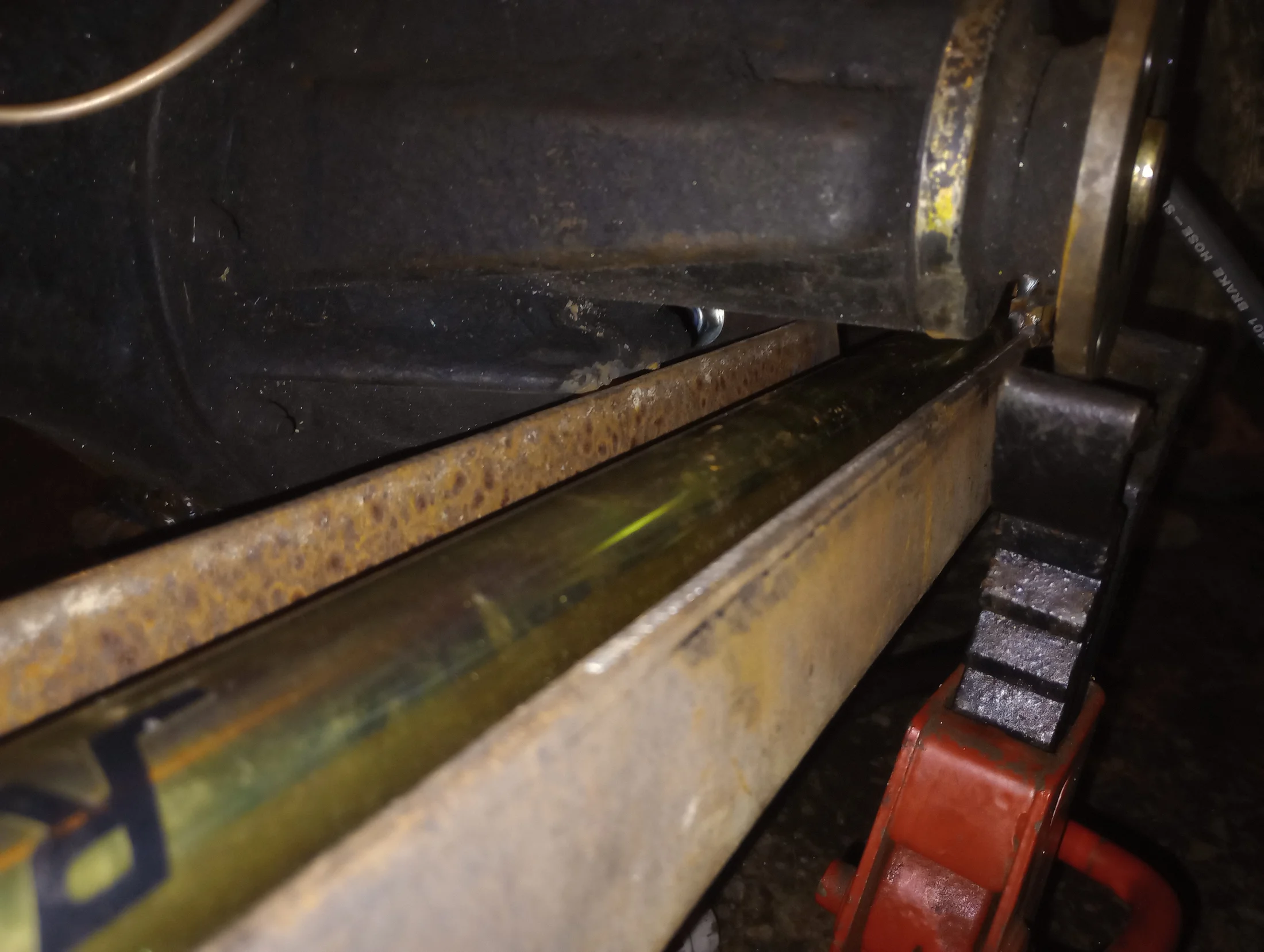

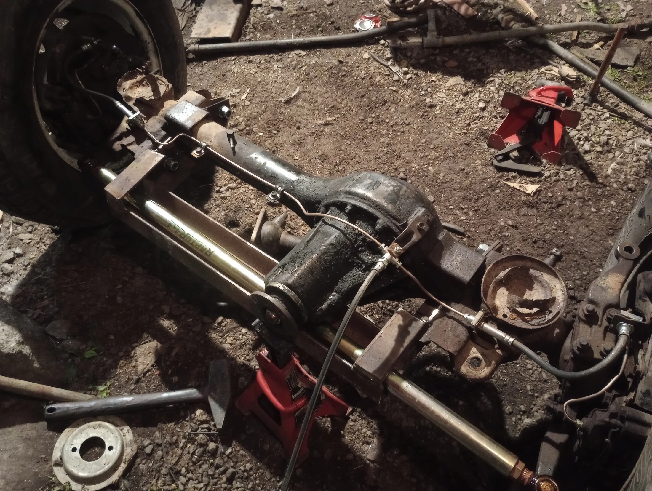

the new heavy duty tie rod: solid 35mm bar.

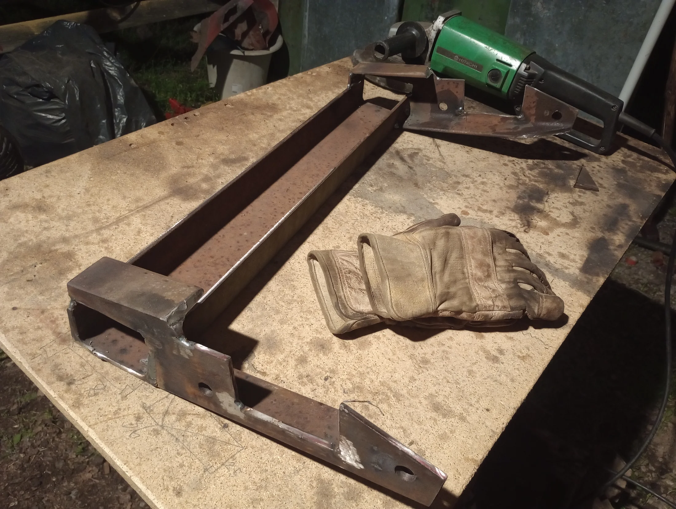

you're not bending a 35mm bar back into shape with a sledgehammer one you've hit a rock with it, so a guard is almost more important than with a non-heavy duty tie rod. 50x100x7mm U-beam which right now is just tack welded in place, but it will get mounted at the radius arm mounting holes and with a clamp around the pinion.

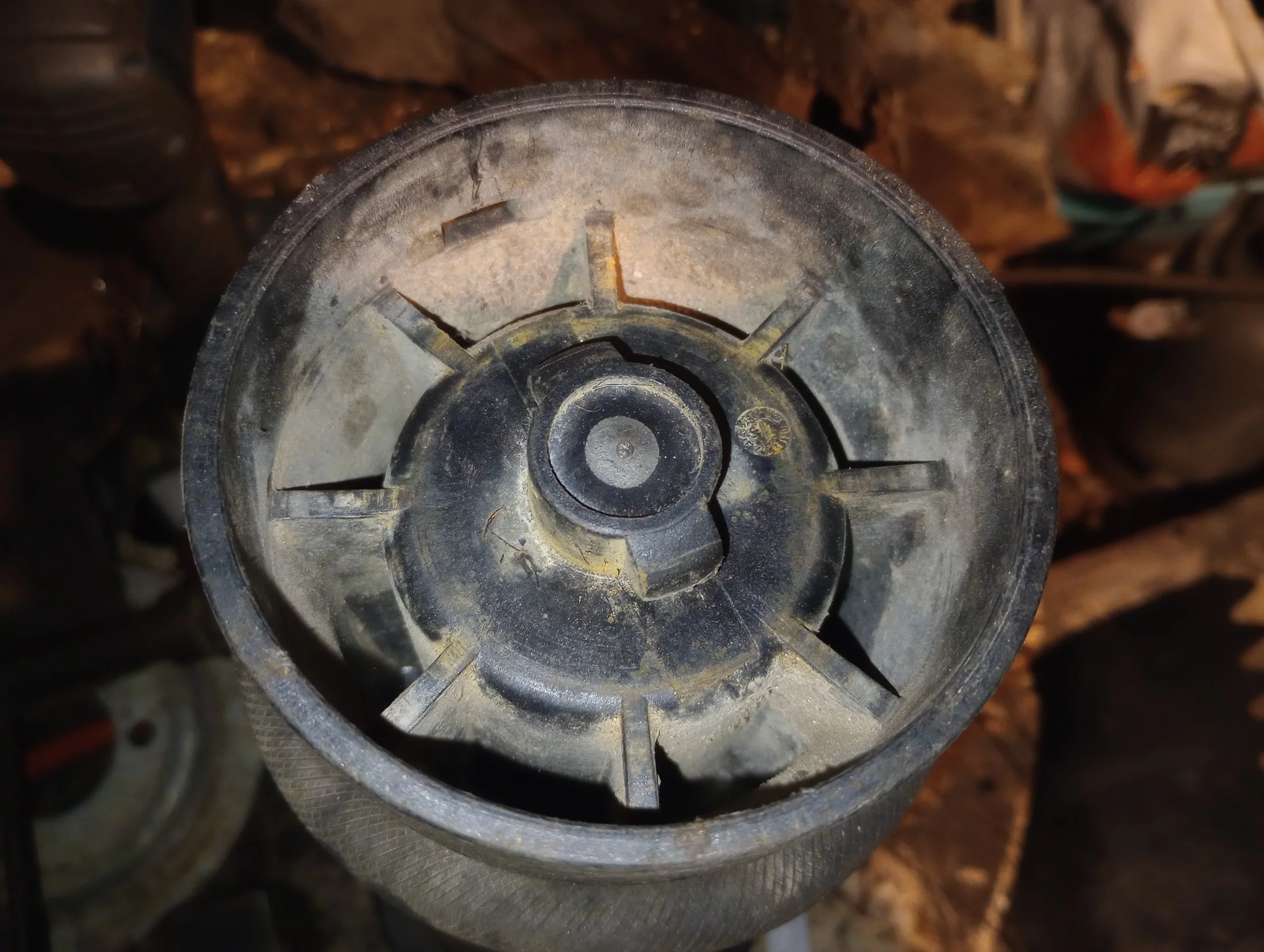

The Discovery 2 air springs fit perfectly in the front.

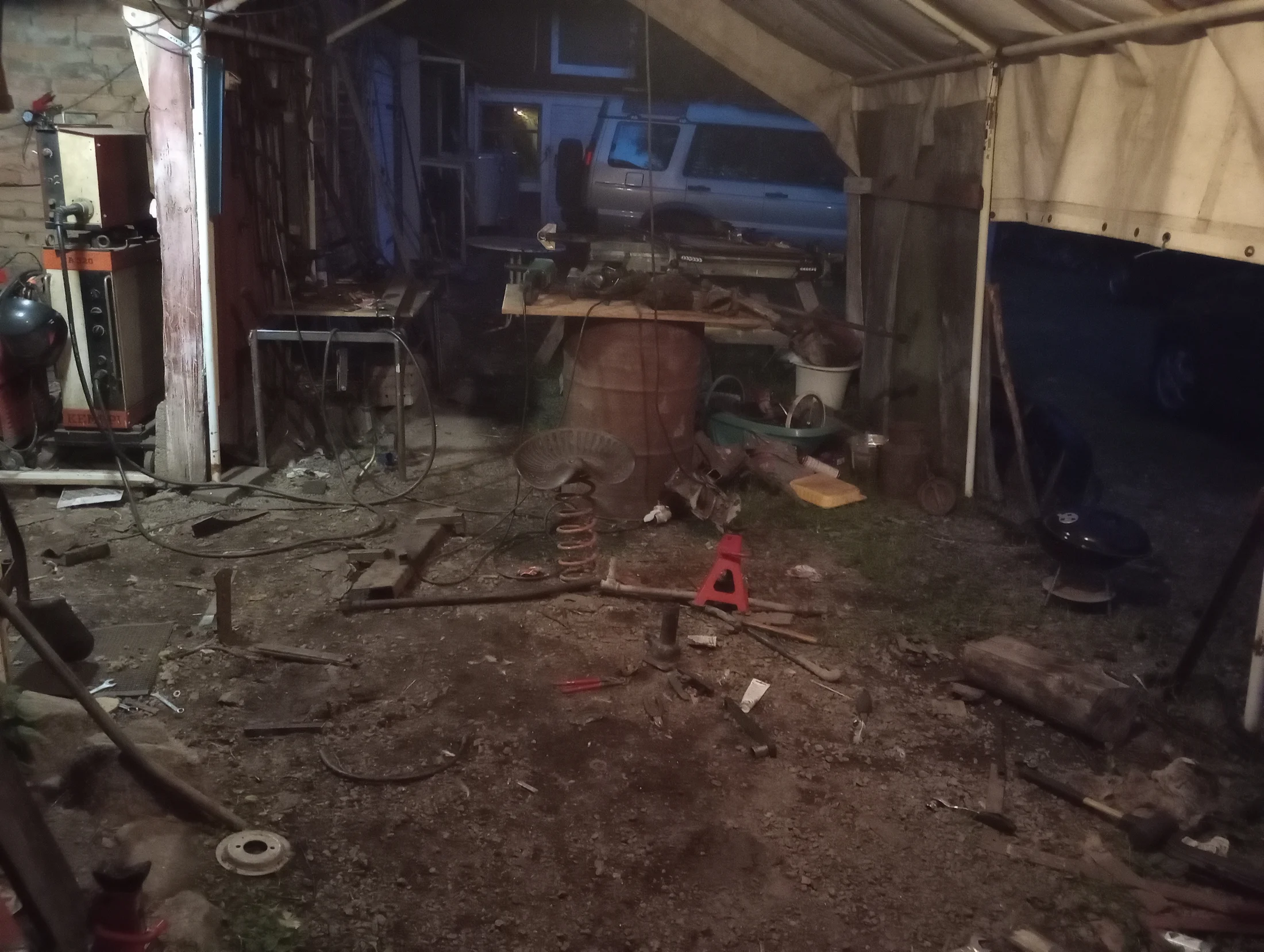

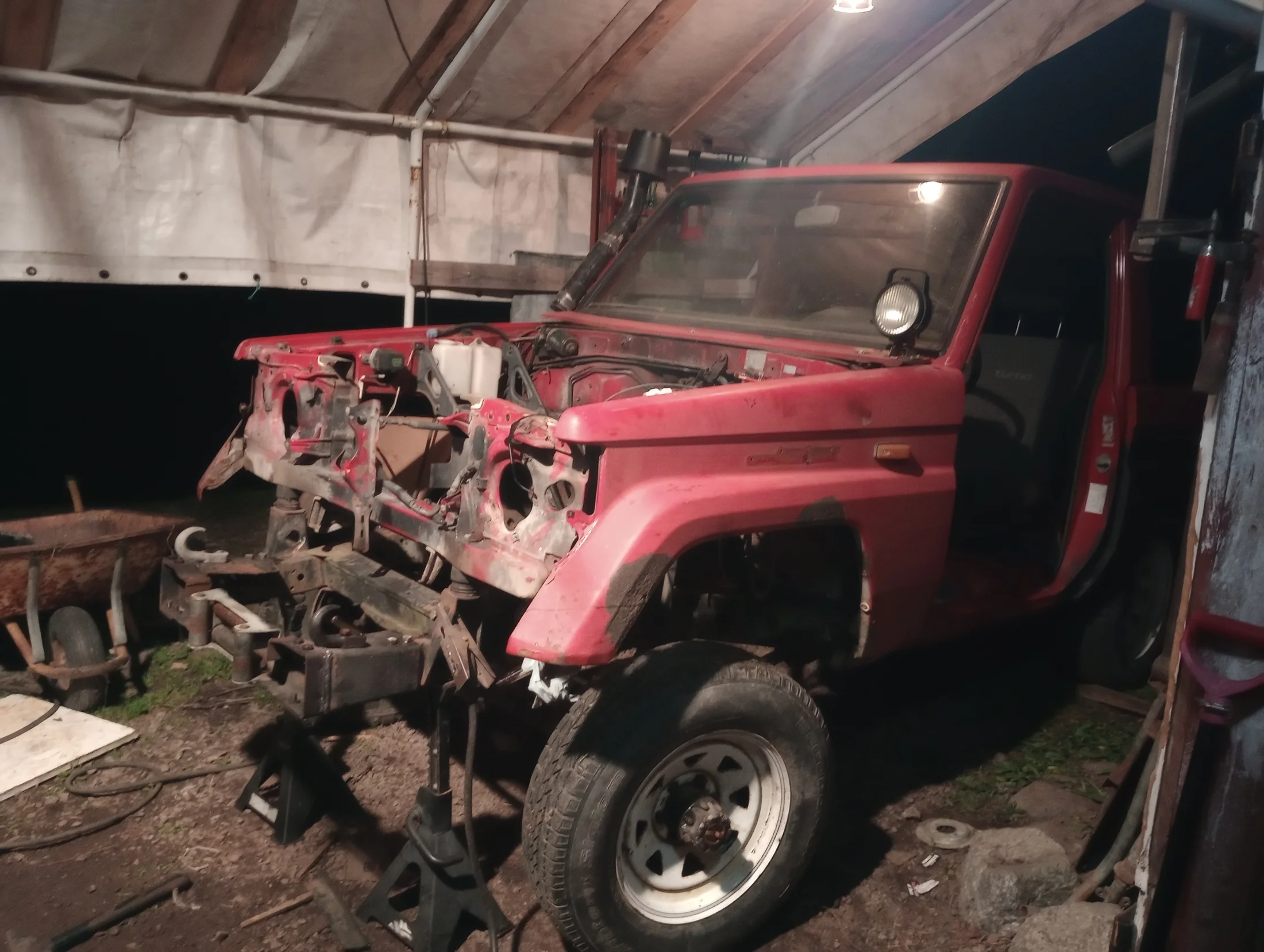

The cruiser is back in the tent for further welding.

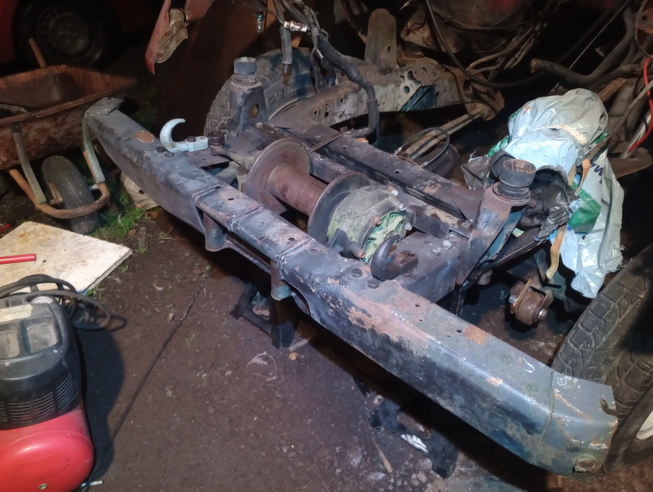

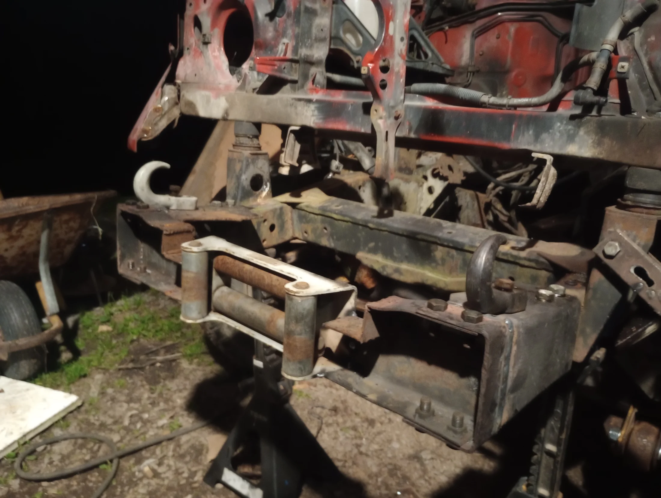

First of all, remaking the front winch mount again. I made the HJ60 front porch fit the LJ70 when I first bought it, but I have since discovered that my PTO spins the wrong way. I've also wanted to remake the welds with the new welder and replace some rivnuts with welded nuts, so I did that first. To fix the reverse rotation problem I've decided to ditch the original fairlead, which also is in terrible condition, and weld a standard roller fairlead in the bumper.
Is there a reason why you never see a welded on fairlead? Probably, but making it bolt on would complicate things more than needing a welder and angle grinder to replace it.

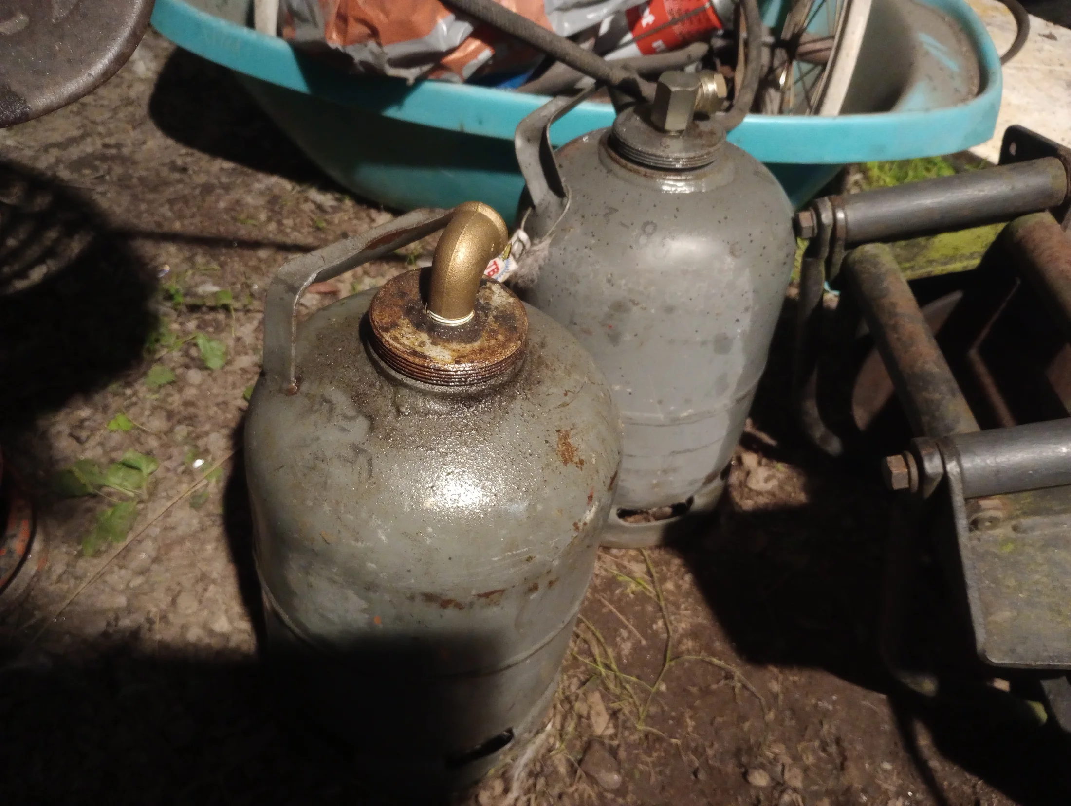

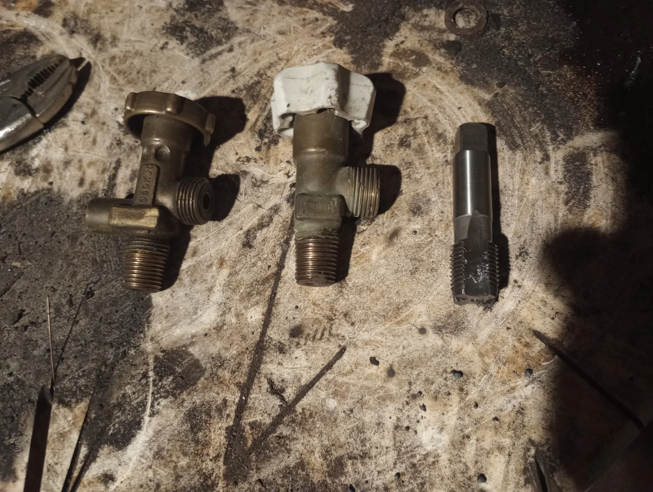

I also got the two propane tanks I'll be using as air tanks tapped to half inch BSP instead of the tapered whitworth they originally had.

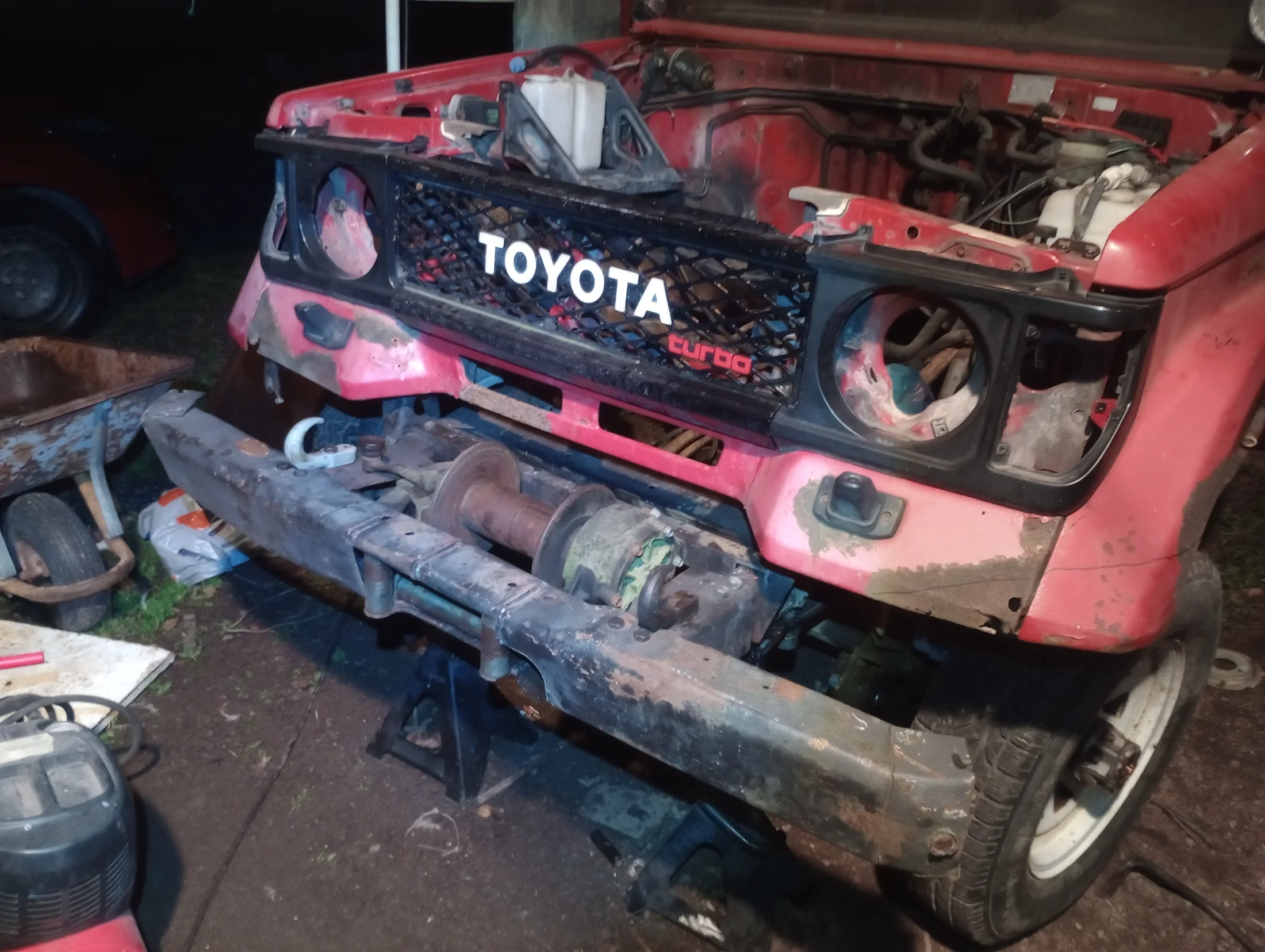

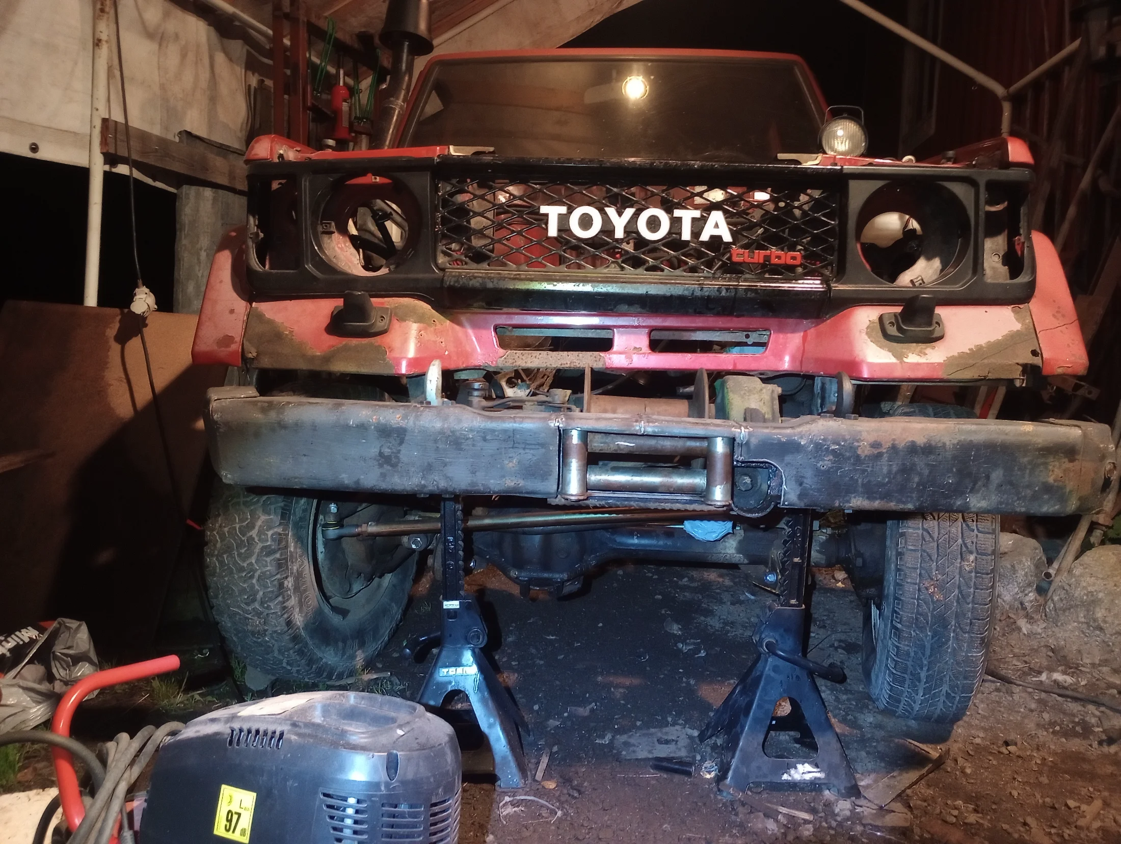

The front bumper is pretty much finished, just missing three fine thread bolts and a ball hitch. I might also reinforce the bumper panel, but I'm not sure if it's necessary.
It will also get a bull bar of sorts at some point, to protect the extra lights and to act as a top link mount for a possible snow plow or something.

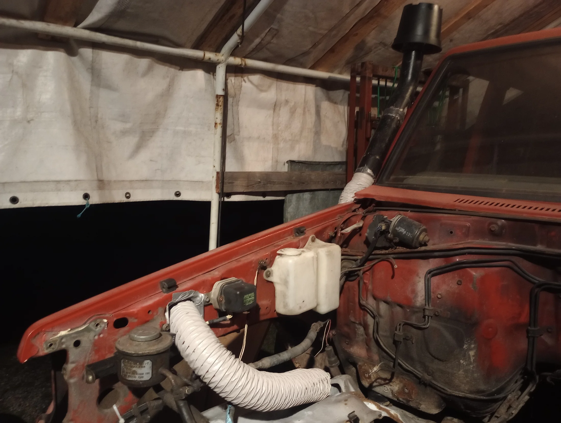

Went to the local rubber hose store and got myself a hose for the snorkel.

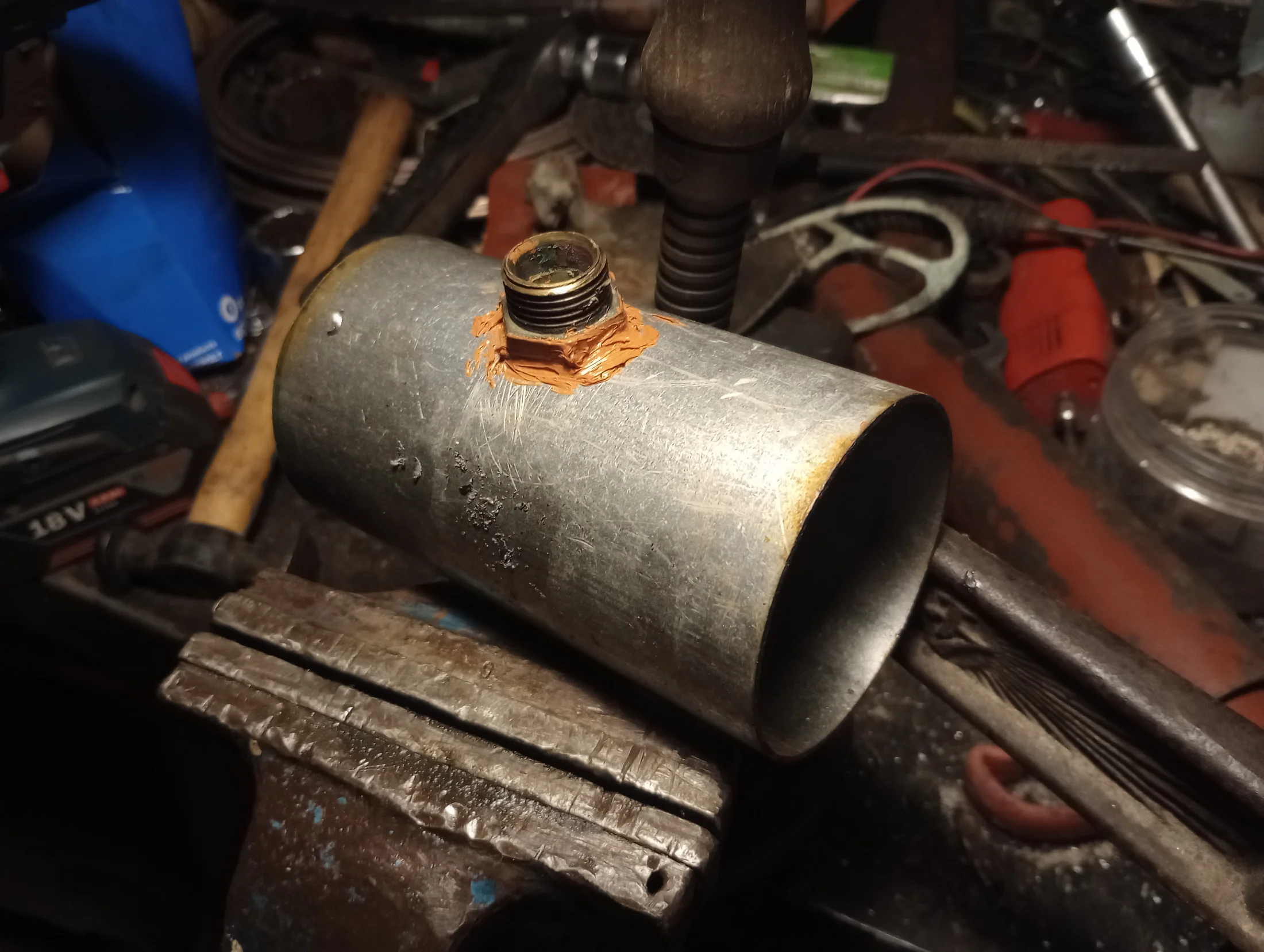

Then I made a tee from a piece of 75mm galv pipe. This will go between the 75mm snorkel hose and a silicon reducer to the 60mm turbo. The 1/2 BSP connector will go to the compressor, crankcase breather, front axle breather and transmission breathers. The rear axle and fuel tank will get their own snorkel at the back.

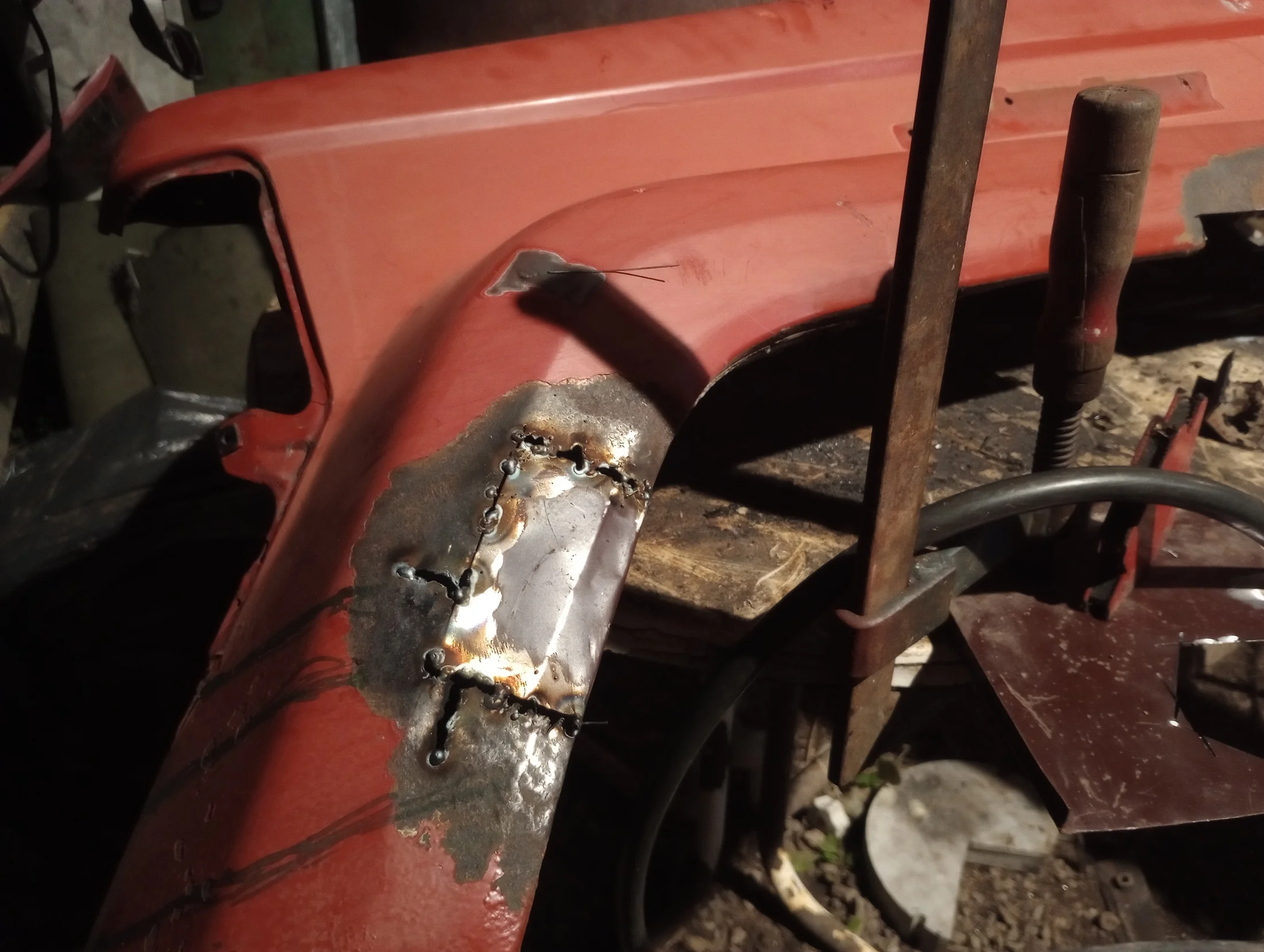

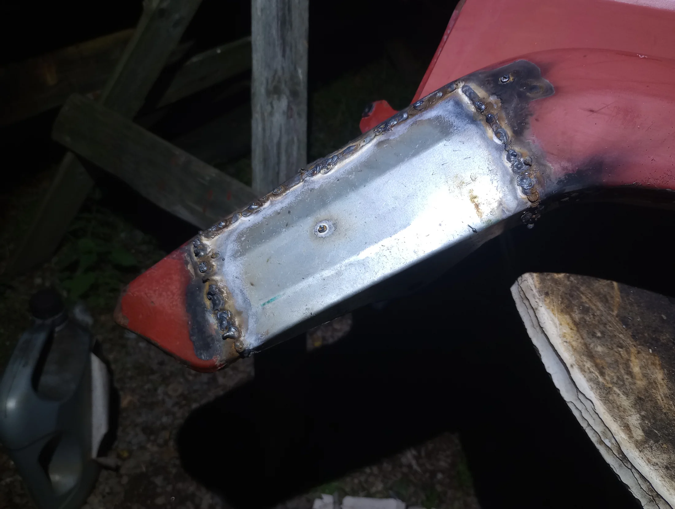

Then I attempted to fix some rust on the front fender, but I hadn't cut a big enough hole so it just burnt through everywhere, so that's where I gave up for today. I'll have to make a bigger hole and a bigger piece to fill it tomorrow.
The rust hole is fixed properly this time. Or well, the porosity problem with the small welder is back. It's probably fine.

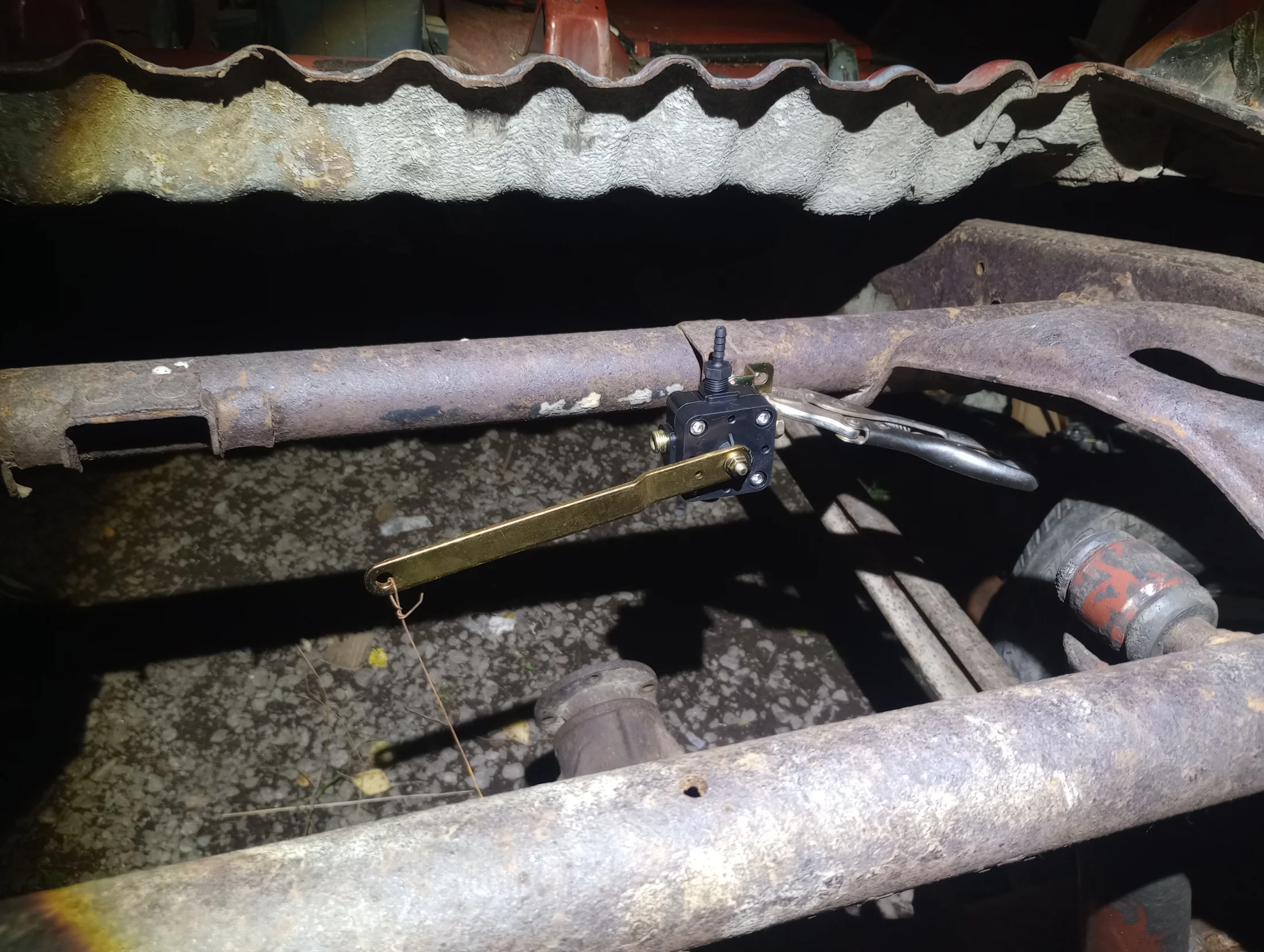

I ordered parts for the air suspension some weeks ago, and they've started dropping in. Here's the rear leveling valve:
I might have mentioned it before, but since I find computerised systems way too expensive and I want both self leveling and manual valves I've decided to make double systems: manual valves and mechanical leveling valves, and valves to switch between the two.

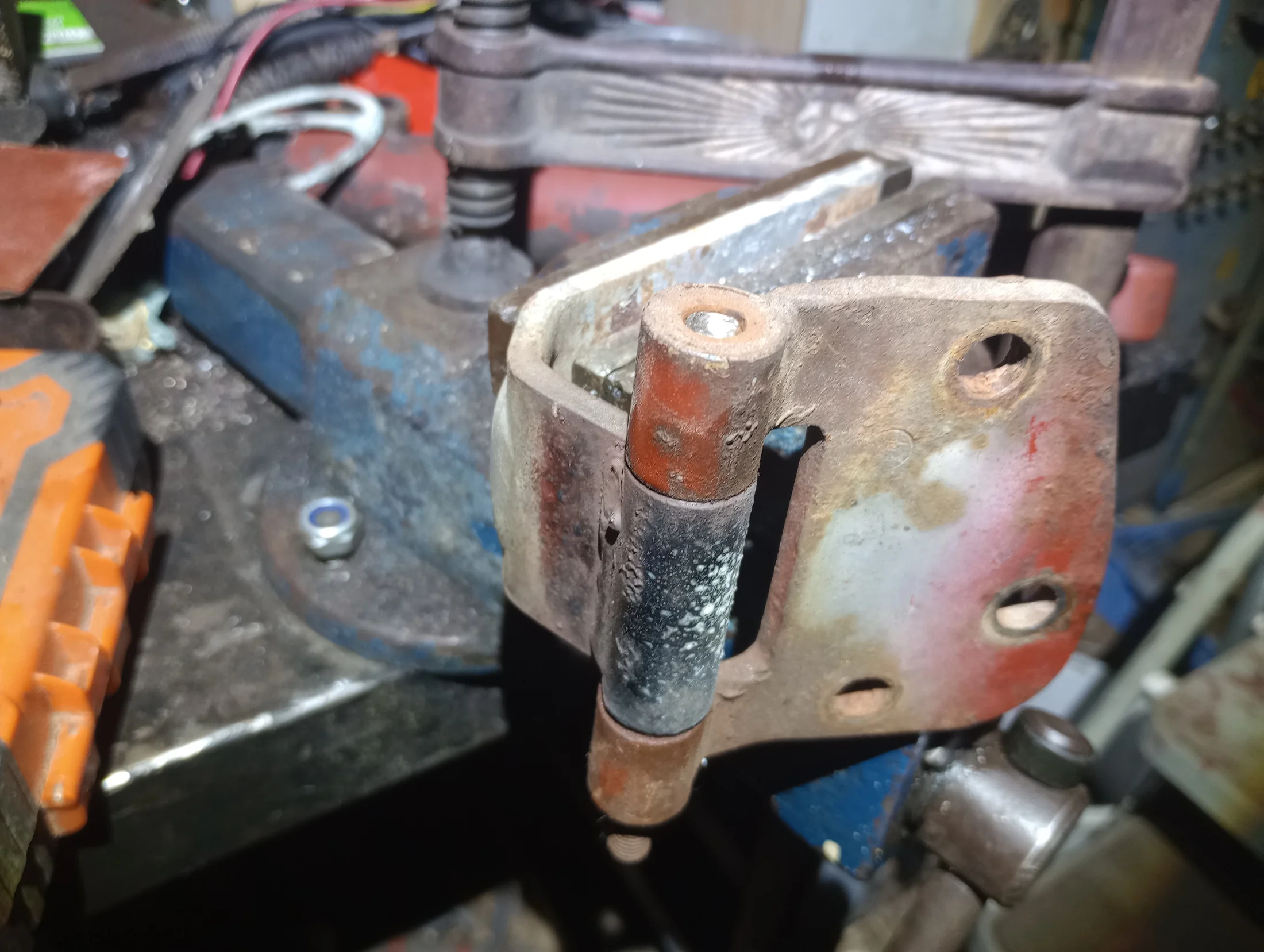

I tried to get started on rebuilding the rear door hinges. They've already been rebuilt once, evident by the way too long bolt with a 13mm head. The bolt has snapped and both parts are very stuck. When I tried to get the top part to move the head snapped off.

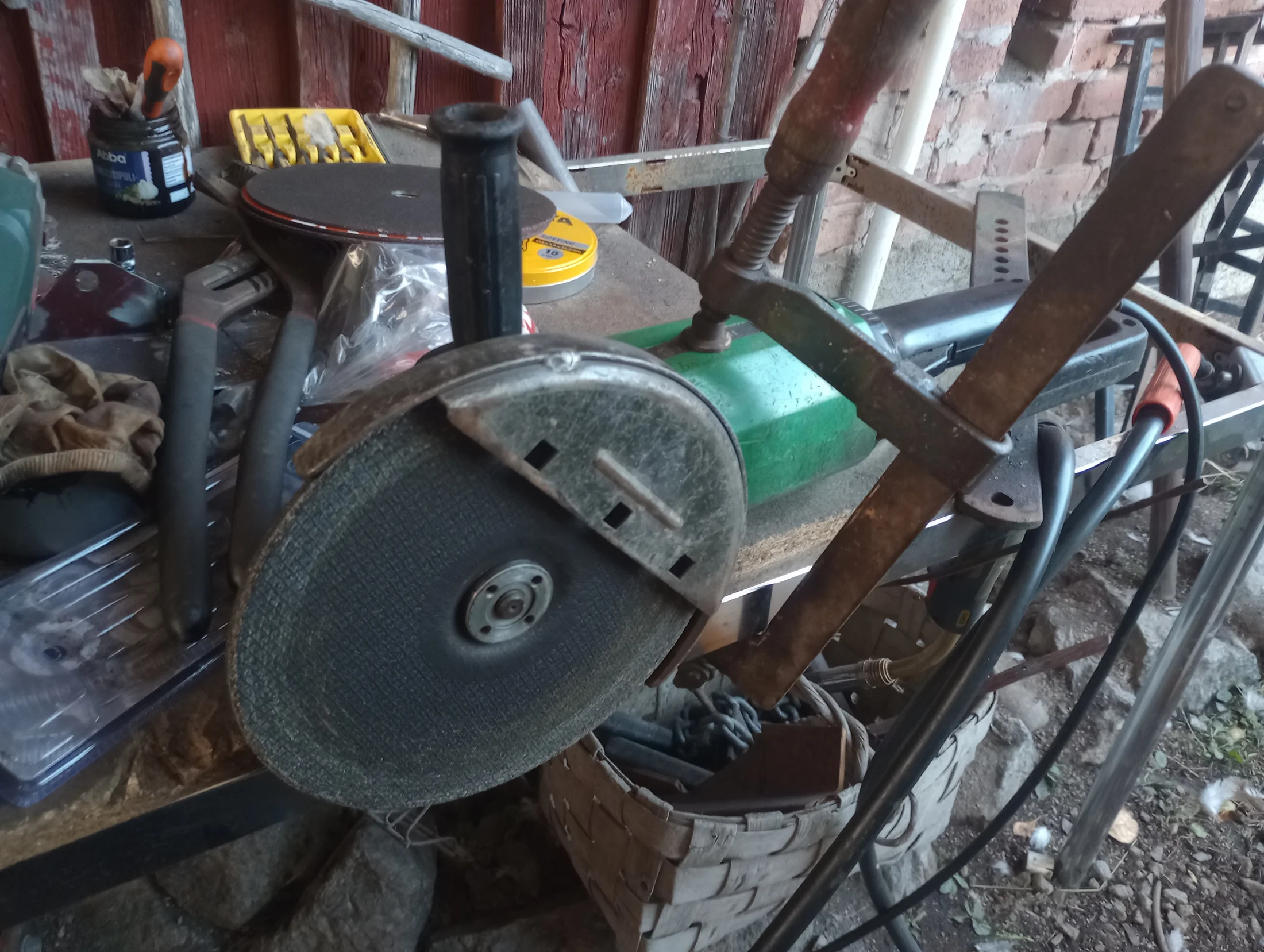

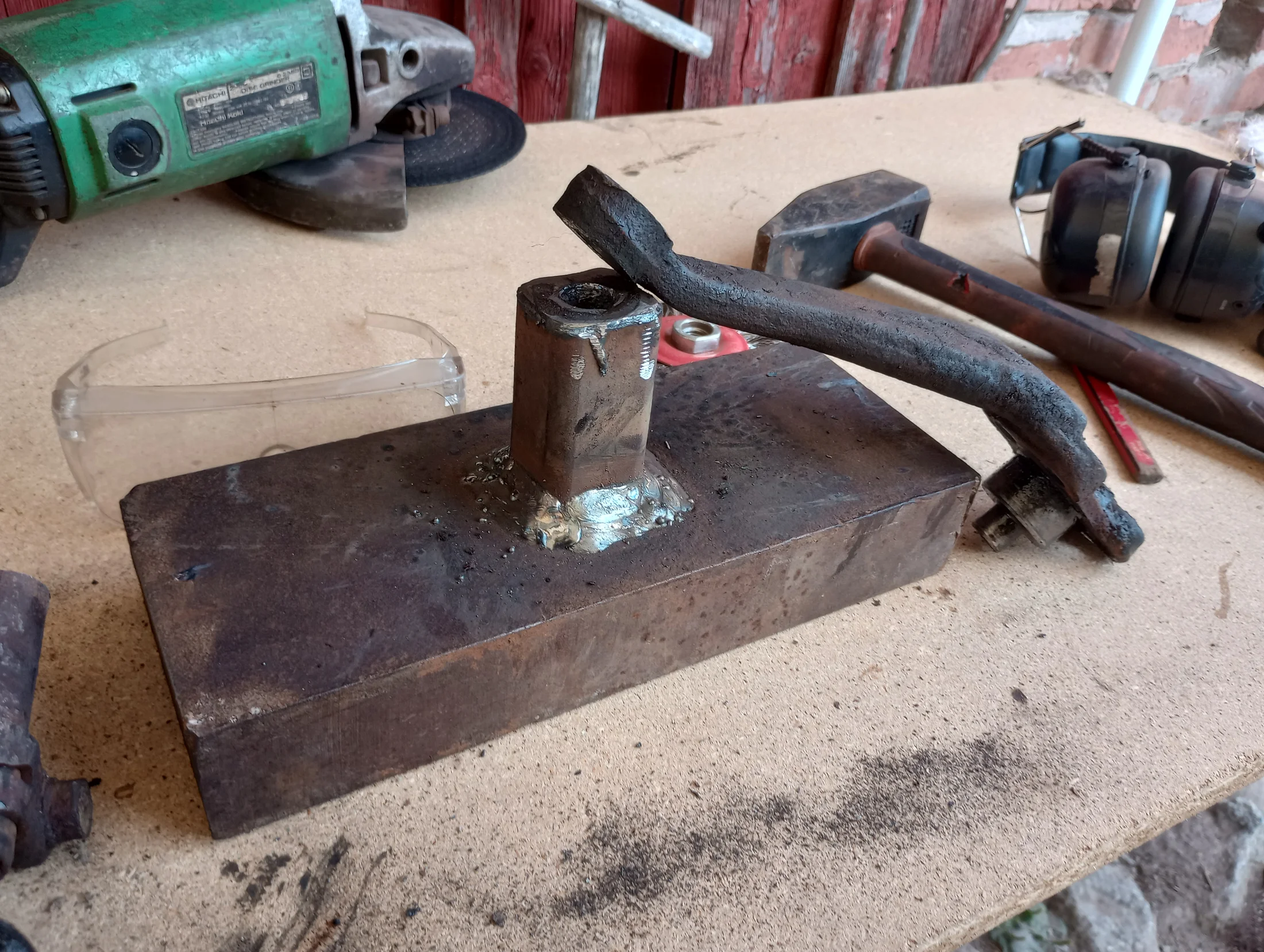

While grinding them I couldn't stop thinking that a bench grinder would make it much easier. So, I made one.
It might not be the easiest to use or the safest one, but it was a lot better than having the workpiece clamped down.

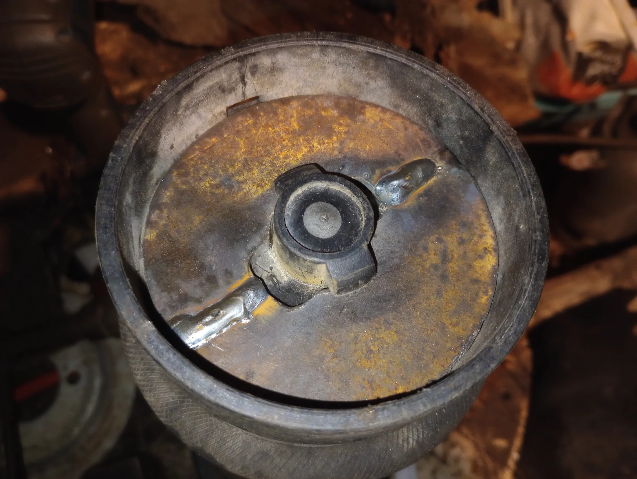

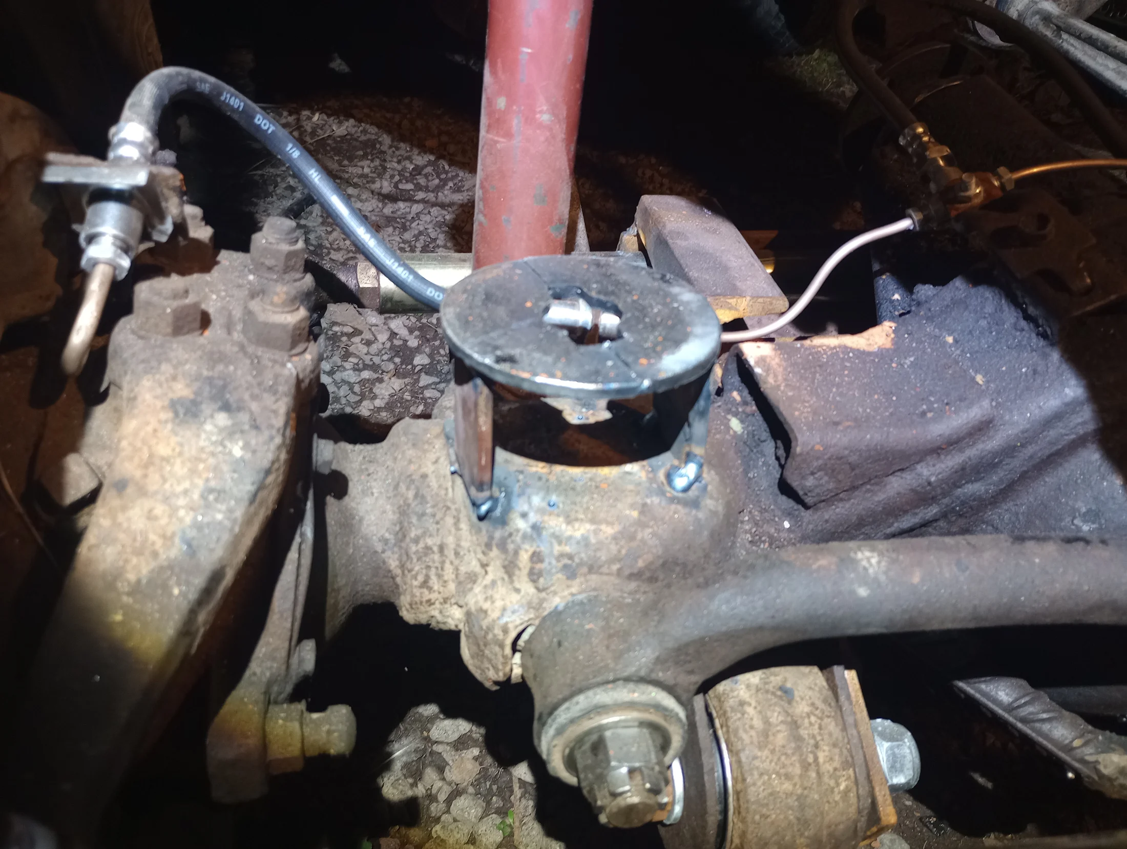

Made a top mount for the air springs. Spaces it down enough to clear the center on the stock spring holder and has a bolt that holds it in place via the existing hole. Now I just have to make three more top mounts and three more bottom mounts...

Got the bottom mount tacked in place with the appropriate spacer.
The spring fits and lifts the vehicle, which has allowed me to do the first prelimiary suspension softness test. The shock is a bit too stiff, but it should even out once the engine is mounted.

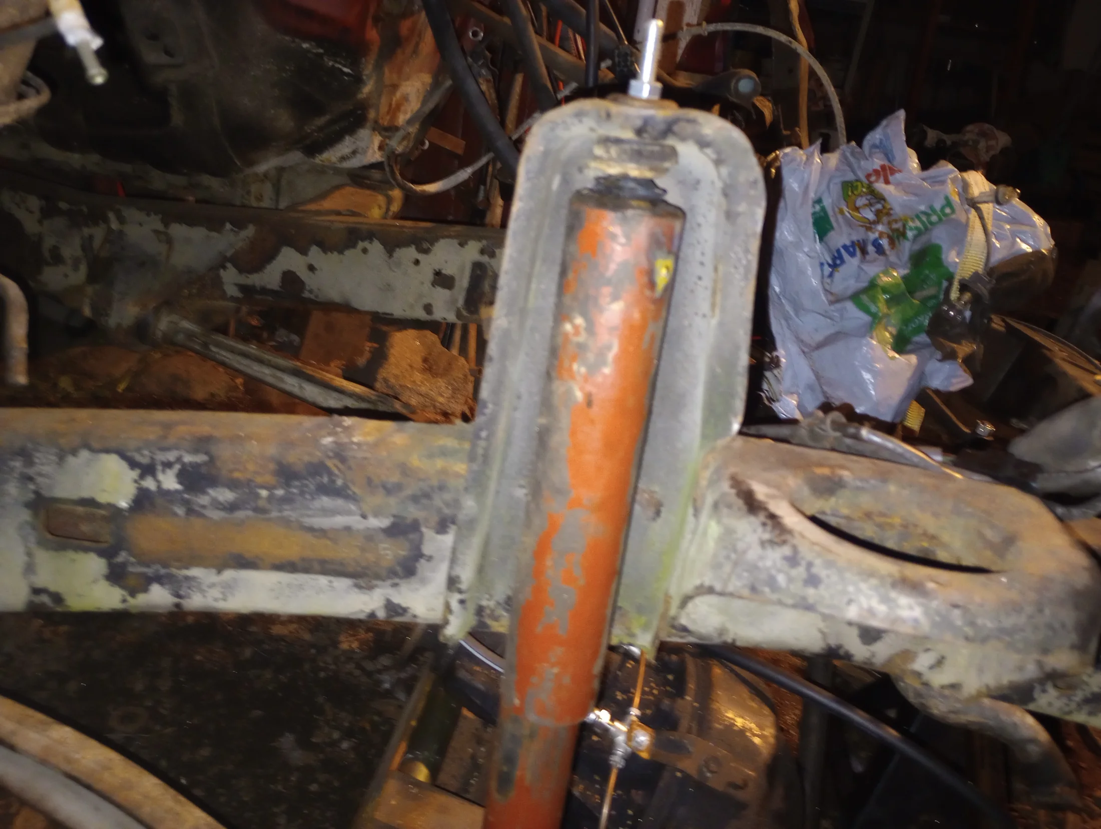

The gearbox mount was completely worn out, so I'll have to remove it and replace the rubber bushing at some point.

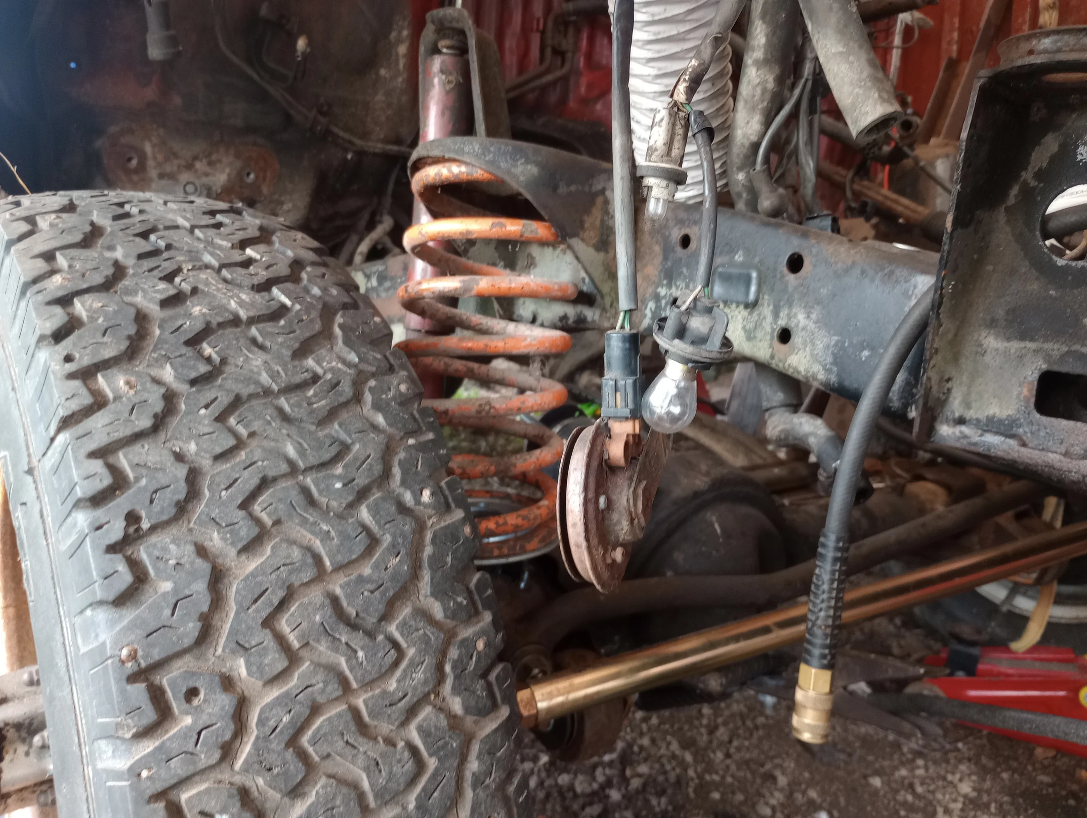

The front axle spring mounts are installed, and I put some coil spring plates and springs in place for now.
