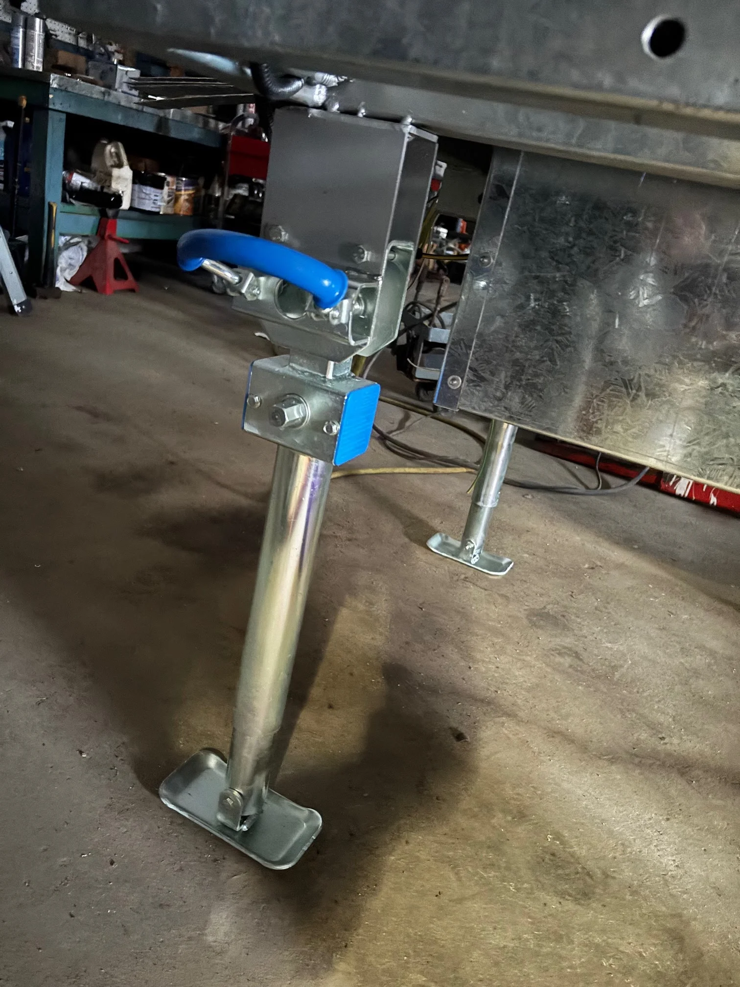

Because this will be seeing long rough trails sometimes I'm upgrading some areas to cope with conditions, starting with the jacks. I've opted for ARK jacks, front and back. The front jockey is an XO500 and the rear corner steadies are XO850mm drop downs which have the added bonus of being able to jack the trailer off the ground for tire changing or leveling.

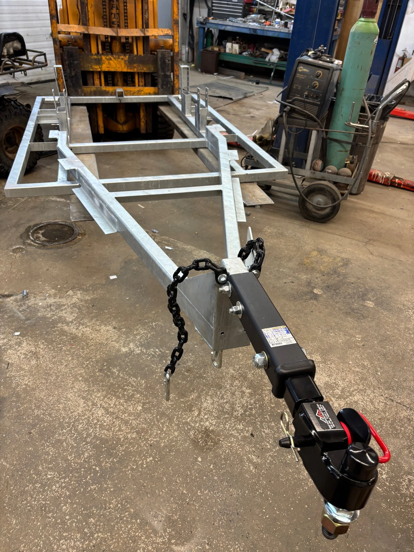

Recently got some progress pics: my frame is in the shop and my Max coupler is now attached. It's removable in case I ever need to switch to a ball coupler or want to shorten it on storage. There are many articulating hitches on the market now but I still like the max coupler the best. It seems to me to be the least complicated but yet it's still easy to guide into place.
The frame is upside down so you can see the spring hangers. No fancy timbrens here... It'd almost be unfair if the driver was on front and rear leaf springs and the trailer was floating on a cloud? 🚙:bounce:

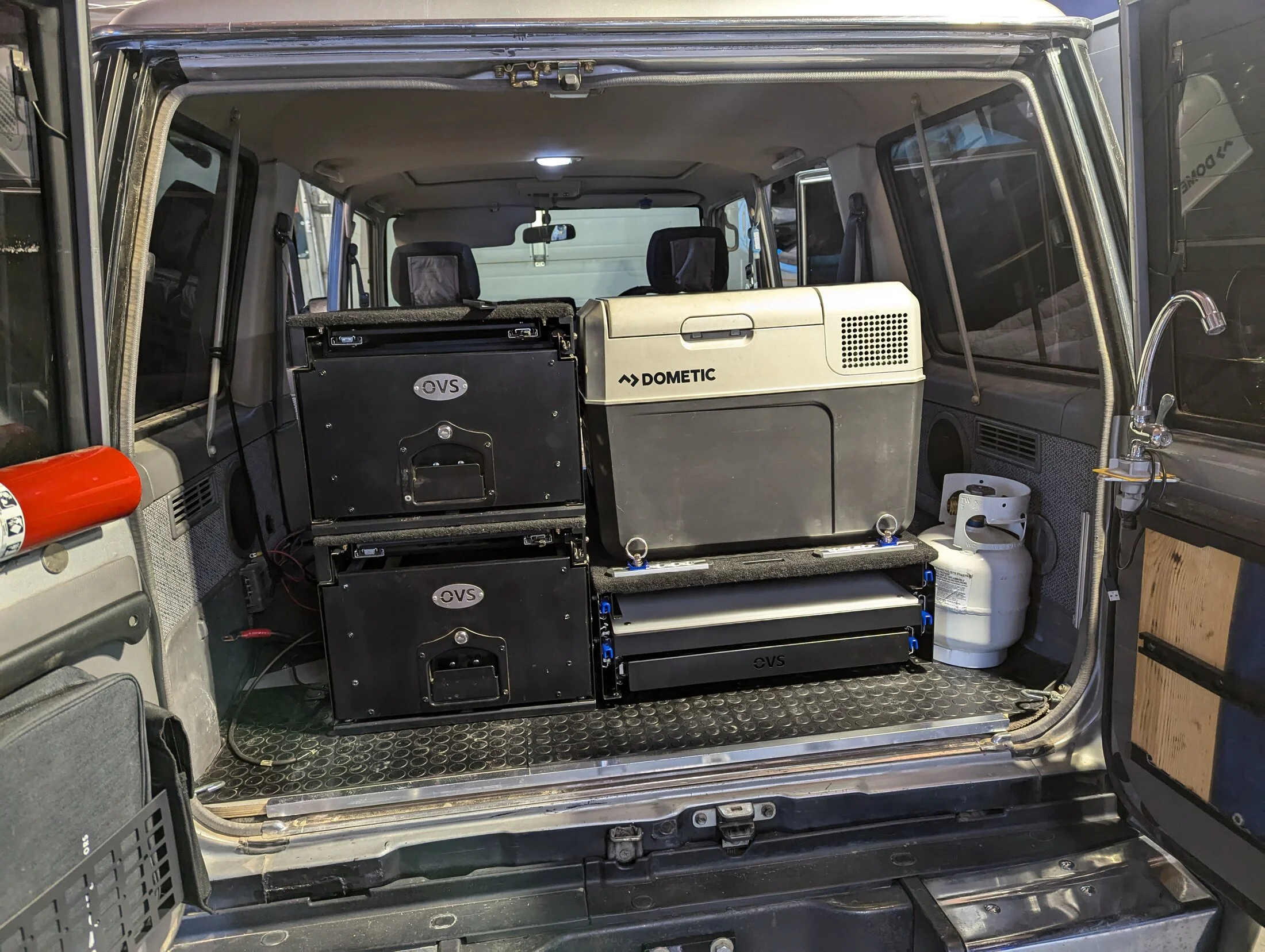

The galley is already built out of the back of my truck and is pretty well-tested so I figured I'd leave it there. 270° awning covers the back doors nicely too.
Also have a drop down table for quick stops and morning coffee, plus 50 liters of water on board with pump. This already works well so I don't see a need to weigh down the tongue with more boxes etc...?
That galley would work well for a RTT. Also for short trips or places that would prohibit a trailer.
That's what I built it for in the first place but I think I'll keep it for the trailer. Also good to have all your cooking and food in a solid compartment in bear country, separate from the sleeping area, although if they "really" want in then my 70 series is probably not gonna stop them.

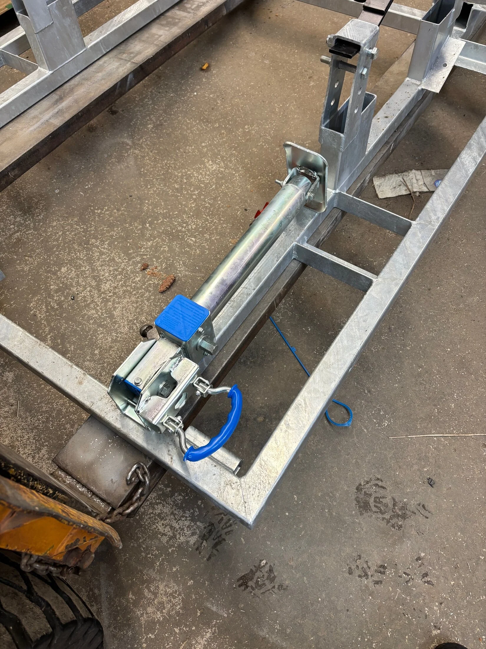

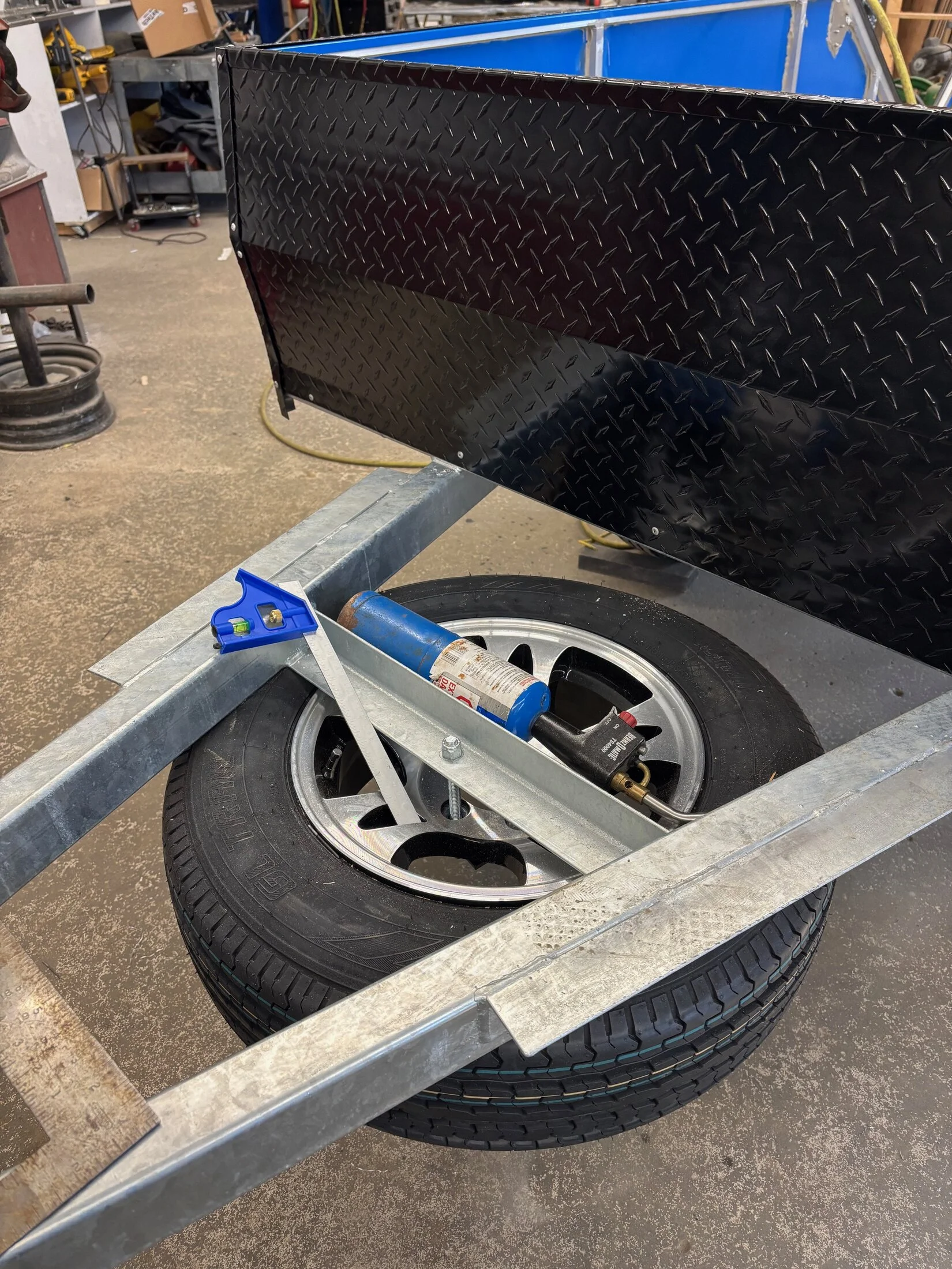

Got an update today. My sides are going in for powder-coating this week, and my rear corner steadies finally arrived from Australia, after getting delayed by the Canada Post strike. The guys at trailersrus (aus) were great to deal with BTW... (these jacks weren't available in North America at the time of ordering). Kamparoo now has the jacks in place on the frame. It looks like my leaf springs are getting mocked up too... The trailer is pretty narrow so putting them lengthwise allows me to have the long ones.

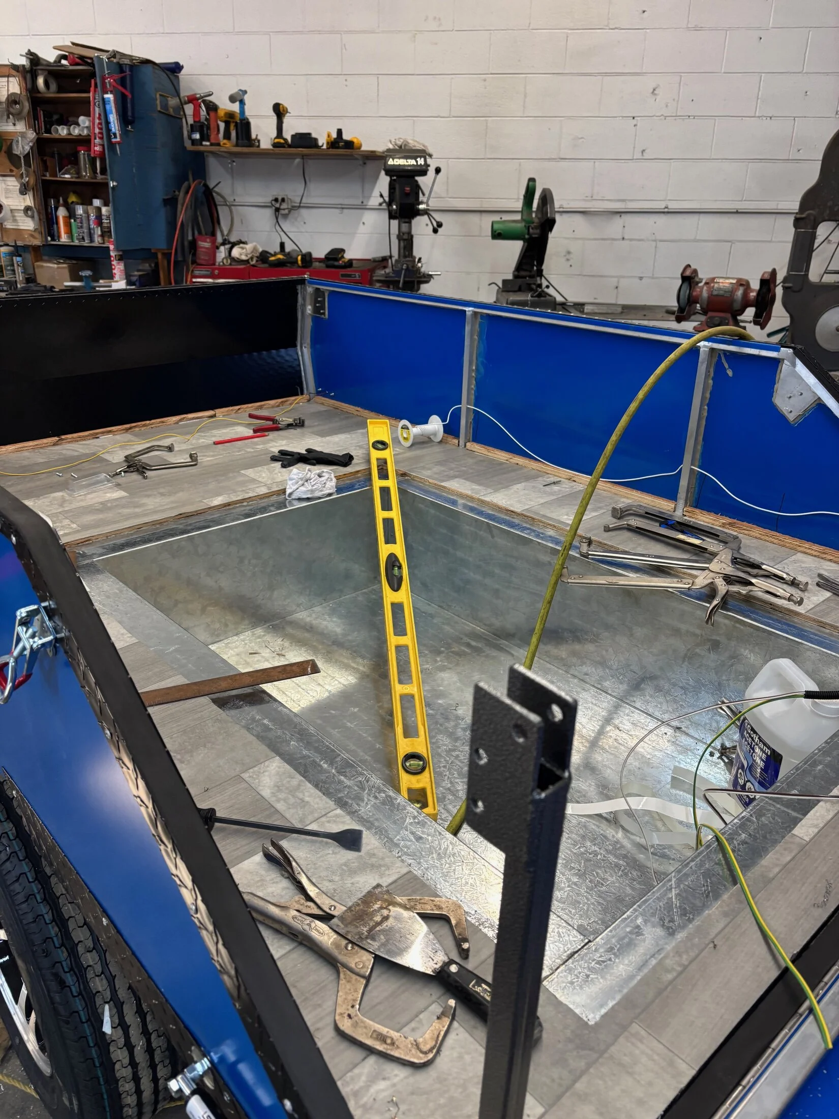

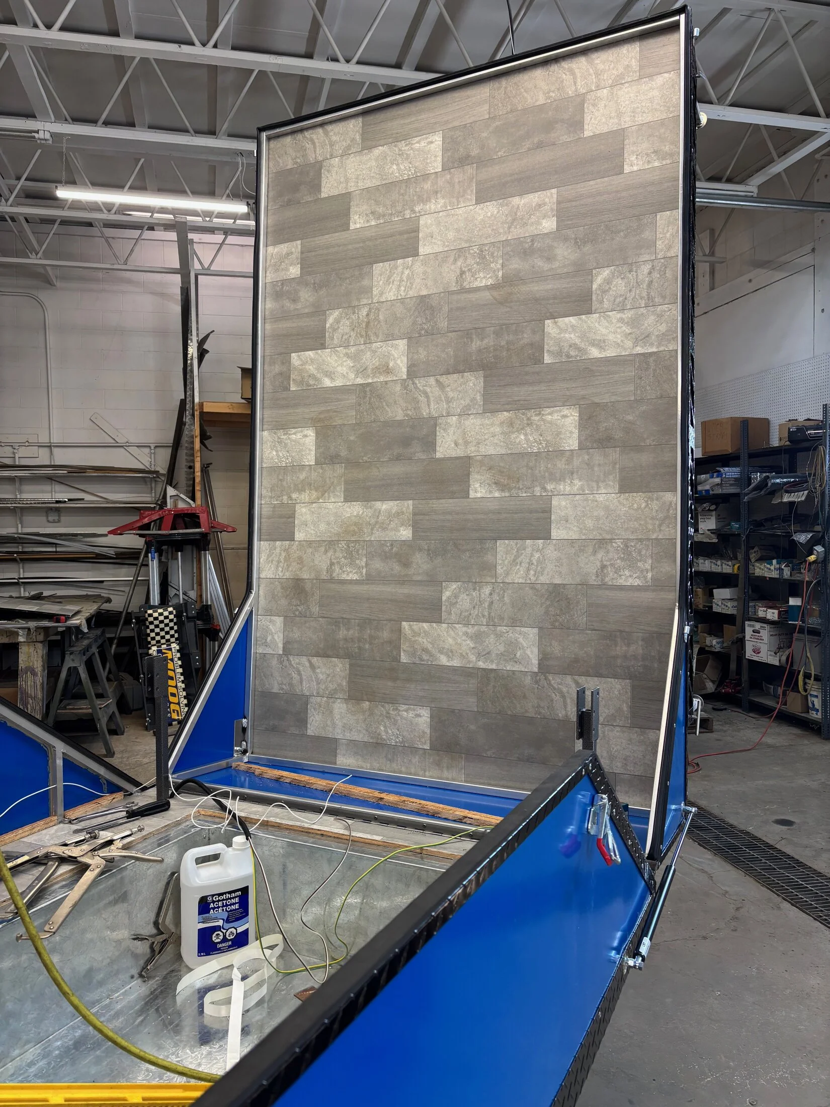

The body tub is beginning to go together now. Here is the floor when opened (and roof when closed).

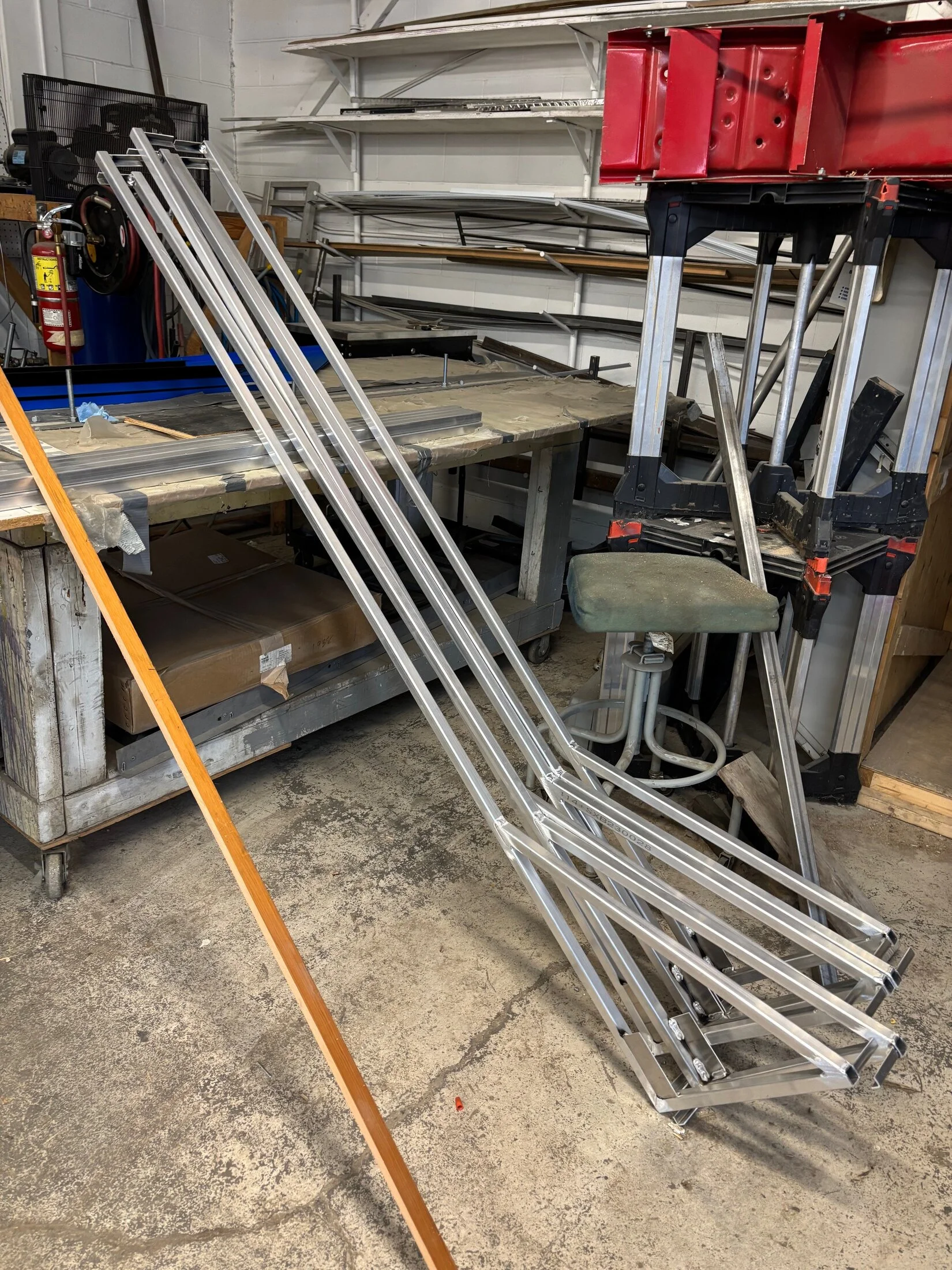

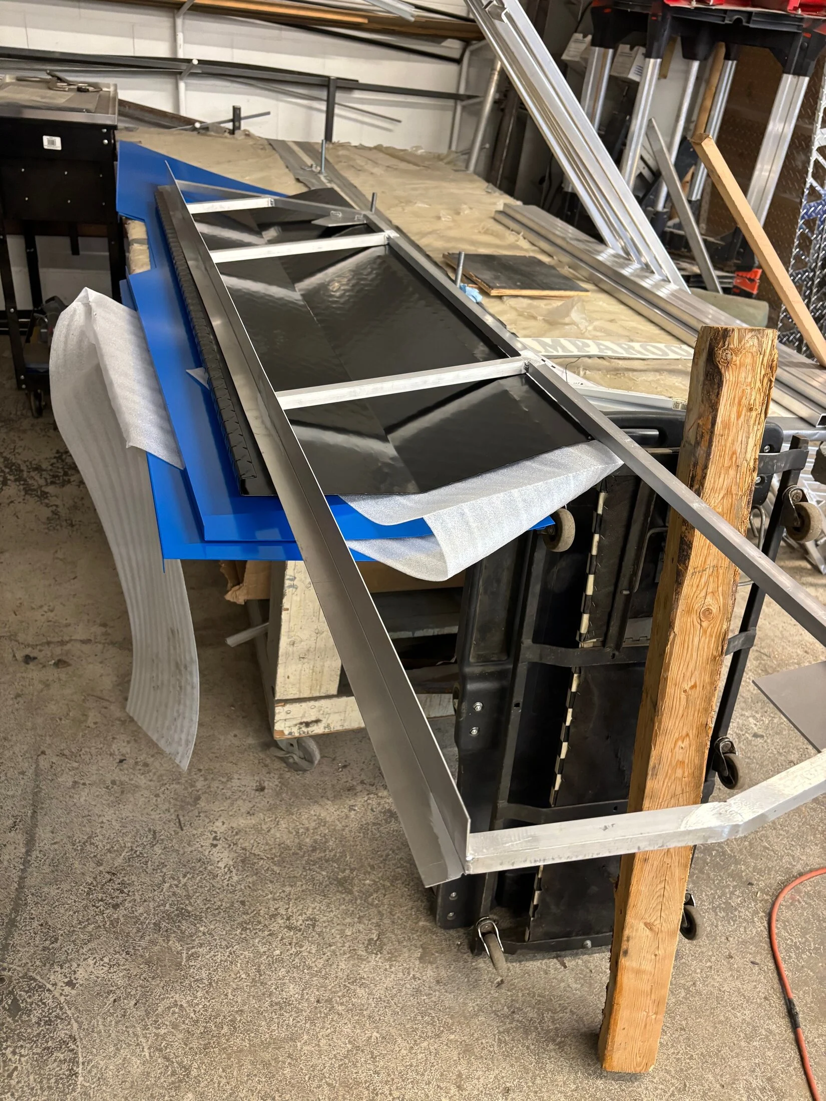

And just to give a little insight as to how it is structured, here are some of the frames:

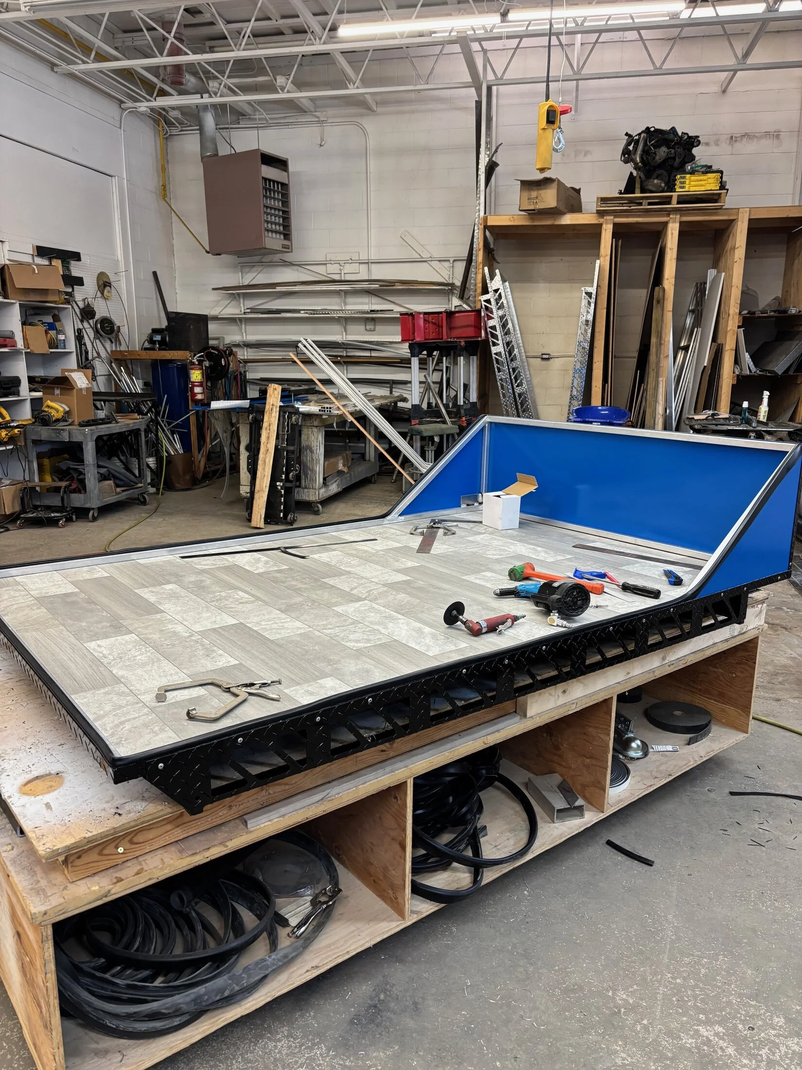

And finally, here is the nose panel and frame:

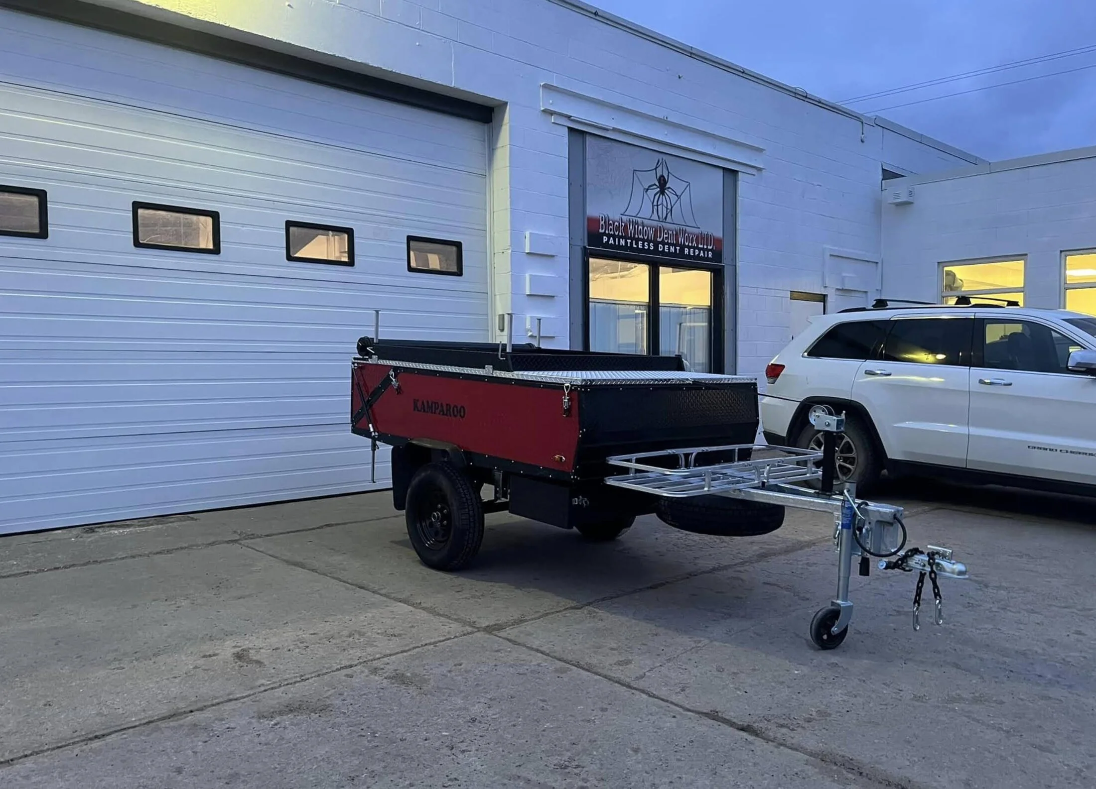

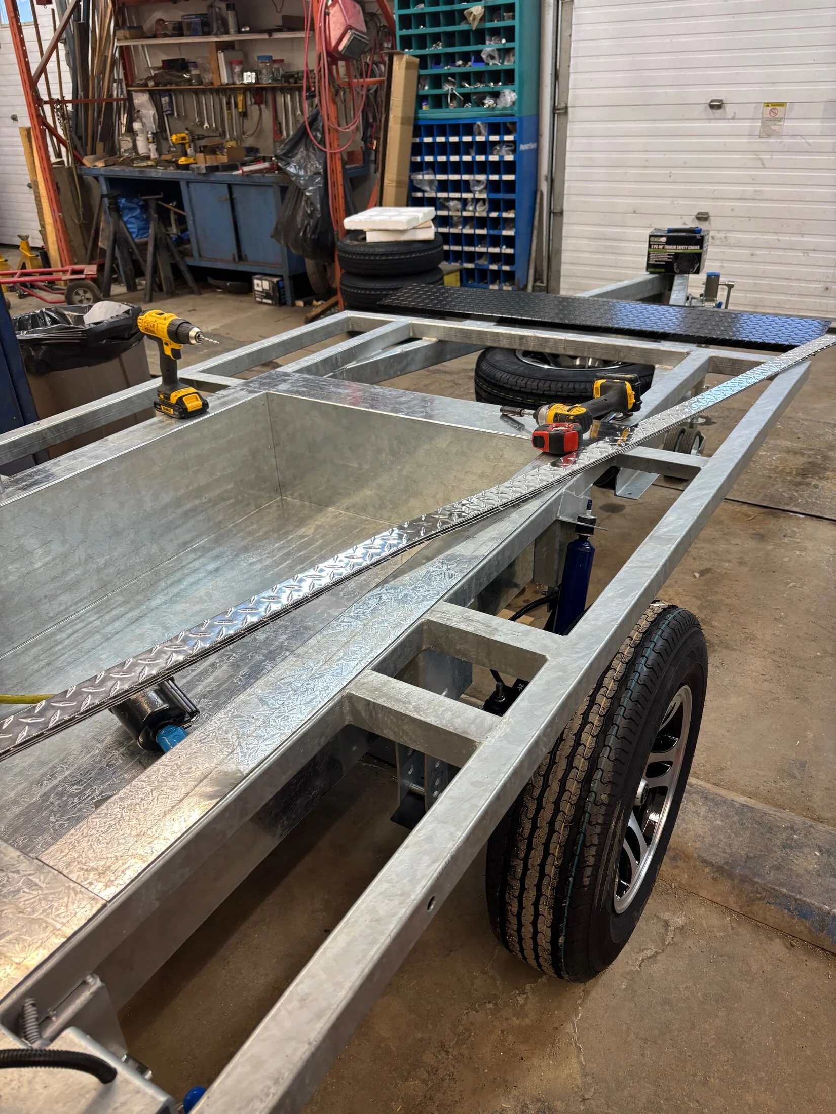

Just got some fresh build pics. Finally I can see all my choices and additions coming together. The only downside I can see so far is poor old Betsy is going to show her patina a little more when this is behind us. At least she has her retro stripe... ;)
