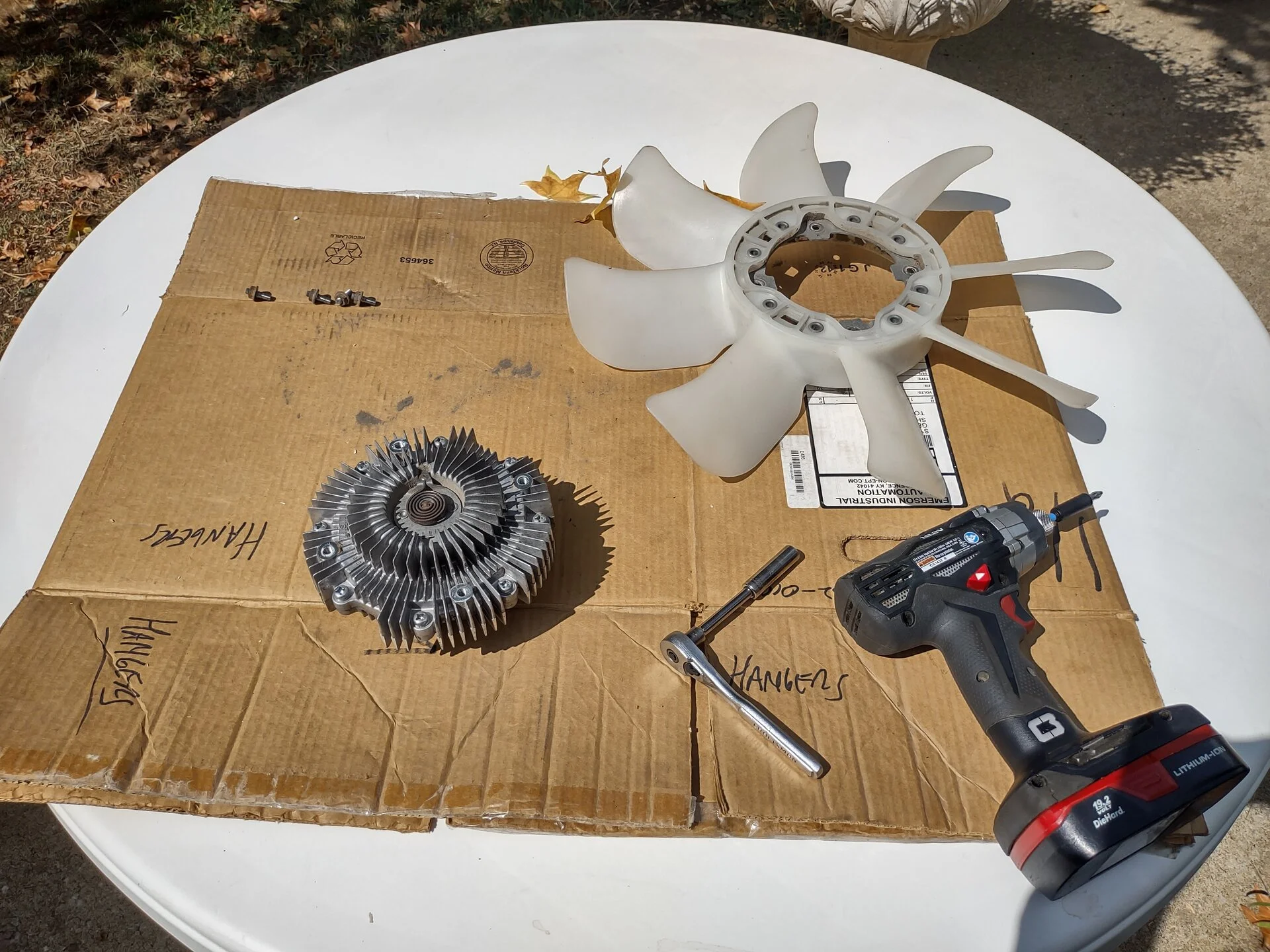

I finally removed my Aisin blue hub to service it.
Thanks @jpoole and @77mustard40 for your information above.

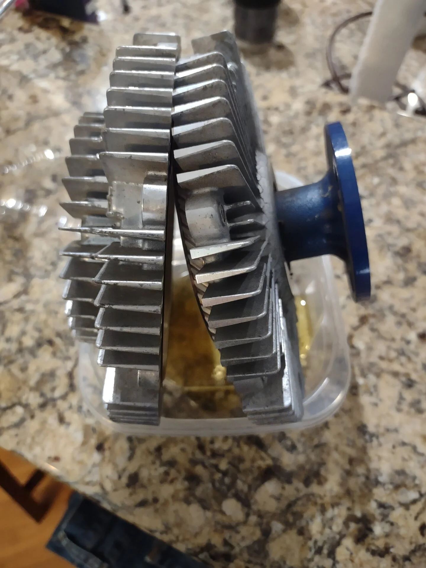

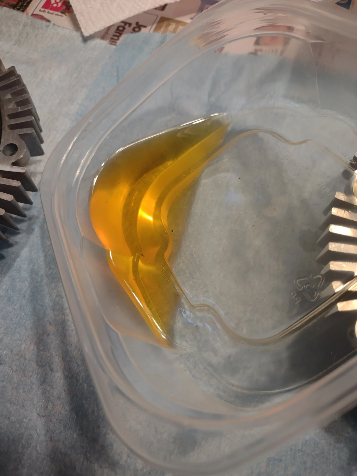

I opened my hub that is about two years old and has about 30K miles on it. I was seeing temps spike at 206°F on an 82°F ambient day while climbing a hill at 75 MPH. It should not be seeing temps like that unless it's 100°F ambient.
I drained the hub overnight into a disposable plastic meat tray.

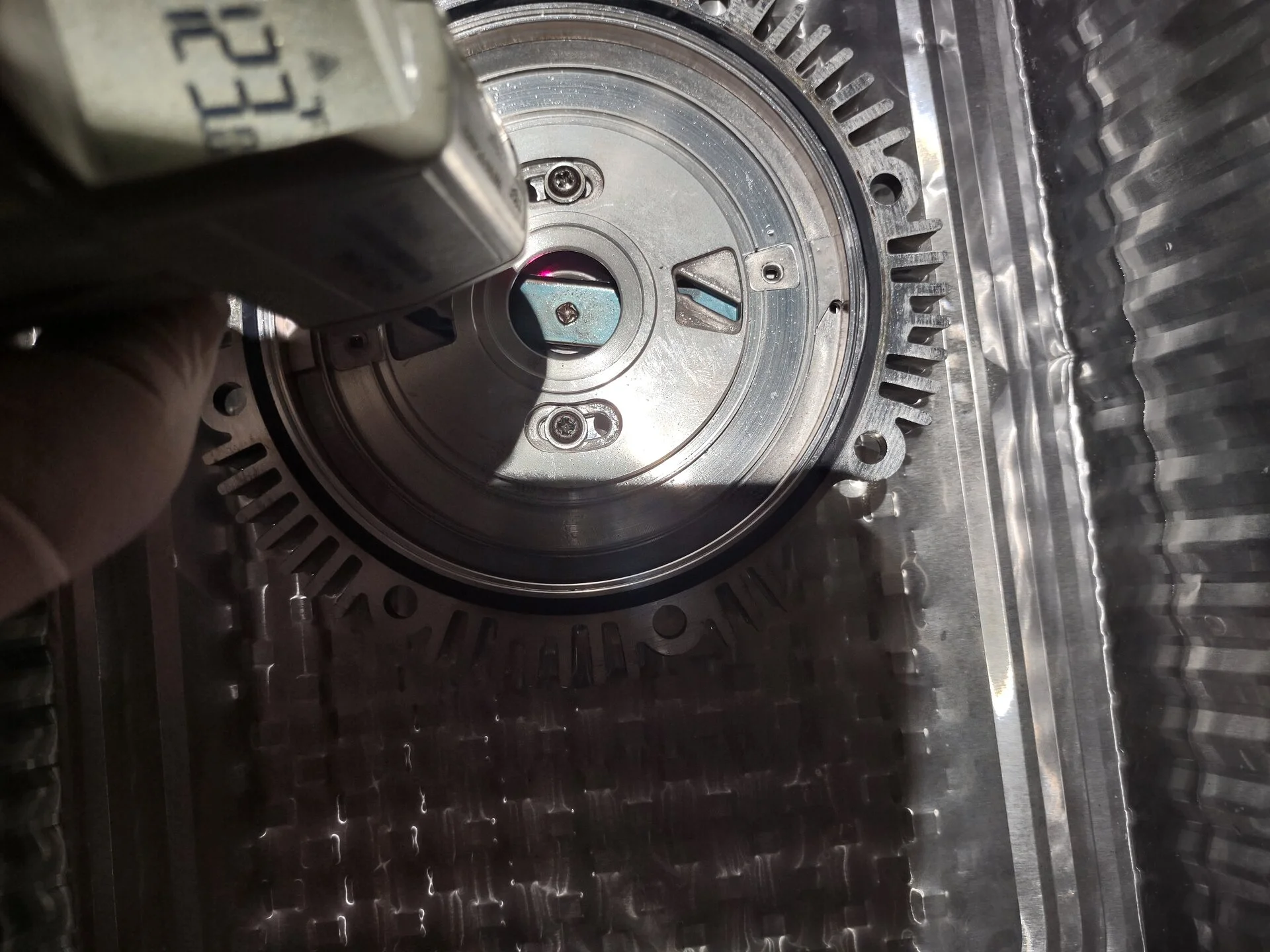

So, I temp tested the thermostat part of the hub in a pan of water. At 109°F it didn't budge.
At 126°F it didn't budge.
Finally at 134°F it finally started to open. The screws were already in the center of the travel.
So, I increased the water temp to 144°F and figured out where it was. Then I loosened the set screws and moved it so it was more open at 134°F than it was before. I expect it to open sooner on temps.

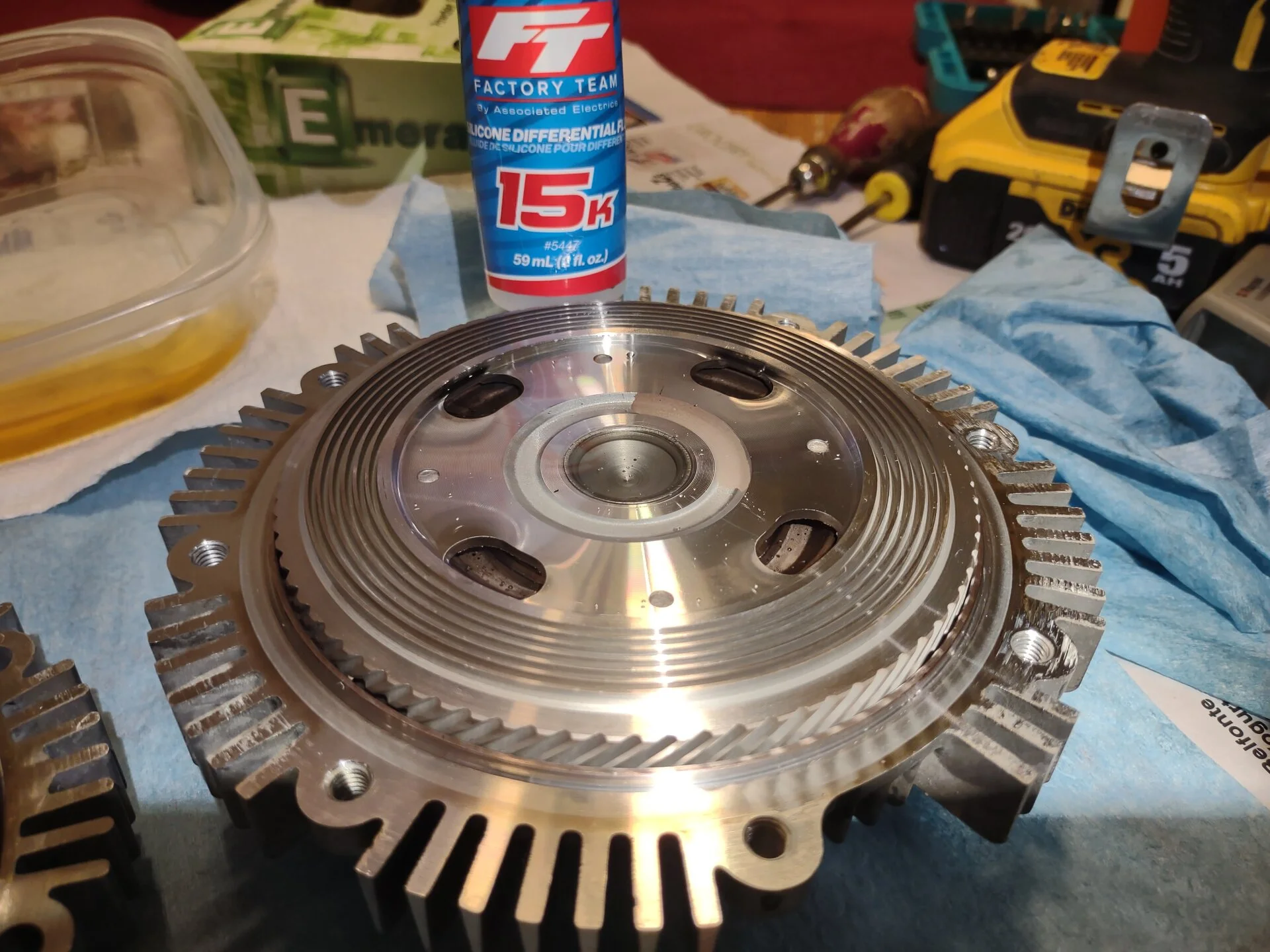

I put in about 55 ml of 15K CST silicone oil. Not sure if that's how much came out, but I filled the non-thermostat side of the hub so it was just under level full. Then I installed the thermostat half and tightened the screws with my impact screw gun. I used a #3 Phillips tip in my screw gun.
I cheated and didn't even loosen the belts to remove the hub. I put it back on and SLOWLY worked my way around the hub until all four nuts were Gutentite.

Your data points helped me figure out a place to start. I was way overthinking this and kept wanting to make it much harder than it was. It still took me a couple hours to do this, but I go slow and sometimes it takes me longer to find my tools. I used my I.R. gun to check temps as I couldn't find the candy thermometer.
I used a disposable aluminum turkey pan, set the thermostat hubs in the pan, then ran full hot water from the tap into the pan. Our water heater achieved 120°F.
Then I boiled water in the teapot and added 170°F water until it got to about 164°F in the pan, then watched what it was doing.

I've used the opening/closing of the small port when setting temps and it looks like you were looking at the larger diagonal port and when it started opening? Maybe that's why you are looking at higher temps than the frequently mentioned 100 or 95 degrees F? It shouldn't really matter either way as you were familiar with the engine's operating temps and simply adjusted a little from where it had been which seems like a good idea. Opening 10 degrees earlier with fresh oil as well should yield a noticeable improvement.

Good thread. This issue pops up every once in a while... in my experience the Aisin blue hub clutch right out of the box will be much better that your 25+ year old clutch.
If you spend a little time and clock the opening temperature of the ports and replace the fluid with ~15k fluid (if I remember, it takes about 60mL to fill (2oz is about 48, right?).
I set mine to open up at about 180*. It sticks to that temp like glue. If I'm crawling, or going uphill and it's really hot or something, it'll rise to about 205-210.
2 oz = 56 ml according to the bottles I bought.
One data point said they added 45 ml.
I added from the 56 ml bottle until the bottle did the first "empty ketchup bottle splooge" and then stopped. I'm guessing that to be about 55 ml. The non-tstat hub was almost level full sitting upside down on the table (in the best orientation to install the screws)

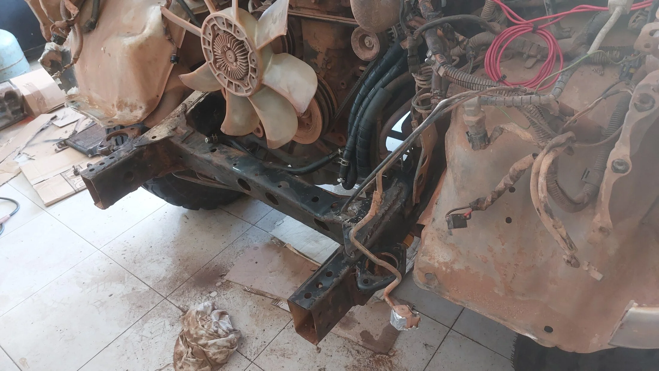

Last winter we were in the Amazon and Bolivia in quite hot conditions. Had some AC issues most of which we have solved now. We are monitoring the engine temp tru the OBD2, AC condensor and evaporator are new or reconditioned, compressor and fluid level are ok. However at idle speed the AC is still poor. I am suspecting the fan clutch, which as far as I know has never been checked or serviced.
We are living in the Netherlands but the car lives in Surinam with temperatures in the dry season of 30-35C (85-95F) and 80% percent of humidity.
As parts are sometimes difficult or expensive to get in Surinam I am trying to prepare and bring everything with me when we leave for Surinam end of the summer.
I am pretty confident that this clutch can still be serviced. All the 'red' in the picture is not rust but red laterite from the roads. If everything fails I can order a new clutch from the States.
Can anyone tell from the picture the make of the fan clutch? I believe it is still the original and has never been serviced. (LX450 1997)
For this clutch, can I adjust the opening temperature and what temperature should that be?
What cst value of silicon oil is best to be used in the given temperatures?
How much silicon oil should be added.
Does anybody have the partnumber of the o-ring or otherwise the o-ring thickness/diameter,
