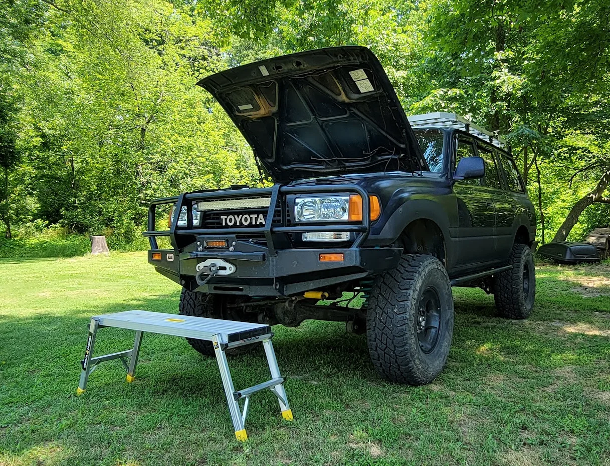

I had similar issues but when idling my temps would climb, moving temps would swing between 182 and 190. Luckily, I had a spare fan clutch. I installed the new fan clutch but when I pulled out my old one I spun it by hand and it had normal resistance. I never tested it while it was on the truck. Walking back to my garage to put the fan clutch in my Toyota spares bin and I spun it was more time and there was zero resistance and spun like it had bearings inside of it :(. My guess is not enough fluid in the clutch.
I'm 6'2" and still needed a ladder to reach the fan clutch.
