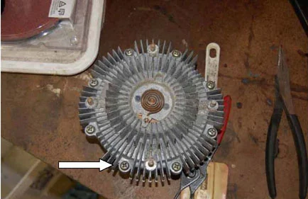

Start by removing the 8 screws indicated in the pic with a #3 Philips screw driver.
Once the screws have been removed the two half can be separated, there will be some suction while doing this.
Be sure to keep the clutch horizontal, otherwise the oil will run out.

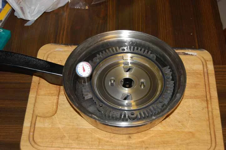

Once the two have been separated the half with the spring on the outside needs to be warmed to 95*.
What I've done is to place about an 1.25 inches of water in a sauce pan and heat it to about 110*. I then placed the control side, spring down into the pan and place the pan on a wooded cutting board. The cutting board helps slow down the cooling process so I have time to make the adjustment.
Since the pan with water in it will cool at the edges faster than the center where the spring is at, it's important to occasionally lift the clutch up and down to help circulate the water and minimize that effect. I did this every few minutes and then more frfequent when I got closer to the target temp.
Attached is a pic of how I had it set up.

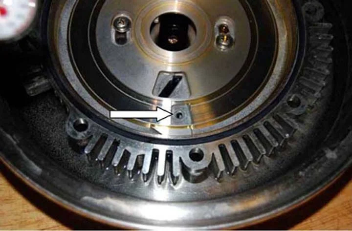

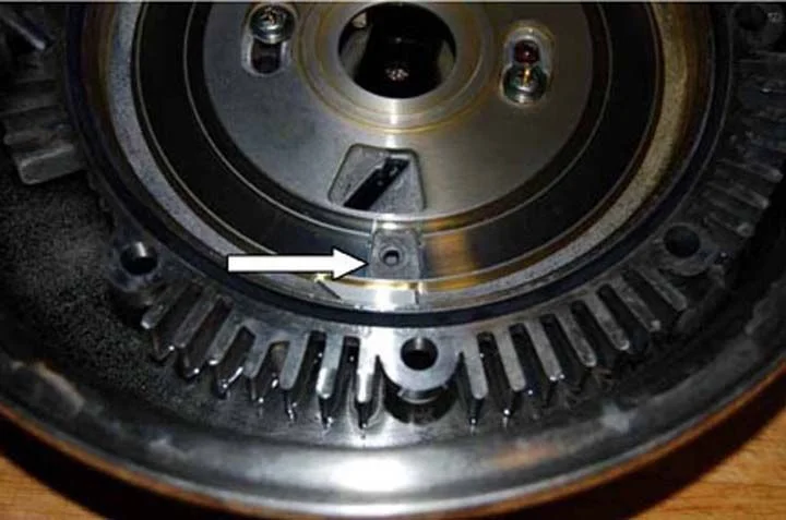

Once you've reached 95* it's time to adjust the control plate.
There is 2 #2 Philips screws that once loosened the plate can be rotated.

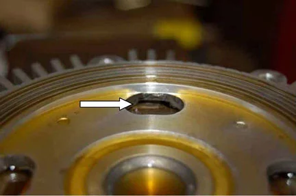

You'll need to sight threw one of the small round holes and adjust the plates position so that half the hole is open and the other half is blocked by the valve.
If the holes don't align perfectly to each other one should be 50% open and the other should be more than 50% open.
Attached are two pics that show an open hole and one adjusted properly.
The top pic is when the temp of the clutch is greater than 95* yielding an open hole.
The bottom pic is after the control plate has been adjusted by rotating it into position once the temperature has reached 95* You can see that the valve is dissecting the hole leaving half of it open

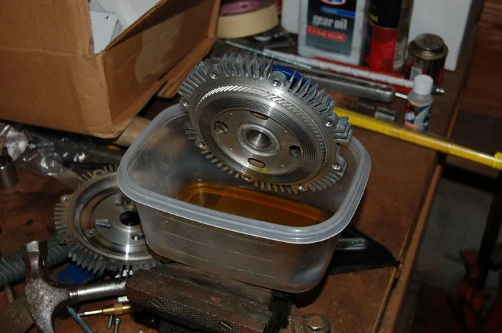

The first pic shows how I positioned the clutch to allow the oil to drain. This will take a few hours minimum, overnight would be best.

You'll want to add oil to all the holes as this stuff is pretty thick and doesn't flow easily.

Step #4 is a little confusing to me. The pics of the 2 holes appear identical and the explanation has me a little confused.
Is the "desired" relationship of the 2 holes at 95* with the 50% overlap? ... or perfectly aligned (no overlap)?

To confirm, these guys (in red) are the ones you loosen? Also, how close to center of the slots were they before you started?
Yes Dan, those are the ones you loosen to rotate the plate and the plate was no where near center when I first opened it up. It would be only a guess if I was to make one but I really didn't move it that much as far as distance goes. But the move was in the counterclockwise direction when looking down from the top.

Nice write-up. It's hard to tell from your cook picture, but I presume the spring half of the clutch is fully submerged in water? What did you do to insure all the water was out of the unit before reassembling?

The unit is only placed in water, contacting the outside of the clutch, but the spring is submerged. The water isn't high enough to actually enter the area that would be inside the clutch once re-assembled.

On the valve, some when opened are even on both holes, others are slightly off, one hole open a little more than the other, this isn't a problem. The idea is to get them about half open between the holes, If one is 40% open and the other is 60% or whatever that's OK, it's not that critical just an indicator to set the opening temp by.
