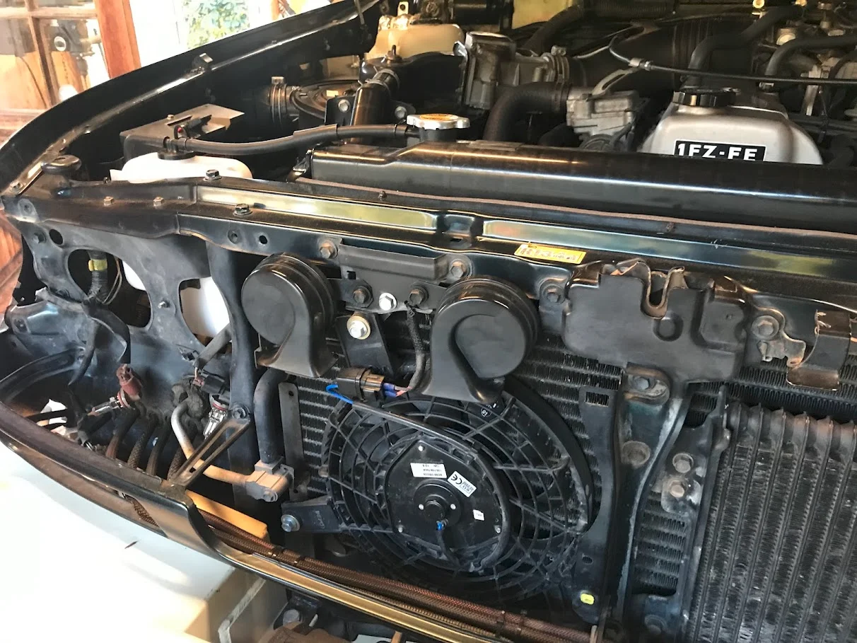

Consider installing a 100 series auxiliary fan.
In some markets the 80s had them.
I run one and they really help in the condition you speak of.
I was just wheeling in 95 degrees weather in Utah and the AC stayed cold setting still in Direct sunlight.

Ok, I meant the aux fan on the left in your picture.
Yep that’s it.
I got it few years ago and I think it’s been out of stock.
You could get one from somebody parting a 100 series or a junk yard and wire it yourself.

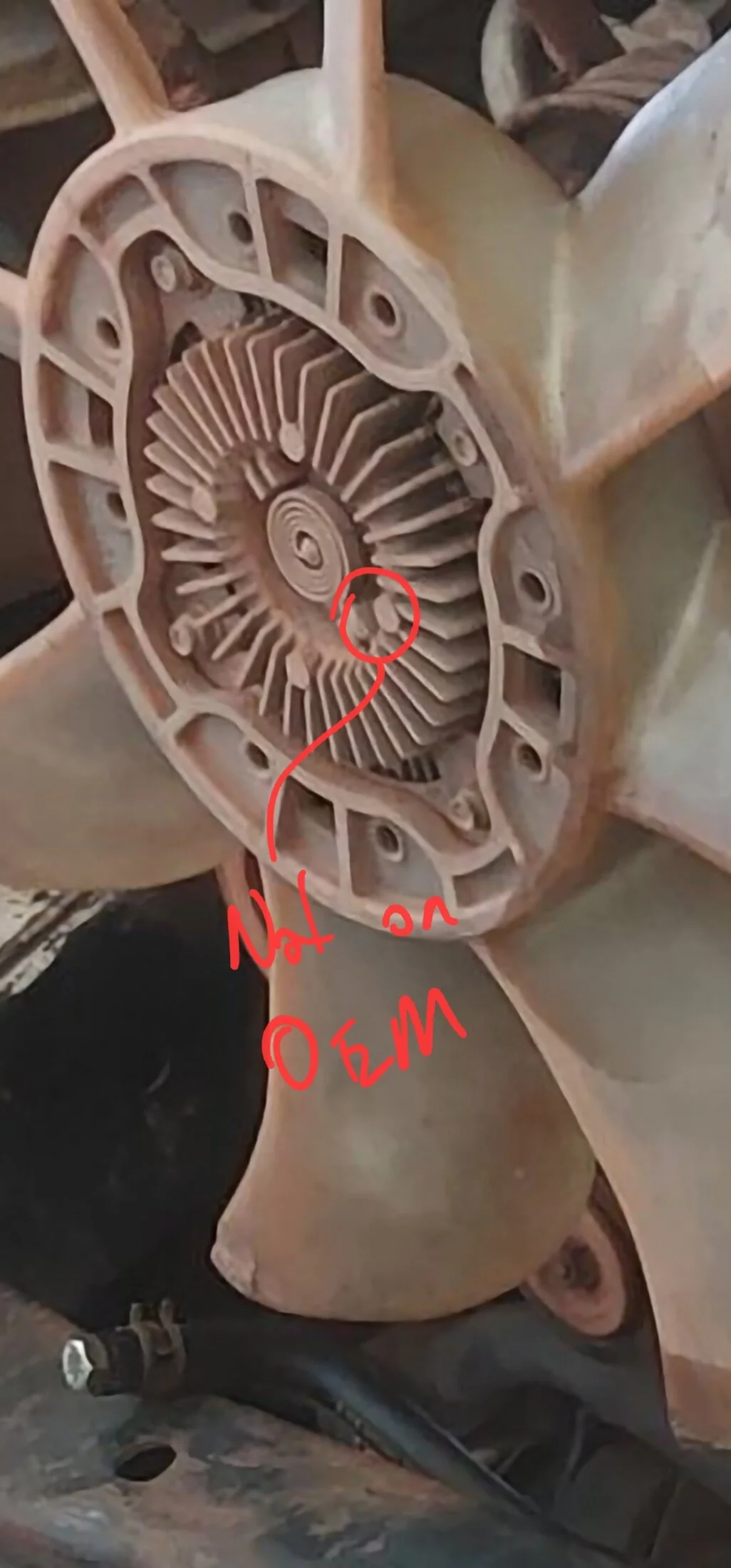

Can anyone tell from the attached picture which FC this is. Eaton, Aisin, ... I think it is original (LX450 1997), but want to know the manufacturer so I can filter all the info on this forum.
I don’t think so.
Someone would have chimed in already
Most likely Aisin
I did an image search using the part numberfor the oem clutch.
I don't believe yours is oem.
The four round bosses between fins on yours are not present on the oem clutch. ( one circled in red)
The link i posted to Partsouq.com is a genuine oem aisin clutch. USD.
They ship all over.
If you're weighing up $180 for an unknown part vs ~$200 for an oem aisin to suit your vehicle, I'd be going for the oem item
Like @mudgudgeon said get the new Aisin !
This is a critical part in keeping you Cruiser running correctly into the future.
And looking closer your fan is also damaged and ready to take out the radiator.
Replace the Fan clutch and fan both.
