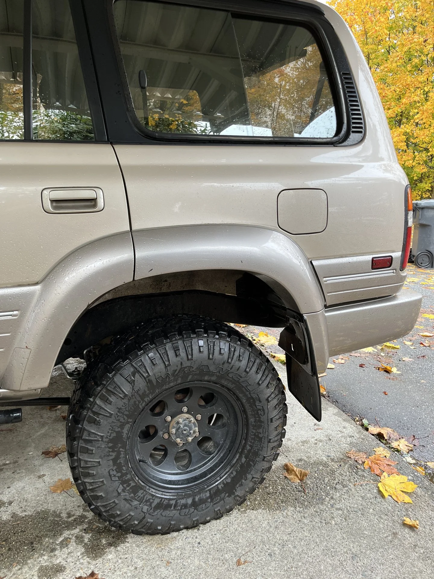

- Custom front sway bar link extension
- Metal Tech rear sway bar link extension

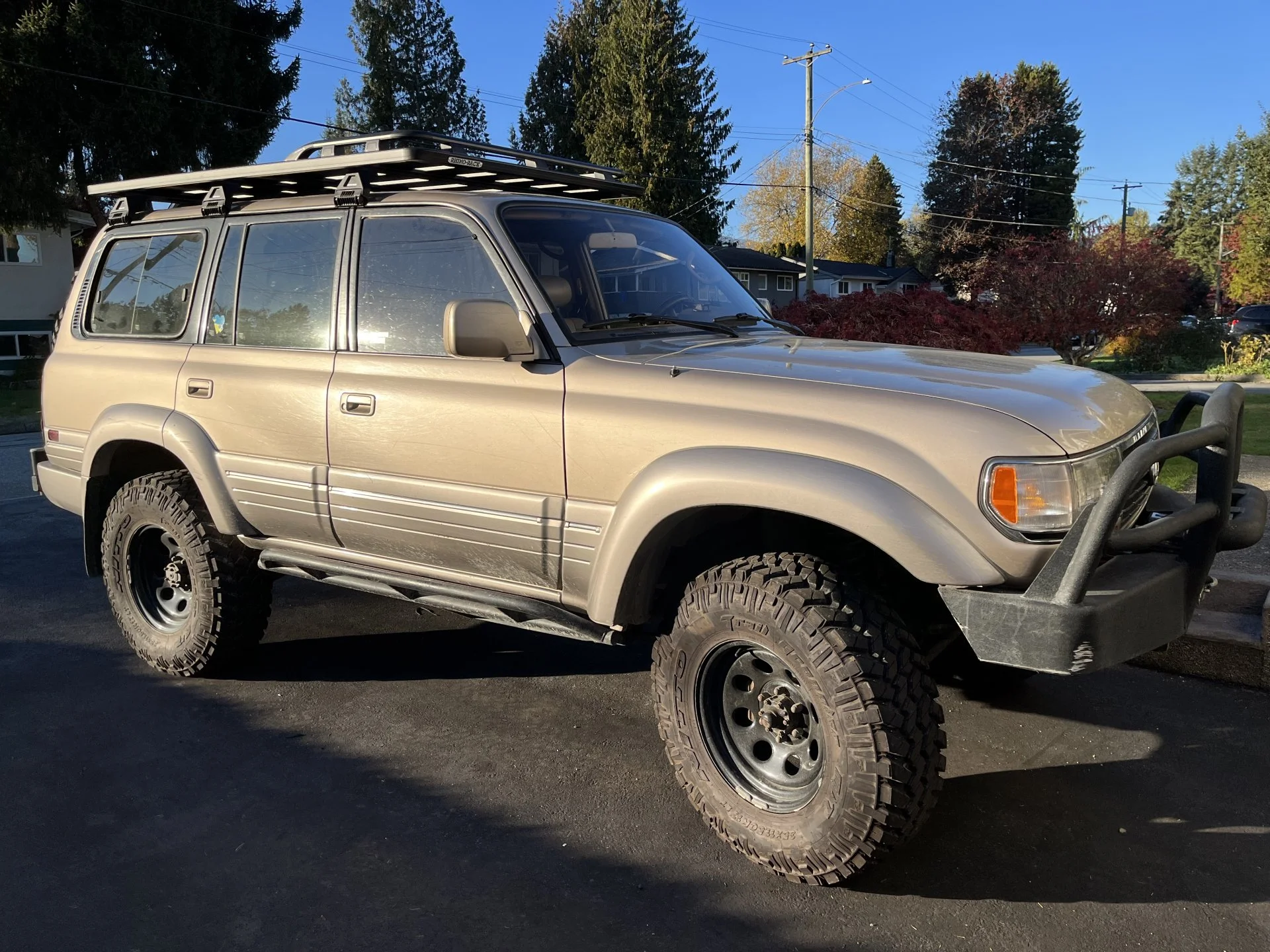

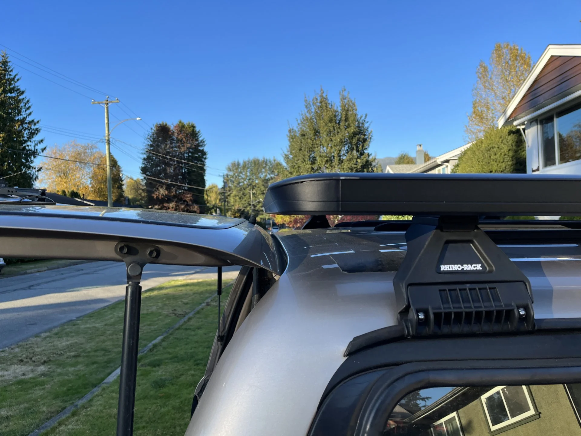

- Rhino-Rack 52104 roof platform with quarter rails.

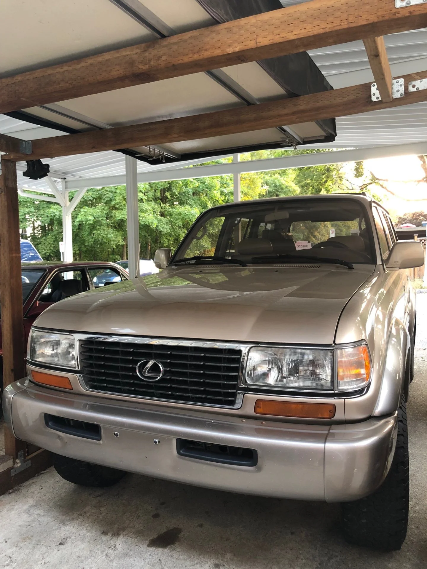

So what I've got:
Lexus LX450 1997, Canadian specs. 276k km, factory lockers, virtually no rust on the body except a couple of small scratches and front wheel wells.
Absolutely stock except bold 285/75R16 BFG AT tires and 1 1/2" coil spacers front and back.

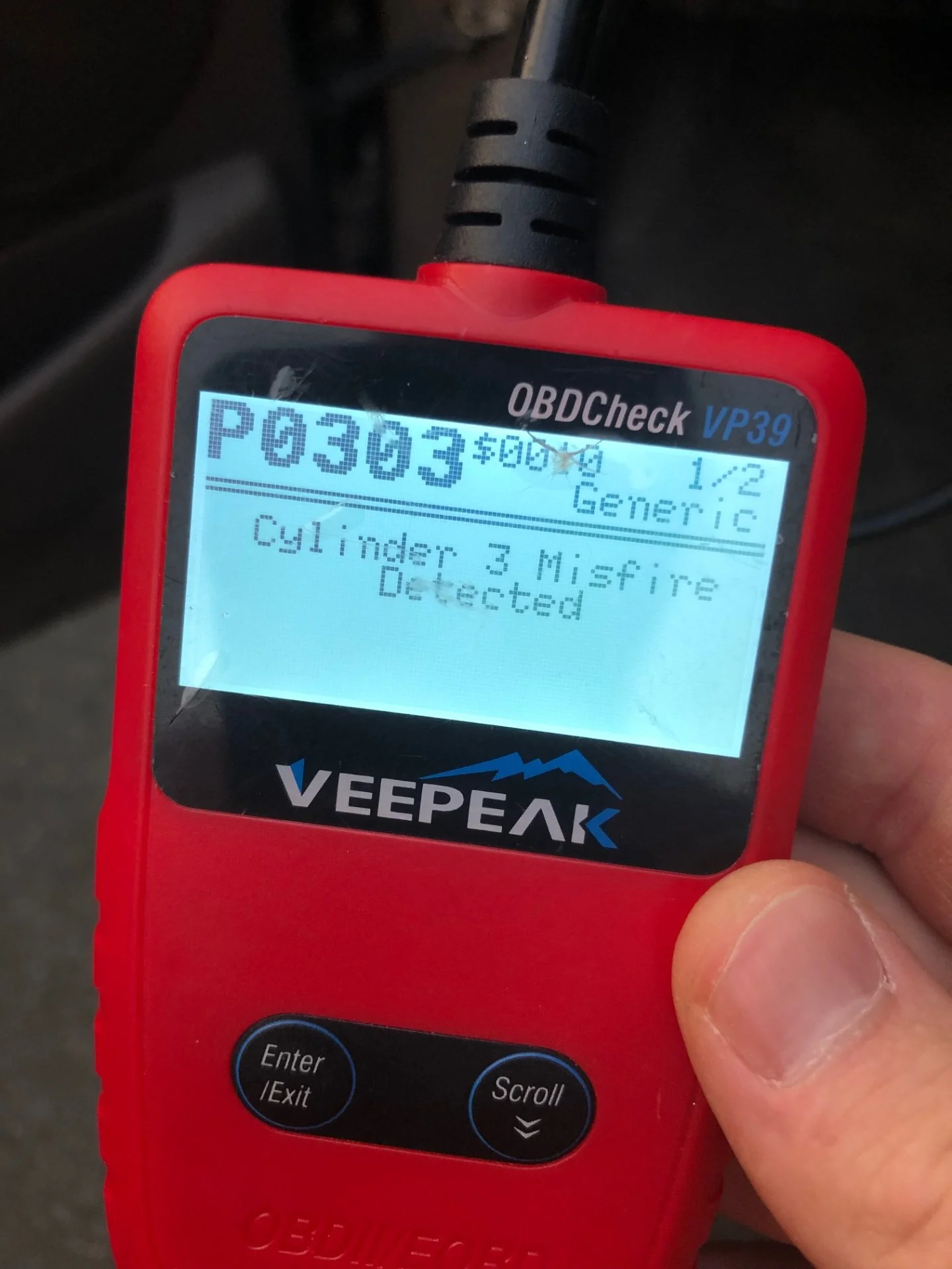

Its character became apparent when I left the seller's house. After the first 1-2kms there was clearly a misfire.
Quick call to the seller - "it never happened before!". Could be true. There was no misfire when I checked the vehicle four weeks ago and negotiated the price.
OK, I got home somehow. The misfire mysteriously disappeared after 50km drive on a highway. I guess there was some water left after washing the engine or something like that but it never happened again. Yet.

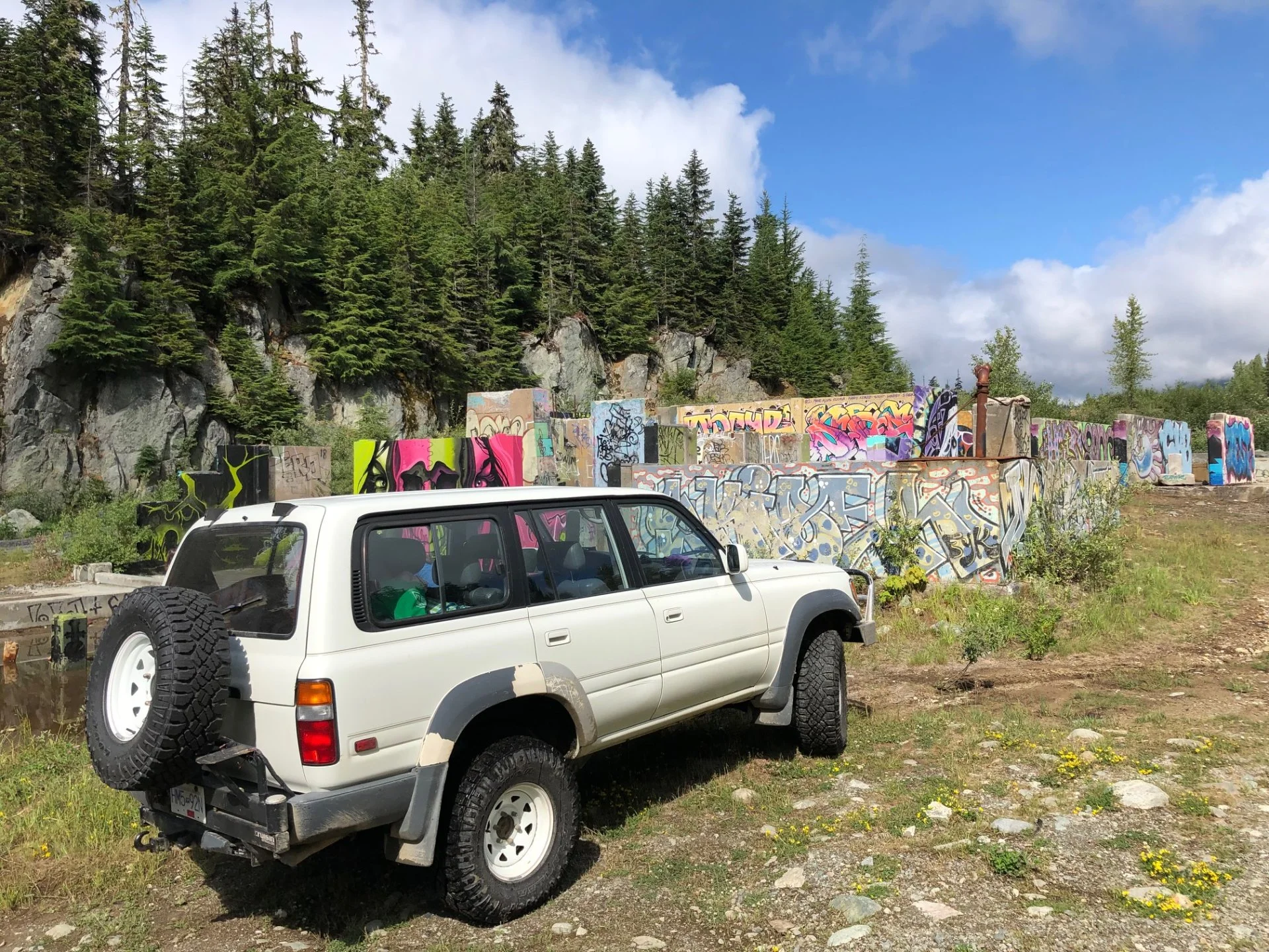

The plan for the truck as of August 2021 was:
OME J-springs, L shocks, castor correction, armor, 35-36" tires.
As of November 25 2021 I've got some progress already. Will post the updates soon.
I'm actively wheeling the truck including trails that are more like rock crawling obstacles.

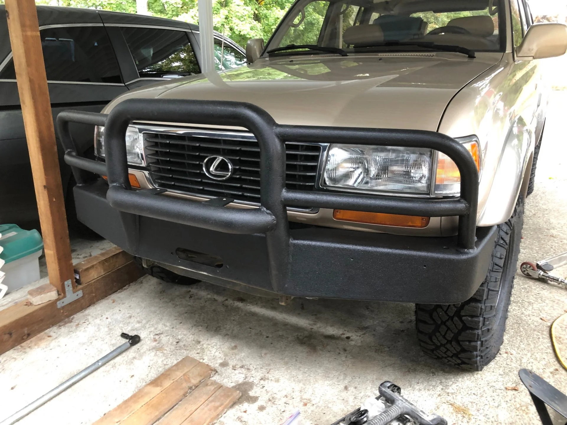

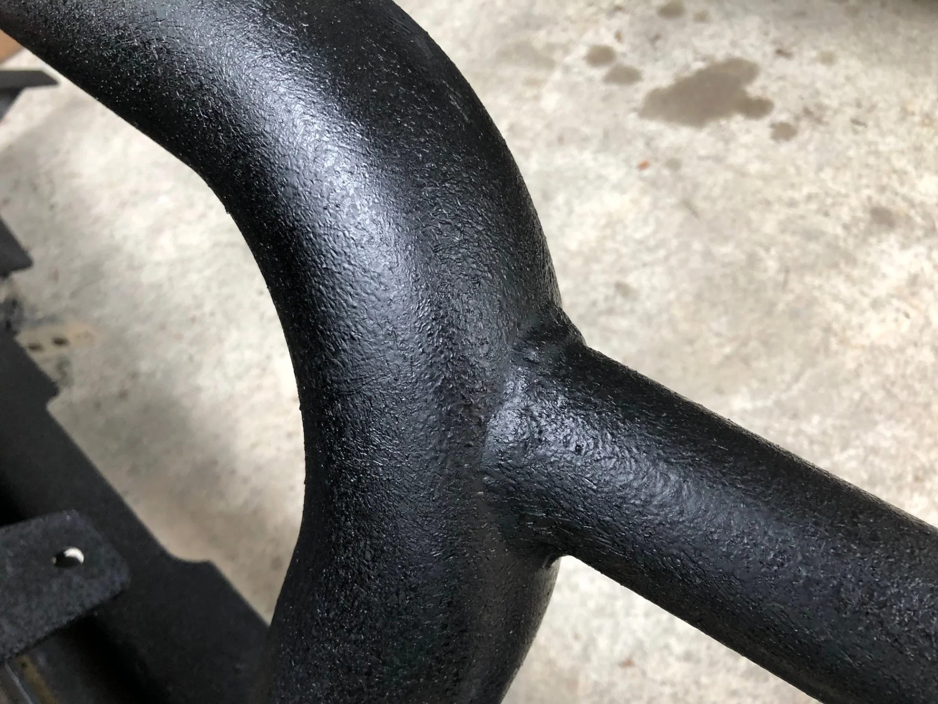

I really like the aluminum bumper I had on my old truck so I decided to take it off, paint in black bed liner paint and use on the LX450.
Sanded the bumper:
End result after two coats and texturing:

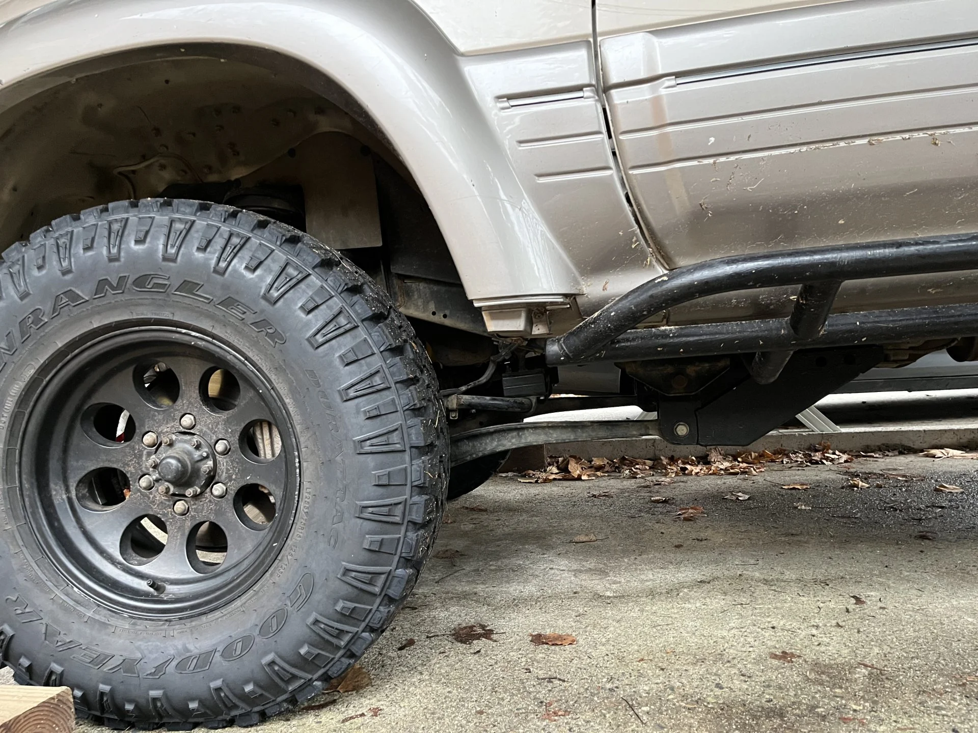

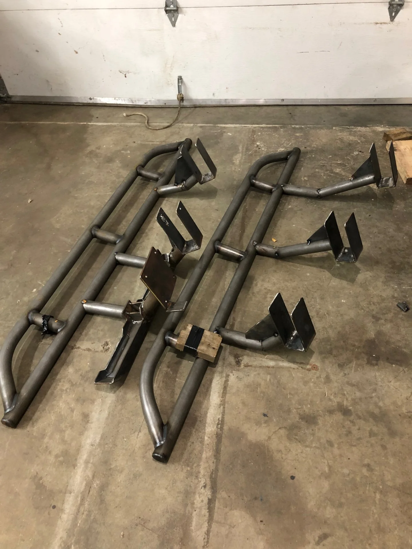

Trail Gear sliders with custom made mounts. The cats on FZJ80 are PITA to work around. Mounts for the FJ80 would be way easier to make.
First trip with the new armor:

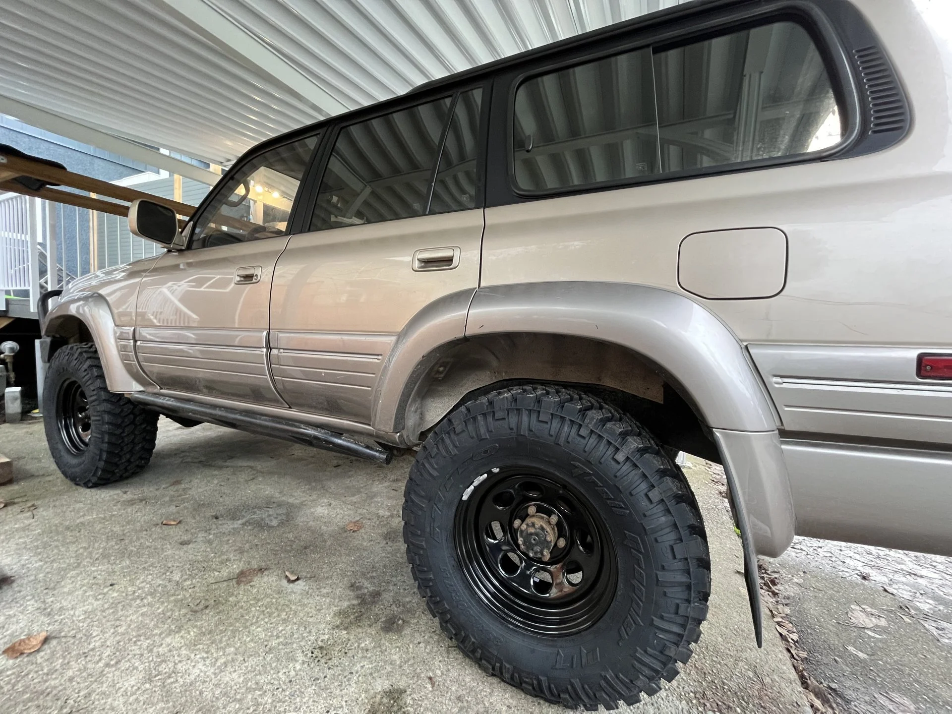

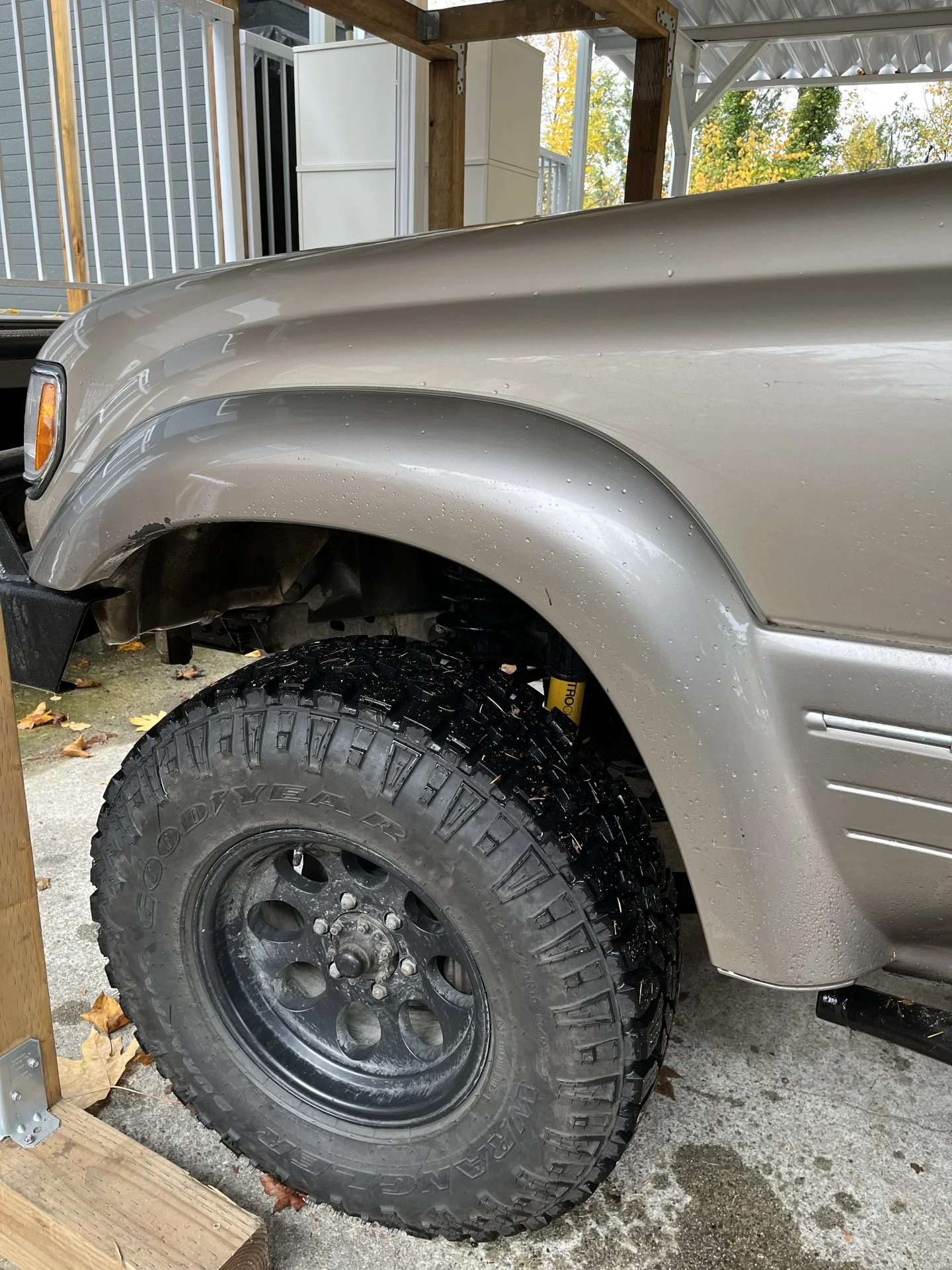

At this point the truck got 285/75R16 Duratrac tires on aluminum ION rims. My budget isn't unlimited so I plan to stick to this set for some time.

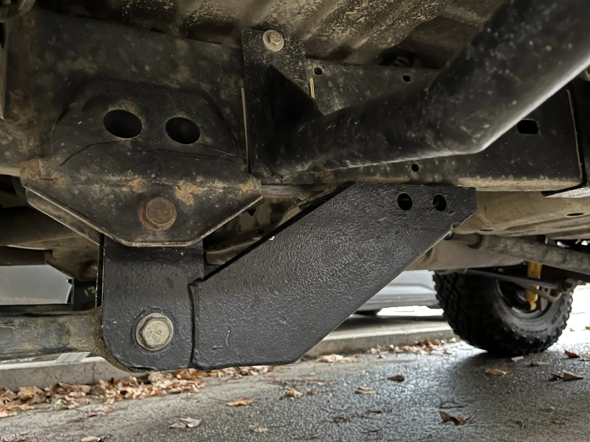

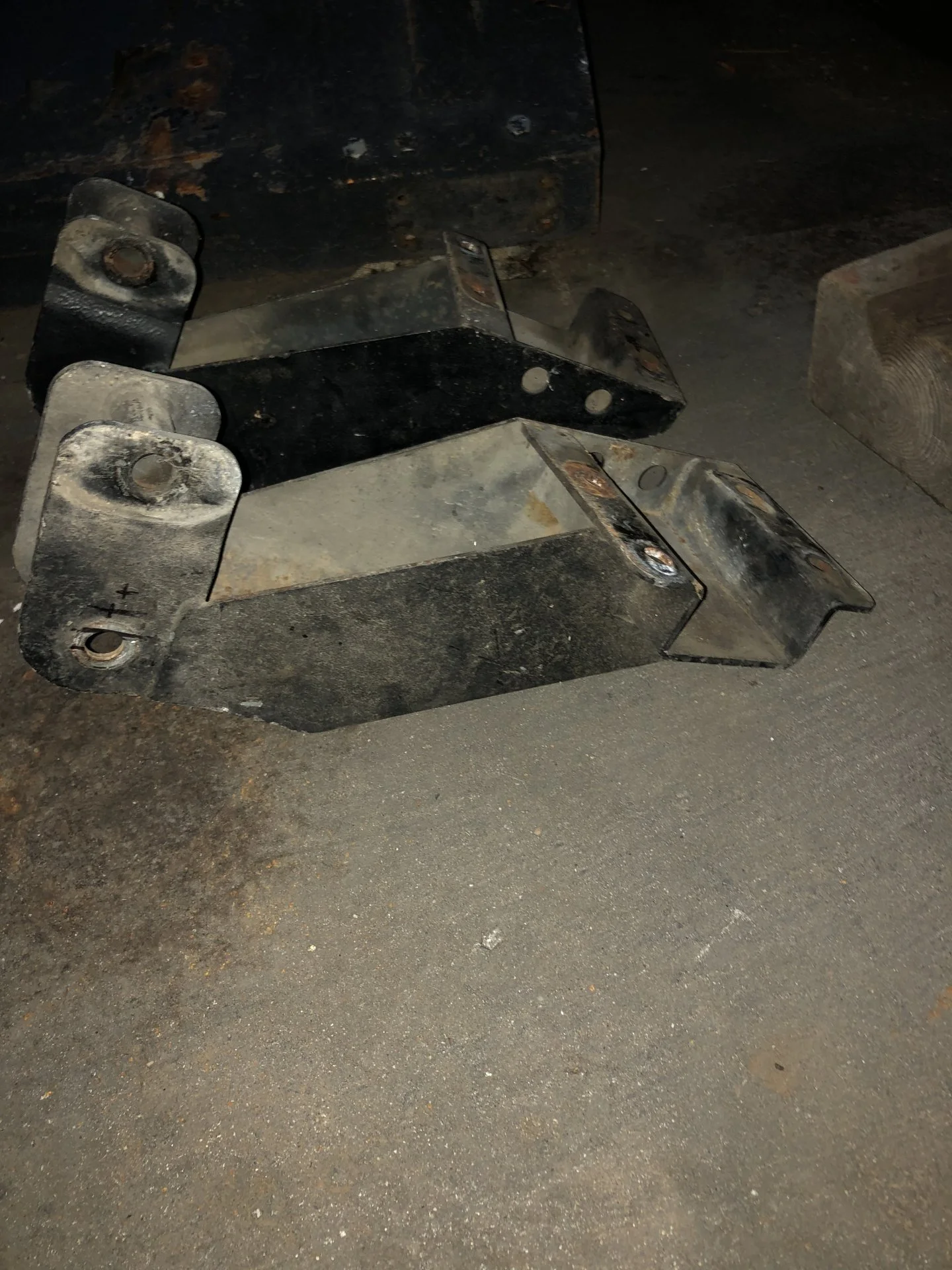

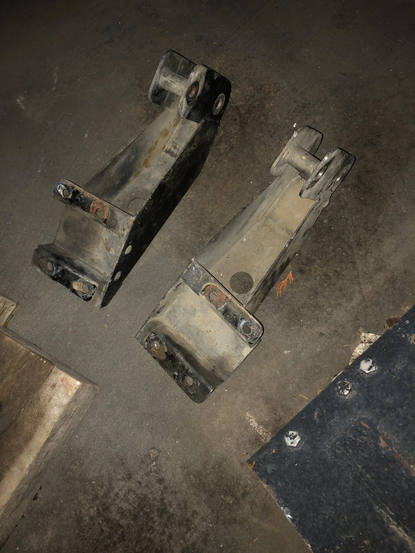

The castor correction is done using the radius arm drop brackets pictured below.
They look custom made to me while the build quality is pretty good. I wish they also move the front axle forward a little bit but it’s not that important for the 35” tires.
I’ve never seen drop brackets of such length. Hopefully, this will minimize the possibility to hook on them while squeezing through rocks. If they won’t work as planned I’d need to get Delta radius arms.

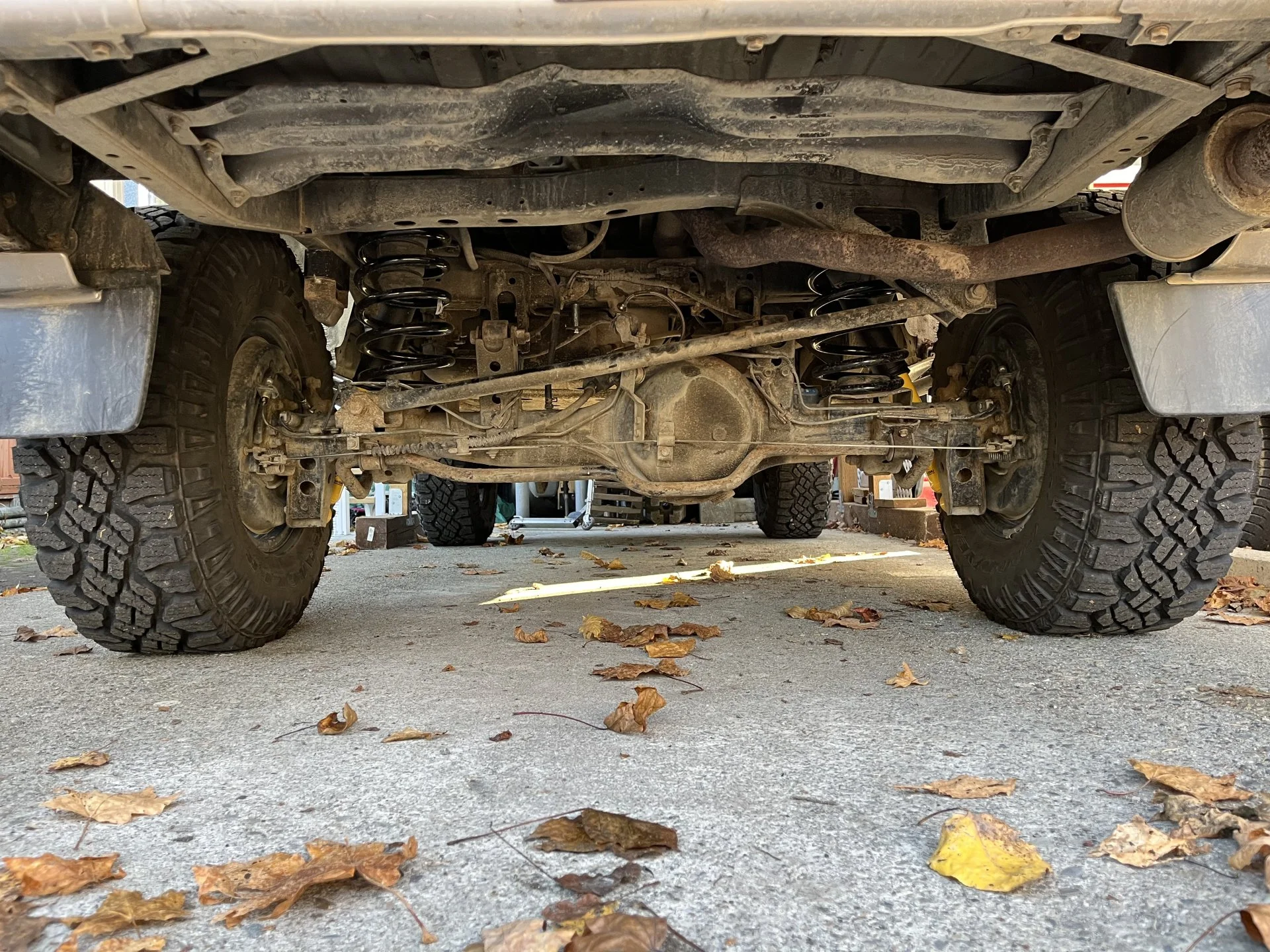

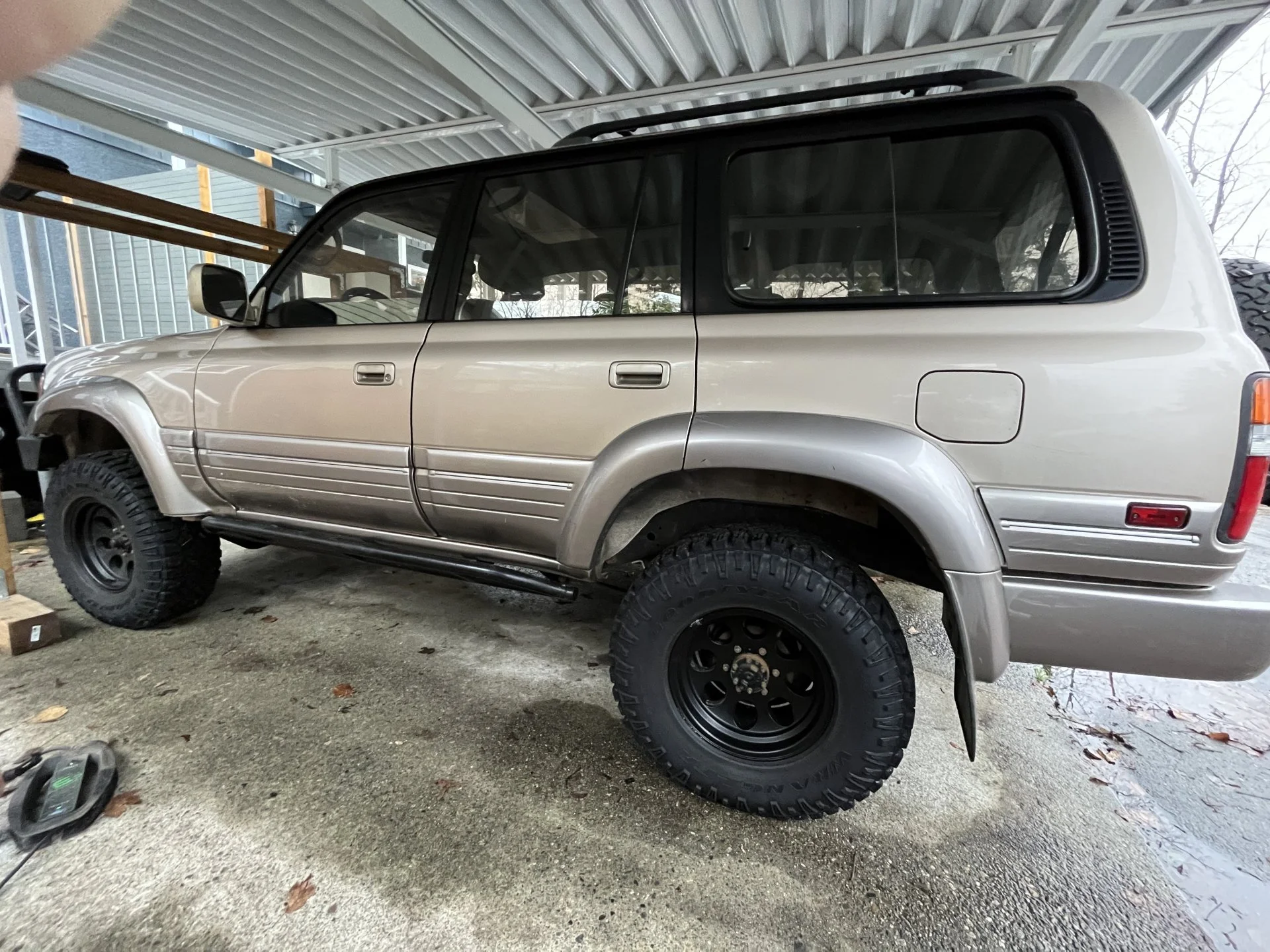

First mistake was to install both front and rear coil spacers. The result was a stinky bug stance and almost zero castor despite the radius arm drop brackets.
The panhard rod is way off its ideal position. The difference in height of its ends is 6.5”.
Removed the original spare tire carrier.

Do you have a picture of the radius drop brackets installed? Never seen anything like that.

Here are the panhard drop brackets installed. Scratched them a little bit already so yes, they will be taking hits regularly.

Man those brackets are funky. Definitely never seen anything like them.

At this point of time I removed the rear coil spacers to level the truck.
The difference in height of the rear panhard rod ends is 5.5” now.

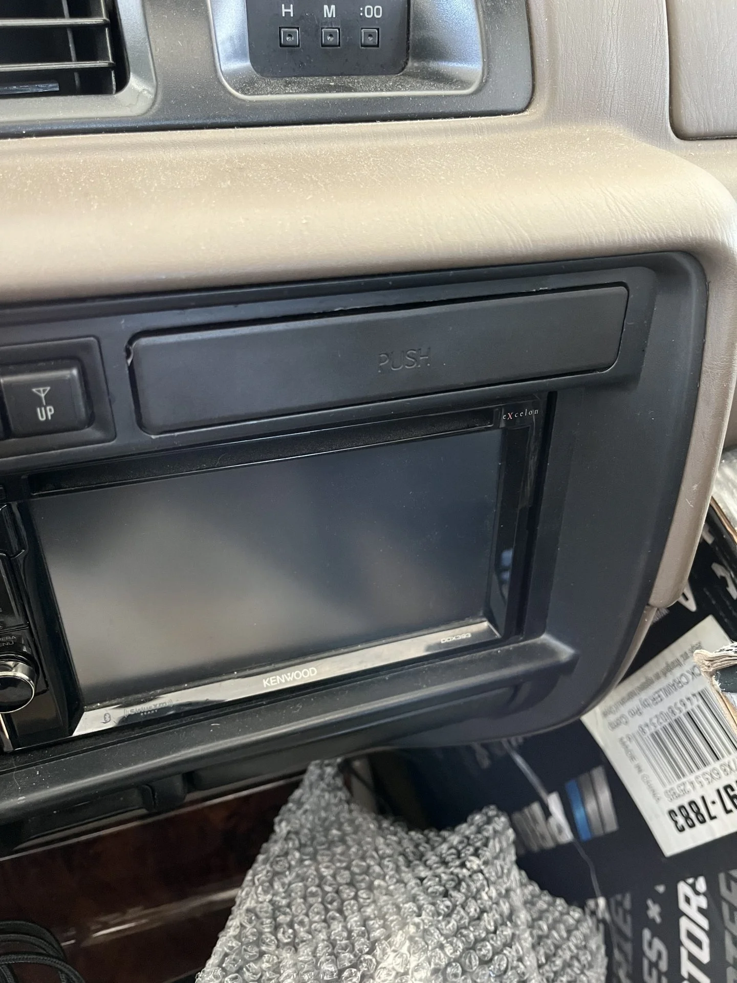

So far I did the easiest and the cheapest mode (or repair):

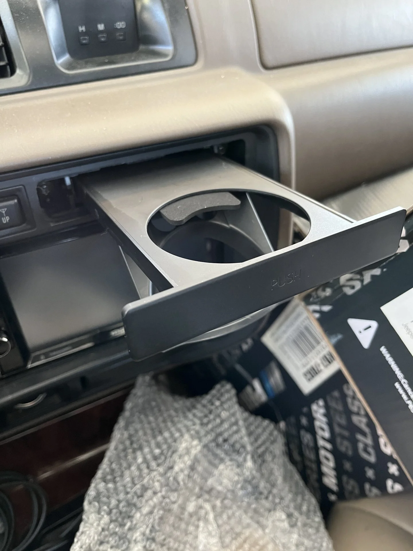

The cupholder from Ali Express works. Not sure how bad is it vs OEM but definitely better than a hole.

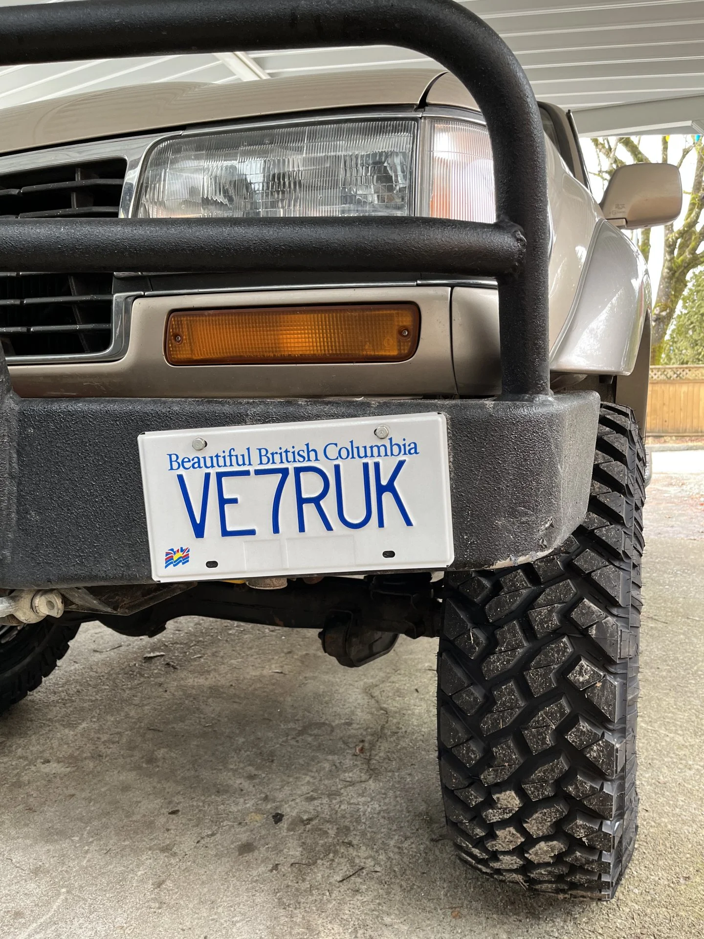

NippoHippo got some updates this week:
- my HAM call sign plates arrived

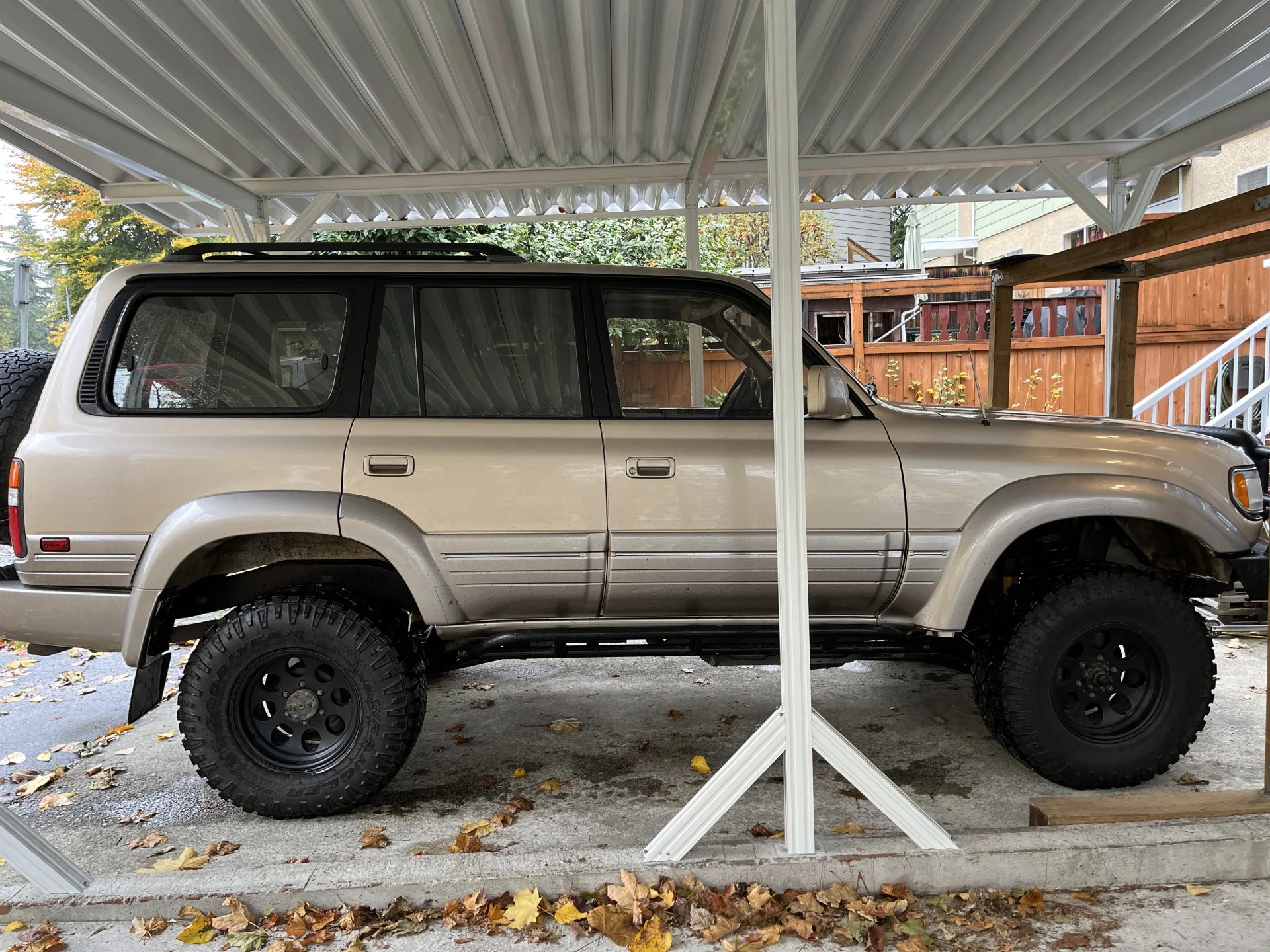

- finally, Nitto Trail Grappler 35x11.5r17 tires were delivered. Mounted on a sparkling new set of ProComp steel wheels 17x8 ET -6
I really like the look of the skinny (ish) tires.

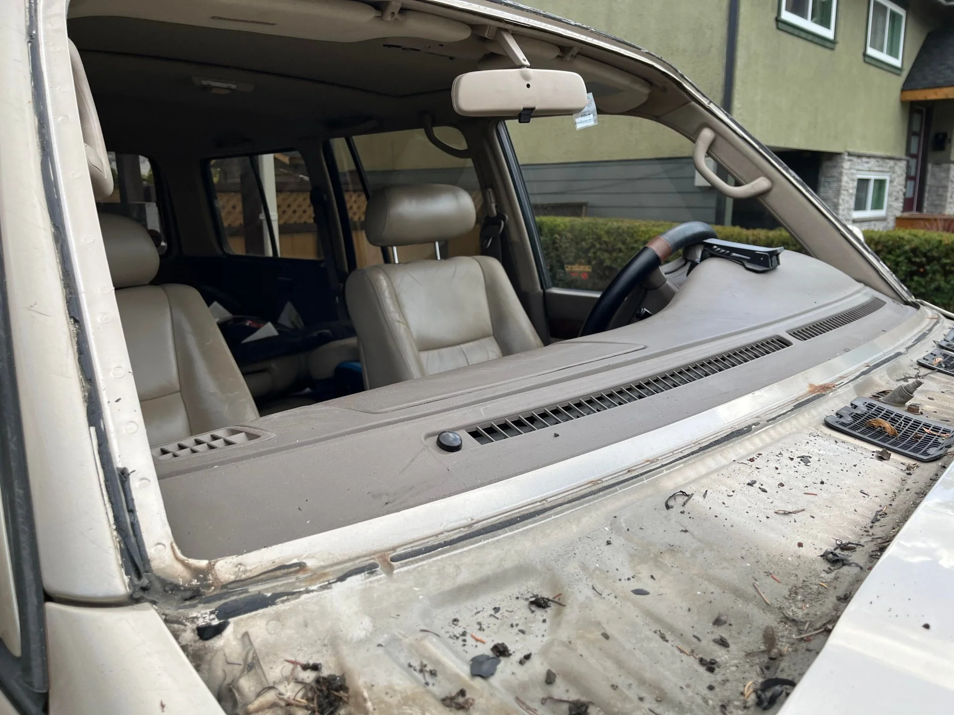

Getting back on track now. The first task was to replace the windshield. Wasn't too bad but there was some cancer at the bottom so I'm happy it's addressed now.

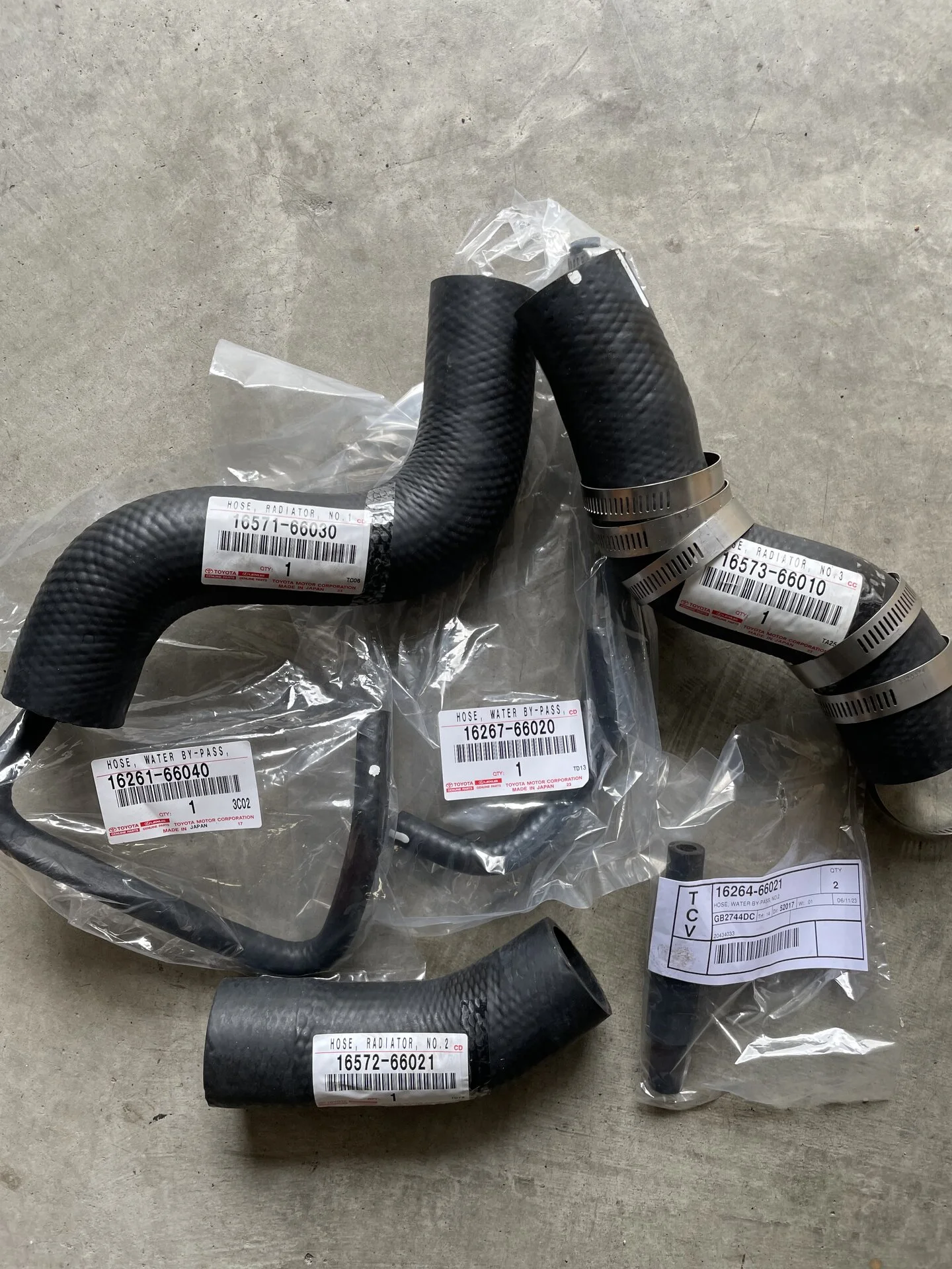

Cooling system story:

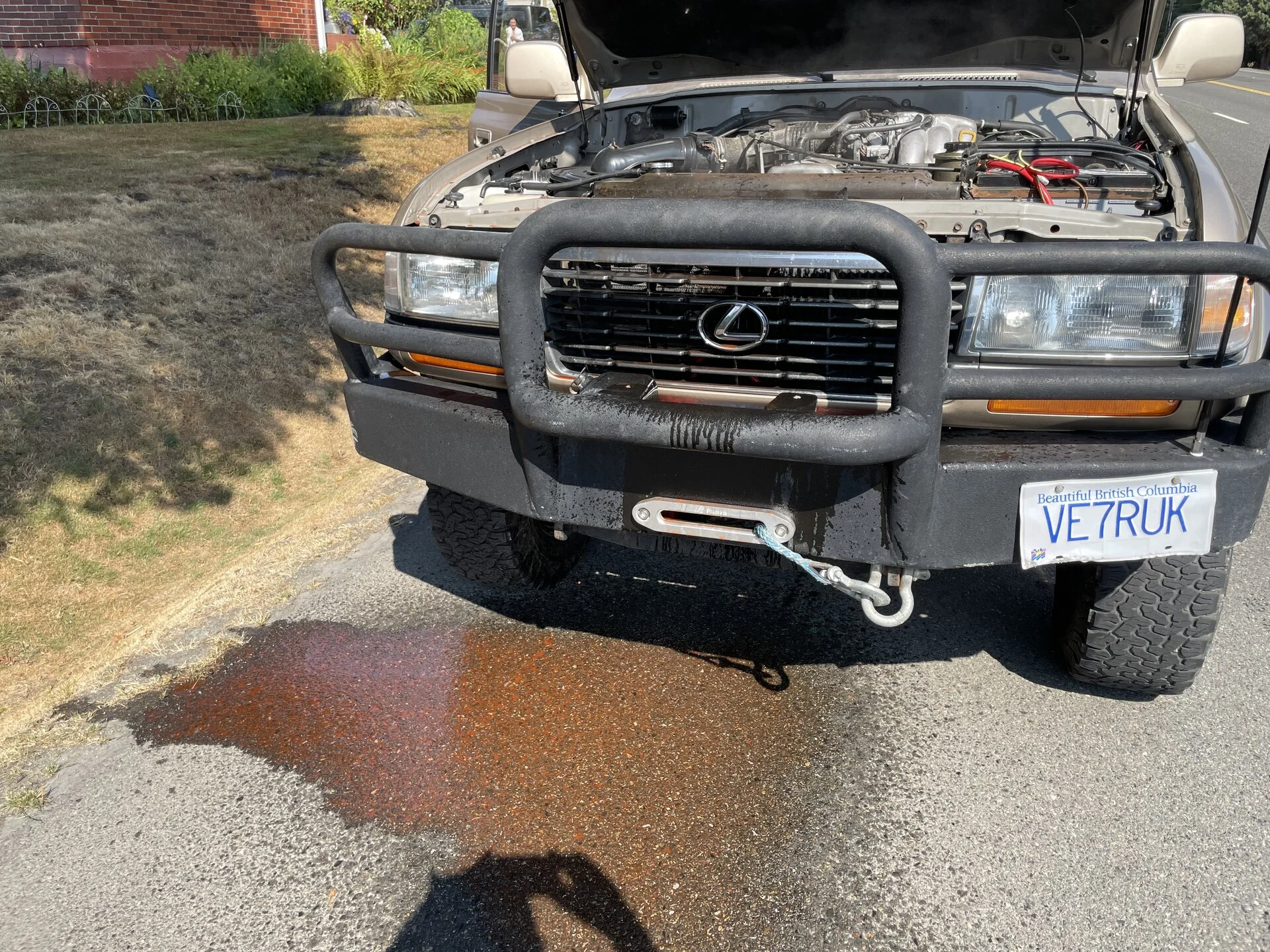

- the radiator cap looked old so I replaced it with a proper new one.
- the new cap holds pressure definitely better as I've got a leak from a PHH. This lead to the full cooling system overhaul except I decided that the radiator is OK and no reason to replace it.
Not pictured: blue hub fan clutch, thermostat.
- Deleted the rear heater
- Bypassed the PHH with a single line from the valve down to the block where the PHH connects to it.
PHH is a real PITA to replace. Confirmed. Bypass is an easy win.

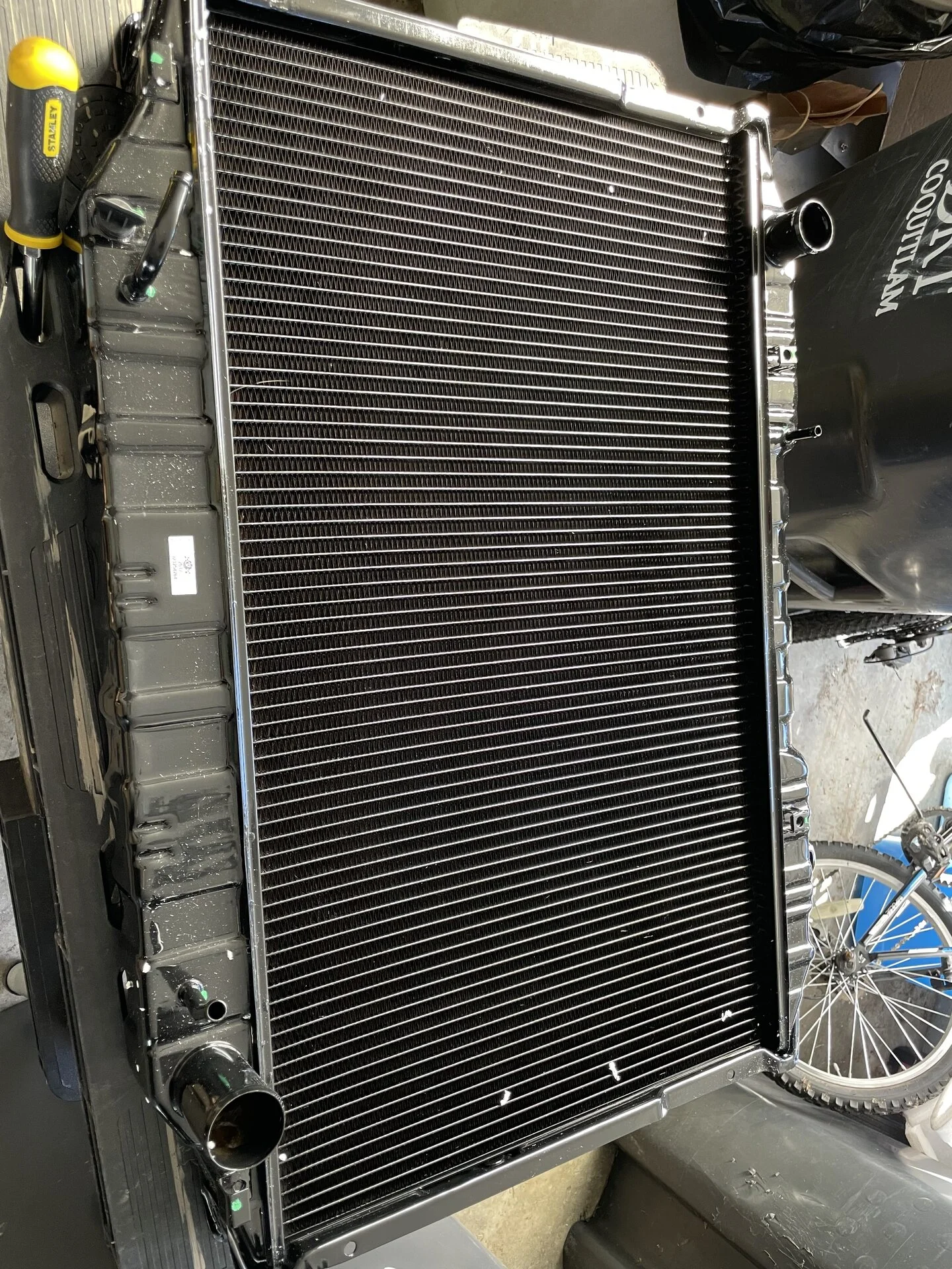

- next, we decided to take a trip to the US in the summer. Here goes the radiator:
- Full metal CSF radiator looks pretty good. I wish I replaced it as part of the cooling system overhaul.

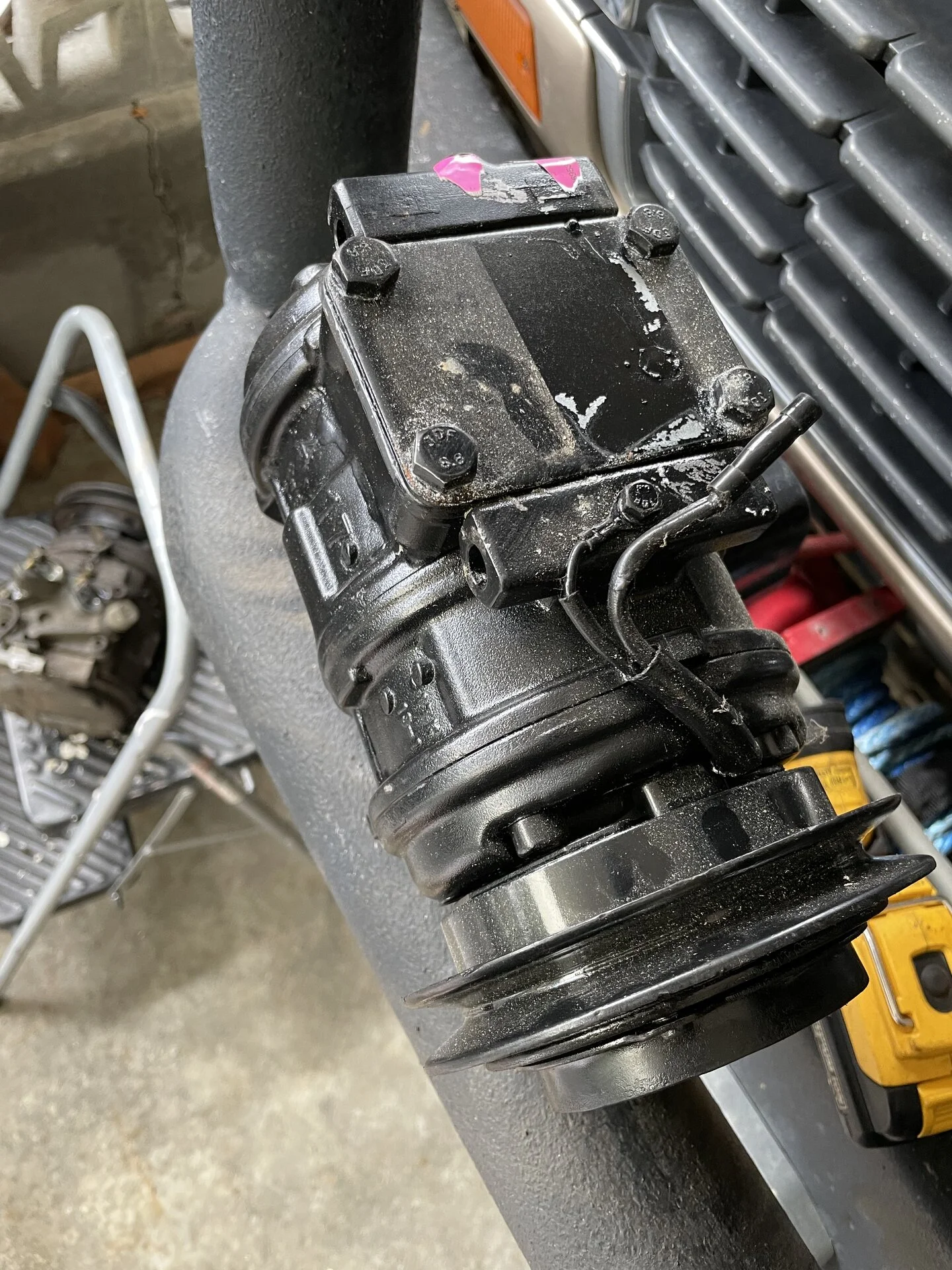

- Re-manufactured AC compressor installed that same time:

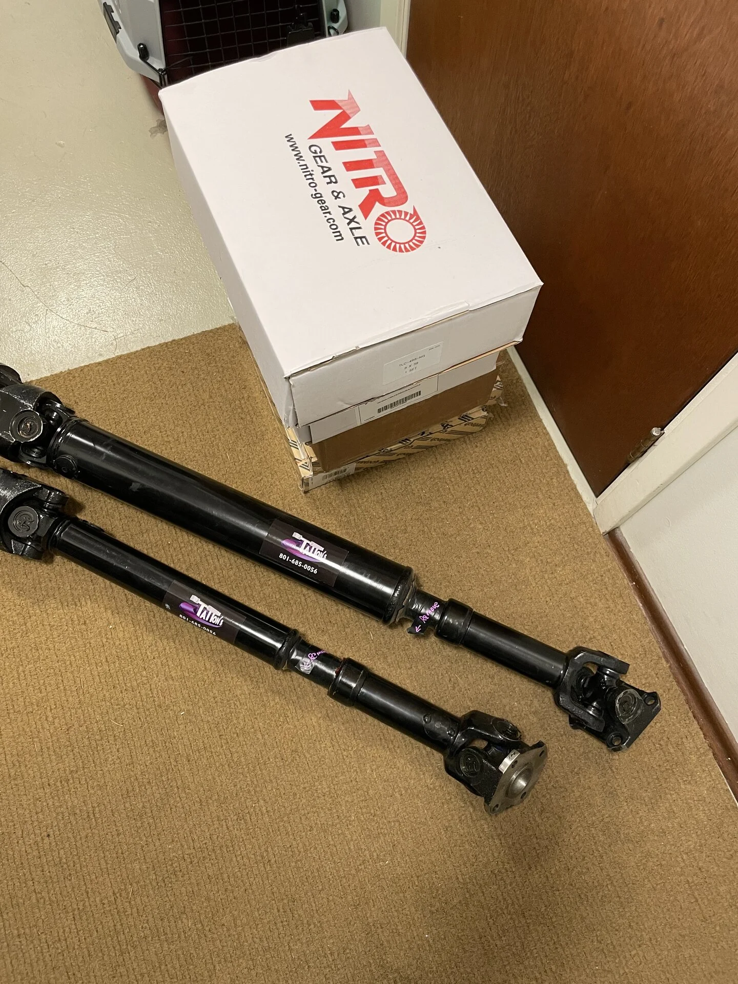

Nitro had a very good deal on 4.88 gears for LC 80 and I couldn't resist to get a kit.
"as I'm there" - goes the full knuckle rebuild kit, wheel bearings, Tatton's DC driveshafts:
