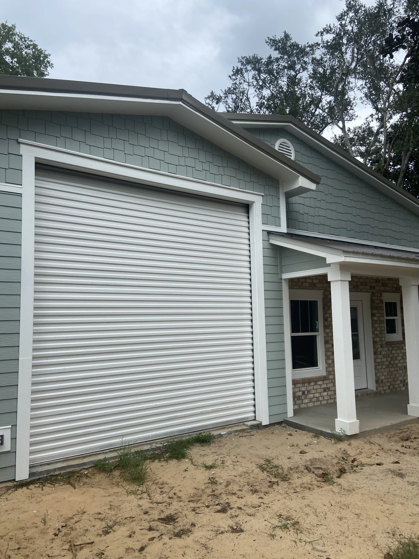

They even messed up the recess in the concrete that the roll up door is supposed to drop down into to keep rain water out.
Over all the building is looking good, I just notice things like that being a builder my hole life.
And what's up with the huge gap at the top of the garage door?

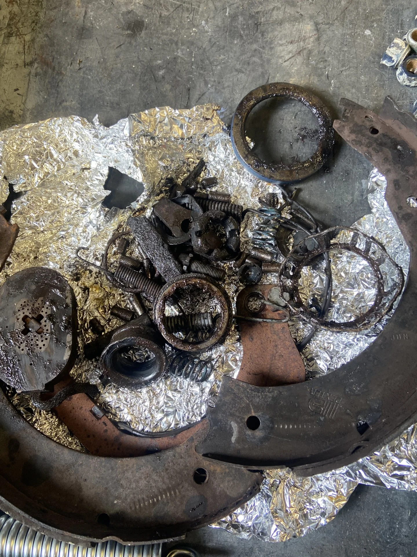

Work trailer wheel fell off the other day. Robbed a complete hub and wheel/ tire from the other trailer at work. - just a pump or two of grease for the long hauls and a couple pumps every 2 or 3 months would of prevented this. That and shacking the wheel for loose wheel bearings.
Annual maintenance is a better idea. Pumping grease in will ultimately contaminate the break shoes with grease 🤷‍♂️
Ask me how I know;)
