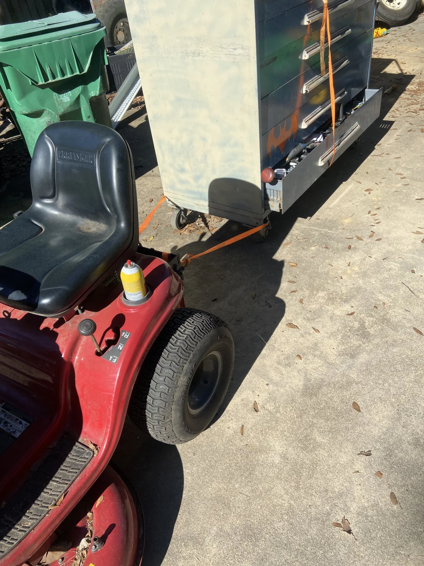

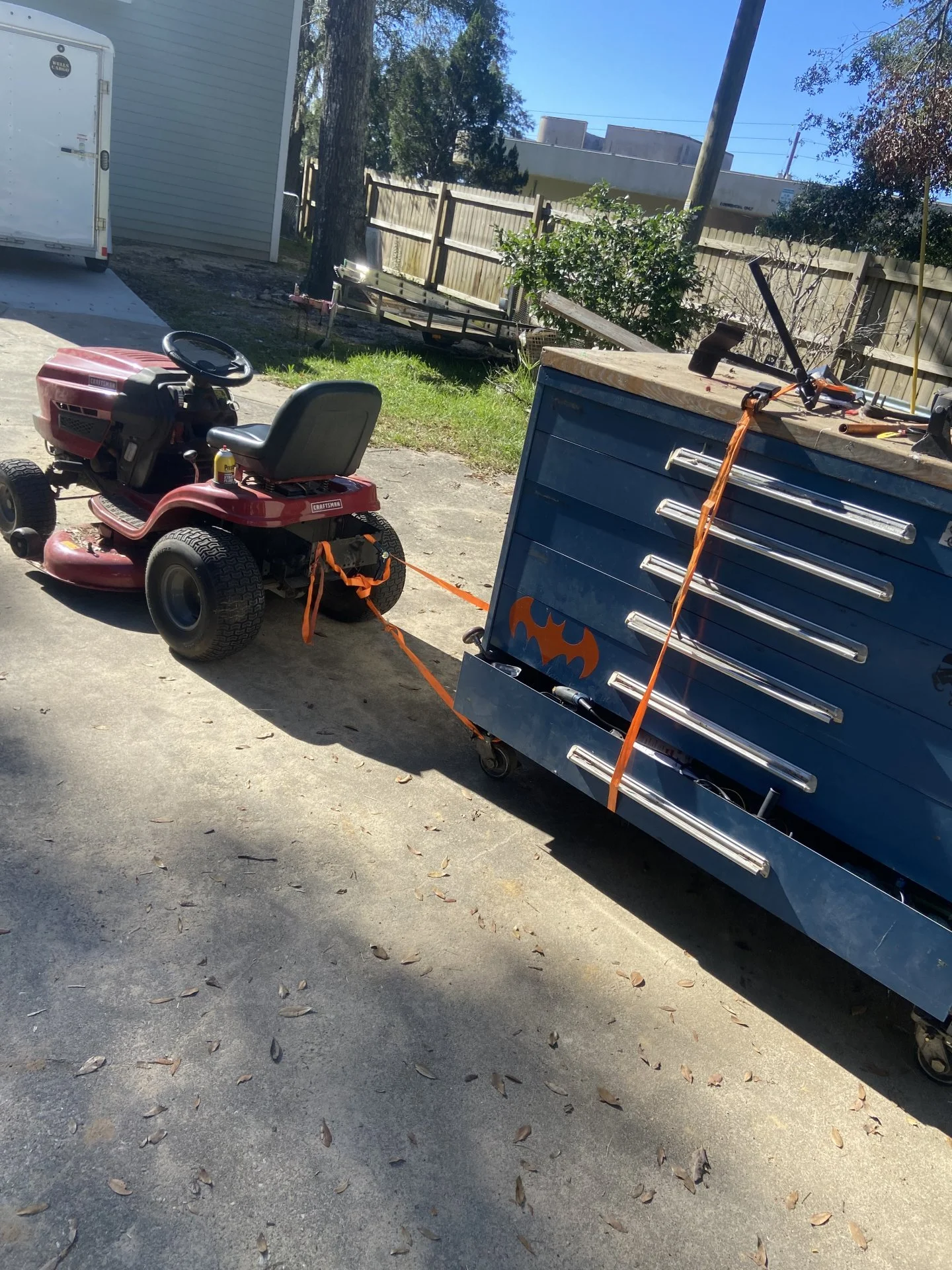

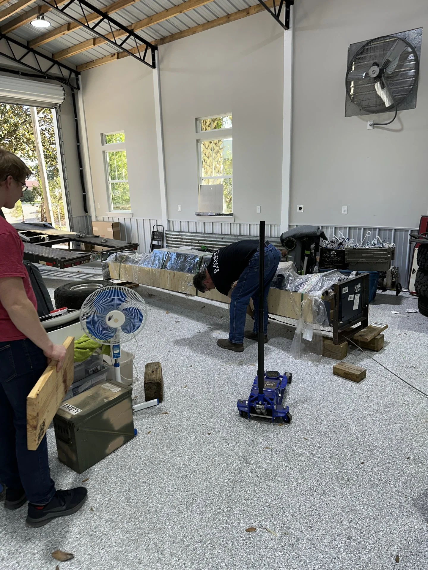

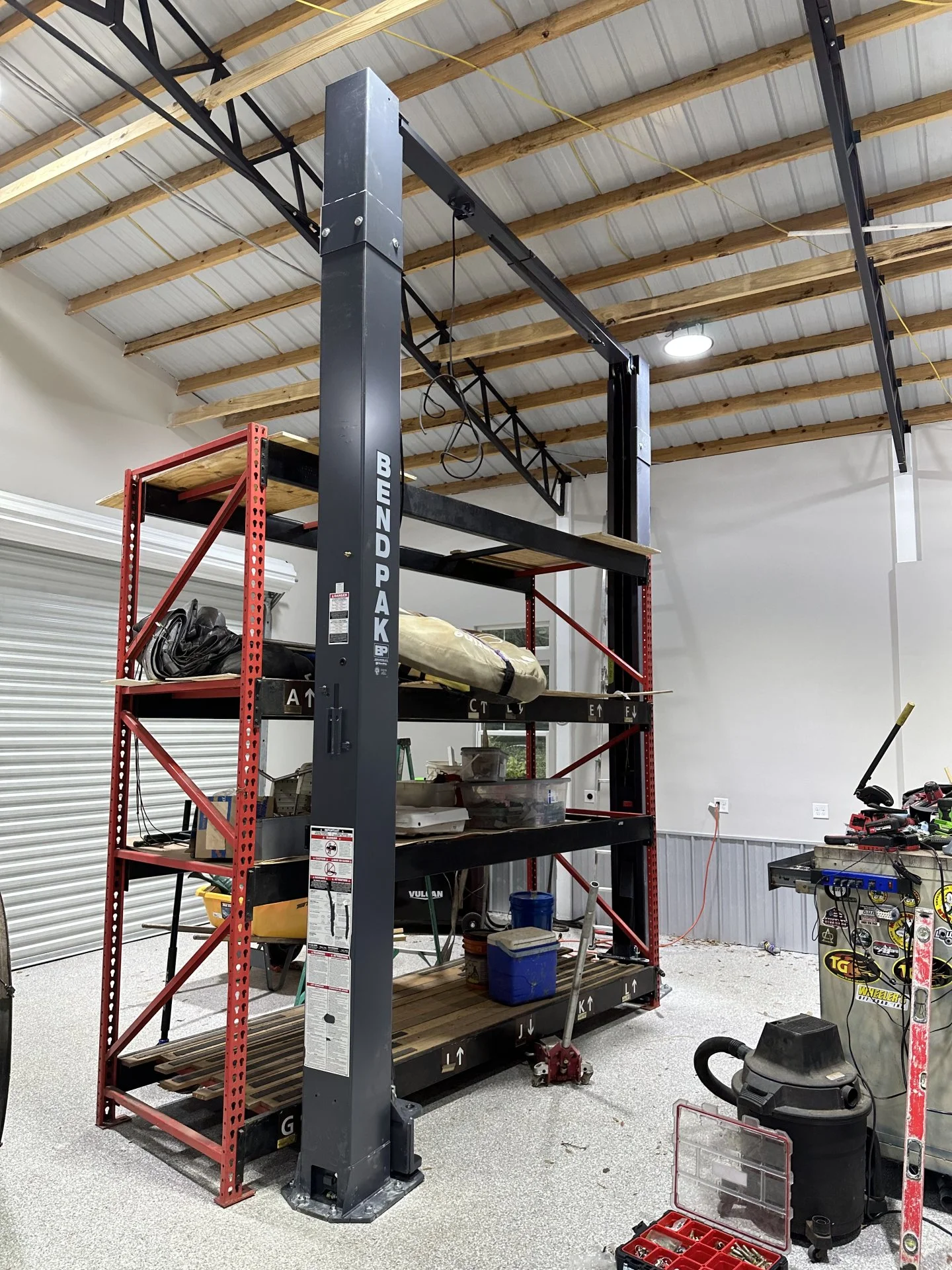

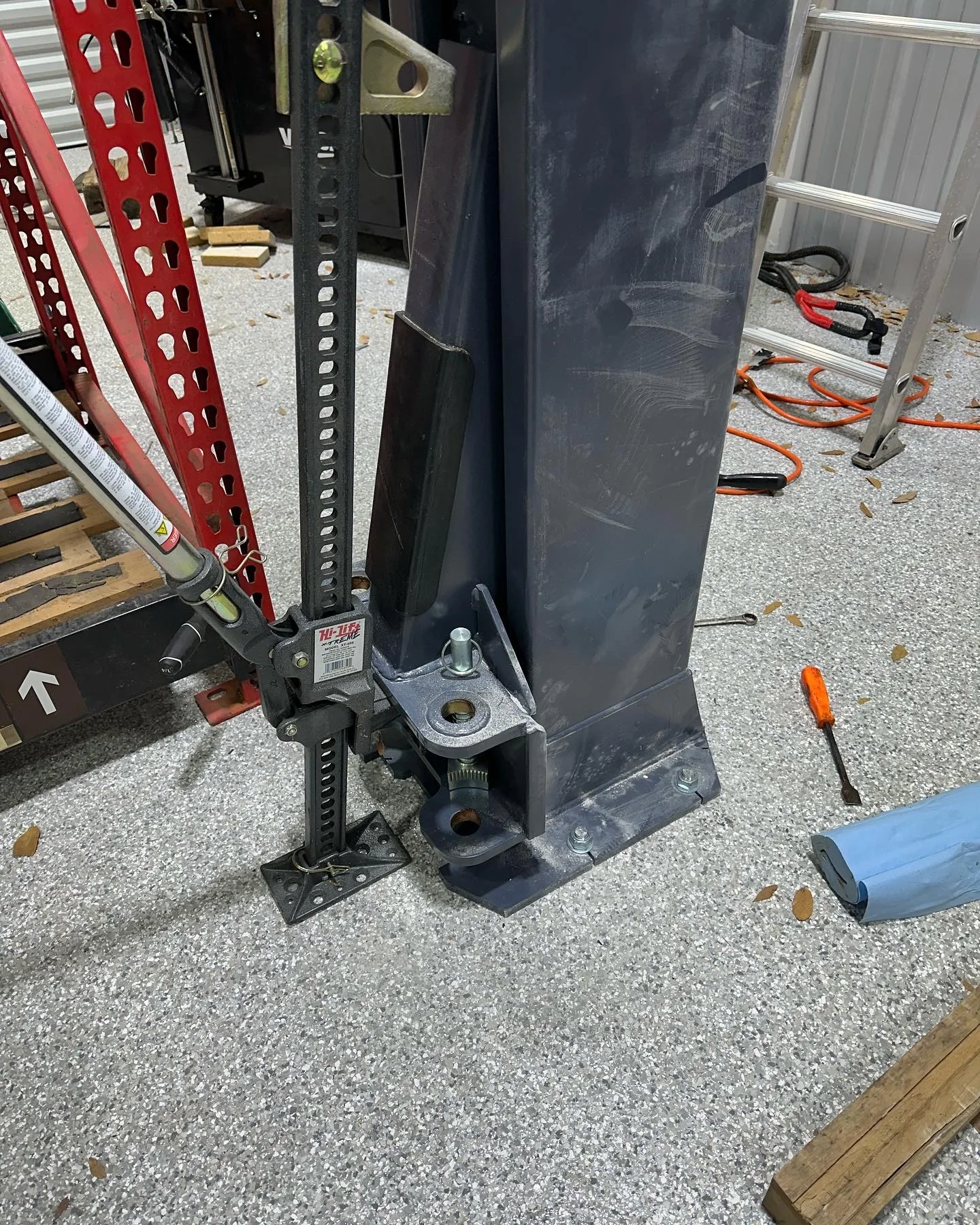

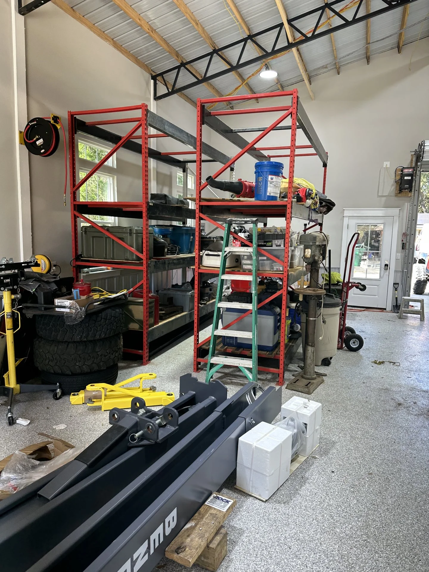

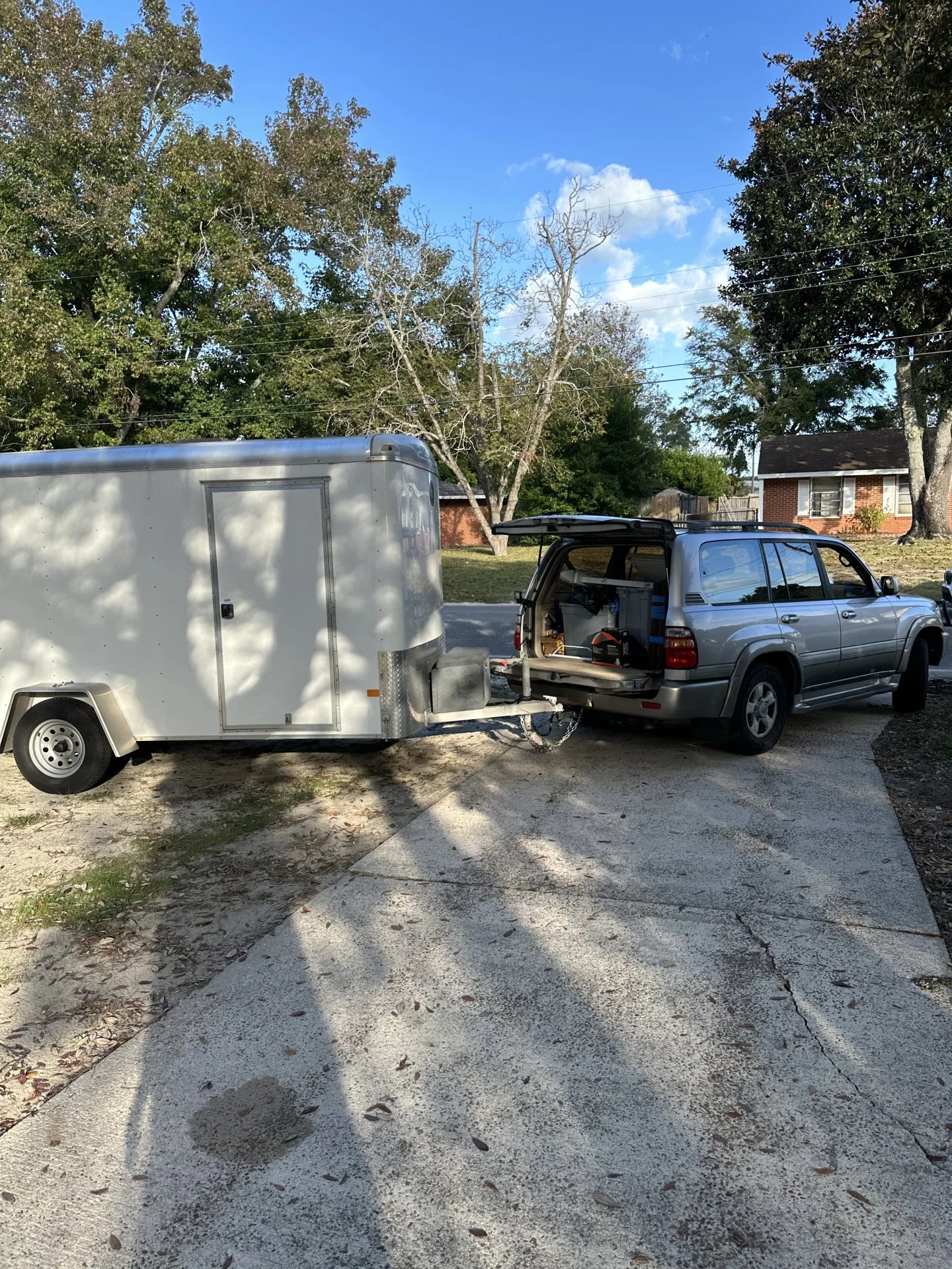

Still can’t do much, best buddy Steve jokingly said to use the lawn mower to move stuf! Heck yeah! Worked great.

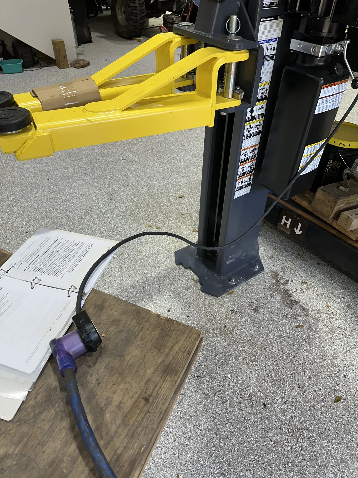

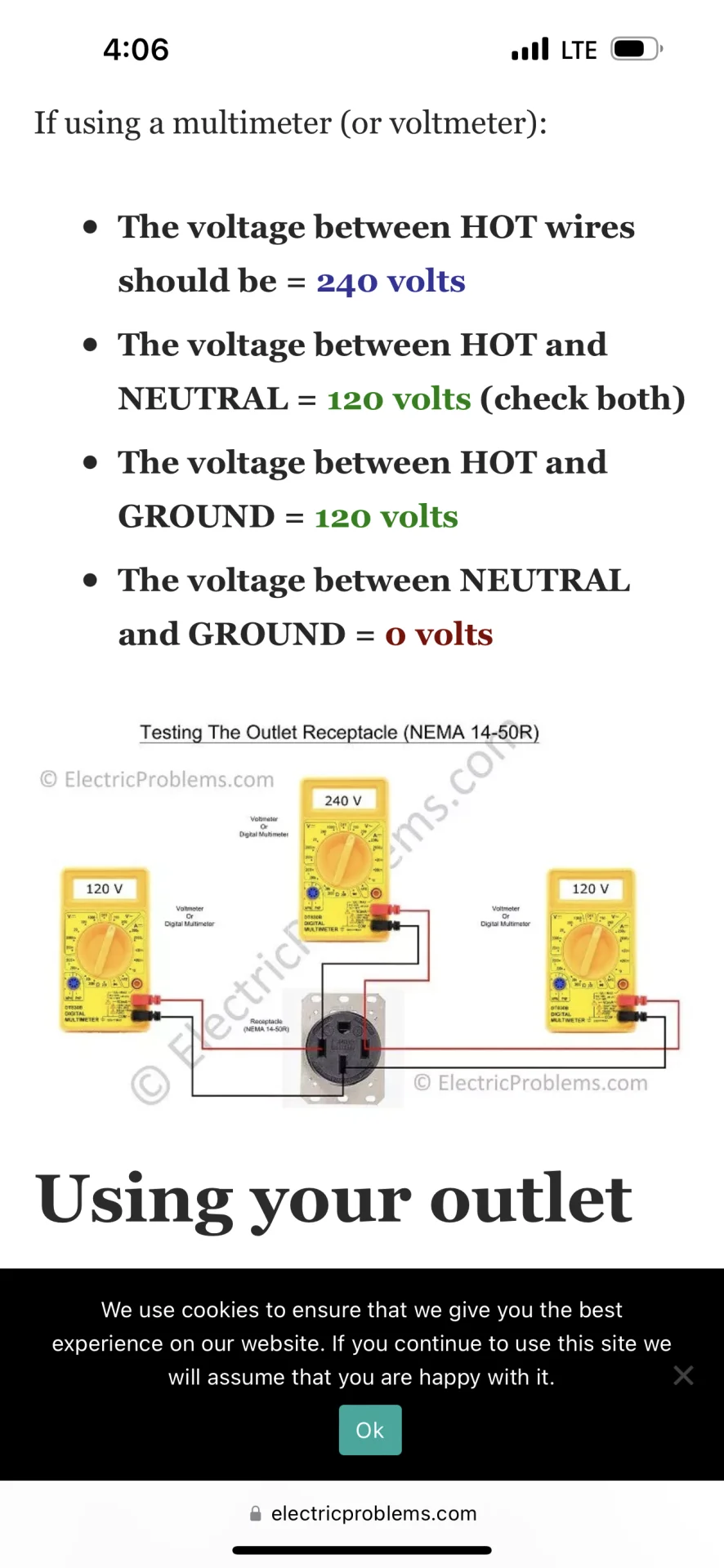

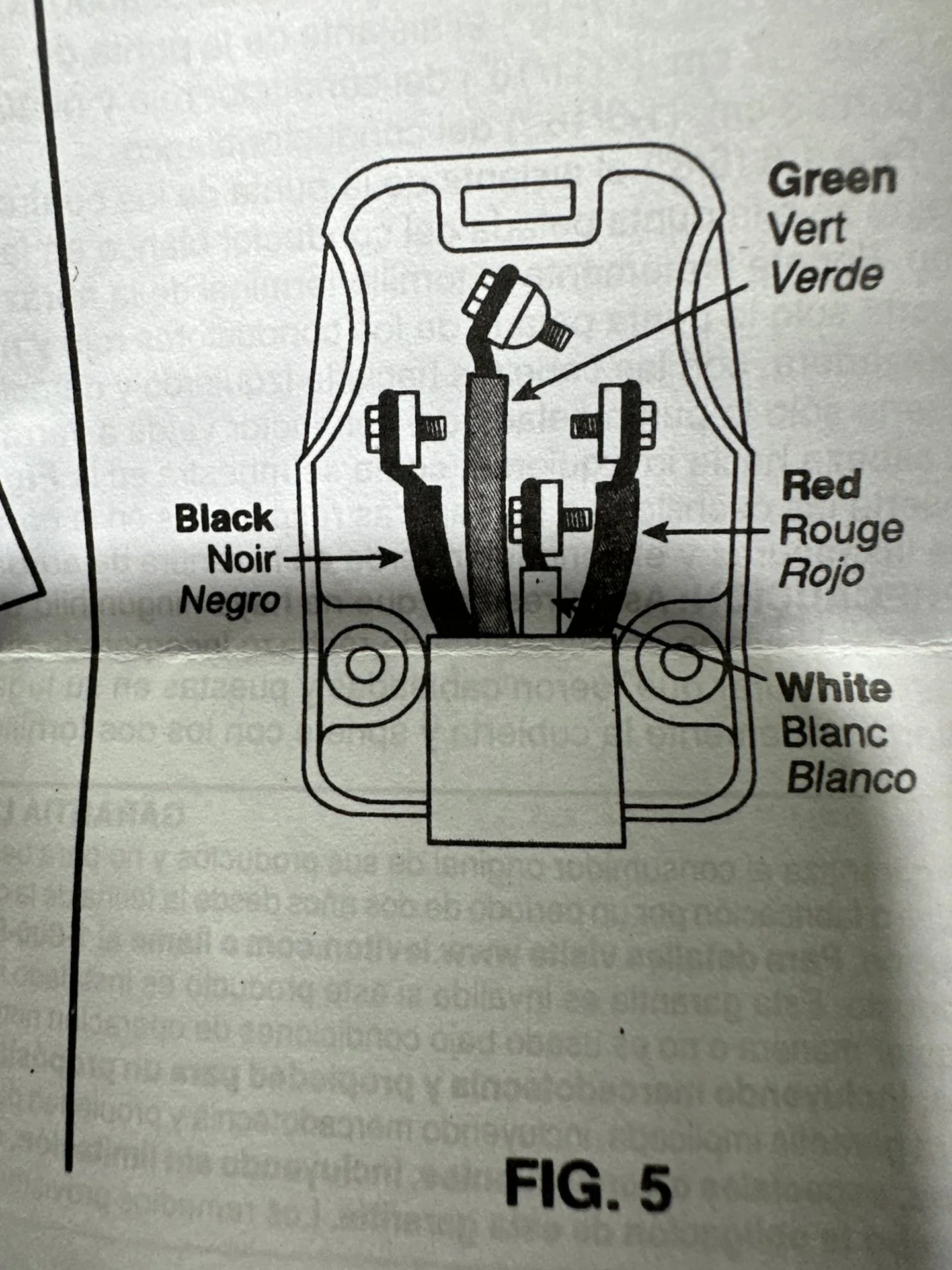

Ummm... You should be dropping the white wire (neutral) and keeping the two hots (red and black).
240V is two hots and a ground. Neutral is only used for 120V.
