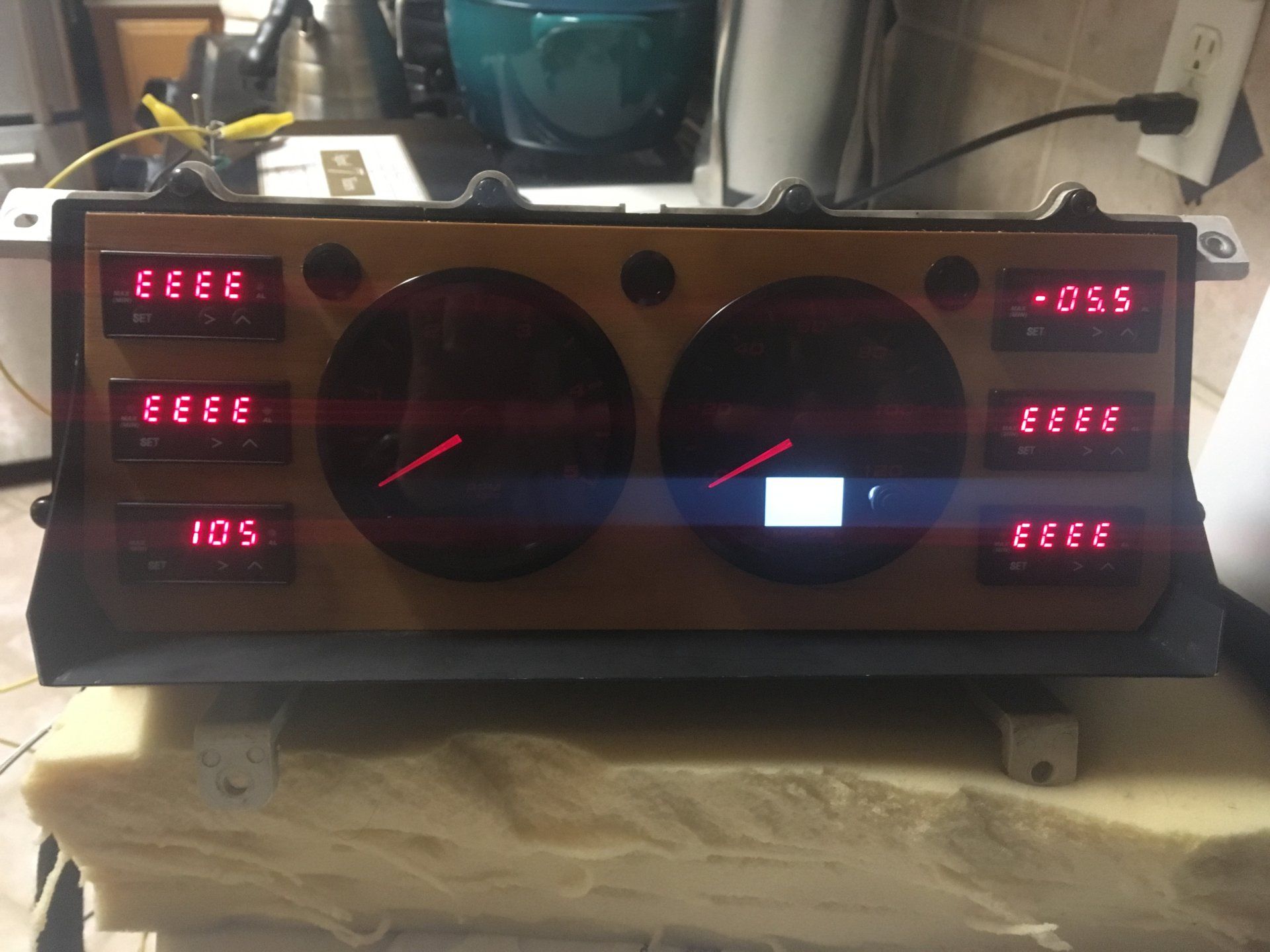

There are five wires. Red, white and black bundle are gauge power, and they're stuck together. The separate black and white wire pair, that connects to the dimmer, are for lighting.
If you power just the backlighting and not the gauge you'll get a blank white display.
So I have red, white, and black hooked up. With just the red and black I get a bump of the needle to show its working but no display. When I connect the white wire I get a red needle and white display with no back light. I haven't tested with the dimmer but I'm hoping it will light up the backlight.
Right. You're not understanding what I'm saying. If you bought the same gauge as I did, there will be red/black/white stuck together (side bonded or whatever it's called) that's circled in red in the below pic. The white wire circled in red supplies power only to the pointers and LCD backlight. The wiring circled in blue is the white/black side bonded wire bundle, that has to be connected to the inverter, and powers the EL wire gauge backlight.
Not circled is the red/black wire that needs to be wired to constant power.
From your issue, it sounds like your red and black wire (circled in red below) are not wired correctly to your 12v supply. The white wire in the red/black/white needs switched +12v with your gauge lighting, and the red wire needs ignition switched +12v.
Yup that's how it's wired except I haven't hooked up the inverter black wires yet. I also haven't powered the optional "Hot Start" wire for GPS. For bench testing I usually use a 12v power supply I keep in the house. However I did pop the hood and run direct to battery to rule out my power supply. I sent an email to Speedhut to see what they say. Trying to rule out stupid (me).
Speed hut confirmed it should be working the way I had it hooked up so they are having me send it back for replacement/fix.
