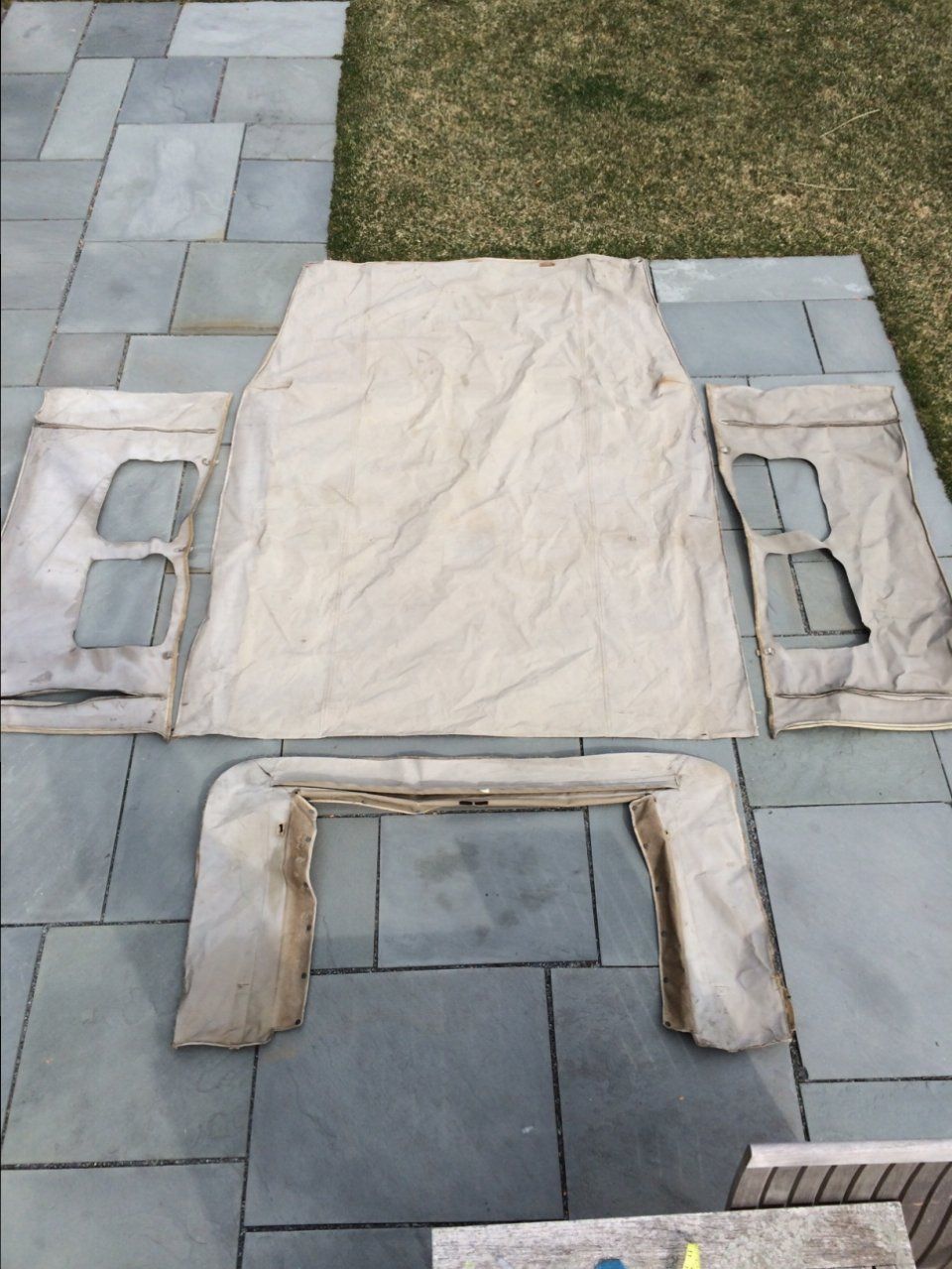

Thanks to Ant's inspiration and remarkable work on this, I've embarked on replacing the top to the 1979 BJ44 I recently got. First step was carefully (exacto knife) pulling apart the original top, which will serve as a pattern and huge time saver. In another thread I'm going to go through what an astounding survivor this truck is. I have every reason to believe that the 40,000 km (26,000 miles) are original. Astounding. More as I follow in Ant's proud footsteps. Attached pictures are the deconstructed original top and mock up of the new top (I'm going to black for a variety of reasons). May make a few adjustments/improvements. Don't have to make the call yet. As/if the pattern for a 44 might be helpful to anyone, I'm happy to share/distribute it. Thanks again Ant!

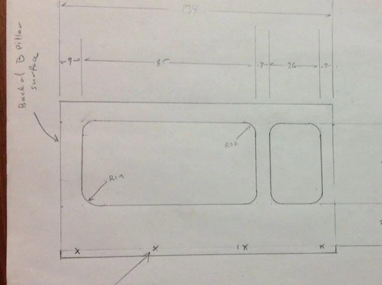

I'm loving this thread. I'm dying to make a new top for my bj46 and if Native1 has some dimensions I'd love to see them. I'm planning on using dimensions similar to the hard top sides for my windows. One reason is to keep the window as close as possible to the b- pillar for visibility. I find the original top creates a large blind spot there. The other reason is for the kids in the rear seat to have more visibility.
My truck also has 40,000 miles on it.
Hey Peteinjp - I'll try to pull together some measurements this weekend when, hopefully, I'm able to make more progress. My new top was a necessity as the original top was shot (read: not waterproof) and the previous seller, while a good guy, had a replacement top made by people who clearly had no idea what they were doing (read: not waterproof again). Beyond the top, I'm amazed the unmolested stock condition of the BJ44. I couldn't be more psyched to get the top sorted and installed. I've attached a bad photo of a test fit of the front and door-top channel material I found on www.sailrite.com.
I'll also pull together a materials list as the right materials - sewing machine, fabric, binding, thread, etc. - has had a huge impact on time and efficiency in this project. Good luck with yours!

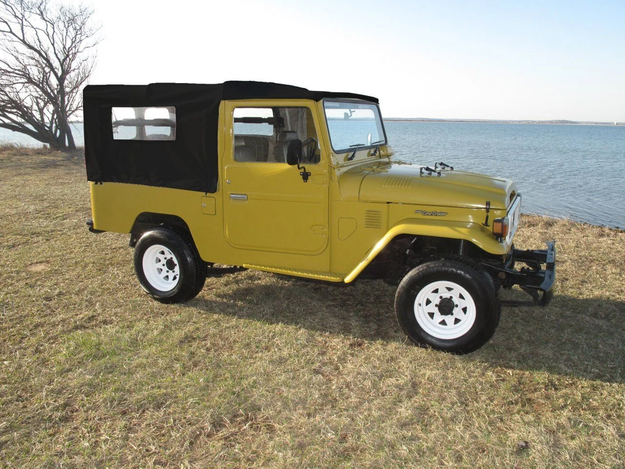

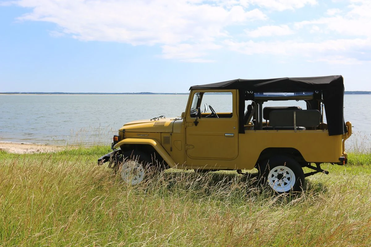

Closer and closer! Finally got some time and attached the side panels and cut the rear panel (not shown). Very happy about the black. The black changes the overall look of the BJ44 for the better and I love the performance and workability of the SeaMark fabric.
Upcoming weekend, tasks are many:
  • attach the rear panel (lack of rear panel is reason for the sag in the top in picture below - no real tension on the top)
  • add hardware to allow straps to attach to the footman loops
  • install front corner grommets
  • trim all excess fabric
  • install twist lock grommet strips at bottom of each side panel
  • last (but certainly not least) figure out how the panels come out of the rear door frame panels. Does anyone know the answer? Removing the frames from the lower metal door is fairly straightforward. Getting the canvas out of the upper frame is less so. Any advice/expertise is appreciated.

amby doors? you must take out the seals by sliding them out of the channels - then you take out the screws holding the channels to the door and finally you can peel off the fabric on the doors.
