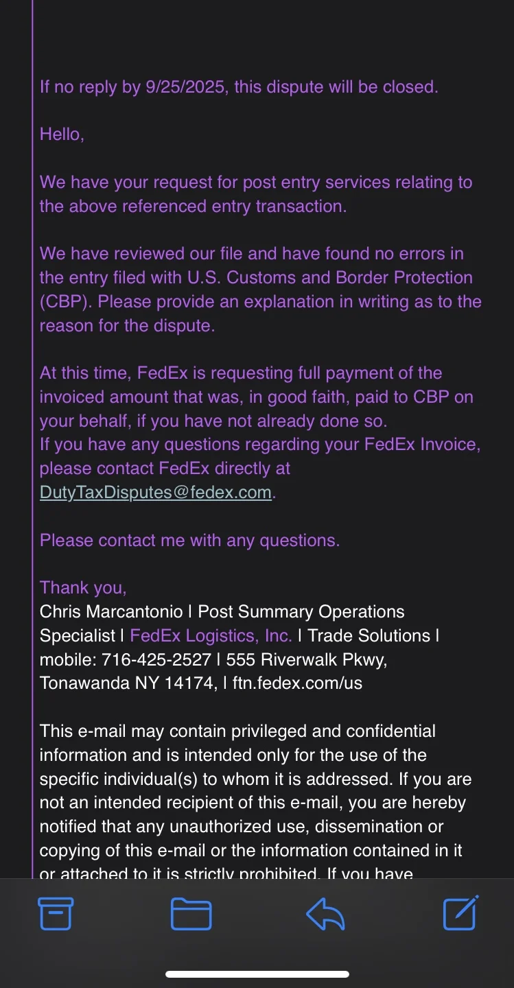

I received Customs final decision, I’ll have to pay up.

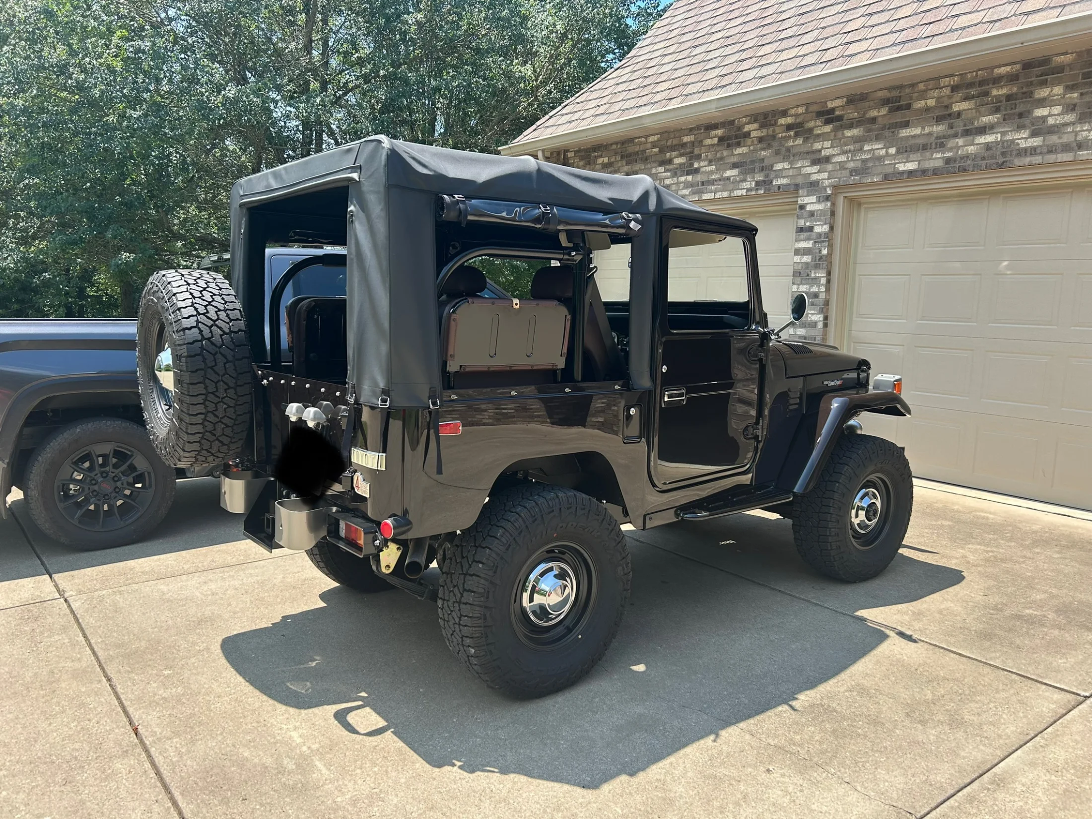

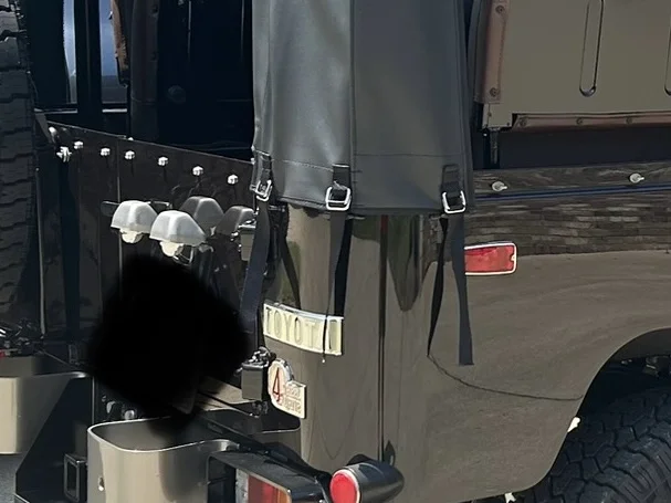

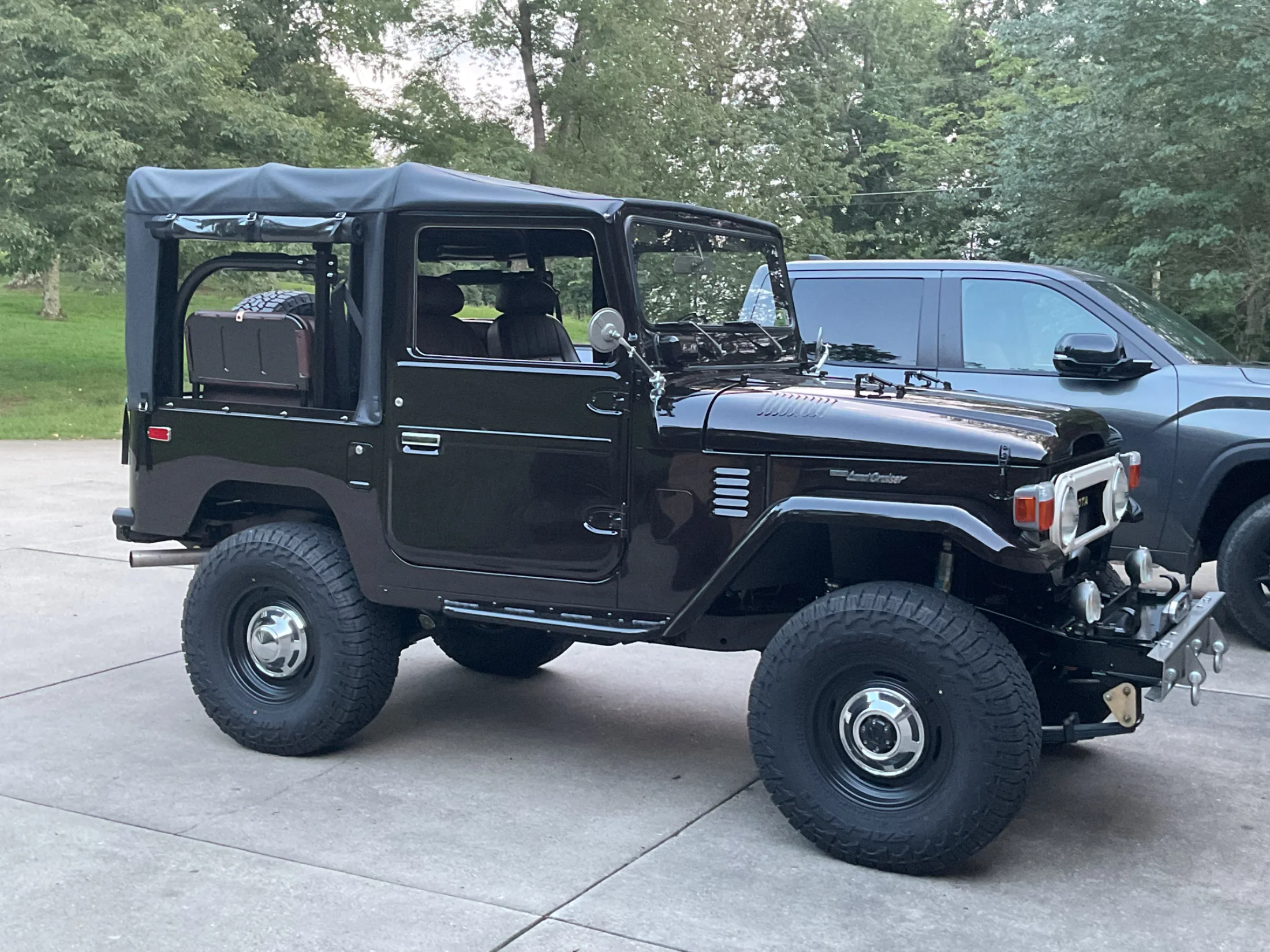

Not sure if I have a TROA top. Came with the 40 when I bought it. But just installed it and it appears too short. Feels like it fits perfectly in the top door channel and down the B channel but doesn’t quite fit over the last bow. It needs to come over like an inch over the last bow and should be perfect. Any ideas? Not sure where to get that extra slack from as everything else seems to fit nice.
Additional pics
Shorten the rear bow? What does the rear bow/wheel well interface look like, a photo would help. Most of these have some kind of bow keeper that the bow should sit down into (there are two designs). You want to make sure the bow is inserted and touching the wheel well.
Love the color of your 40. I think Nebula green would be my 1st choice of color if I ever restore a 40.

Here’s some pics. If I cut it down to be shorter then the other cross supports wouldn’t lineup right?

Its obvious it has been modified between the black & green section (rusty section). I'd bet it was not correctly measured/cut/welded..... I have a C-pillar hoop I could get some measurements on for you over the weekend if you wanted to remove yours and compare.
I doubt anyone would notice if you shortened it to make the lower edge of the soft top line up with the tub properly.
You are also missing the tub rail holder for that rear hoop:

Did your top co e with the upper bracket that holds the rear bow stationary to the tub? Might be optical trickery, but the bow looks slightly off center.
Pic below for reference.
