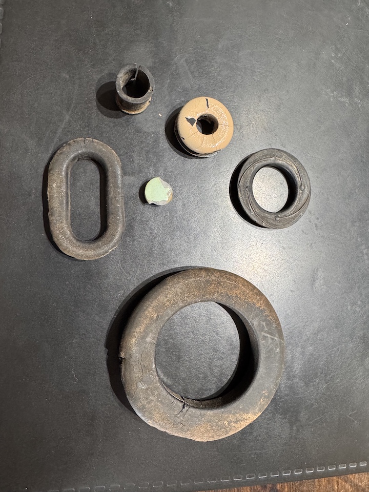

If you ever get some extra extra down time I've been looking to get these this made.
-Big one is frame grommet for fuel line to enter frame, then come out to tank
-oval one is for fire wall rib to protect positive cable as it routs to the starter
-top one is for front soft brake line retainer spring/bracket
-green one, (should be round) is a dash plug and FJ45 LWB bed plug
-beige one is hood support rod grommet
-last one is bushing for horn contact ring
PM incoming with my e-mail... if you have a pair of calipers and can get me some solid drawings/measurements then I can do the rest. Is that horn bushing brass or copper? It is possible to copper plate resin prints
frame circle grommet, firewall grommet, and horn contact bushing are on the printer as we speak... should be done in a few hours!
