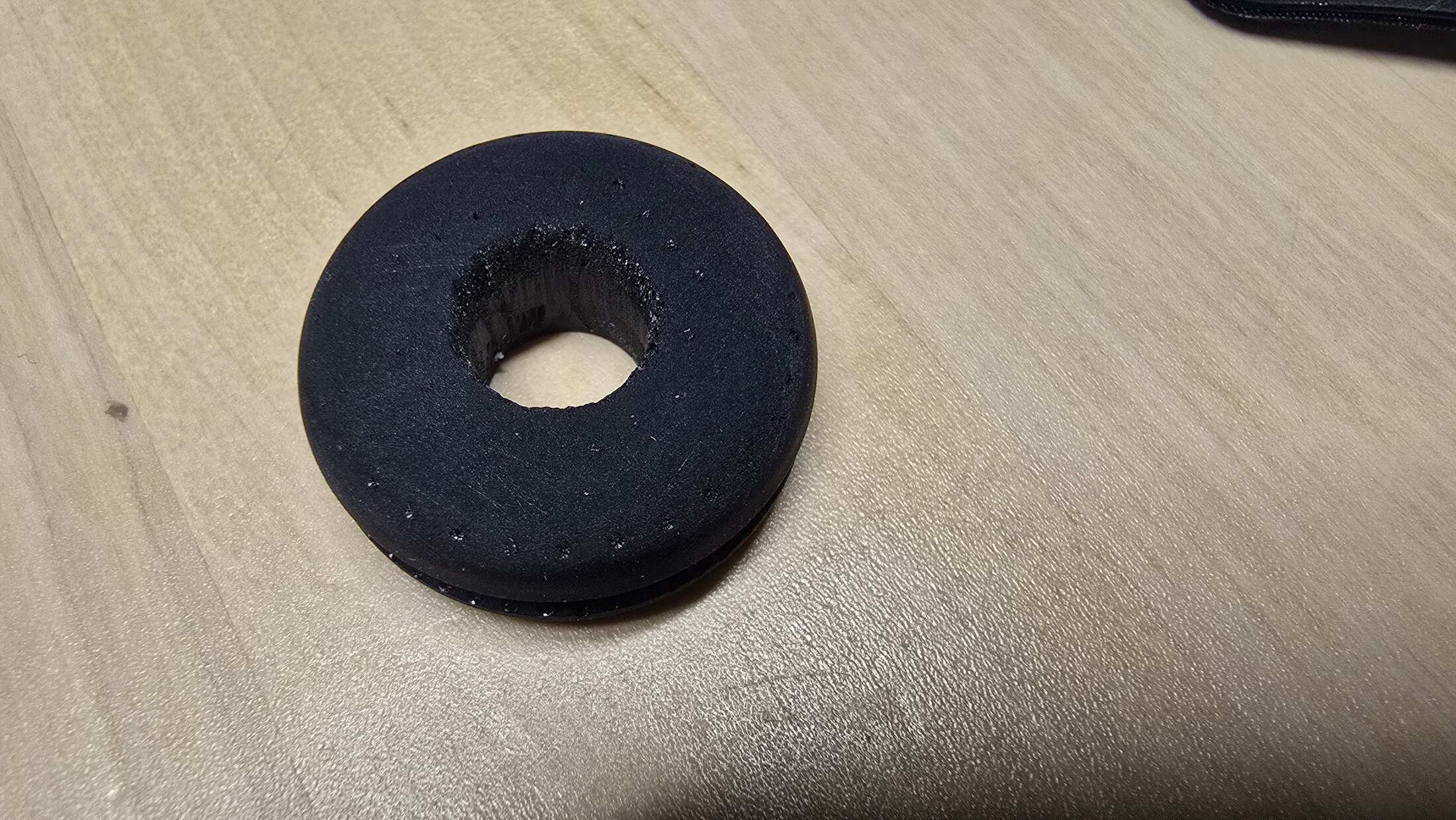

Anthony, I have been waiting a long time for the right person to step forward and make the horn contact insulator grommet. There is a very specific taper to the grommet that is important to providing the proper distance between the horn button retainer and the ground plate. I have an NOS grommet available to you for measurements, or to borrow if need be. 😊
Mark, that would be very helpful as the used ones get squished clearly seen by that circular pattern. I would be open to the borrowing but I'm overseas and I don't trust the mail with priceless artifacts.
Do you have a way to take perfectly tangent/perpendicular images of the side and bottom? I could then overlay those images to get the taper right.
Measurements from a NOS one would also help confirm what tahoe sent me. ID, OD, height, thickness of the shaft portion and thickness of the disc portion.

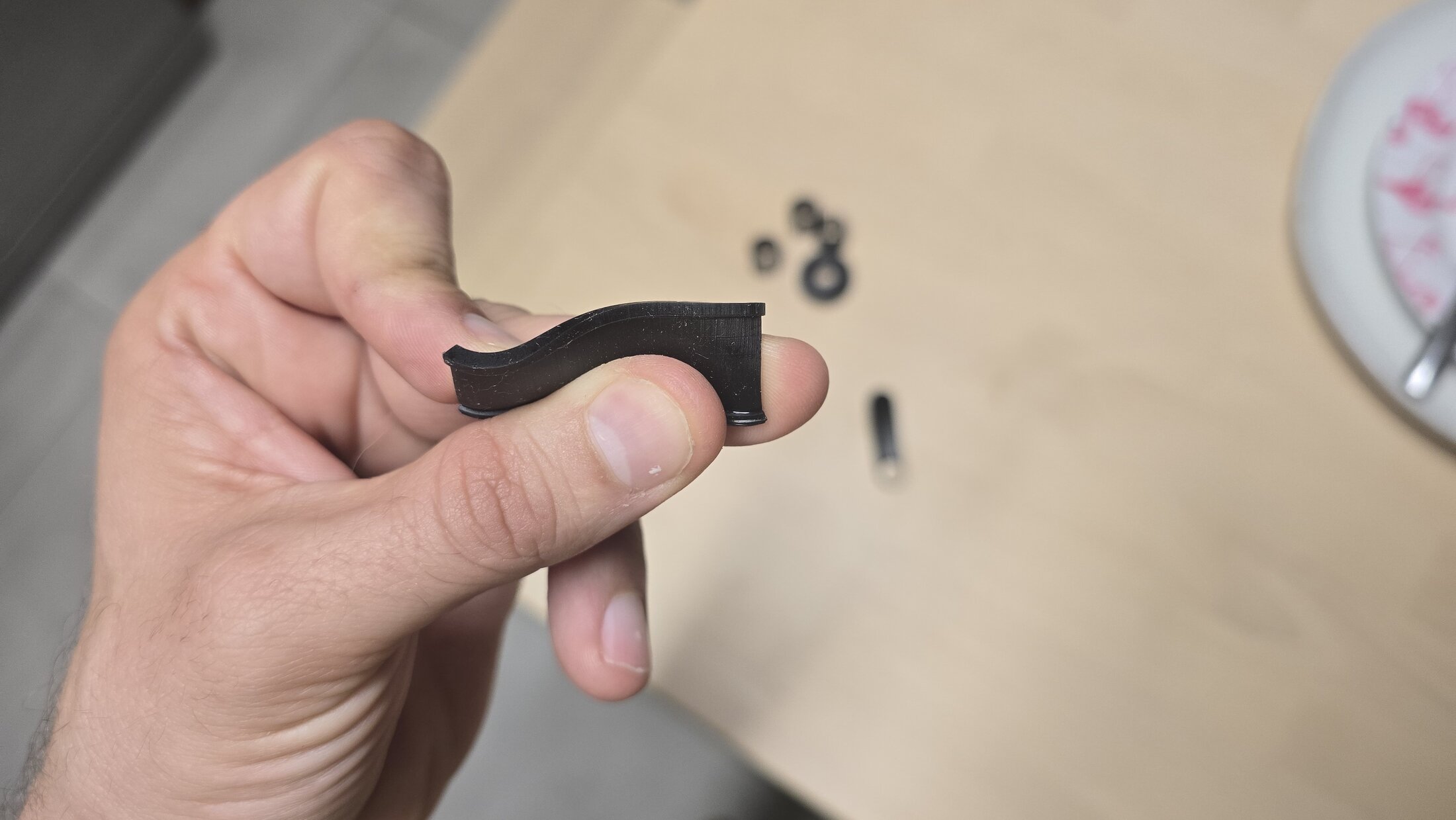

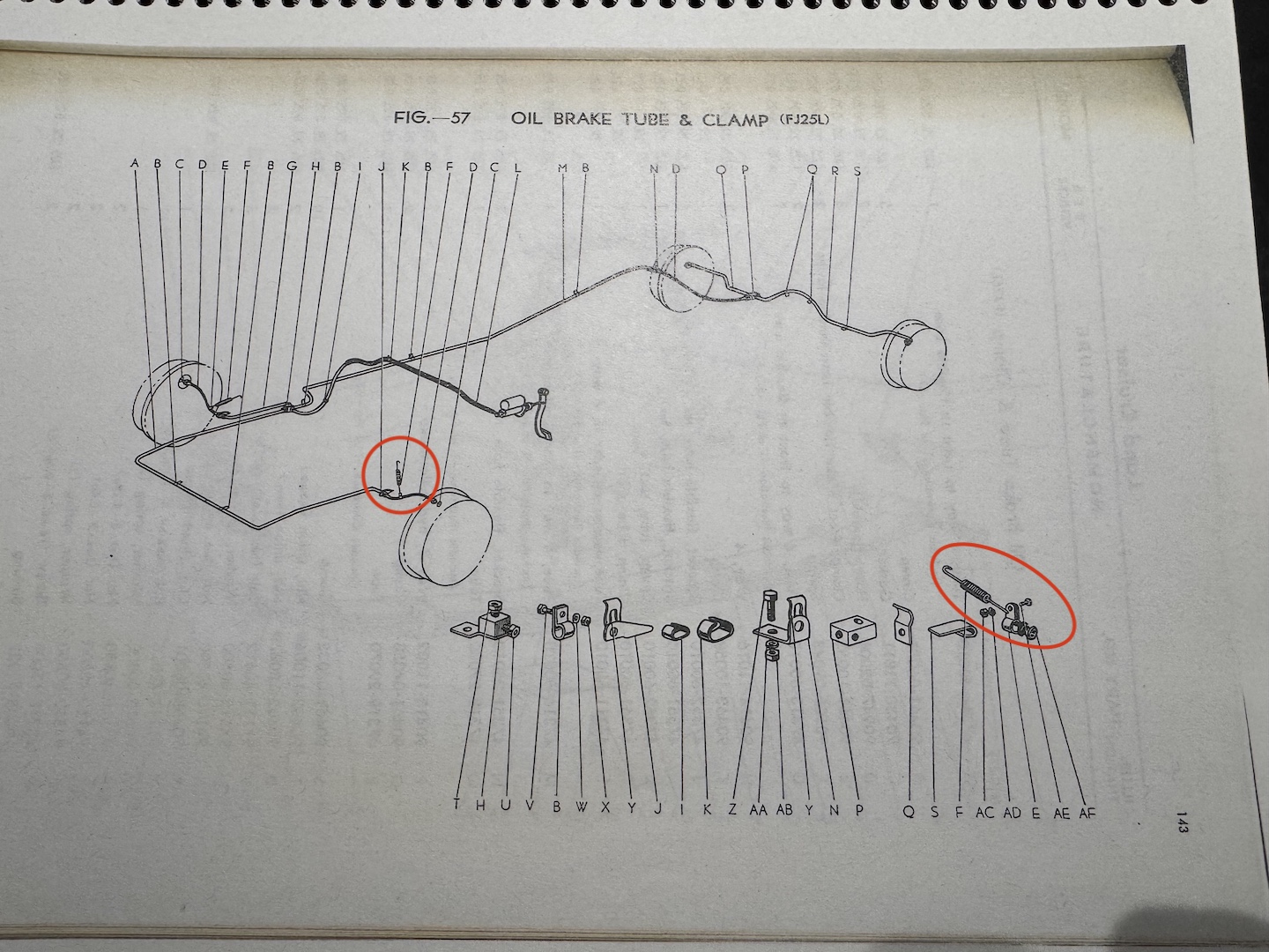

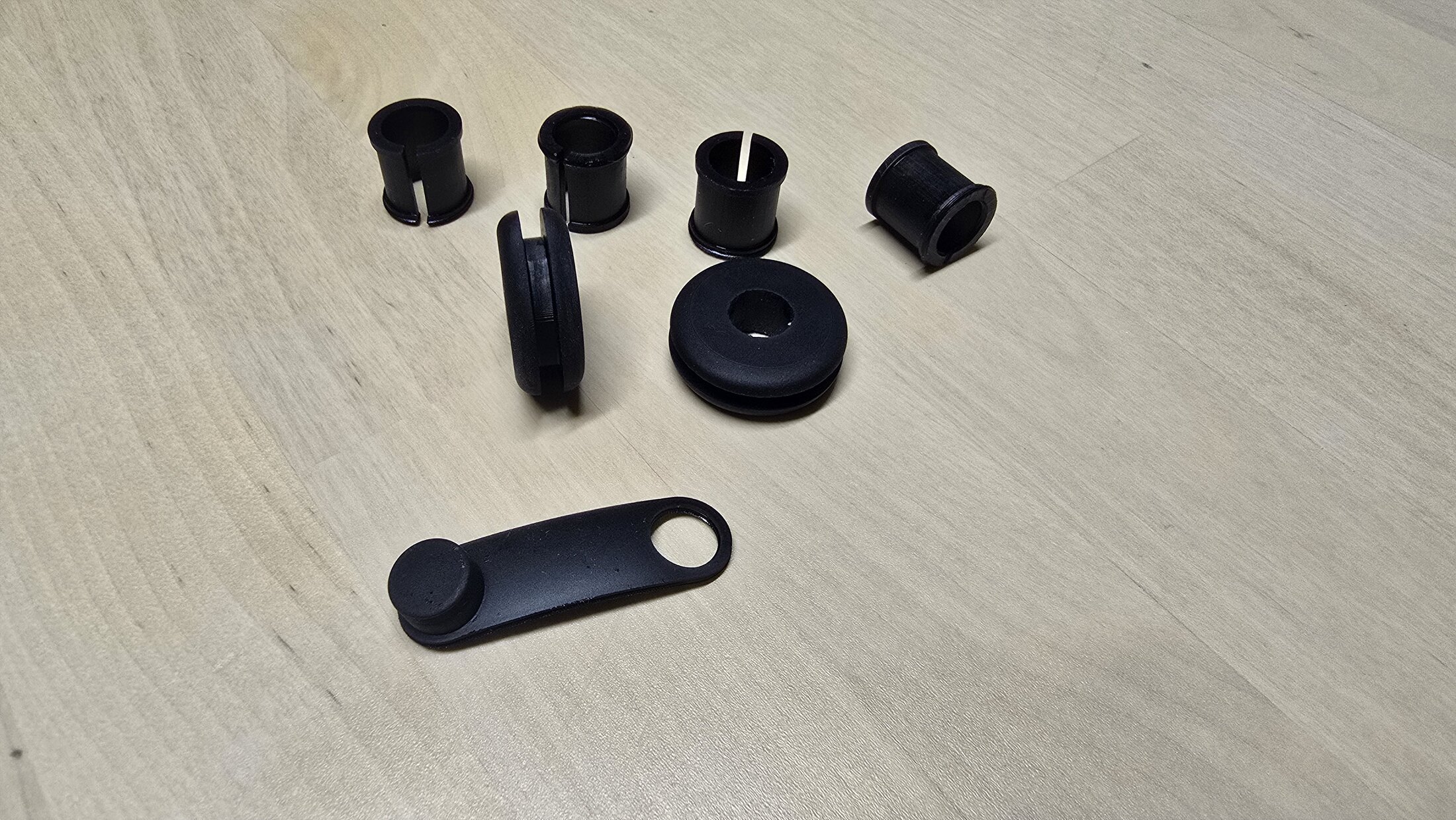

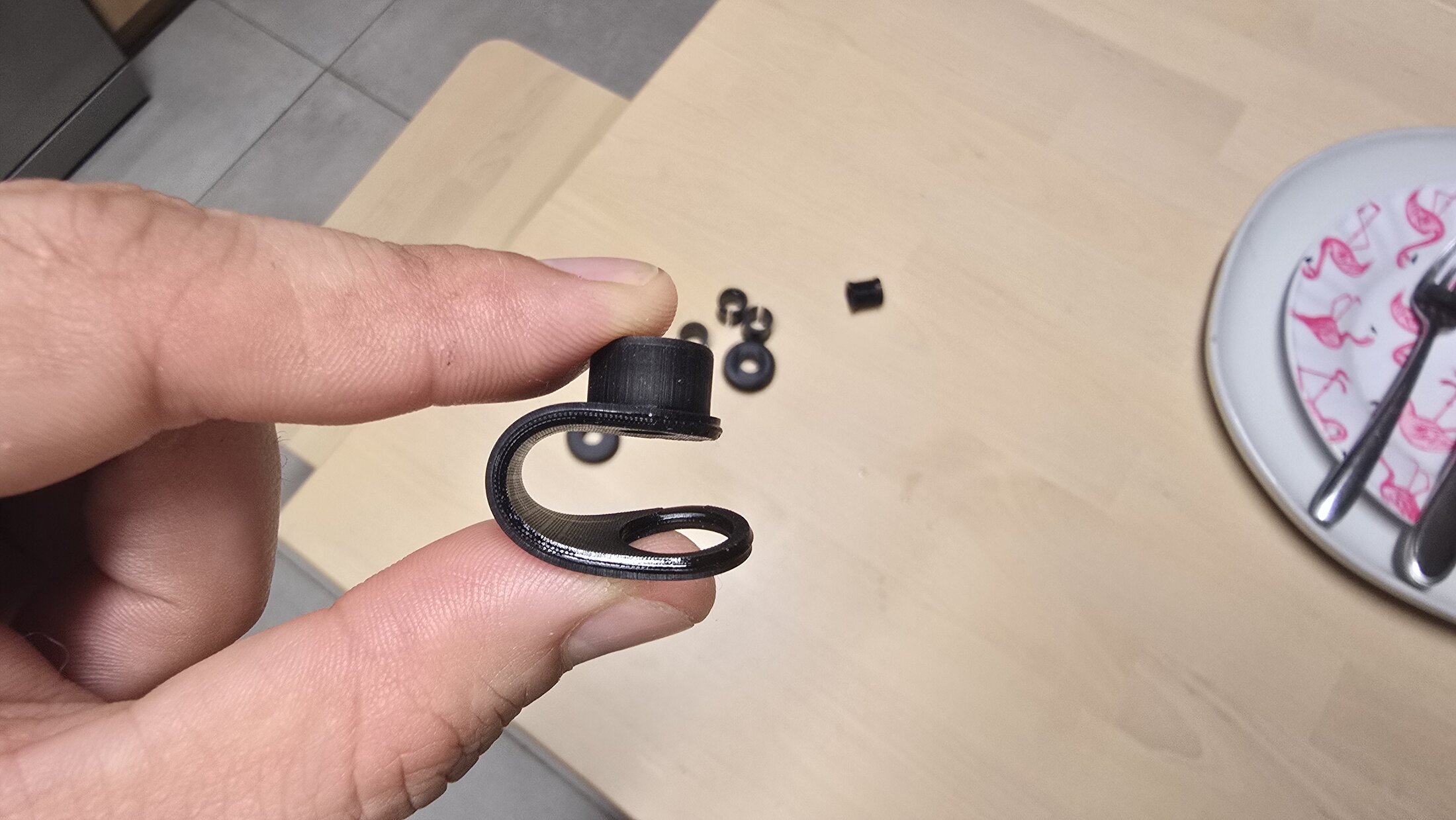

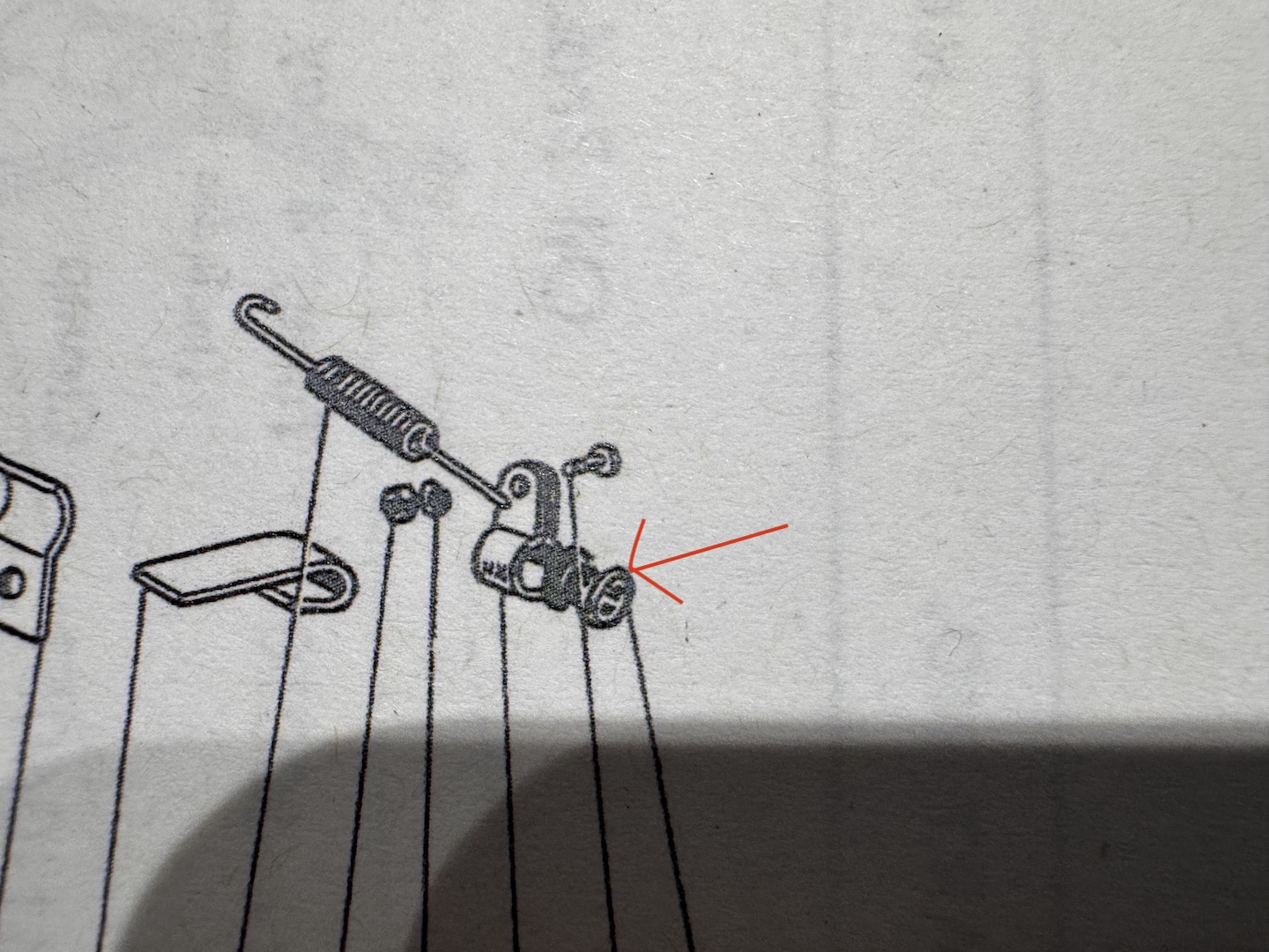

60's? FJ25 soft brake line clamp insert and the hood rod grommet. Also a non stock brake bleed cap for fun. I found out i can gently wet sand the area that has the supports with IPA and 320 grit to smooth out the surface. Looks way better than the ones I was scraping with a razor blade.
The soft brake line clamp is also used on early FJ40s and 45s. Just a different style metal bracket, but same rubber part.

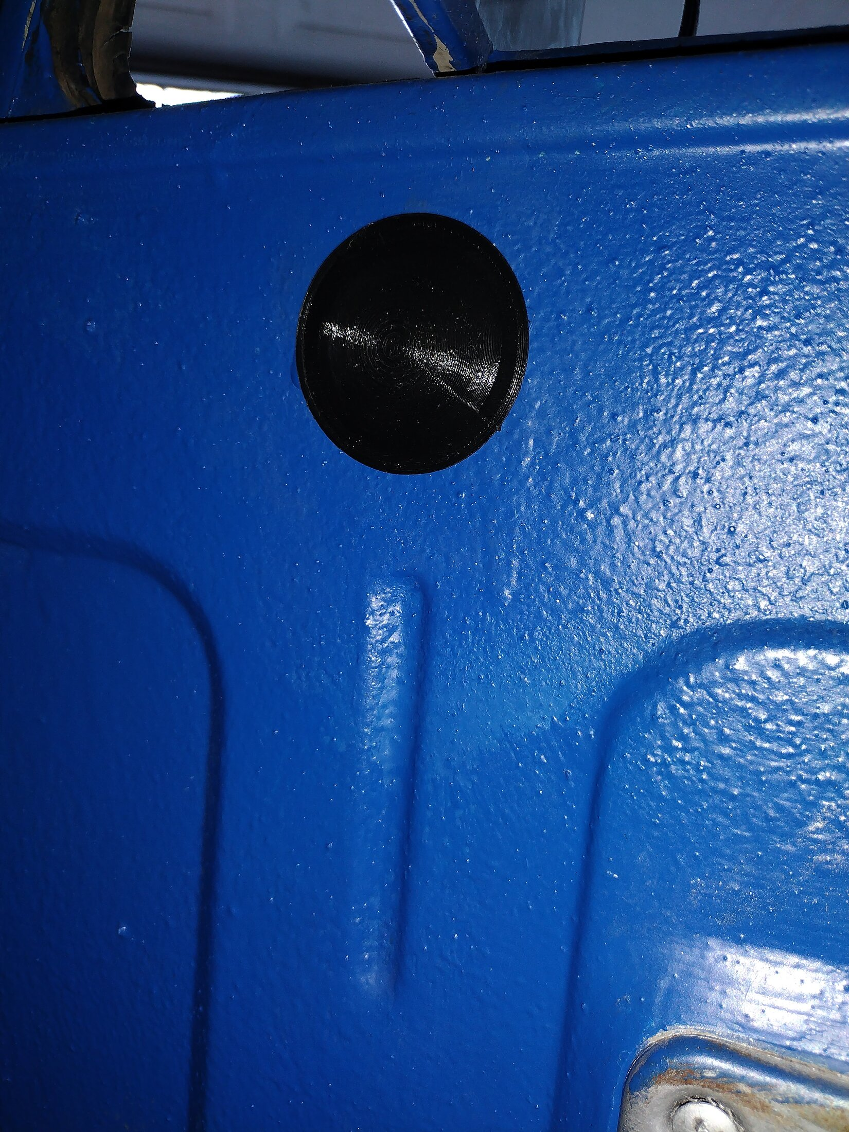

I bought the file to get the door access panel cover for my 69 and the file came with the TEQ in it but I had to paint it to get it to show up.
I asked a co-worker who does 3D printing as a way to goof around to print them for me.
That's cool! Did they ever come that way from the factory? Where did you buy the file?
I don't know if they were ever factory with the TEQ, and I can't remember where I bought the file but I still have it if you are interested, shoot me a dm.

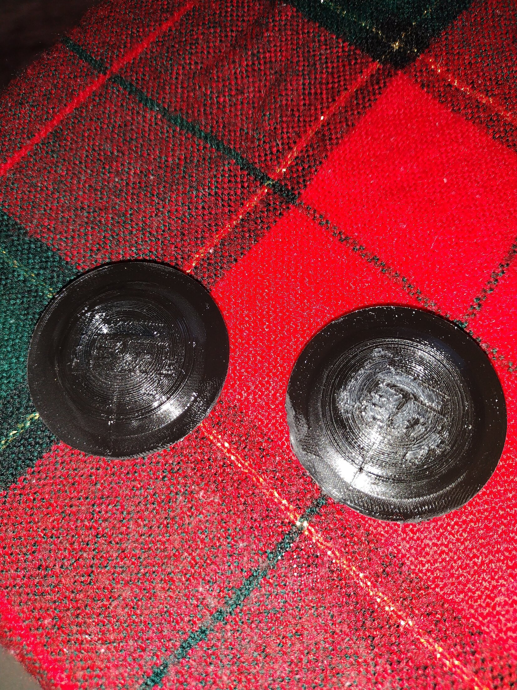

Okay this one is silly and I picked the wrong font so I need to go back and change it/resize the numbers but I made the little TG? Symbol and modeled the mold line. These are only ~$6 so I'm not sure $2 in resin is worth it when oem is available but it was quick to model
