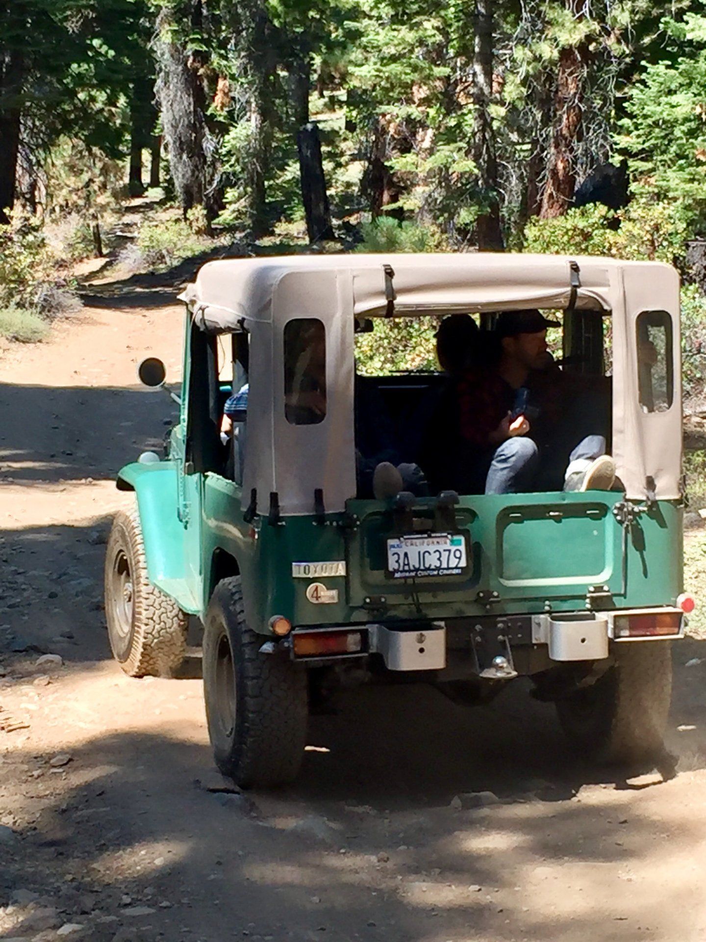

As a side I'm planning on moding the rear tops of the doors to slide out without having to take out the hinge bolts. Then I can pull them easily and when I roll up the sides adn pull the rear door tops it will really be open back there.
Also I've been using this makeshift arrangement for holding up the sides. It allows for a much more open feeling. I'd love to see a good system based on this idea rather than the usual straps as it makes for a better viewing area for the rear passengers i.e. the rug rats.

Peteinjp: I like the thought and had the same one before I sewed the side panels on. In a different version, I would make the side panels a zip-in option at the top so that if you wanted to drive for a few days/weeks without the side at all, you just zip 'em out. Wouldn't be that tricky to do, it would just take a little more time/measuring. You could use velcro also but wouldn't be as solid a fit as a good zipper.
For yours, you could cut/few a similar beige fabric "strap" (5"-6" wide running front to back on either side and then tuck your sides up and into it. Basically the same functionality of what you've rigged with the bungee cords but might look a little more OEM. If you wanted to go overboard, you could get male twist-locks on the strap to snap it up when the sides were in the "open" position. Anyway, plenty of options/ways to do it. Good luck!

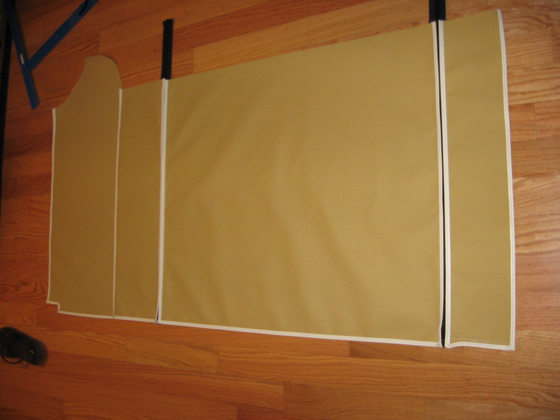

Whew - finished it! Learned a ton, loved the process, would kill for a dedicated workspace to do something like this 'cause I can't tell you how much time I spent just getting all the gear out, setting it up, then breaking it all back down, putting it away, etc. The actual work wasn't nearly as taxing as prepping the work.
In any event, I'm thrilled with the fabric (Seamark from Sailrite). It rained all weekend long and not a drop came through the top in any way, shape, or form. For my effort, I would give myself an 8.5 out of 10 (I'm generous that way). I inadvertently erred slightly on the side of being a hair too large, which is infinitely better than it being too small (read: not fitting). It looks 100% better than what the PO sent it with (which was not waterproof/watertight) and I personally love the way the black looks. Footman loop hardware works well, as does the hideaway flap for the twist-lock fasteners.
In any event, some pictures are attached and I'll write up a fuller description of what I did/didn't do right, materials, tools, and more so folks on this thread can learn from my mistakes.
Thanks again for starting this thread Ant and good luck to those of you tackling this project!

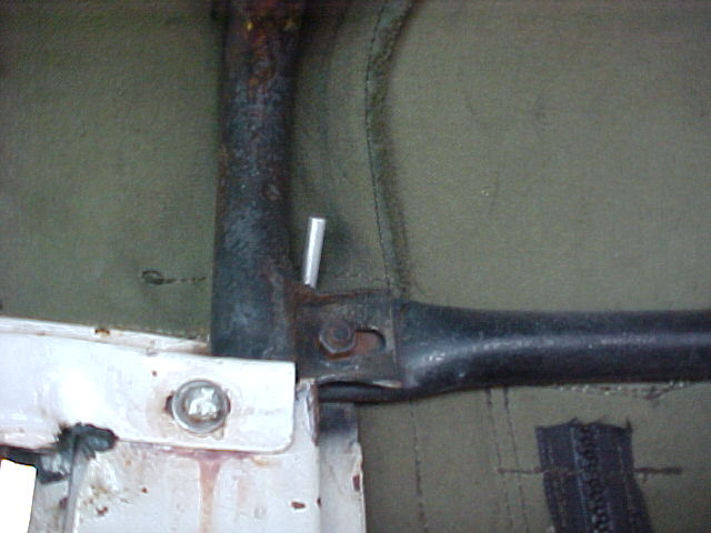

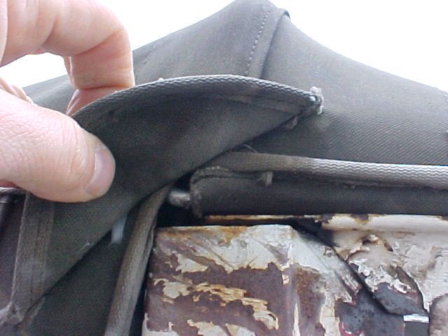

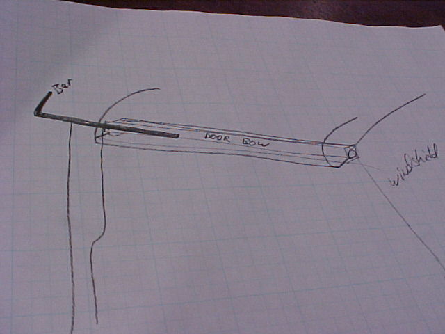

Pete over the door you can do what kayline used to do for their oem replacement tops... The welt above the door is just the fabric... The welt is an aluminum dowel that is bent at one end...
Very easy removal
If nobody posts pics of it... I know I posted some here before... But... My pics are at work... Can post tomorrow if nobody does (not dies.... stupid spell check) before me :)

I would like to see pictures of this setup.
EDIT: HA HA. Just as I posted, your pictures posted ahead of mine.
Thank you for the "preemptive response"!
That's a cool idea. I would think the windshield would be harder to do. But maybe one from each side?
