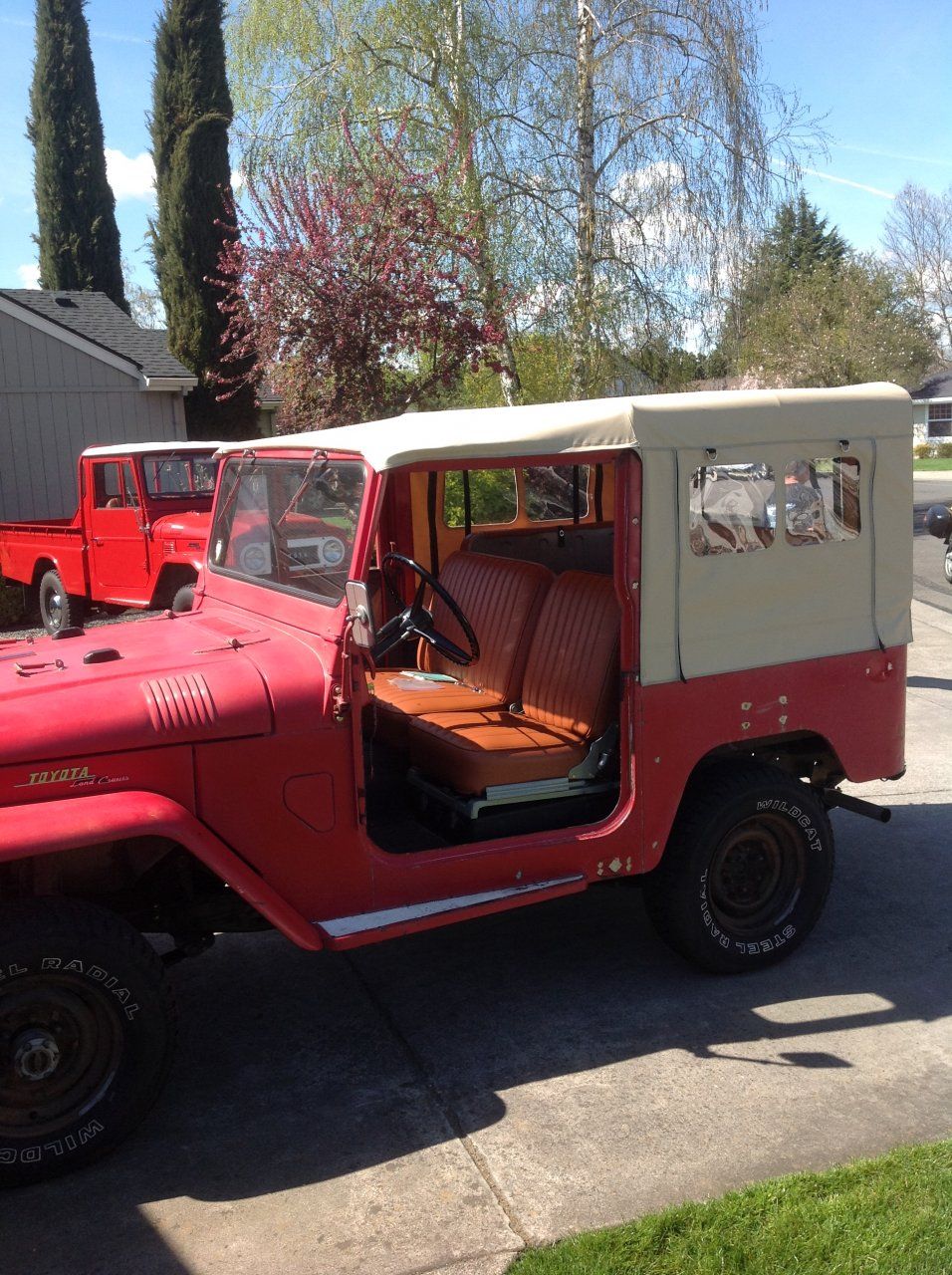

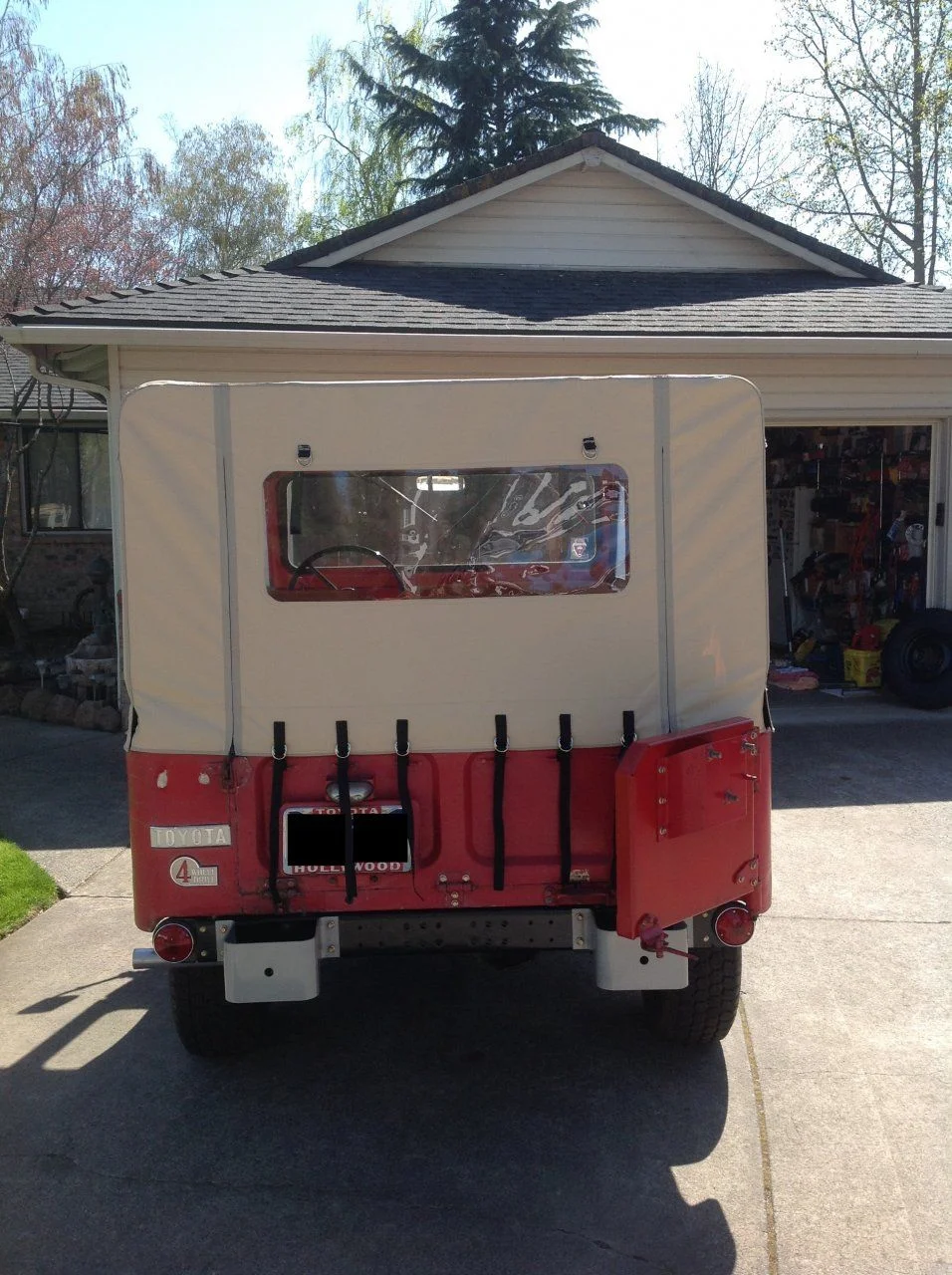

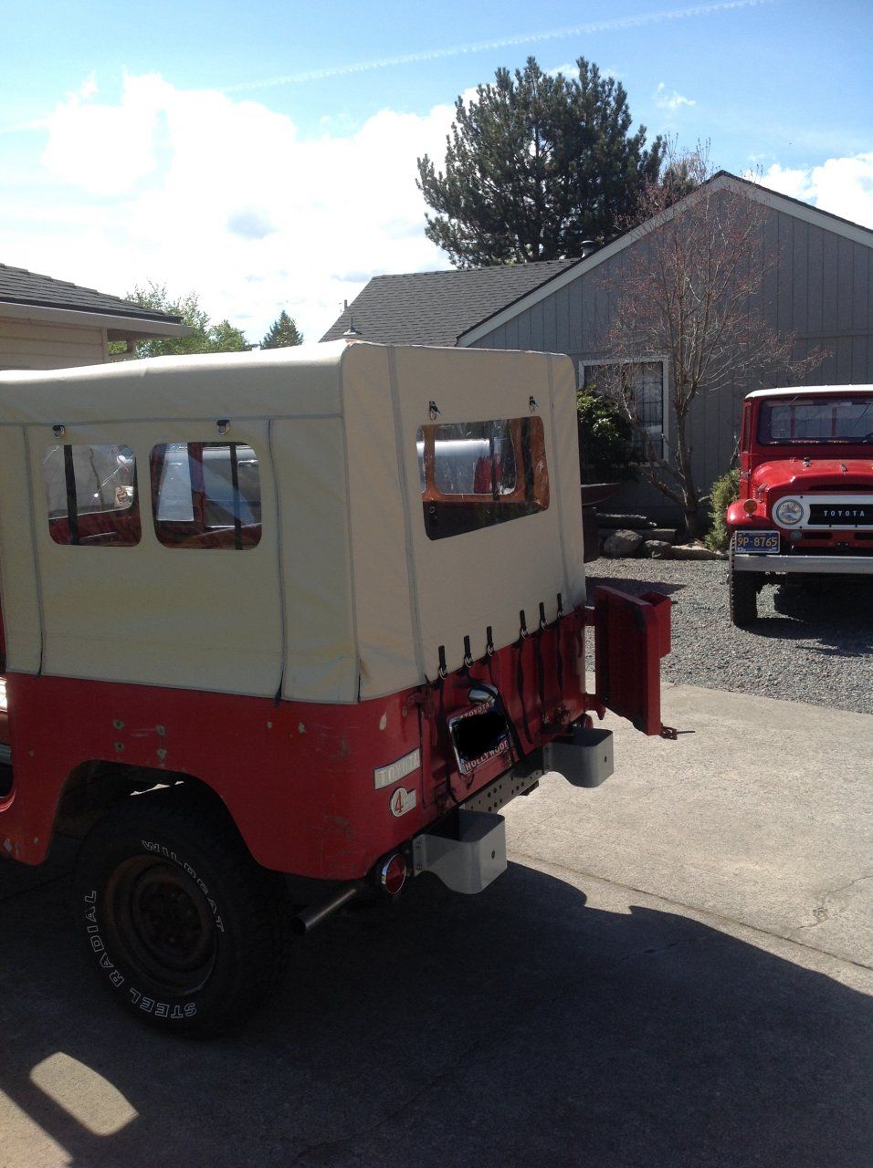

finally got the measurements right!!! This is the perfect balance between not too tight and not too loose. This is using a material that has less than 5% stretch.
These measurements should work great with canvas too.

Ant - looks great! I am about to place my order for the Seamark (100% waterproof Sunbrella) fabric to get started on mine. Can't wait to see your measurements/pattern for some guidance, even though the size for the 44 will be slightly different. Nice work!
