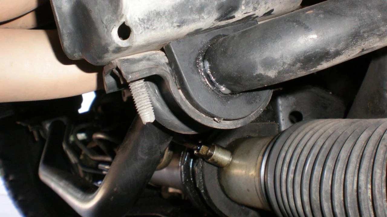

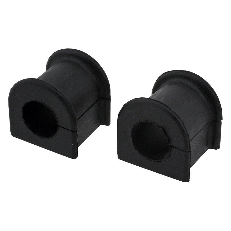

that's the end link bushing is this part
The bushings in the pic are of the link arms and, while they will rattle some, they generally don't creak. The bushings on the sway bar will likely still be intact and might even show little sign of wear but will creak when they dry out.
By the way ... You can test the sway bar theory by disconnecting the link arms from the sway bar, making sure the sway bar is secure, and driving it for a day. A little more body roll in the corners but otherwise no big deal.
They look/feel dry, no cracks in them. I'll disconnect the links and drive around before ordering stuff though.
Definitely wait before ordering parts. Creaks are an annoyance but, in most cases, not much else. There are several other items under there that can make that sound such as leaf spring (shackle) bushings, ball joints, and even a bad shock; but focus on the "most common" cheap & easy possibility first.
Something that cost no money to check (and since your particular Cruiser gnomes are fond of loosening bolts!) is to take your new torque wrench to the spring pack U-Bolts and be sure they are tight, i.e. not letting the axle shift around. When the threads are clean the torque on those would be somewhere around 90 Ft Lb.

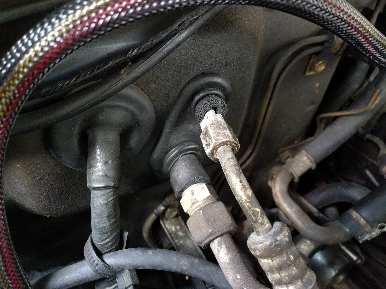

So my AC is leaking at the rubber covering the fittings. Fittings are tight and not leaking. I'm assuming this is leaking from the evaporator coil behind.

The foam at those fittings is only there as insulation and to prevent chafing of the lines. Is it leaking freon at those spots or just water? If it's just weeping condensation then the system is not necessarily compromised.
I think it's leaking freon. When I pull back the foam and spray it with soap solution it bubbles.
