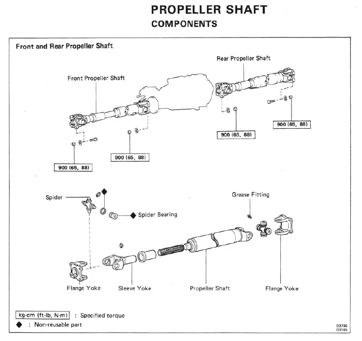

The slip is facing down from the factory, not up towards the transfer case. Doesn't really matter, but I wanted to point out that that would not have contributed to your vibration problem at all.
Line drawings in the FSM show the slip toward the T-case, that's how I have come to the conclusion that it should be on the T-case side. . No thought at all that this was the cause of vibration.
You're right. The rear does have the slip at the t-case for the single-cardan shafts, yet the front has the slip at the differential. Huh. Rear DC shafts have the slip at the bottom, guess I thought both styles were oriented the same.

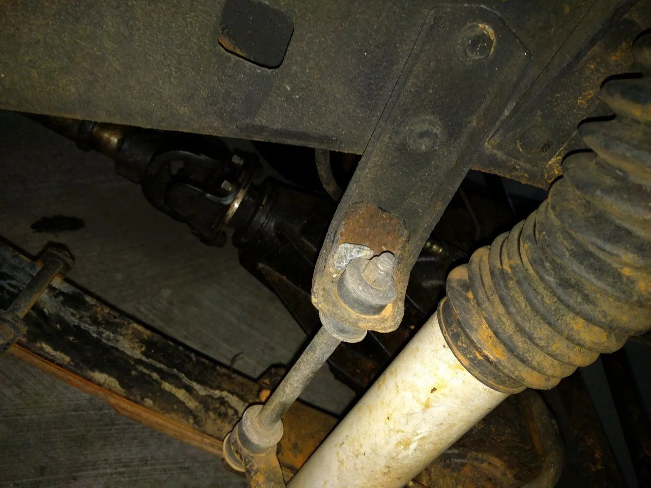

Now there is a "creak" coming from the front right suspension when I'm turned and hit a bump (like turning into my driveway). Will look under it this weekend to check the bushings.
The joys of daily driving a 30 year old truck.
First good place to look .... sway bar bushings.
