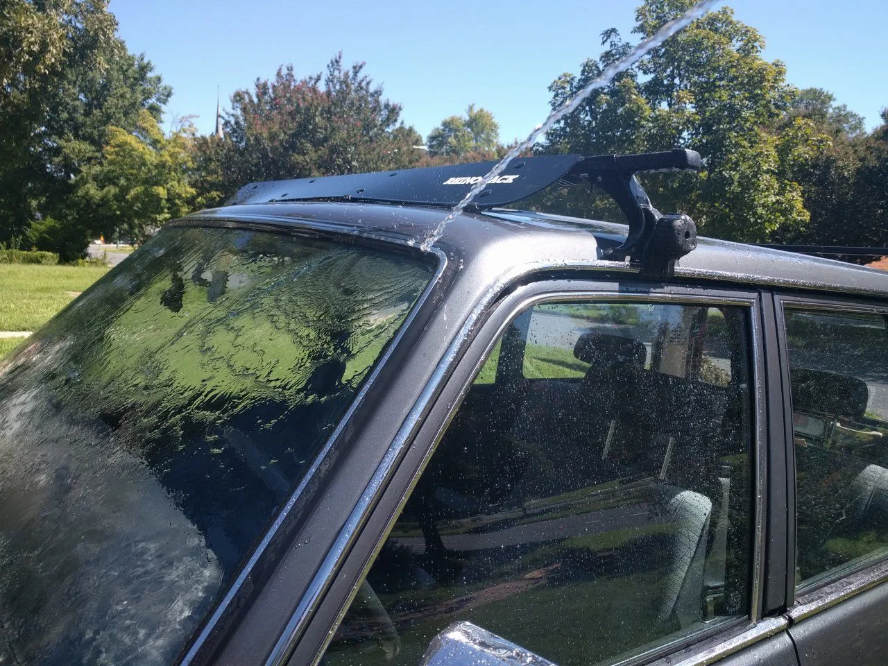

Poured 2 gallons of water in the gutters with a bottle and then set up the hose to slowly release water for 25 minutes. Dry.
I'm assuming process of elimination means it's my windshield seal?
15 min spraying the corner if the windshield leads to nothing. Guess I'm fixing both issues even if they aren't causing it.

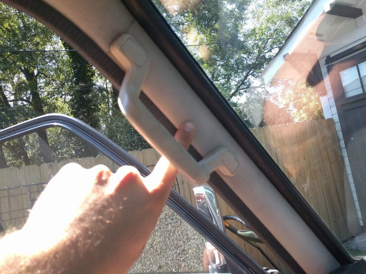

@CharlestonG8R - I don't think the door seal would cause this leak, the fabric behind the grab bar was wet (see picture). Maybe I'm wrong but don't think water could come up and around the door and then soak through the fabric at that location
