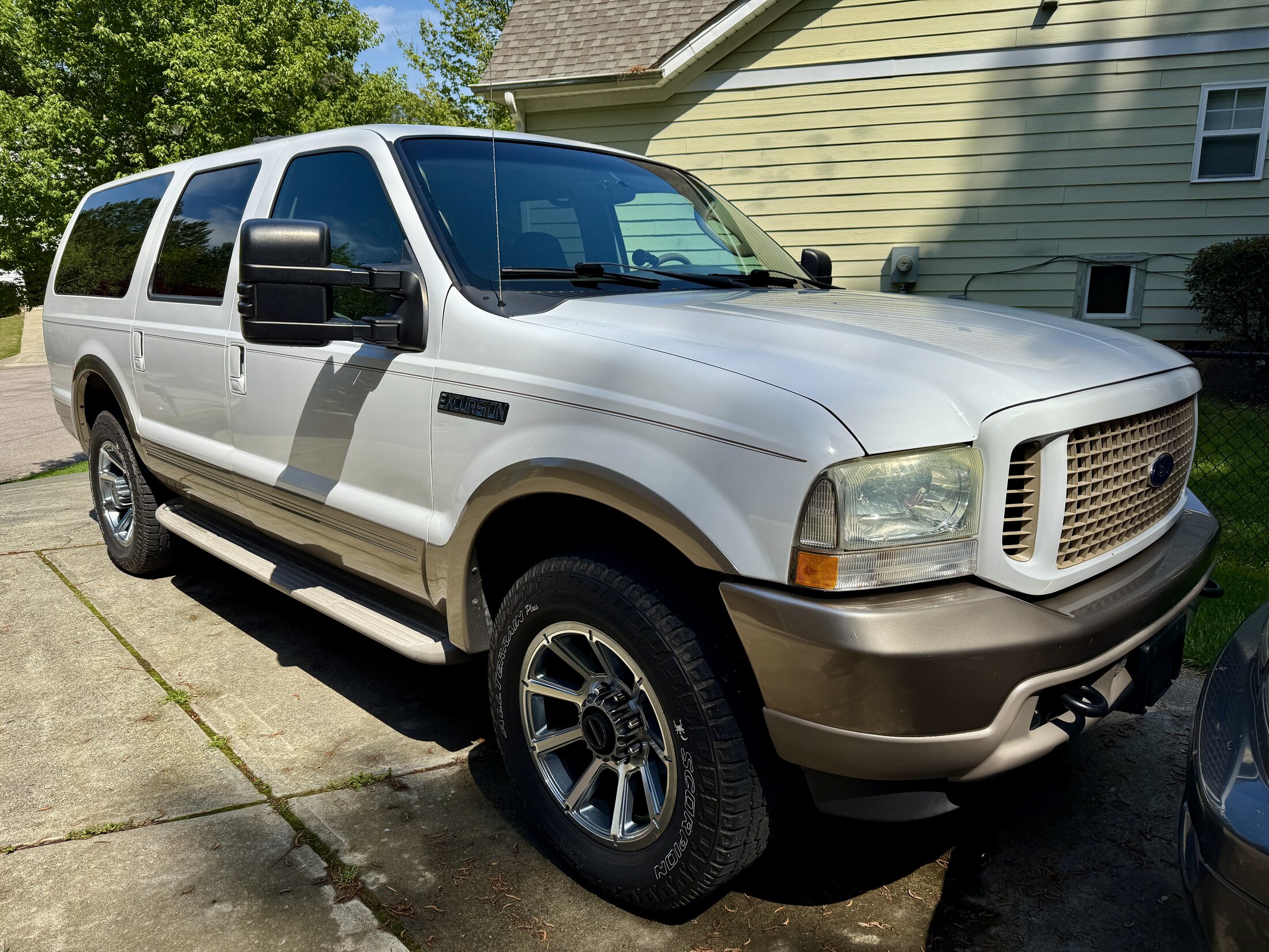

Going to log my progress on my new 2004 Ford Excursion 6.0 EB here so I can track it somewhere. The Ford forums....aren't great.
For those who missed it, I bought this low mile, rust free, really clean 6.0 Excursion with 160k miles on it a couple months ago to possibly replace my 2003 LX470 that I've owned for the past 9 years. Well, the LX was sold this past weekend to a buddy of mine from Denver, CO so this is officially the new daily.
This truck came with a BulletProof diesel semi-bulletproof kit so at this point is is bulletproofed, minus studs. Heads/studs are on the list to address.

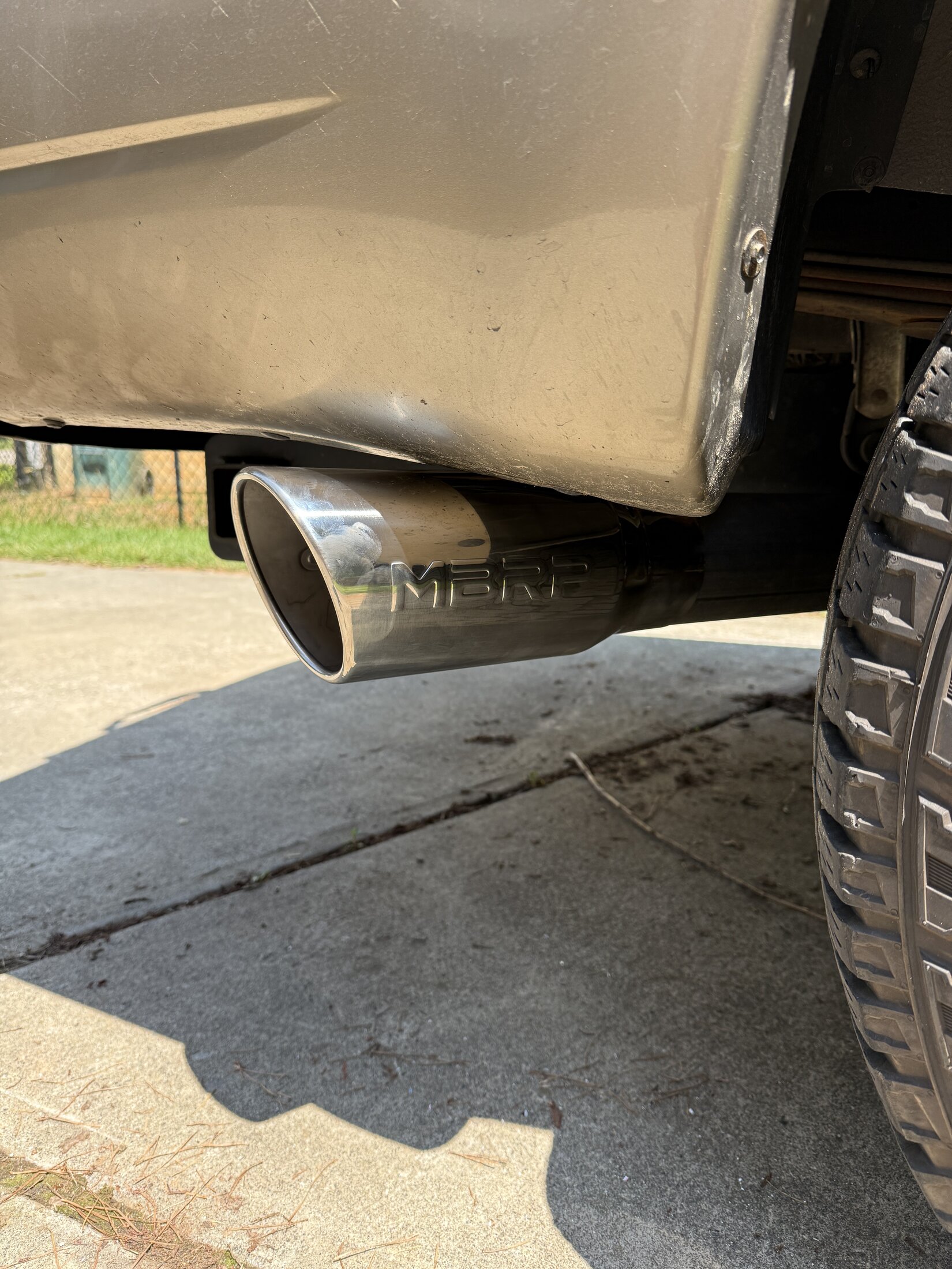

First "mod" was putting a MBRP 4" stainless turbo-back exhaust on it which I got done yesterday. It was a really good price with the MDW sales at Autozone and somehow this specific system was included in the sale even though all other MBRP systems were not. Maybe I just got lucky!
