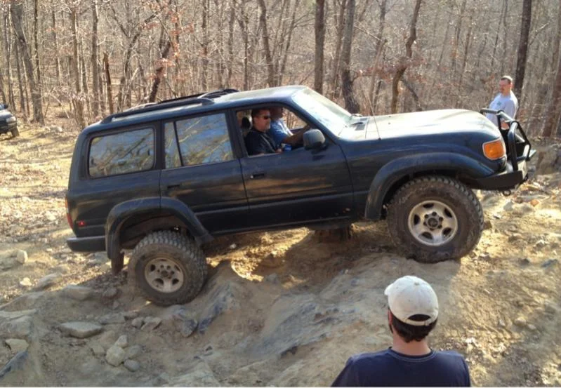

Here I am in the passenger seat at the December URE trip. I'll add some pics of my own when I have time to take some. (And, no, I didn't set out to find a green 80 to match my 40 :doh:).

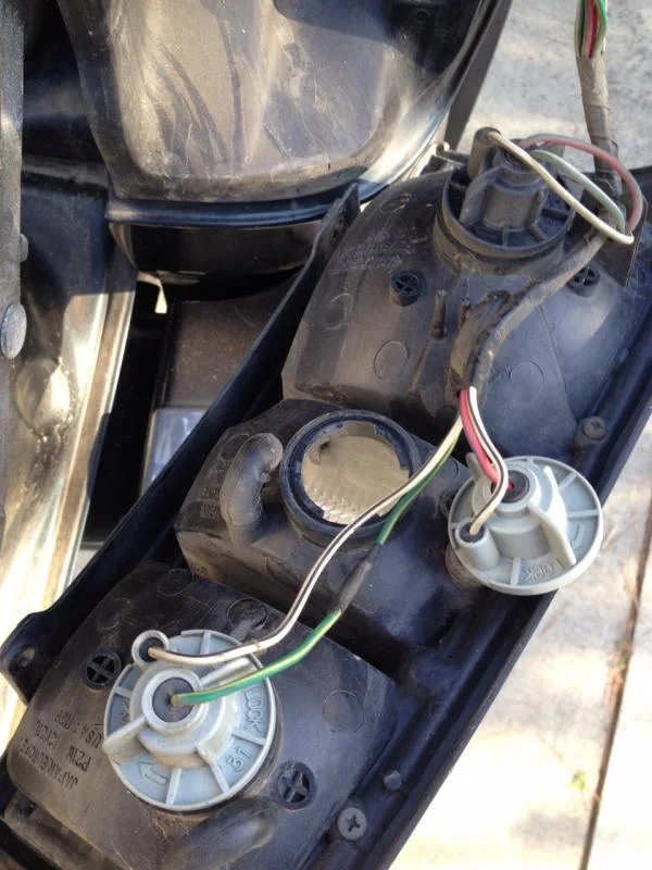

Reverse Lights
The only thing I've done so far.
Superbrightleds #1156-CW45-T. Can't wait to see them at night. Any light output will have to better than what I had with the factory bulbs.
1. Remove housing. Remove reverse bulb.
2. New on the left. Old on the right.

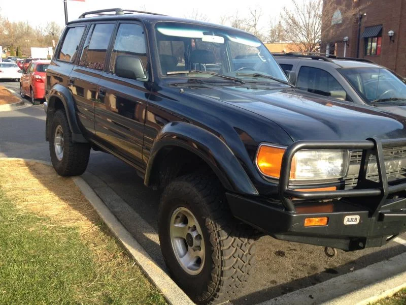

Mall Crawl
So I found a great parking space at Trader Joe's but there was an obstacle in the way. Luckily, I didn't have to engage the lockers. 35's sure would've been nice, though. ;)
That trader joes has the tightest parking lot ever made
All the hippies in their yaris and prii didn't think that larger spaces were necessary :lol:

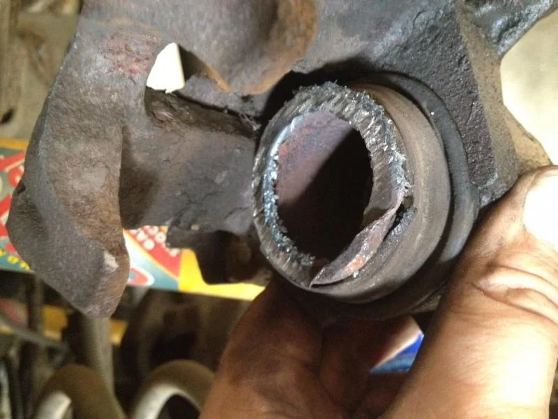

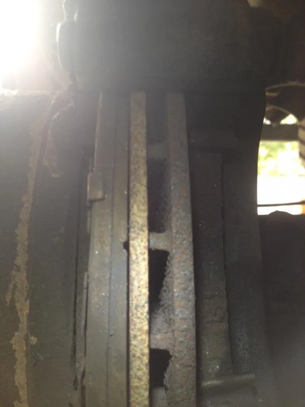

Rear Brake Job
The parking brake was rusted and seized so it was time to rebuild it. There was also some grinding going on back there on the PS. Time to check that out, too.
1. Who knows what's wrong here?
2. Not what it was designed for.
3. Found it.
That's all the pics I took. The rear rotors, calipers and pads were replaced.
I removed and replaced the parking brake assembly (bell crank and such). The drum pads for the p-brake were still well within spec, so they stayed. I used Poser's thread to walk me through it and I don't have anything to add other than his parts list lacks the 2 screws per side to hold the bellcrank assembly to the hub/backing plate/whatever it's called. His list was for a '97 LX but the part #'s checked out for my '94 too. Parking brake?
