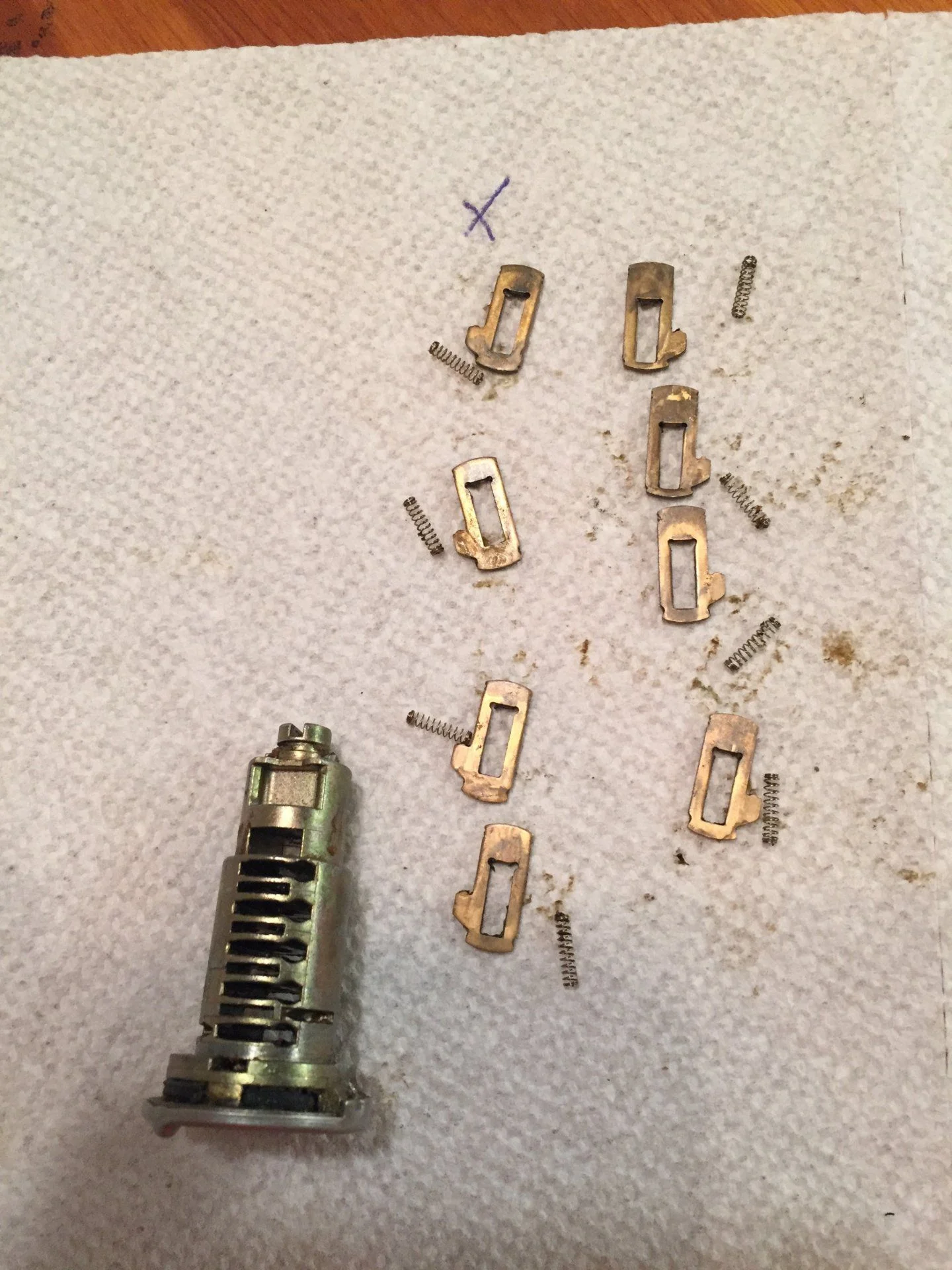

1. Lock cylinders removed, cleaned, lubed, and reinstalled; @JohnVee

2018.04.16 Door lock cylinder refurbishment teaser shot. Write up in progress. Many thanks to @jrmudder92 for gaining access to the vehicle after I found all 3 door locks to be non-operable from the outside...both times. Sometimes it pays to take your 'new' vehicle directly to a monthly meeting before driving 3 hours home!

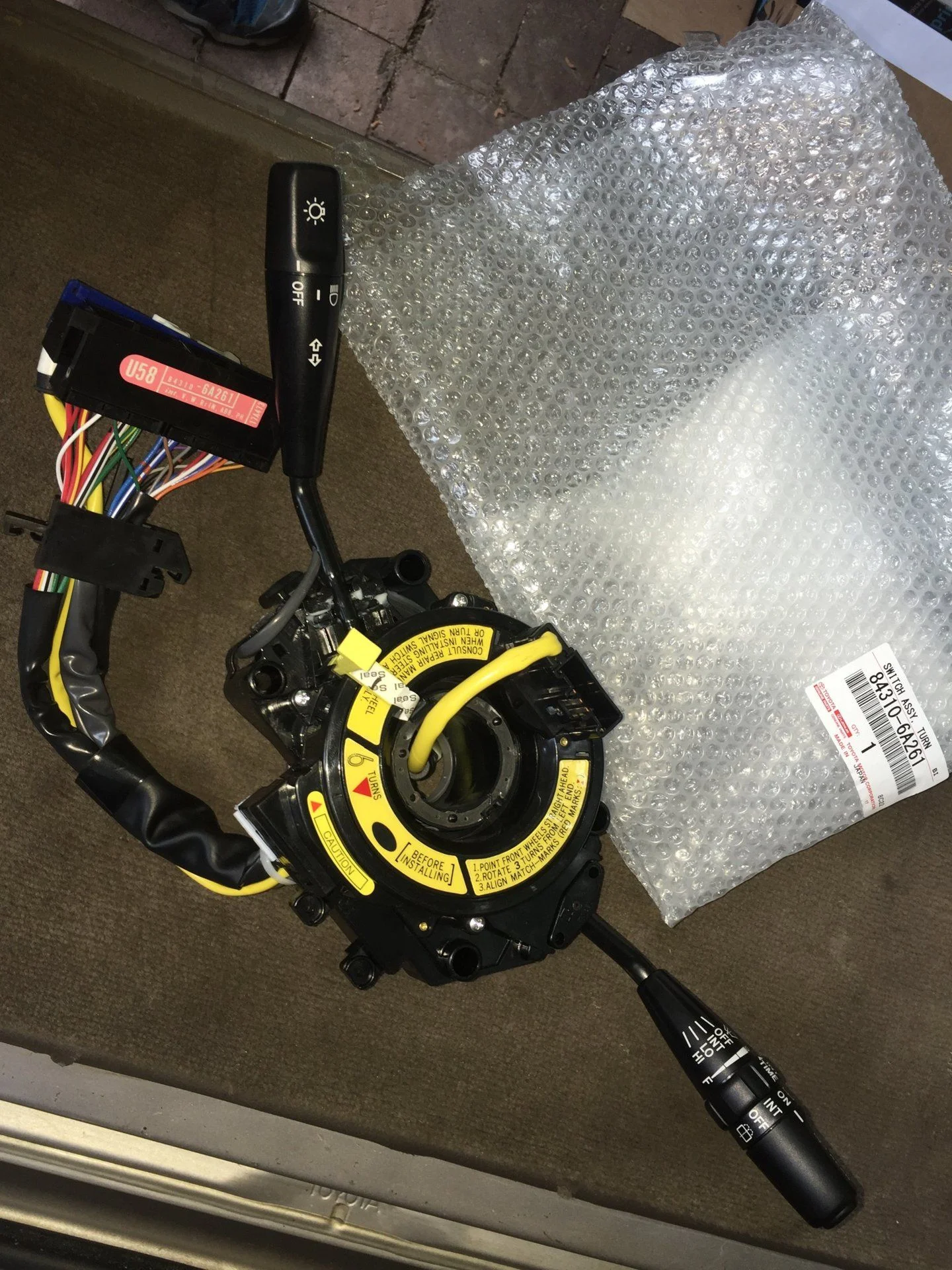

2018.05.04 Replaced the spiral cable (aka clock spring) assembly. All this because the horn wouldn't function. Still need to troubleshoot and fix the cruise control.

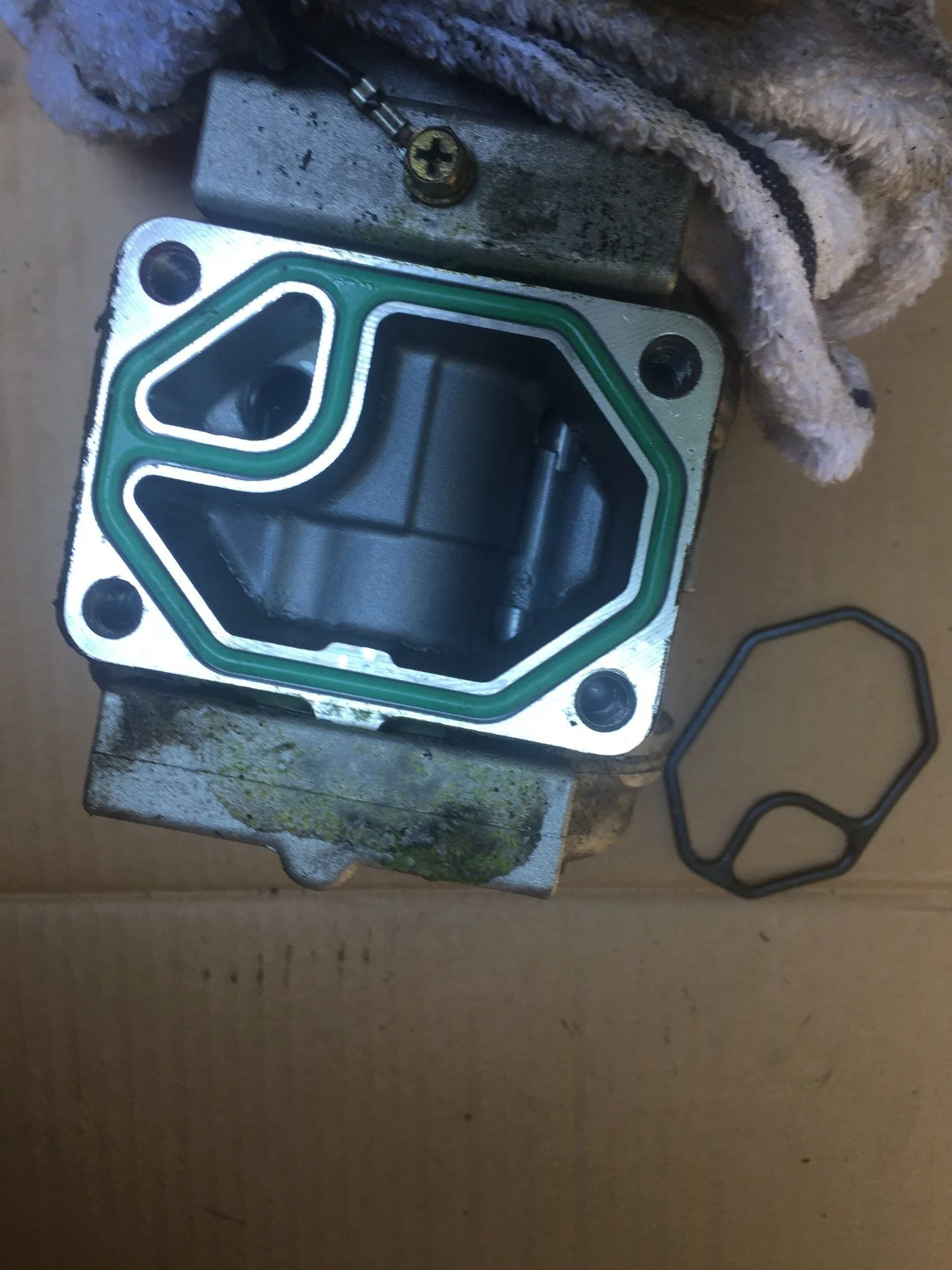

2018.08.11 Replaced leaking AC compressor seal and the associated O-rings. Vacuumed the system (thanks @Roxx) and recharged with R134a.

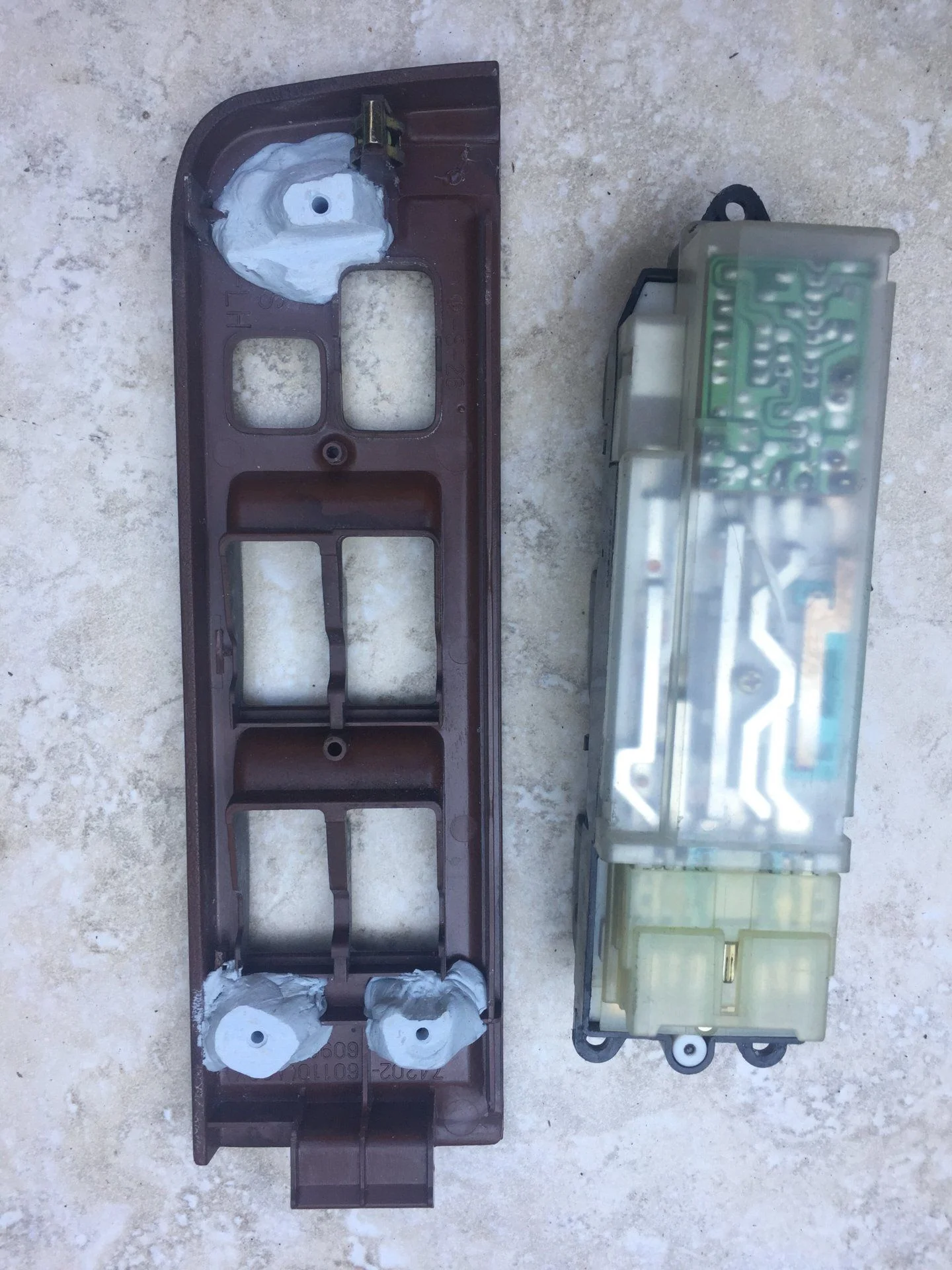

2018.09.03 Rebuilt the DS master switch panel mounting holes with JB Weld.
