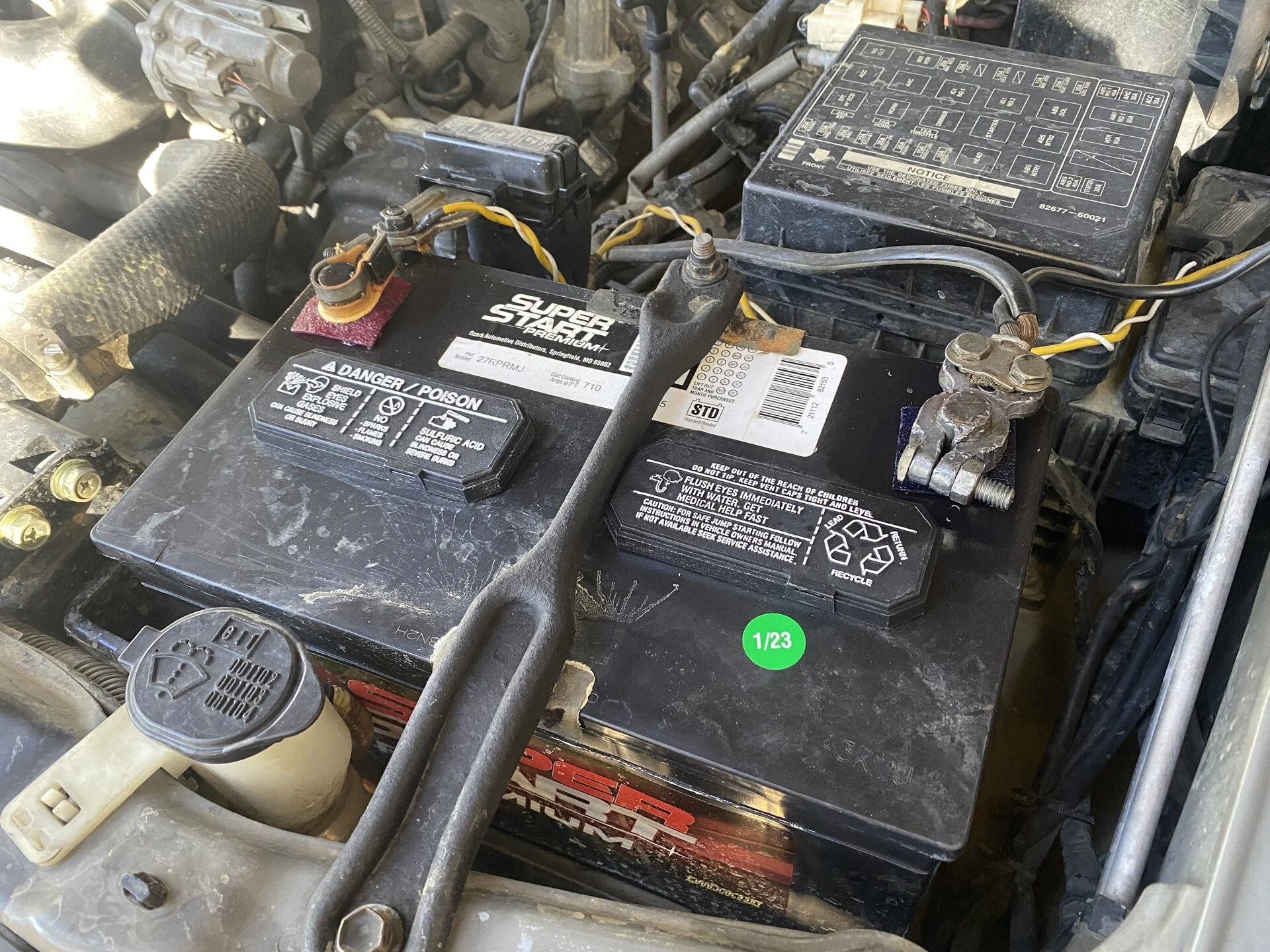

  • My starter was a little sluggish the first day or two, but I also noticed that the battery terminals had pretty bad corrosion. Now that the corrosion is all cleaned up, I haven't had the starter click problem. I went ahead and ordered a new factory starter to have it in the shop just in case, but if I can avoid pulling the intake manifold for now, I will. Anyone else seen that same issue, or is the solenoid on these old starters problematic?

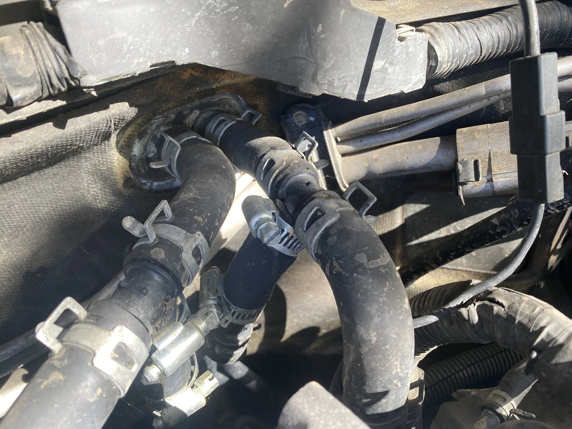

Heater tees? Don't even push on them with your thumb to 'test' them, until you have replacements on hand. If they original, they will likely crumble.

Slow crank during start. Is almost most always related to battery voltage. Oxidation between post & clamp, not only reduces voltage to starter. But also reduce it's ability to accept a full charge, which damages battery. It's very likely the starter was replaced, during engine swap. Either with start in replacement engine or a remanufactured. You can look at starter without pulling intake manifold, for clues (info plate).

My LX is a tad slow to crank as well (gut feel). I’ll clean up my battery terminals like you did and see if there’s a difference.

I think the battery terminal cleanup did the trick... if I can avoid taking off the intake manifold for a while I will.

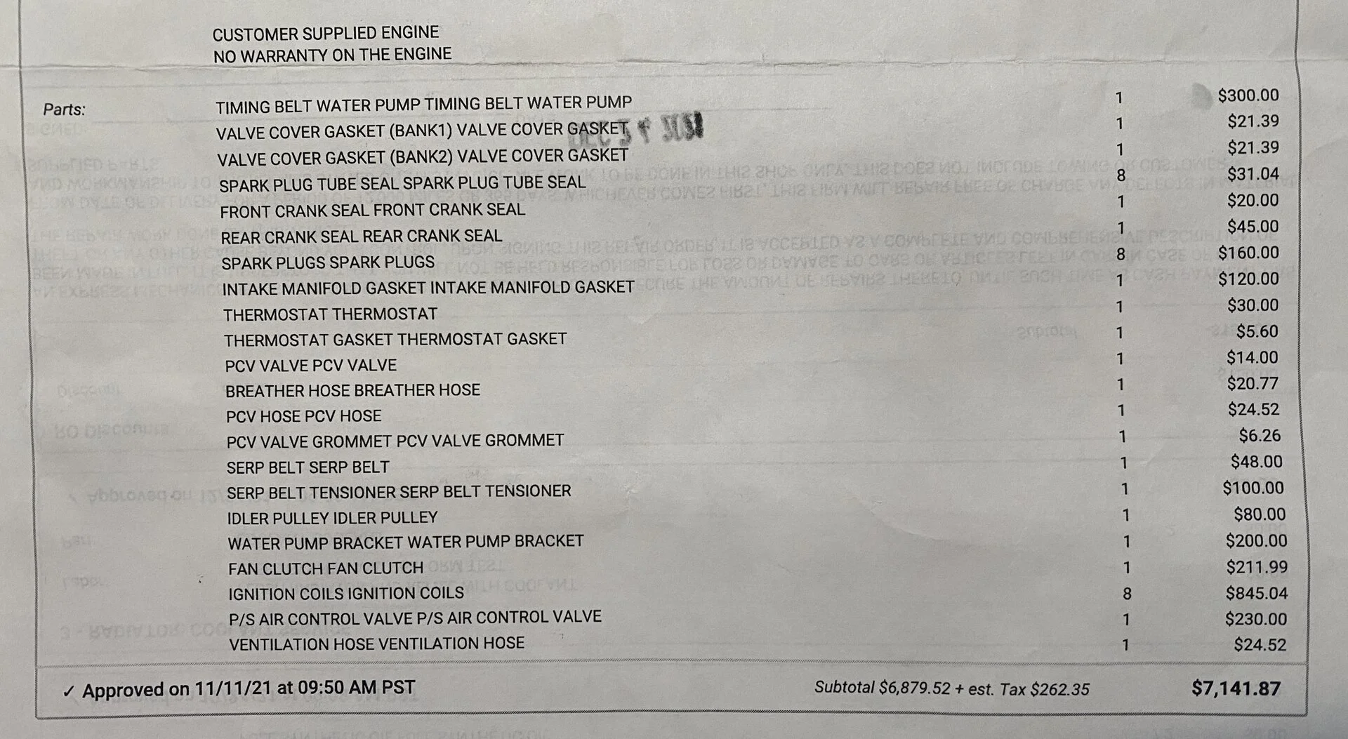

Also, for the fun of it, here's the invoice of the engine rebuild from 2021. Did they miss anything they really should have done on this rebuild? Looks like a basic rebuild to me.

Took a few photos and it looks like the heater tees have already been done!

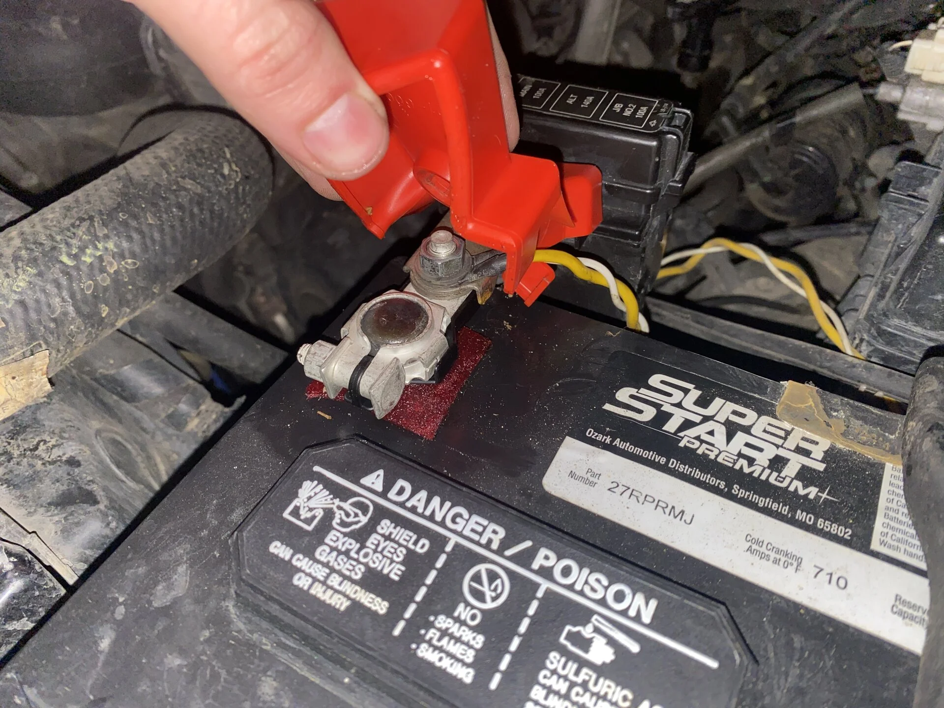

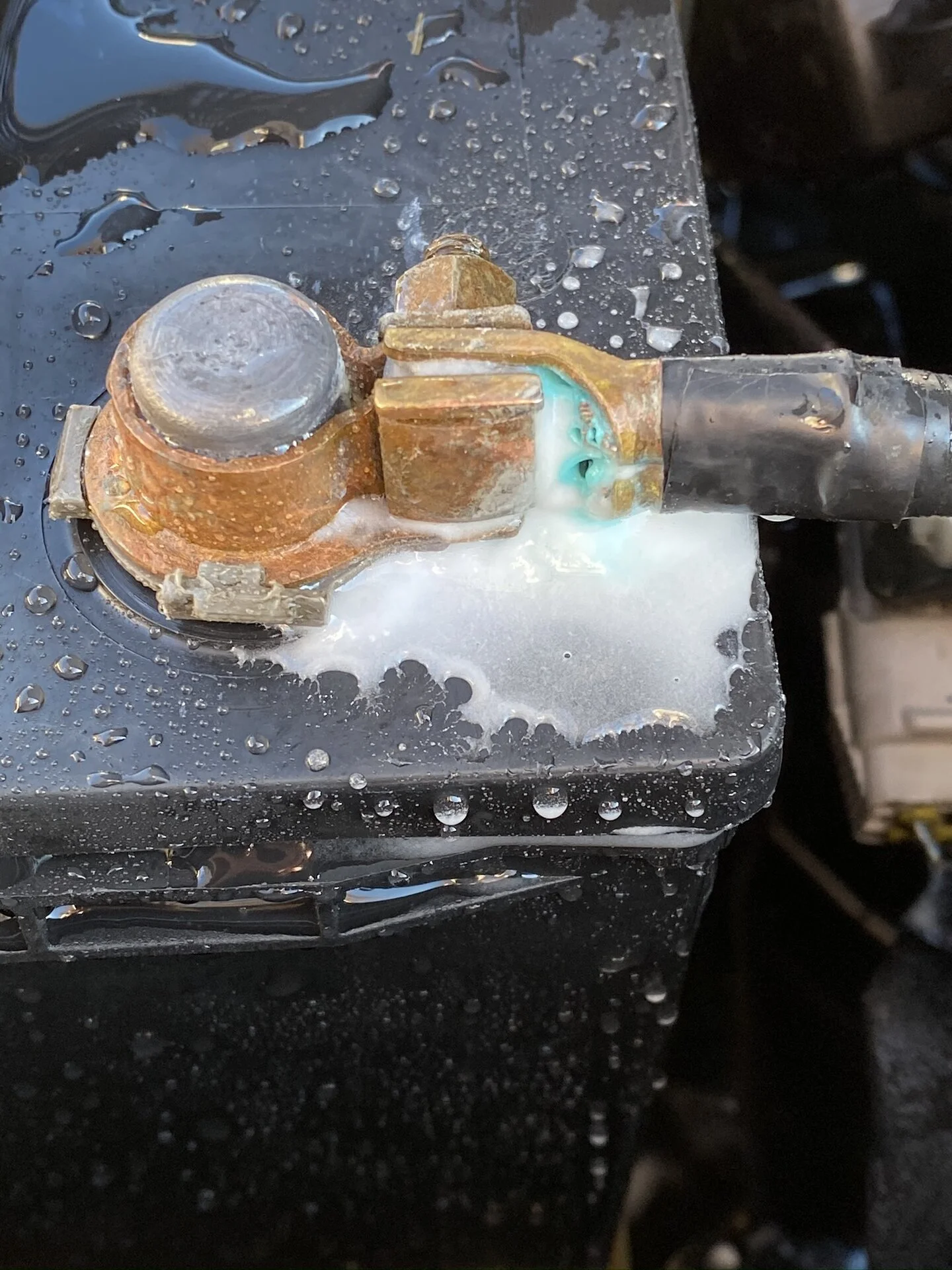

I'll assume you use baking soda and water solution to neutralize acid (battery corrosion), to clean. The aftermarket clamps indicate, it had battery issues. Mostly likely corrosion and or overtightening battery clamps, Which aftermarket Negative is showing now, was overtighten. The aftermarket wire, indicates aftermarket toys installed. So watch for parasitic draw.
When battery corrosion, goes uncleaned to long. Corrosion (acid), does get into positive cable fuse block. So I'd inspect it internally.
The guys at Lexus service did the work, so I’m not sure if they used baking soda and water or some other neutralizer. I’ll keep an eye on it from here though and do that if and when I see the development of any more buildup. Do you happen to have a photo of what the stock terminals look like? As for the aftermarket wires, those are heading to a relay and switch for some led floods. Eventually I’ll make an accessory block for that sort of thing.
Appreciate the help!
To be safe, so paint and metal not damaged. I'd spray with braking soda water solution Or wet and sprinkle, the entire area.
OEM pos
OEM neg with baking soda solution. Blue is acid being naturized.

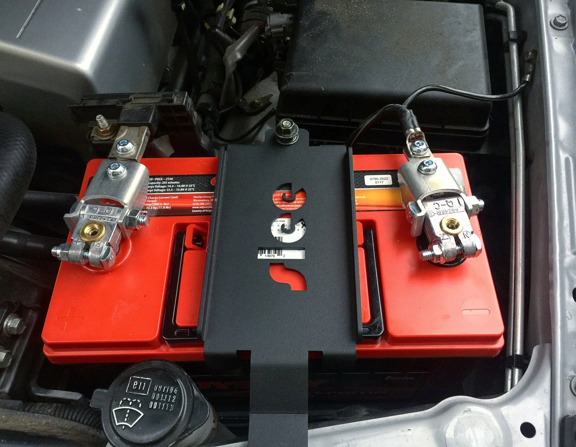

Aftermarket
I should have mention. The positive post fuse block, is larger (like above) on newer LC/LX than yours.
Any chance you have links to these aftermarket battery connectors? Factory negative appears to be discontinued.
No sorry. Slee has some cool ones. I just went to parts store and custom fit what I could find.

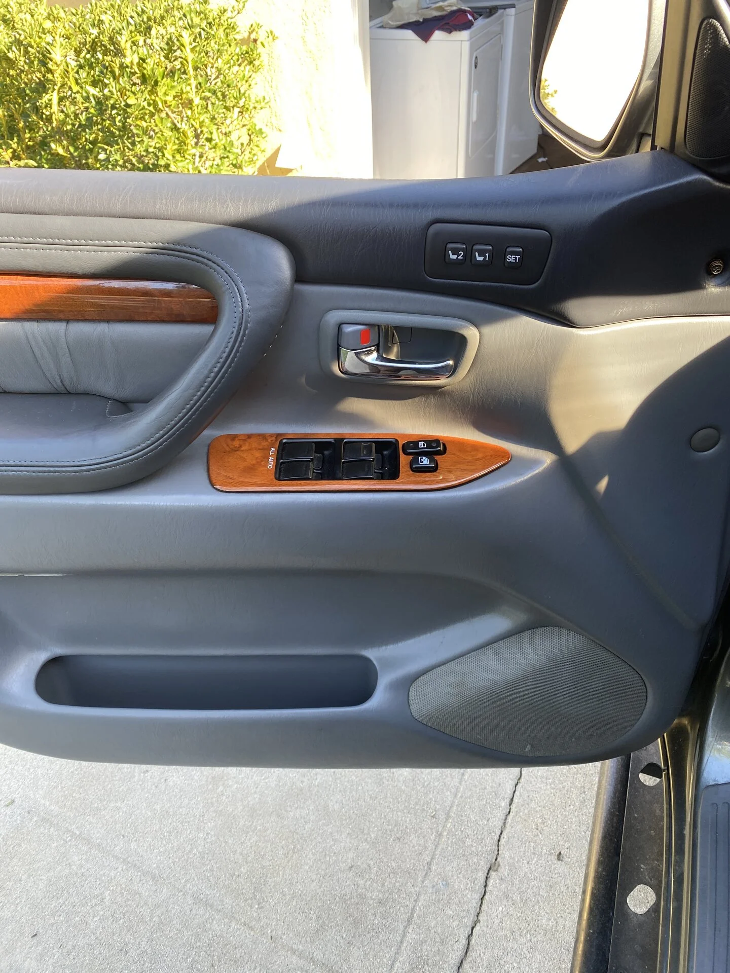

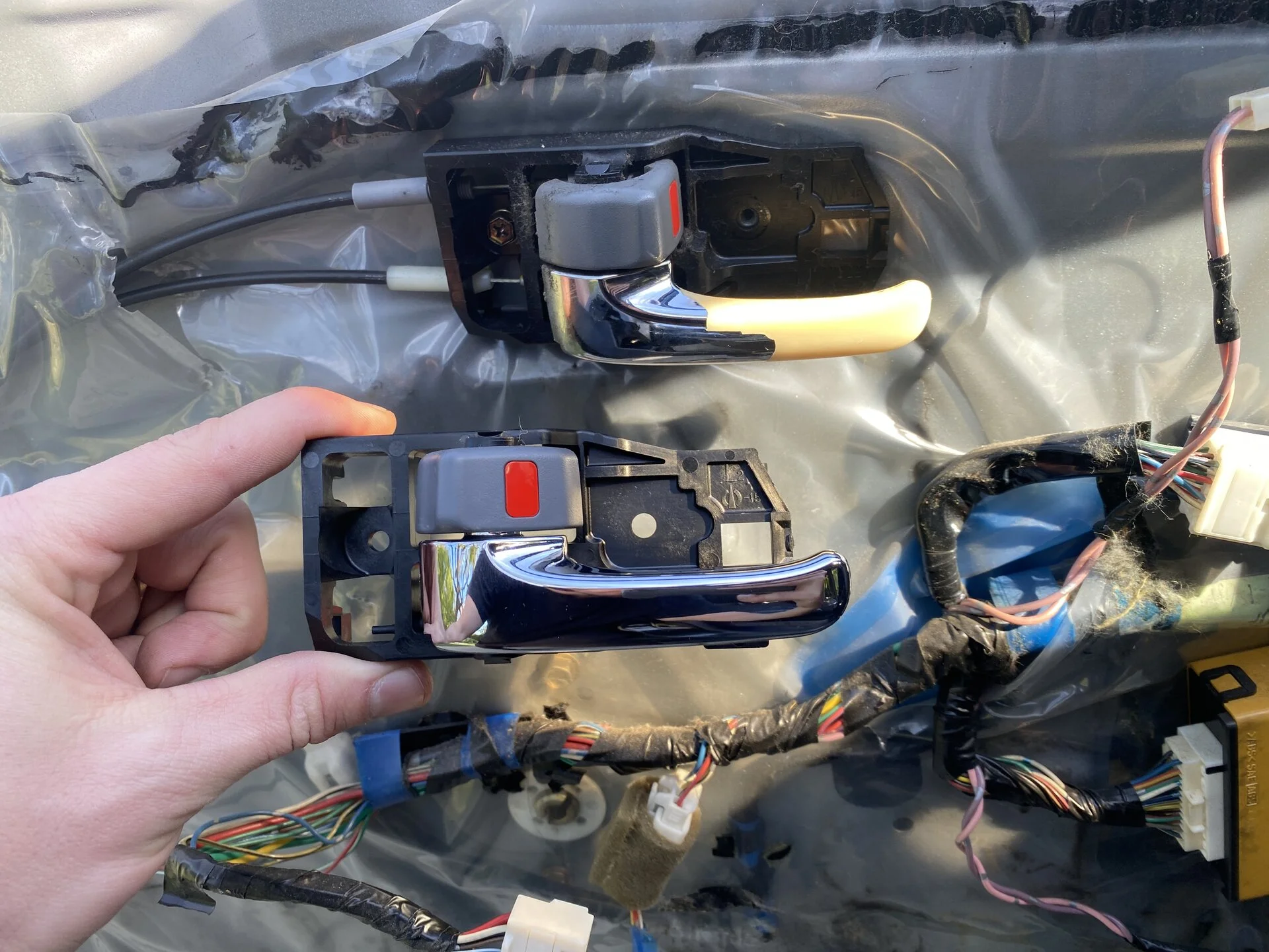

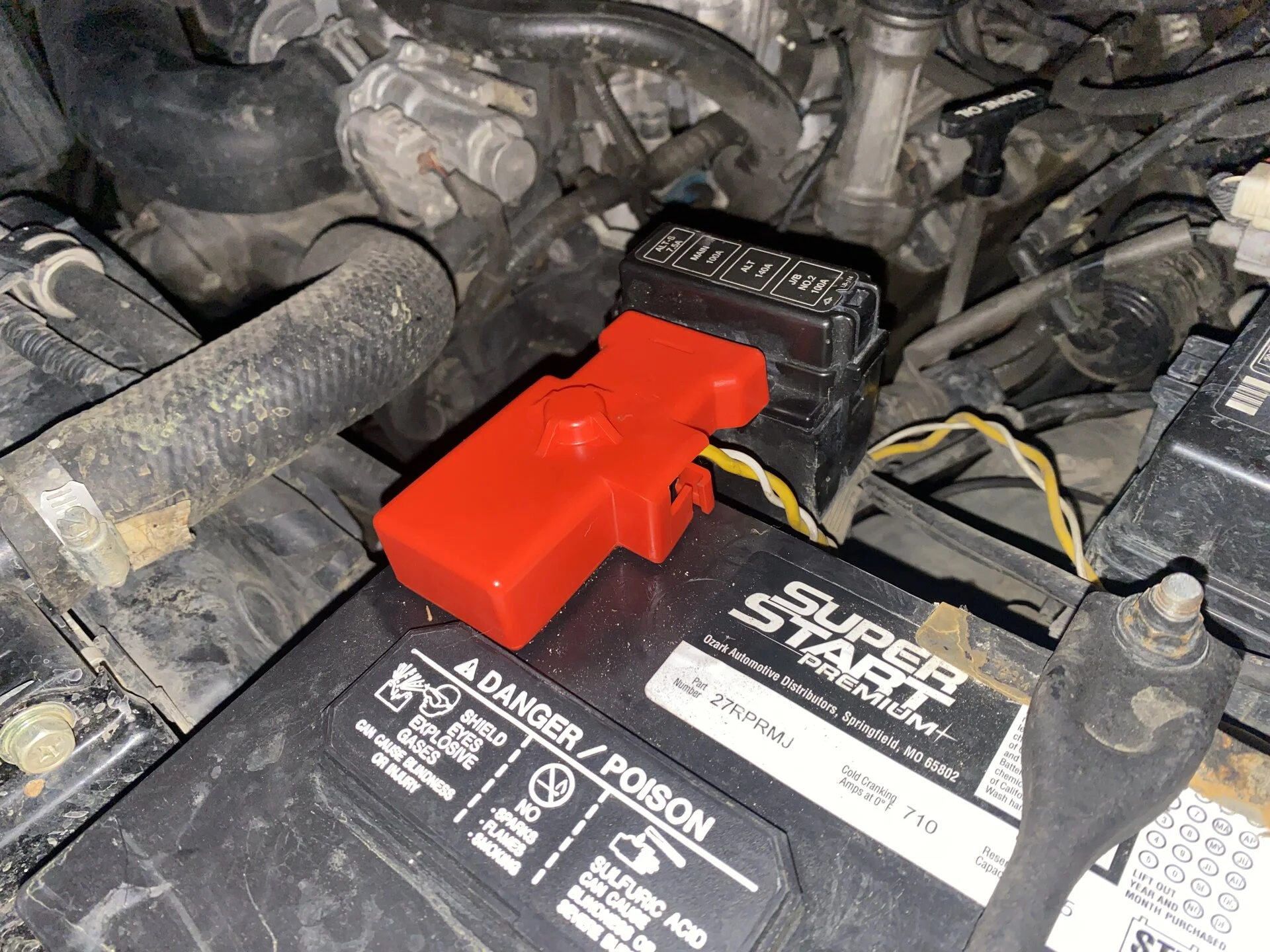

Finally getting a few little things done.
  • OEM positive terminal and cover
  • Inner driver’s side door handle
  • Remove unused suspension system pump and reservoir
