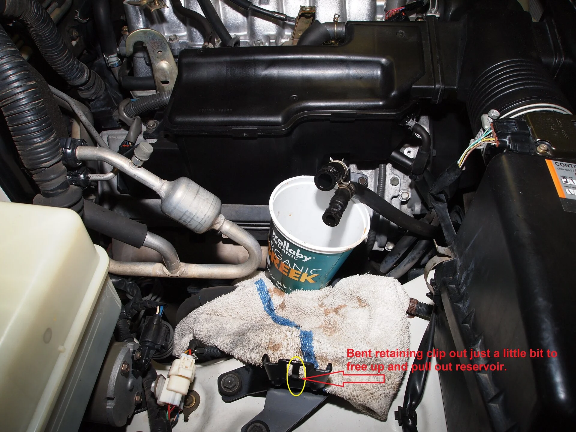

  3. Pull reservoir out of holder. You'll need to release/bend clip outward, on outside of holding bracket.

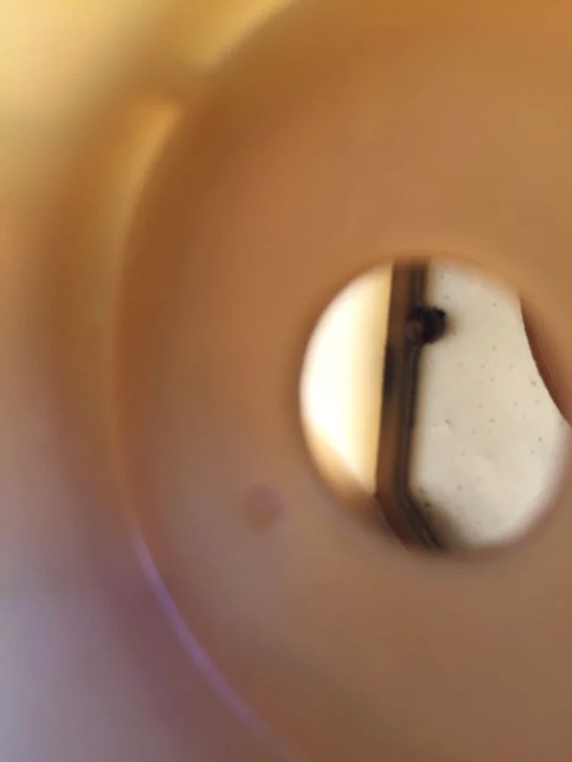

  8. (Skip to step 10, if just flushing). Remove reservoir and clean inside it. Getting screen and bottom cleaned of gunk. I do this once during my first flushing, if reservoir screen & lower chambers clogged. It's thereafter kept clean, by just regularly flushing.

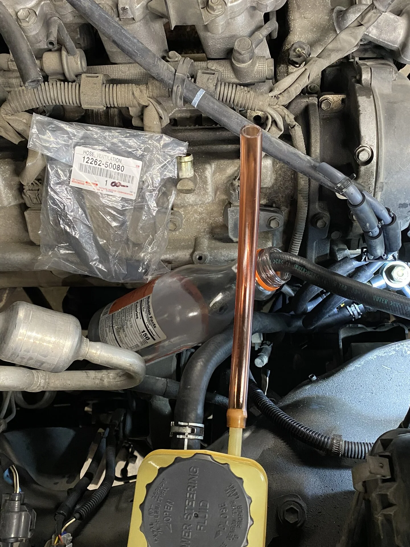

  10. Plug return (smaller) nipple of reservoir. So you can fill reservoir, without fluid running out of return nipple. Keep the return hose, running into to catch can (step 5).
  11. Fill reservoir to near top with ATF (I use Mobil 1 ATF) and replace cap. Takes ~1/2 qt. Tip: If reservoir still has a small amount of old fluid in the bottom. Before adding new fluid, just turn steering wheel to remove that small amount. But note: If you remove to much, you'll suck air into suction hose. Which you can do, but makes bleed air out a longer process.
  12. With return line run into a catch can, front wheels off ground, reservoir full and engine off. Turn steering wheel slowly lock to lock, holding snug at lock (stop) for three seconds or more. Takes a little more than 1 1/2 turns to empty reservoir below return line nipple, so watch close. Don't run reservoir dry. By now you'll be seeing clear translucent red fluid, flowing into catch can. Which means system is completely flushed.
  13. Re-attach return line to reservoir. At this point, fluid should be just below return line nipple of reservoir with some fluid in very bottom of reservoir. Tip 1: By titling reservoir, so nipples are tilted upward. Keeps fluid from running out, as you re-attach return line and place reservoir back in its holder. 2: When all fluid was flush/drained from system to replace components such as rack & pinion. I'll sometimes find, I need let fluid sit in reservoir for a little while, to trickle into vane pump. Then turn steering wheel fast from lock to lock, to get fluid moving at first. This help force in fluid through and push out air. Once fluid flowing (sucking) from reservoir, slow turns from lock to lock and hold at lock.

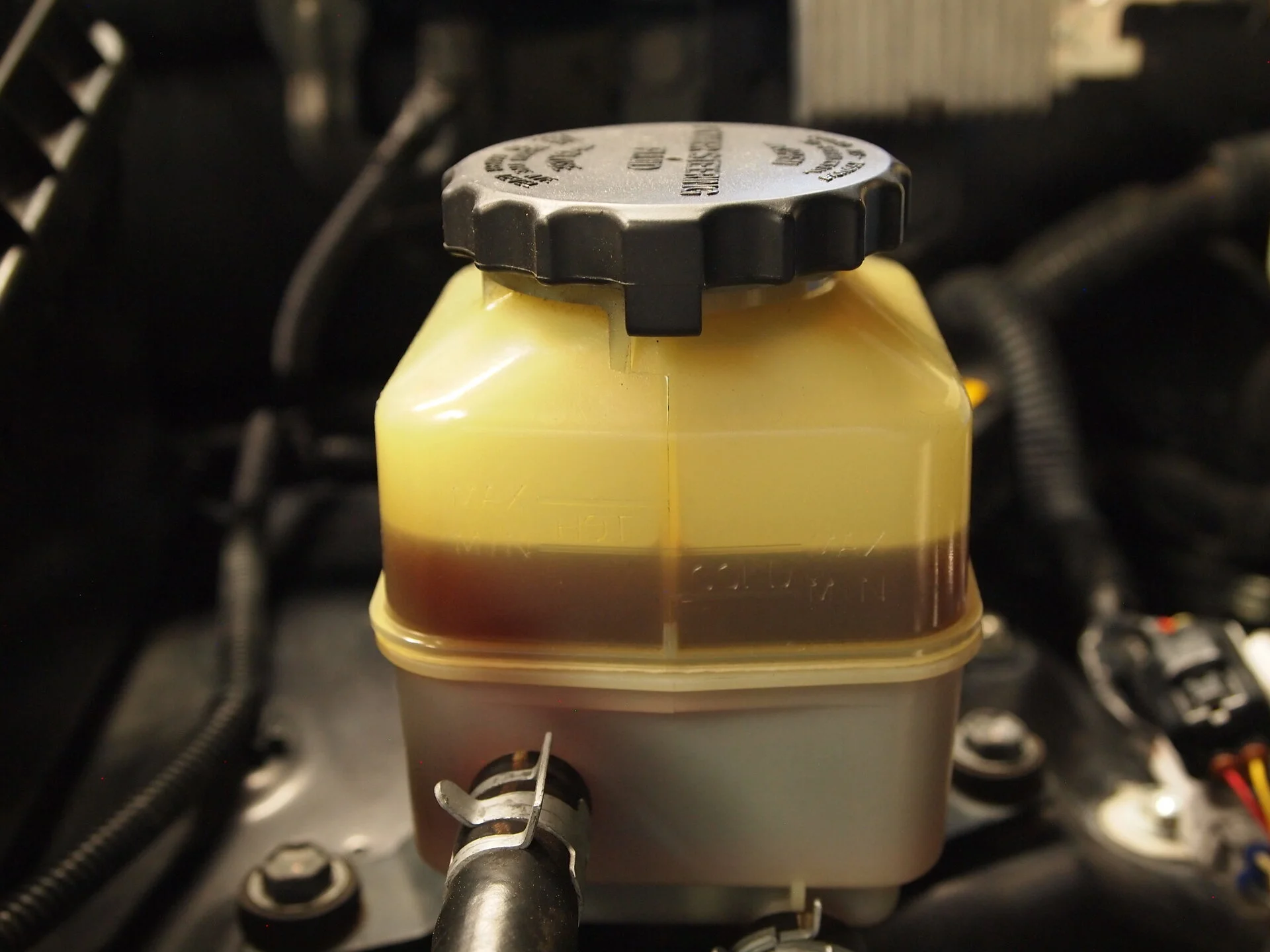

To remove reservoir, I release clamps and reservoir from holder. Then hose will turn freely and I flip over reservoir pouring old fluid out.

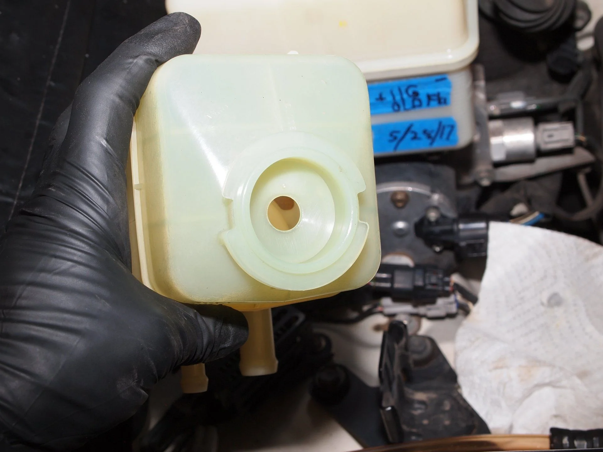

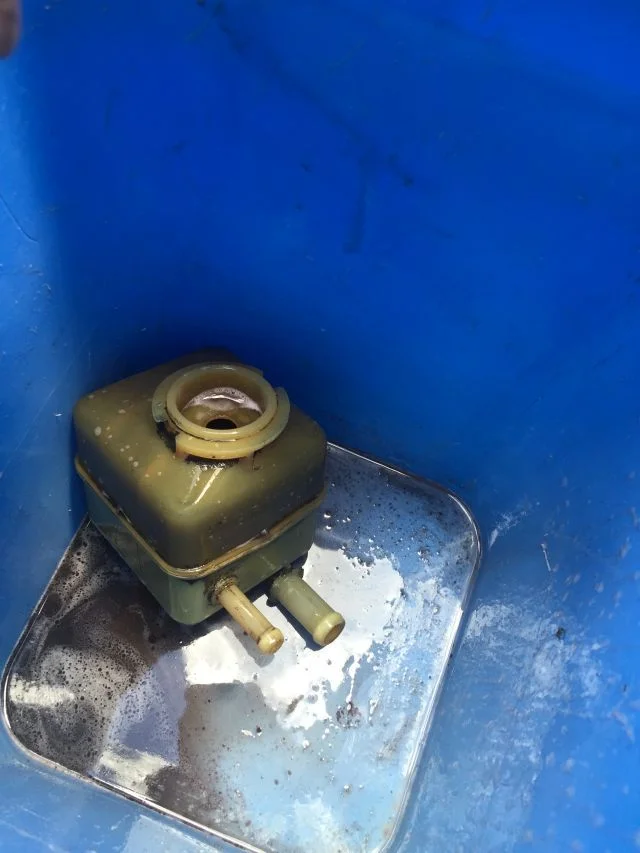

After removing reservoir. I rinse inside of reservoir with a de-greaser. Like dish soap, simple green or whatever degreaser I've around. I then place reservoir into jug (old antifreeze jug I cut top off of), pour in 100% industrial strength Simple Green, and submerging reservoir solution. I let soak overnight, shaking jug now and then. A Sonic cleaner speed up process. Then spray out reservoir with garden hose. I keep re-submerging in Simple Green and spraying inside reservoir with water to rinsing, as many times as it takes to get gunk out of screen and bottom of reservoir. Note: Do not reinstall until completely dry.
Look close, you can see screen inside reservoir. It must be clean.

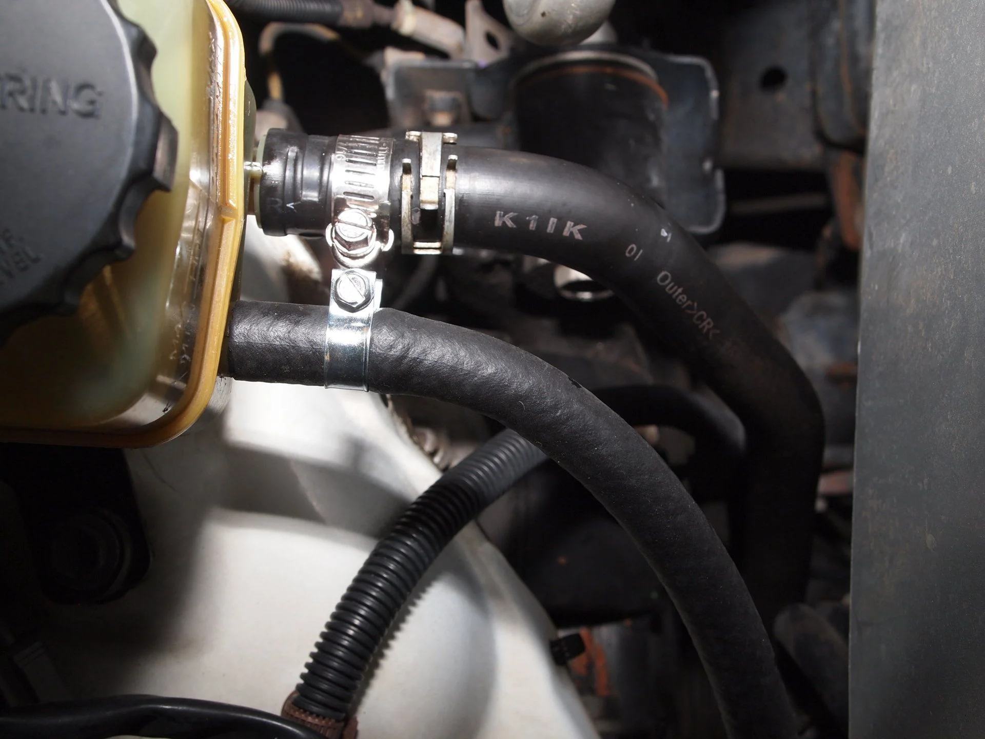

To stop seepage from hoses at reservoir, vane pump or where return line attaches to hard line. Best is to replace hoses, using OEM hoses and clamps. But we can just doctor hoses and clamps as temporary solution. See clamp and hose examples in post #7. Which is temporary IMHO, buts works most of the time. Best, is to replace hose or hoses and use OEM clamps.
If you don't have or can't use, OEM clamps. Then, best clamp is fuel line hose clamps. Worst to use is typical worm gear clamps. They don't give a perfect seal and they cut into hose.

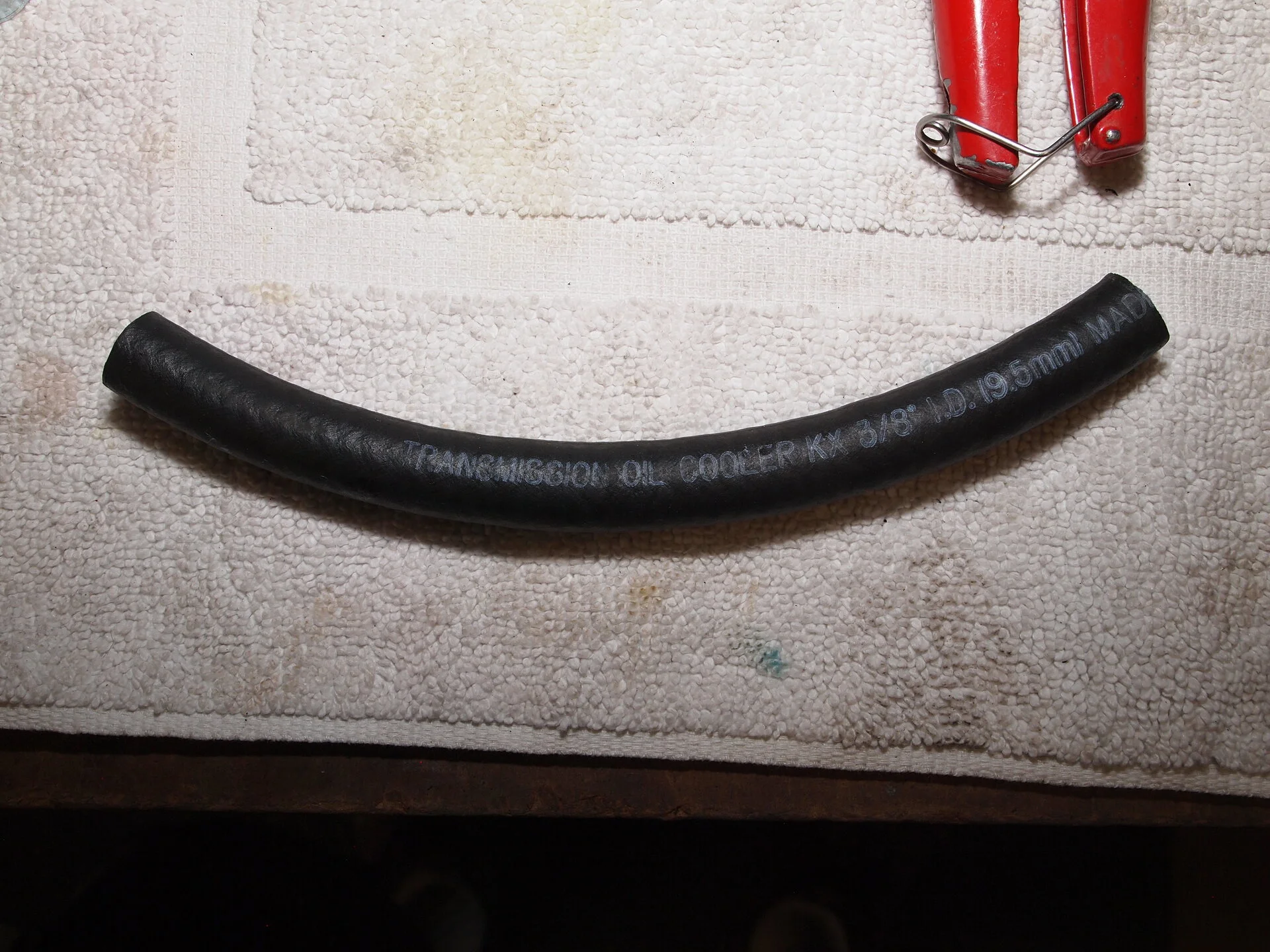

98-02 OEM return line is not available from Toyota separate from the costly HP line assemble. So I use 29" of 3/8"ID transmission cooler line from Advance Auto, which is a very tight fit. The 3/8" cooler line will not come back off easy. Care must be taken when removing factory or aftermarket hoses from reservoir, due to risk of breaking the reservoir male nipple. Basically do not pull hoses off. Just, push/pry off from back end work very well
When temporary clamping old hose(s), to stop weeping rather than replacing hoses. I move factory clamp to just outside the end of male nipple tip (ball at end). Then place new ASS screw or fuel clamp just to inside of male nipple tip seems to work okay. But as stated, Fuel line clamps is best practice for aftermarket hose when OEM clamps won't fit due to some smaller walled (OD) hose. Tighten, but not over tighten.

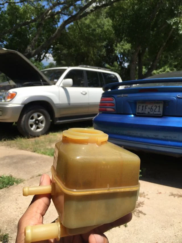

yeah Mine is pretty stained also, i think i will try simple green degreaser since i have some on hand. I have never changed mine. I just changed my water pump timing belt and alternator. Now time to change ps fluid and clean the reservoir as best i can, i will post pics.
Nice job, your screen looks good.
I rinse & soaked in most any de-greaser (purple power, simple green, dish soap, hot soapy water, high pressure water to raise).

Here is some pictures of camps. Note: On 98-02 I use, 29" X 3/8"ID transmission cooler line with fuel line clamp (OEM clamps best when OD large enough). The 03-07, return line is available from Toyota. I've found the OEM clamps work just fine. The only time a double clamp, is temporary, just until I've new hoses(s).
Notice return hose (smaller), has fuel line clamp. The old hard suction hose, is temporarily double clamped. Using typical screw clamp. I do not use the typical screw clamp on good hoses. As they don't give even pressure and they cut into rubber.

3/8" transmission cooler hose.

Bend this retainer out a little, to remove reservoir.

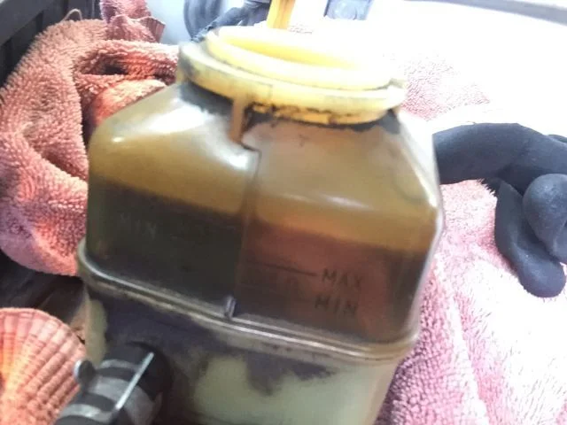

The one (270K miles) I'm working on today has leaky steering rack as well as hose ends at reservoir. It looks as if not flushed ever. Before resealing or replace rack, I'm going to flush and add seal modifier. I'm thiking this will stop leaks and save me some time & money. Mean time I'll replace bushing with poly's to tightens up rack.
Edited: Worked well, leaks stop & pump sounds good!

To stop seepage from hoses at reservoir:
I clamp with 1/2" on top (return) line & 5/8" on bottom line IIRC, all stainless steel (ASS) screw clamps. If to large they're capable of exerting to much pressure, which you'd risk breaking the reservoir male nipple. If to small you'll not get enough pressure to stop seepage. So start small and work up.
Move factory clamp to just outside the end of male nipple tip (ball at end). Put your new ASS screw clamp just to inside of male nipple tip. Tighten, but not to tight. Come back every 50 miles or so, an retighten just a little bit, until seepage stops. By using both old and new clamps, I feel it helps create better seal at nipples tip around the ball at the end where seal is needed.
