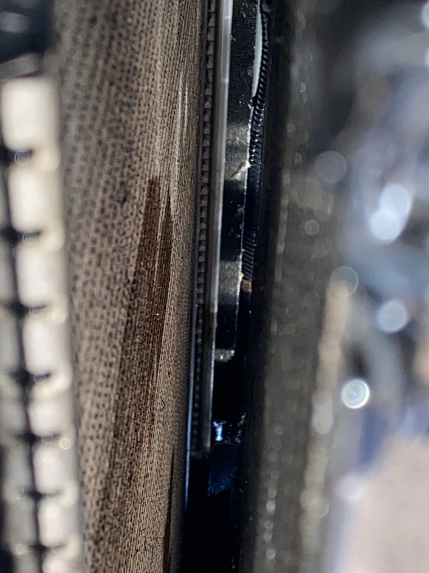

Got me to thinking about the radiators I've been replacing. All have debris built up on lower third.
This one hand some extra grasses along with general clogging on lower third.

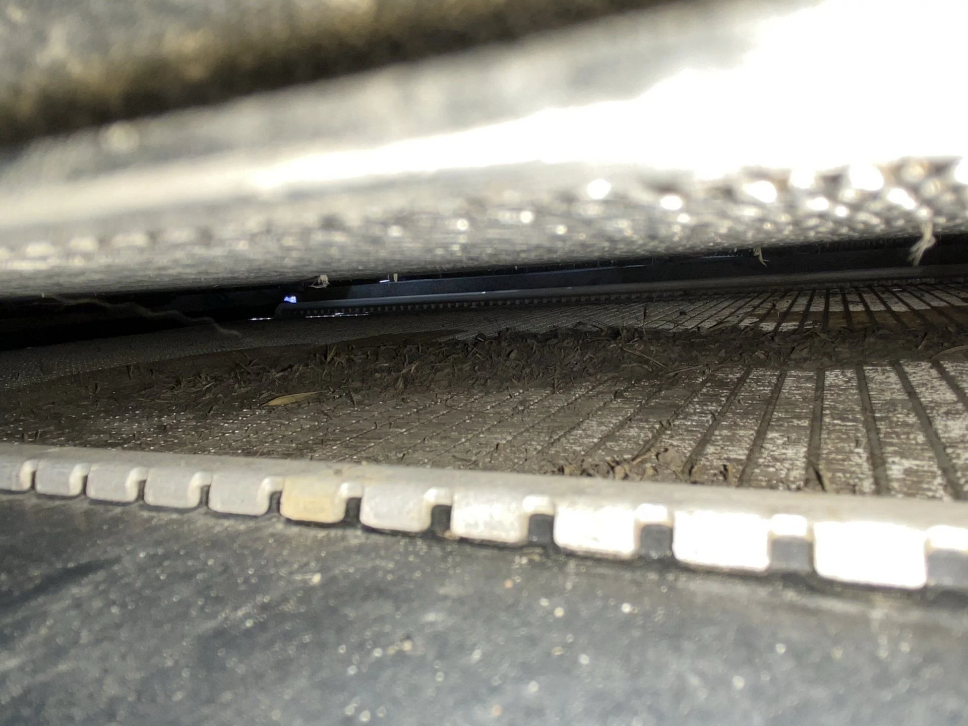

Over the years/miles debit builds up in condenser and radiator fins. Bulk in lower third. It's hard to inspect for this with skid plate on. But with skid off it easily seen between condenser and radiator.

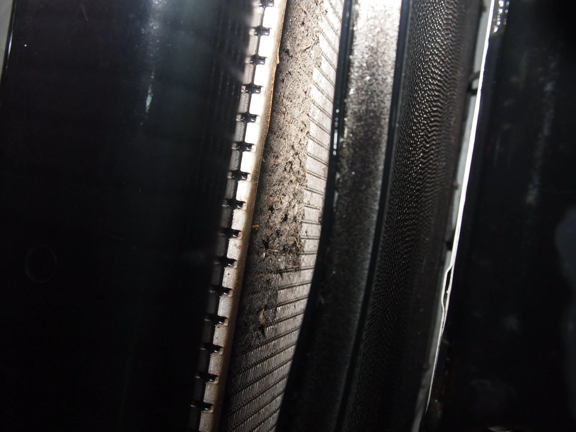

If ever in deep water especially flood water or standing water. Large debit like Styrofoam, grasses, etc. can float into space and become trapped. Any clog will reduce cooling effectiveness of radiator and A/C.
Replacing Radaitor is one way to take care of. But cleaning is so much cheaper and faster. I've added to my list of PM as of today.

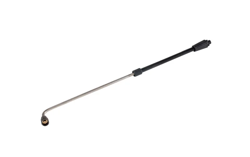

I've attachment with 90 degree for getting inside between fan blades and up under between radiator and condenser, undercarriage and wheel wells. If it had a little smaller head, would be nicer!

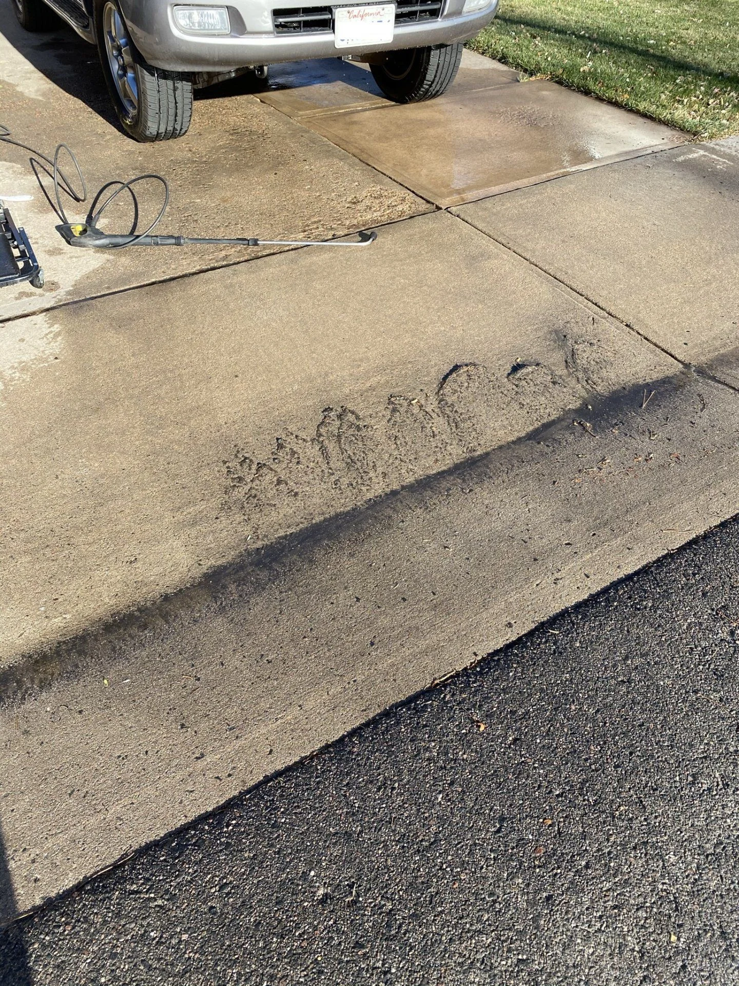

I added a short video to OP in this thread. Of final rise of engine and radiator. I find it take coming back time and time again to get and keep clean. Average first time, over two days, is 3 hours.
