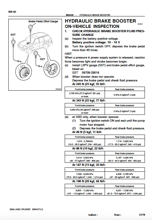

Periodically test booster motor run time. Do this by pumping brake pedal 40 times with IG key off or key out of IG. Than check level in brake master fluid reservoir. Which should be at or near max line but not over. Than turn IG key to ON, and time booster motor run time. 40 seconds is max. 28 second is a very health system (new or newer). 40 seconds is limit, but may indicate some weakness. i.e: low voltage/amp from battery, it likes about 12.5Volts, weak seals, bad fluid, air in fluid, etc. Over 40 second, service is necessary.

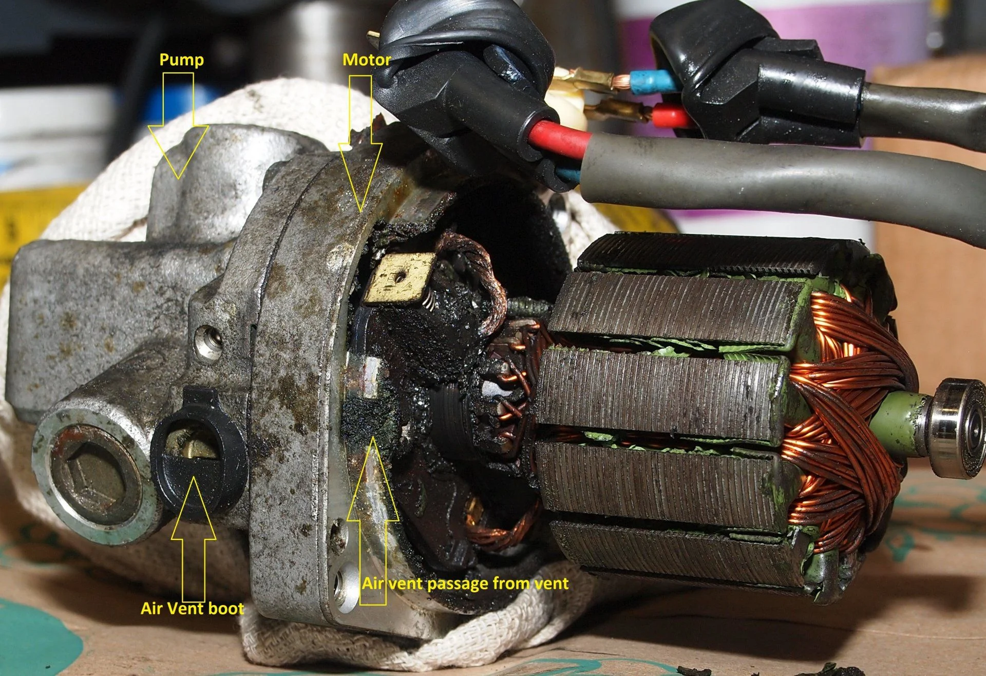

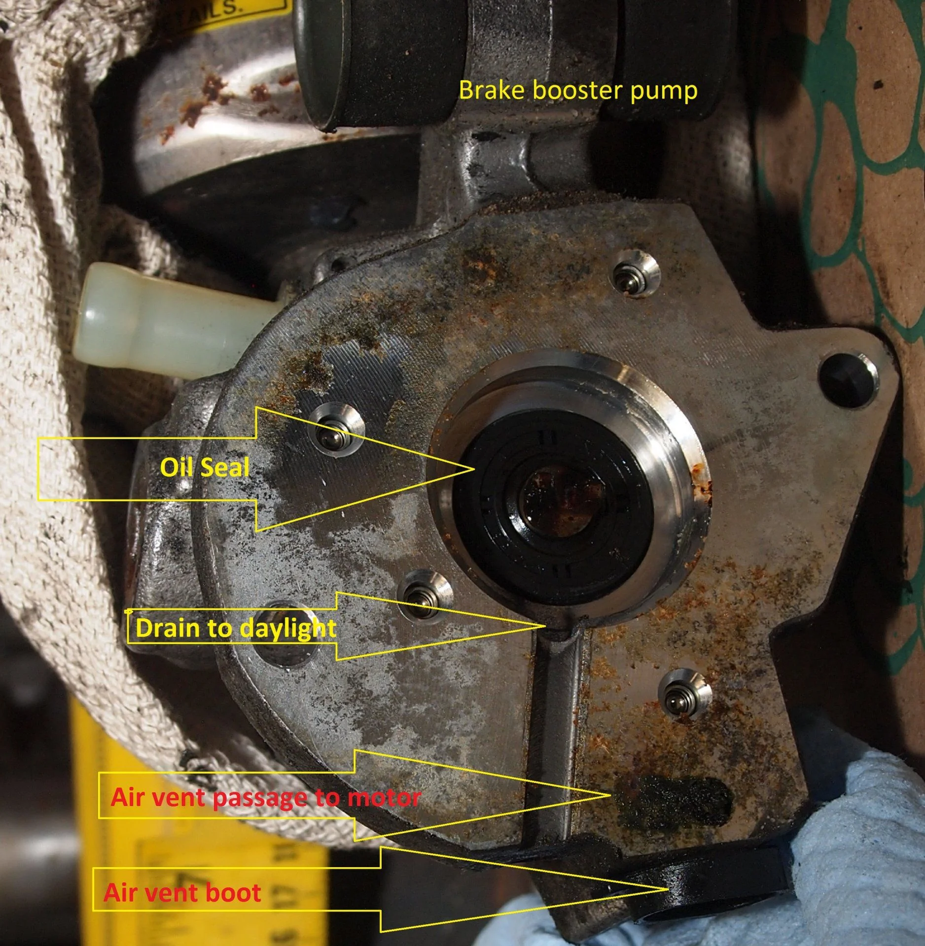

A second cause for brake booster motor failure. Is excessive long run times:
Motor running excessively long, each time it is called (pressure in system low) on to run. This happens most often due to a leak or air in system. Leak is not always external (internal pressure leak). Internal pressure leak, will not cause fluid level to drop. Note: level drops naturally with pad wear. I'll touch on this subject later. But if we hear the screeching sound when motors is running and see bubbles (wake in fluid seen) come up front of reservoir. This is internal pressure loss. The master will need replacing, or pump will run excessively long. Pump is designed for short run time. Running to long each cycle, can overheat the motor. This heat too, cause premature wear of motors commutator and brushes.

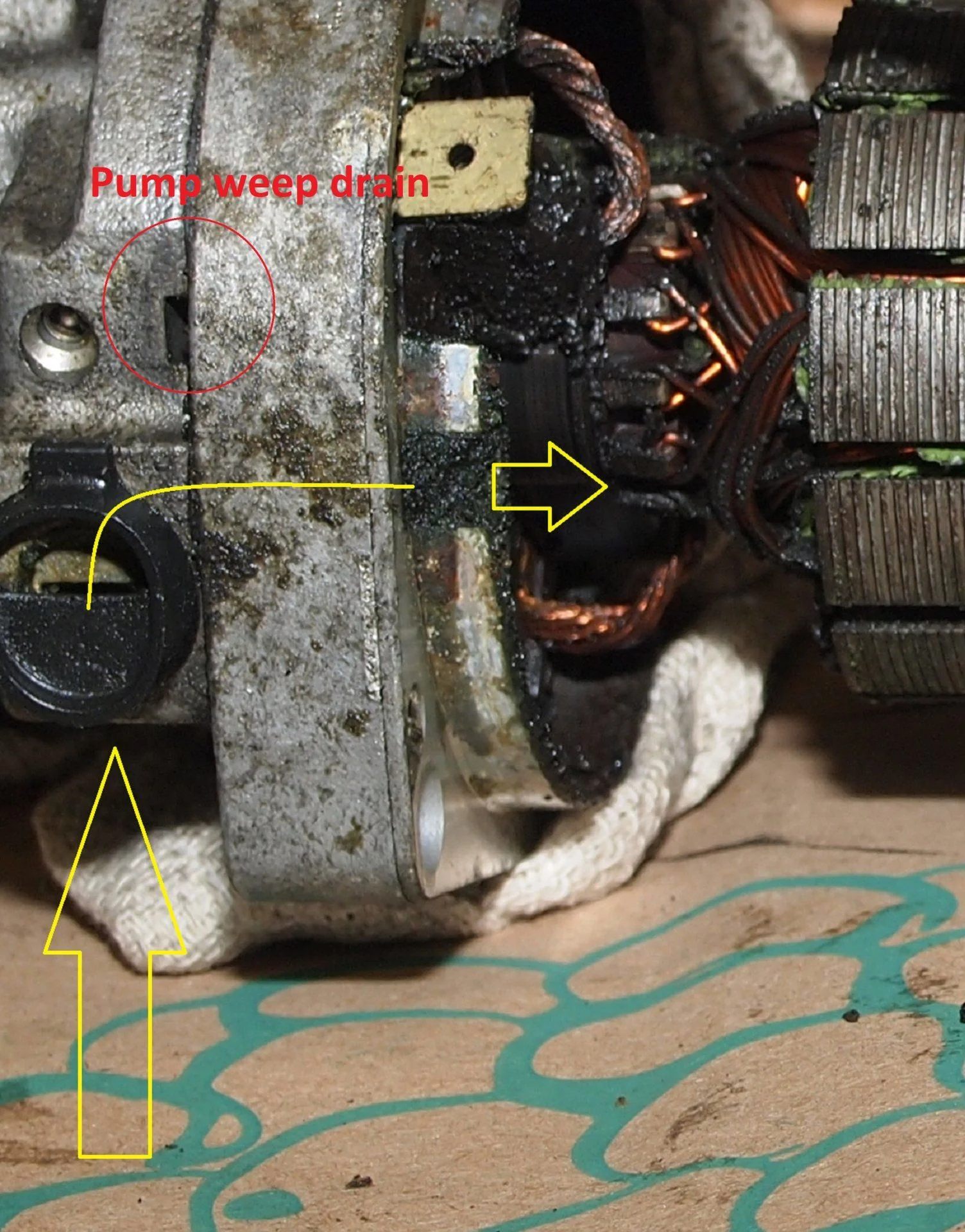

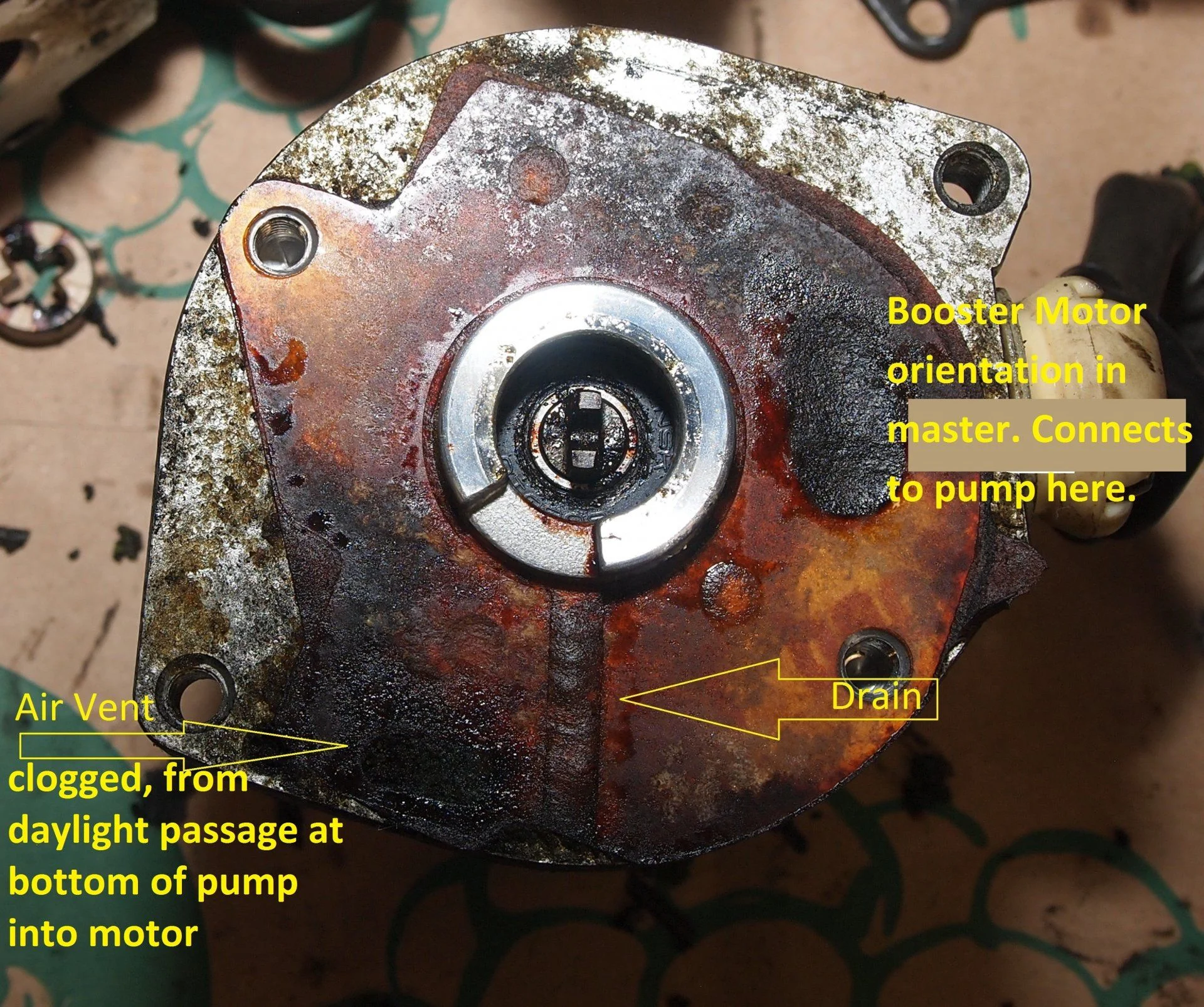

A third cause for motor failure.
Brake fluid, gets in the motor from passive seal in the pump, which is not a pressure seal. This seal is seen, when motor pulled off the pump.
What happens is the motor air vent become clogged. The pump has weep drain canal on face of pump, where motor mounts to it. The pump also has a air vent with boot cover next to the drain canal. This air vent is designed to reduce the vacuum (negative air pressure), built up inside motor, as it spins at high RPM. If the air vent gets clogged, brake fluid is then sucked from passive seal weep area of pump, into motor. The brake fluid then soaks/damages the rubber insulation in the motor. This brake fluid can also damage motor bearings. It "may" also affect resistance within motor, by affecting contact between brushed and commutator and windings.
Pump and motor with clogged vent pictures:
Pump (side motor attaches to)
Motor
Motor & Pump
In most cases, we're best serviced replacing the booster ASSY w/master ( the whole brake master).

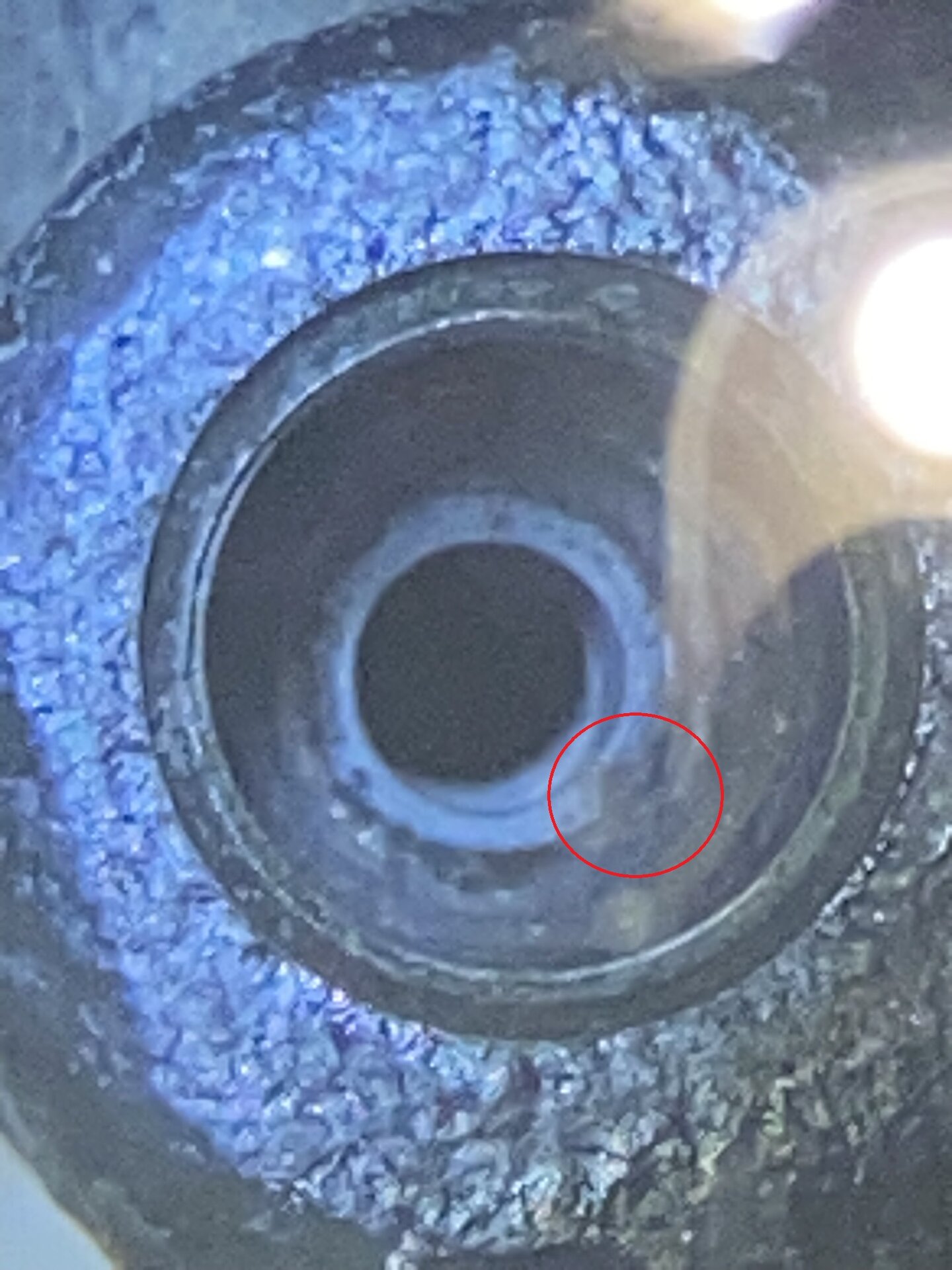

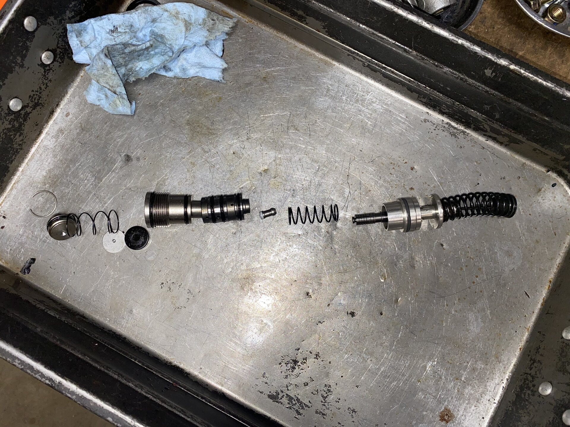

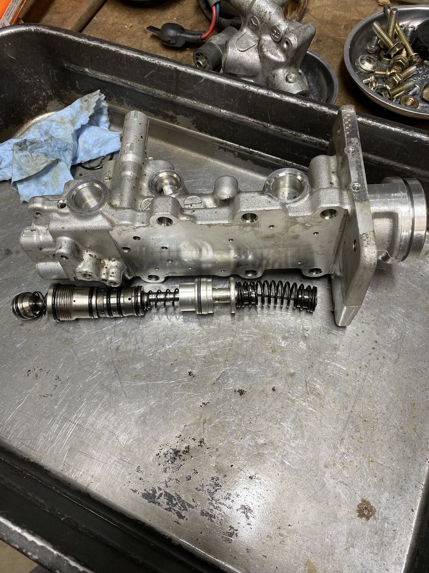

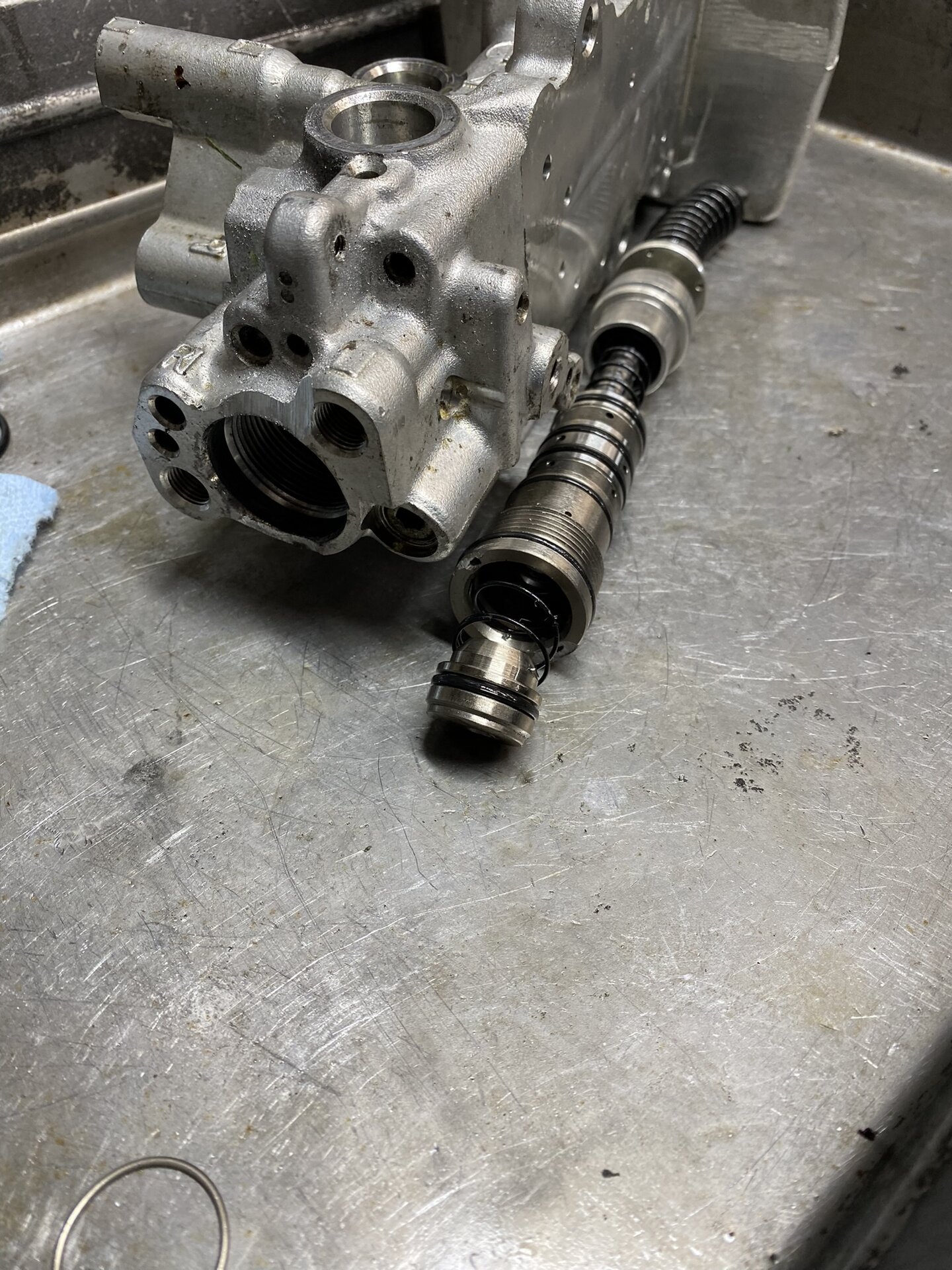

Master replacement only current cure, If screeching sound with bubbles!
The screeching sound with bubbles (wake seen in reservoir fluid) coming up front of reservoir. IMHO is a sign, that a seal in forward point of master cylinder is past useful life. The seal, can no longer handle the higher pressure developed by booster assembly (motor, pump & accumulator), coming up to near factory peak pressure. So brake fluid under pressure, leaks past this seal. This produces the screeching sound. Wake in reservoir is the fluid escaping past seal into reservoir, from back (forward of vehicle) master cylinder. This seal, currently, we've no way to replace it.
At first, the screech sound, is only for short burst and mostly when cold. As day warms or brakes used, heat expansion takes place. Then leak and associated sound stops. Same happens with caliper seals, during braking. But without the screech sound. With these caliper piston seal damage, we may get a brake alarm, that goes away when seals warmed up. Brake fluid itself, gets very hot with use. So either use or hot days will increase size of seal (heat expansion). Then when cold we get shrinkage. So issues come and goes with cold and heat.
Over time these seals with fail. They'll not hold even a minimum pressure, even when hot. We still have brakes (weak) as long as we build enough pressure. But the booster motor runs excessively for longer duration. Which longer duration, results in motor premature failure.
Why some brake master seals fail, yet others do not.
It has to do with brake fluid condition. Proper flushing is so important a PM.
Seal failure: "May" also have to do with brake fluid brand!
Note:
Bubbles are not accurate or great word to use. "Wake" in reservoir fluid is probably better. IMHO this is a rapid release of fluid under very high pressure, into reservoir.
Most will not even hear the early shot burst screeching. Why, background sounds! Like chimes, Radio, Cabin fans. I, make sure all electricals are shut down, before I turn key off when parkin. OM does suggest this. I turn on IG key and wait for all sound (chimes & booster pump) to stop, then I start.

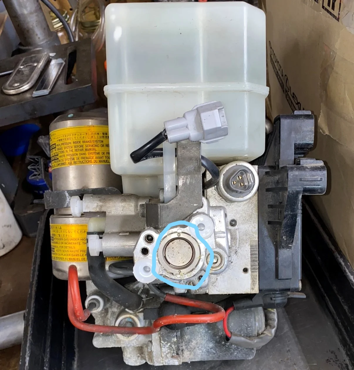

Here are the seals that IMHO are failing. Toyota does not sell, nor are they designed to be R&R.

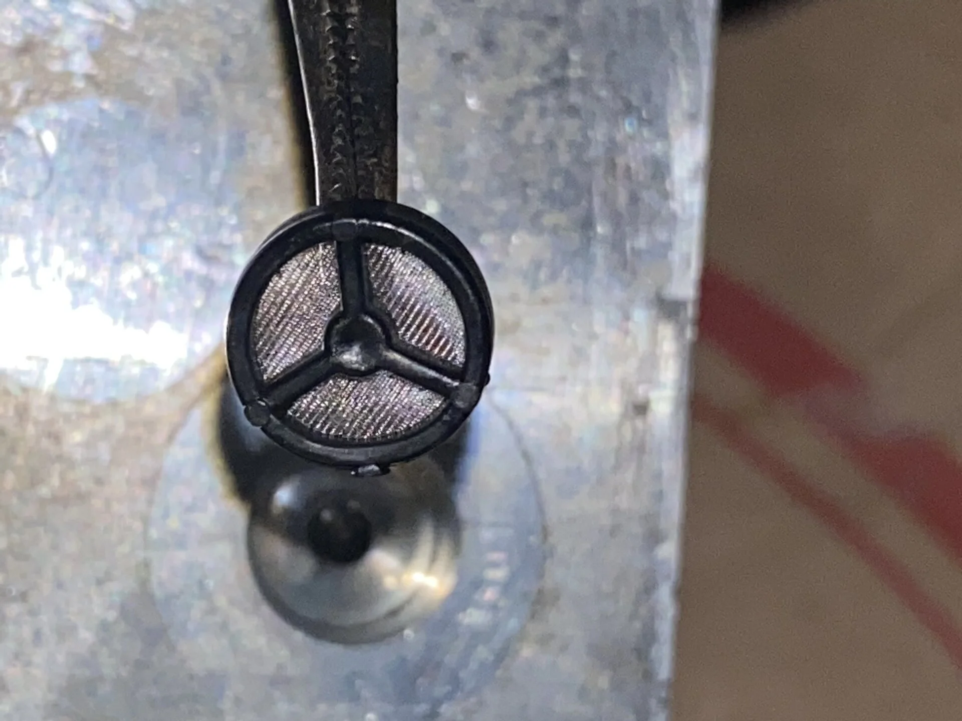

Here's some buildup in the ABS screens. In which some valve(s) withing ABS malfunctioned. Which resulted in one rear caliper braking (locking up) freezing on.
Here is an ABS units clogged screen.

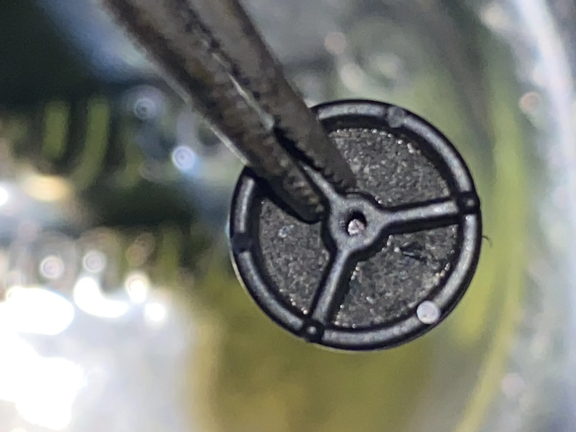

Here is a clean screen

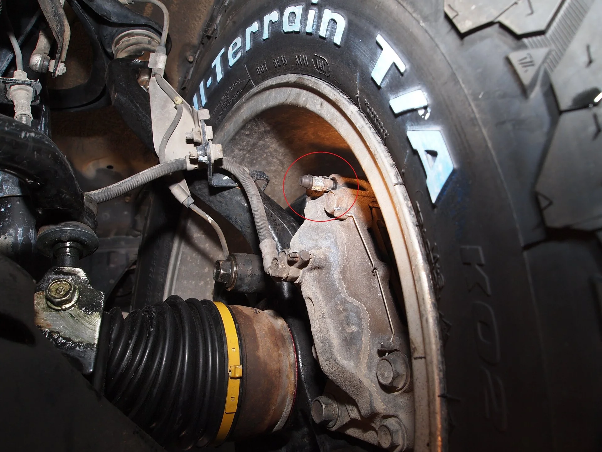

Brake bleeder rubber caps.
A small inexpensive part. Missing or damaged can result in frozen bleeders. Which then we can not flush, unless bleeder removed. Which will 98% of the time, damage the caliper bleeder seat.
What happens more so in rear calipers. Is the bleeders retain water and rust. This rust works it's way into the bleeders seat of/in the caliper. Which often results leak at bleeders once removed , even when new bleeder installed. 98% of the time, we then must replace the caliper.
Rust damaged seat of bleeder in caliper:

3) Timing booster motor run time (with battery putting out 12.7 Volts minimum) can be revealing.

IMHO most of these brake failures are preventable, in the relative shorter term.
It's difficult to define short term. As brake usage in a perfectly health brake system, is so varied. As some are constantly on brake pedal ever few feet (stop and go traffic). Whereas others may go ~200 or more miles without touching pedal on regular basis (HWY vehicle). The 1 million mile Toyota had no brake issues reported IIRC.
It is sudden zero pressure in brake master and lines, that yields pedal to the floor (relatively no usable brakes). This happens from lose of fluid or brake booster pump motor failure.
Eventually all brake booster motor will fail. It's the motor failing to start that yields zero pedal more than anything else I've seen. As the motor turns the pump, pressurizing the accumulator.
A few tips:
First, never ignore brake warning lights or alarms.
Second, after vehicle has sat for a few hours (pressure bleeds down over time, the older the system the faster it bleeds down) or more. Turn IG key to ON, than wait and listen before starting engine. You'll hear brake booster motor run for up to 40 seconds. Not hearing or hearing run time longer is a warning. If not heard, press brake pedal a few times, it should than be heard. If motor does take all of 40 second run time before stopping, that should be investigated but is considered okay to drive.
Periodically test booster motor run time. Do this by pumping brake pedal 40 times with IG key off or key out of IG. Than turn IG key to ON, and time booster motor run time. 40 seconds is max. 28 second is a very health system with new master assy, good fluid and caliper pistons and seals. 40 seconds is limit, but may indicate some weakness. i.e low voltage/amp, weak seals, bad fluid, etc. Over 40 second and service is necessary.
Prevent measures.
  1. Flush brake fluid often. No longer time period between flushes than 3 years, after first factory fluid flushed out.
  2. I've gone back to using only Toyota brake fluid. It's pricey and may not make any difference, as Toyota no-longer states on bottle who makes. But the extra cost for piece of mind, for what is stated on the bottle "engineered to Toyota spec" may help protect internal seal. If seal weep/leak under pressure, motor will run excessively.
  3. Inspect motor run time and listen for excessive running of motor.
  4. Never overfill brake fluid reservoir. Fluid may escape from cap or grommets at bottom. If fluid get on booster motor brake control wires, it may enter boots protecting wires at connection points. The ensuing corrosion from hygroscopic action, will increase resistance of brake control wires. This will hasten motors failure, very rapidly. Brake fluid may also get into breather port for motor. The moisture will attack dust. This may clog breather and then as motor creates a vacuum (high RPM spin) it will suck fluid from pump into motor.
  5. Inspect breather at bottom of booster motor annually. Deep water crossings, driving in tall grasses, muck, very dusty condition, missing fender or undercarriage shielding, lifted increase open area in fender to engine bay, oversize tires, etc. May all add to debris entering engine compartment. Be on the watch and check breather more often under these or extreme driving condition. Or ensuing fluid sucked into motor will damage brake booster motor.
  6. Keep battery, battery post and clamps properly serviced. Volt/Amp drop from battery, will be the same as increased resistance in wires. This will effects RPM (slowing) and life of all motors. The brake booster motor and fuel pump motor of the most concern.
  7. Keep grounds to frame, body and engine properly serviced.
Hope this helps. Be safe!
I'd not replace brake master assy. Unless I've a reason to do so.
First being no brakes. Which only happens if no pressure in system.
  1. Failure of booster motor to run.
  2. No fluid in master.
  3. Booster motor running excessively long, with squeal sound and bubble seen in front of reservoir. Master seal failure.
  4. Leak seen between master & ABS unit (black box on side of master). Leak just gets worst and alarms will ensue; motor will burn up.
Otherwise, I grade them, on a scale of 1 to 10. 10 is new:
  1. Brake control wire screws/leads corrosion/rust. Heavily -3, medium -2, light -1.
  2. Reservoir staining. Heavily -3, medium -2, light -1. Note: If fluid looks good and no staining. I'd consider just replacing booster side, if clues warrant it.
  3. Condition of fluid, without staining. Very dark -2, Dark -1, Clear 0.
  4. Pumps of pedal with resistance, until accumulator evacuated. 40 -3, 35 -2, 30 -1, 25 -0. Note: If no staining and fluid good. Above 35 pumps. I'd consider just replacing booster side (accumulator), if clues warrant it.
  5. Time to charge accumulator, w/12.5V minimum, fresh Toyota brake fluid and system properly bled, no leak. Over; 40 seconds -3, 36 -2, 34 -1, 30 -0. Note: If no staining and fluid good. Above 38 pumps. I'd consider just replacing booster side.
  6. Age. 25 yr -2, 15 -1, 9 -0.9, 8 -0.8, 7 -0.7 and so on.
Things to consider when thinking about replacing, just a component.
  • If we replace any part of booster side. This results, in additional pressure in master system. We very often see, within two years. One or more, none replaceable seal(s) fail, within master or ABS unit. We then must R&R master. This result in added labor.
  • If buying new Toyota parts. All components' that make up the whole, bought separately. Cost more than the whole.
  • Availability. Today there is one of our masters out of production. It's the 2000, with type A pressure sensor. So, we can't buy from Toyota. I've found and bought the last one, "known" to be in a Toyota warehouse or Dealerships globally. Toyota shows it, as out of production. One day, all will go out of production. IMHO: Not likely anytime soon on the 01-07. We may get down to just one P/N, which today there are ~3 for 01-07.

Before you spend money on parts & labor; have the booster pressure tested ( by someone capable and honest) In the FSM (service manual) in the Brake section (BR) (BR-40 in the 04 manual) Is the beginning page of testing procedure.
