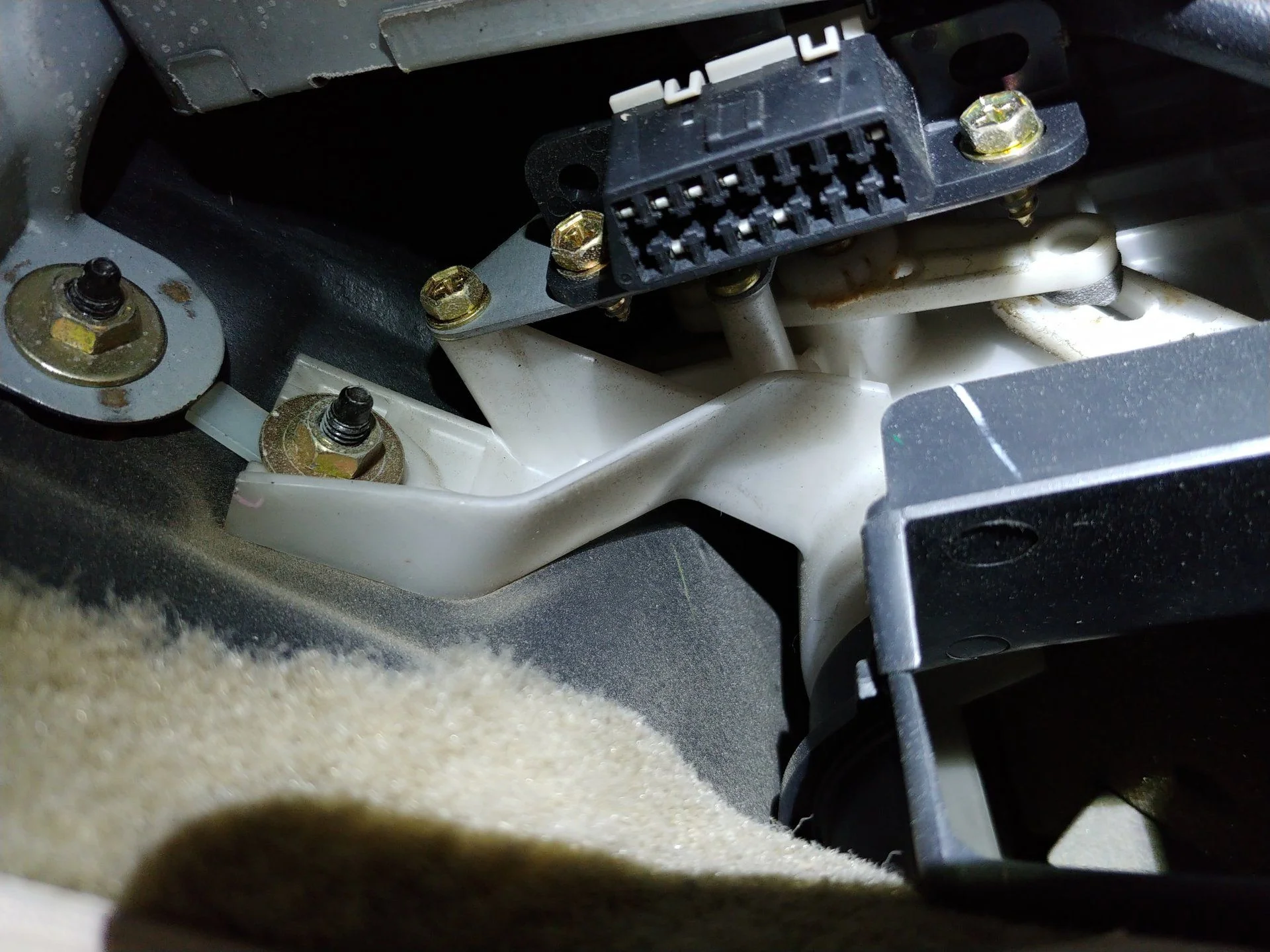

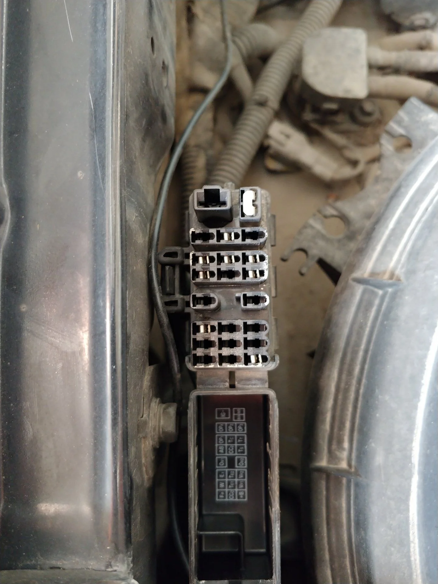

Can anyone please tell me what is this connector in the driver's foot well:
It looks like OBD, but I am asking because I have a connector under the bonnet and it says DIAG or something on the cover.
Could it be that the plug in engine bay is for some modules, while the one under the steering wheel is for others?
Drivers footwell is the OBDII port. One in the engine bay is a different diagnostics port, NOT OBDII. Techstream cable is plugged in the footwell.
Thank you!
