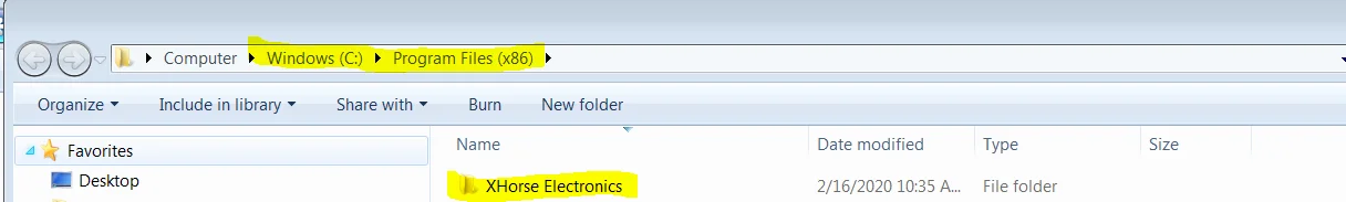

This weekend I had problems when I attempted to reinstall the product on a different machine. It turns out that my distribution CD from Amazon was missing the XHorse driver directory. There should be an installation step to copy XHorse Electronics to c:\Program Files (x86). Once I copied the XHorse drivers it started working.

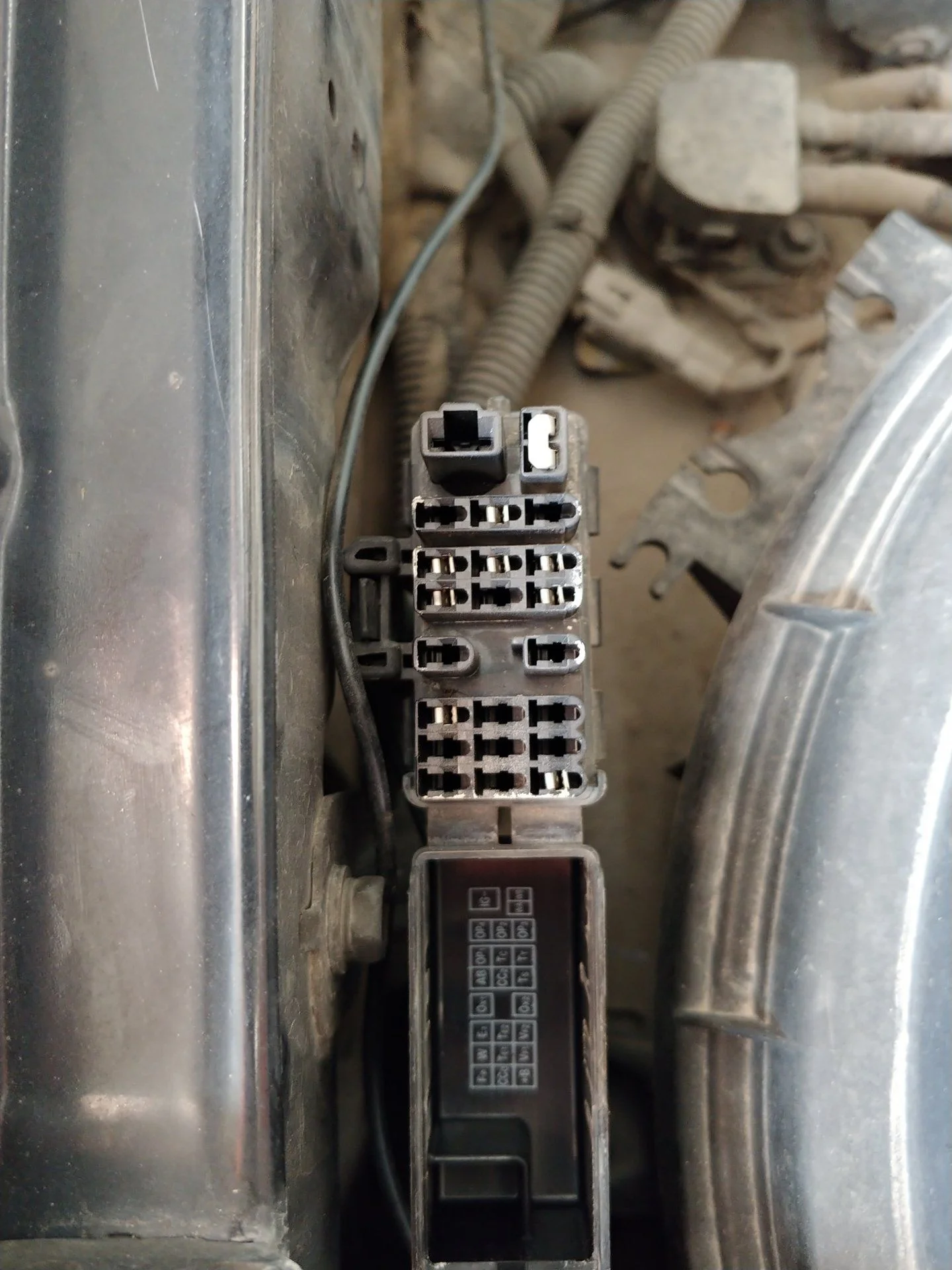

Surely this is not OBDII on my car.
Can anyone please let me know how to identify the name of this connector so I order it on Amazon or Aliexpress?
sorry, i don't really understand (i'm from France !!)
