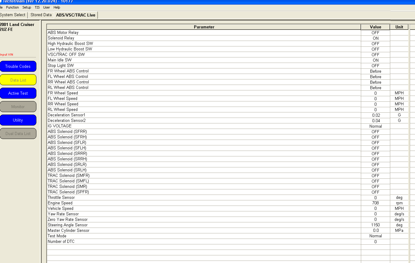

alright so i have been chasing this down for a while, and its kind of driving me nuts. The car drives great, and is very smooth except for small bumps, like if you are offroading over small bumps (graded roads) it feels like it will rattle your teeth out, doing the same roads in a different vehicle, it does not do that and the small bumps are absorbed by the suspension.
I got my AHC to middle of the road spec in terms of pressures, globes are good, good graduations etc.
I then learned about the steering angle sensor locking up some solenoid in the suspension to help with vehicle stability etc (vsc). When the turn the car on it reads 1150, but once i go above like 25mph it starts to read, and it reads correctly.
there is an item in the VSC section of the datalist that says "solenoid relay" and it basically always says on, i am unsure if maybe this is the solenoid that makes the suspension a rough ride or not, any help would be appreciated. It does stay on, did the "active test" that lets you turn it off, it goes off for a second, then back on.
I am almost thinking that maybe this is just the way the suspension is since i have bigger, heavier tires (~33" nitto terra grappler g2's @44psi)

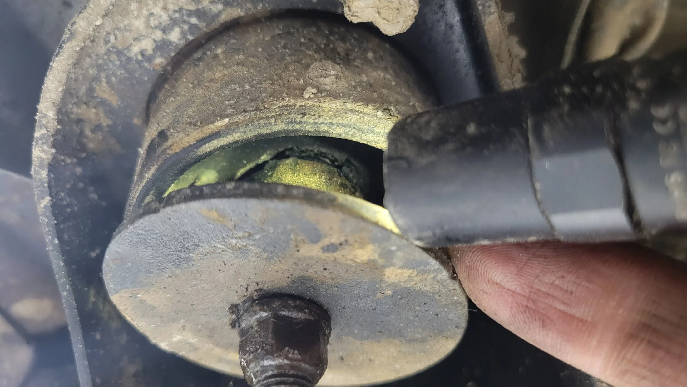

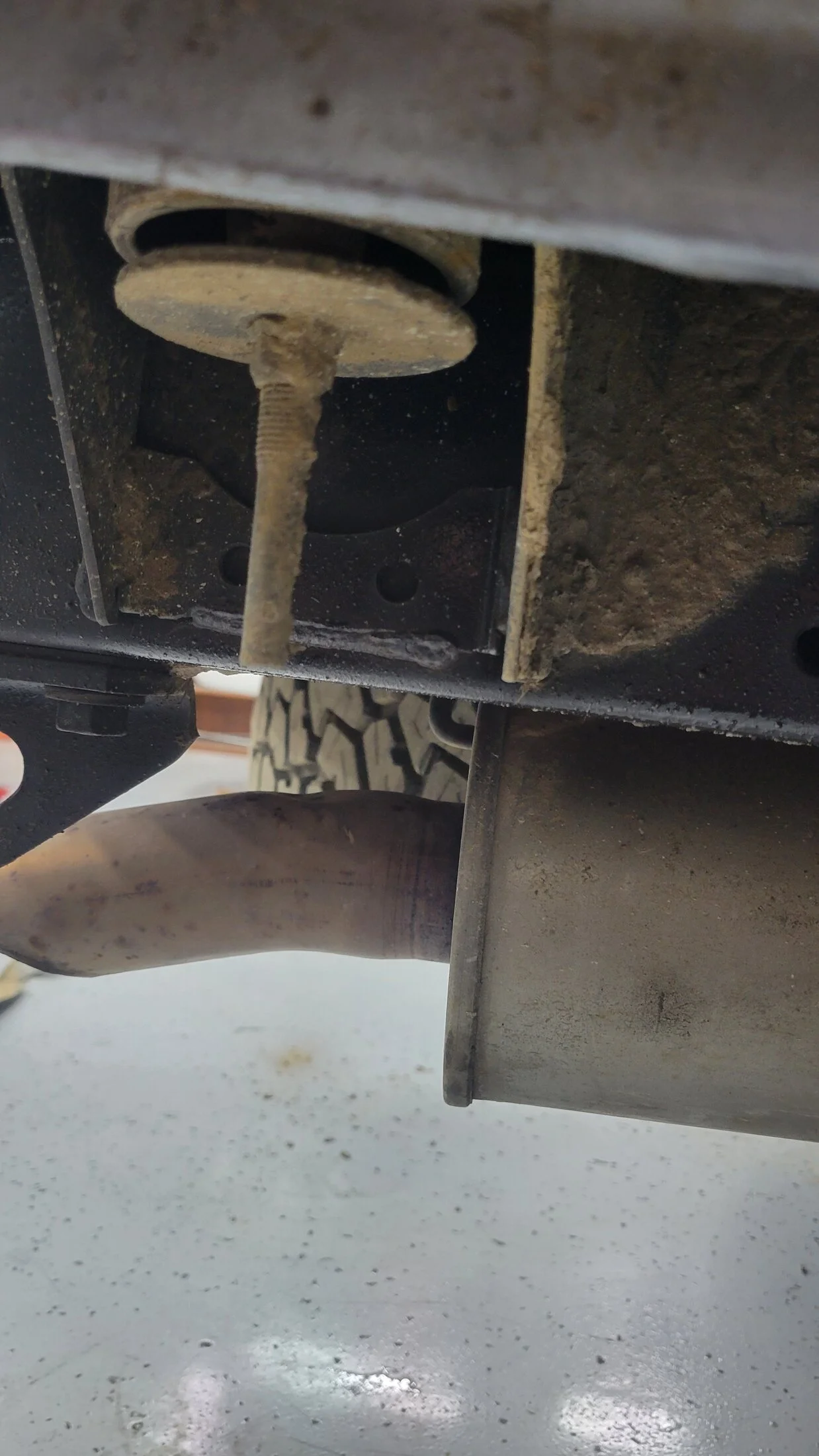

I have a very similar issue. How do you body mounts look? Here's mine... Going to replace these when I get the truck back from getting a custom rear bumper built for it:
ALL other bushings in this LX are new OEM. New globes, new fluid, correct pressures. Body mounts are off center (first photo) and visible/severe cracking (second photo).
I have a very similar issue. How do you body mounts look? Here's mine... Going to replace these when I get the truck back from getting a custom rear bumper built for it: View attachment 3889015View attachment 3889016
didnt think about body mounts, interesting thought, was also thinking maybe it could be because i run nitto terra grapplers and i think they are LT, i noticed my neighbors max psi on his tires (american 35") are only like 35 psi max while mine are 80psi max, wonder if the stiffer sidewall is what im dealing with?
