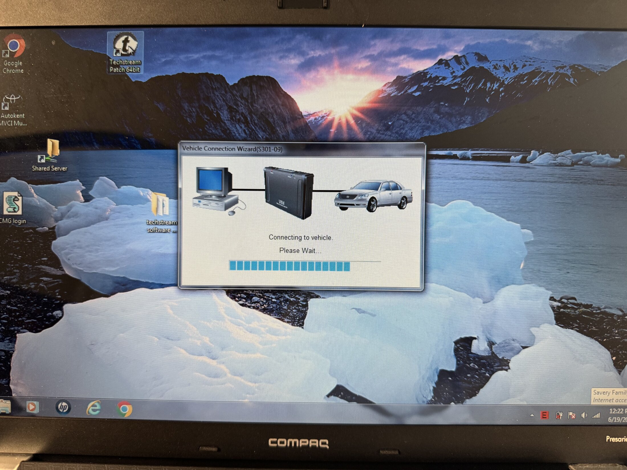

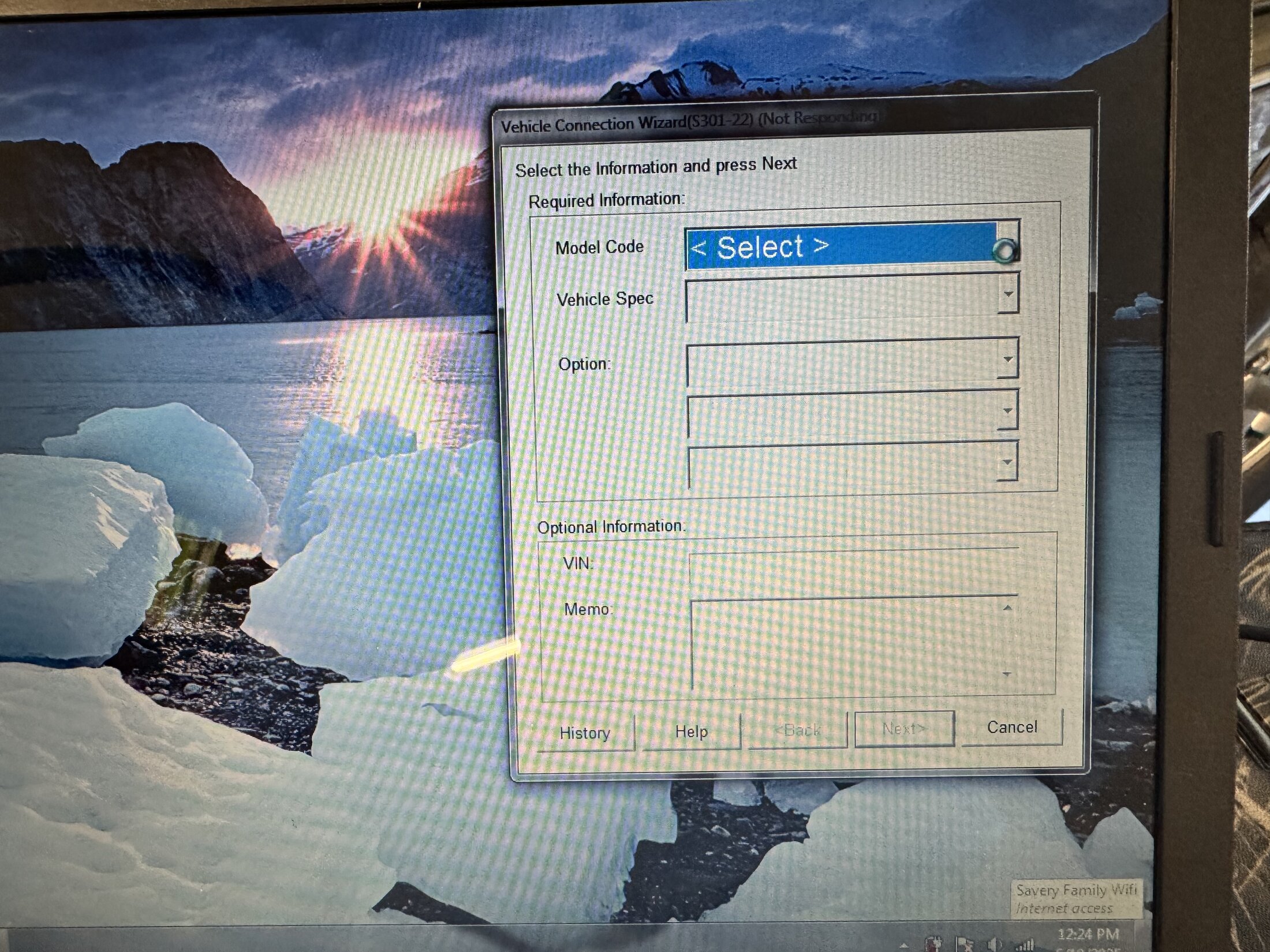

I am running Techstream on a 64 bit windows 7 laptop. I have installed all of the software successfully and have been able to get my 2001 LX470 to connect by using the 65 bit driver. However, when I get to the menu to select the vehicle model code, the screen gets locked and then flashed the choices momentarily and shuts down. Any ideas on what may a cure might be?
Turn Off Wifi and try again. 65 bit driver?
Good to know. The Techstream process has been a little frustrating. I have tried a 32 bit windows 7 machine, a 64 bit windows 7, a newer Intel Mac, 2 cords and this is the closest I have been to making it work. If I can just troubleshoot this last challenge I think it will work but I am out of ideas

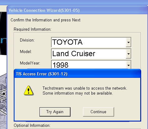

TS also gives this message when I type in the VIN. Not sure if its supposed to "connect" since old version and all.

Error message is due to not being connected to internet which is correct for this application so you’ll see that everytime you run health check
