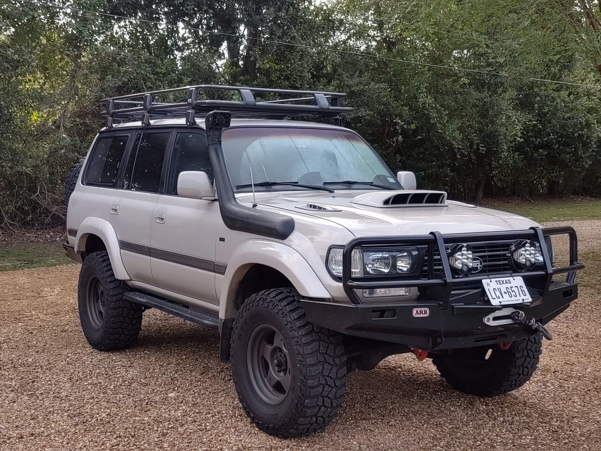

I did a scoobie scoop and added View attachment 2411551RR side Vents on the hood - they match nicely and dropped temps by 20 degrees at 100 ambient.

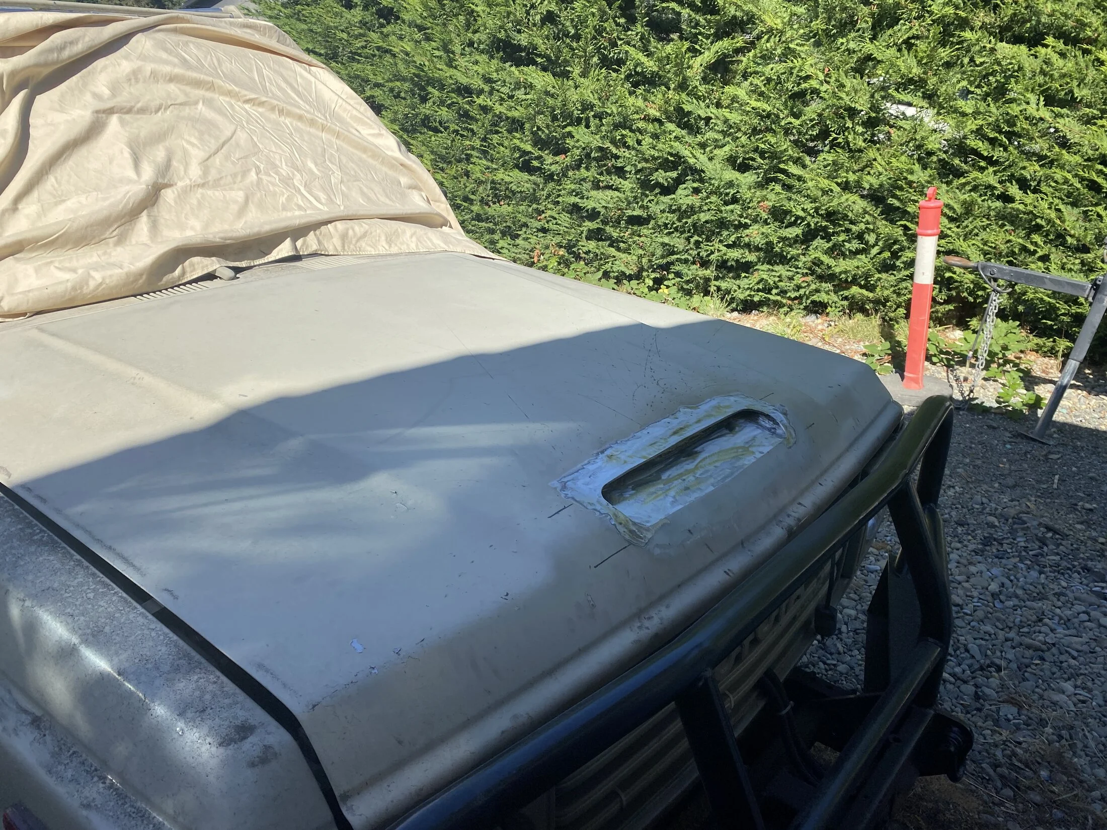

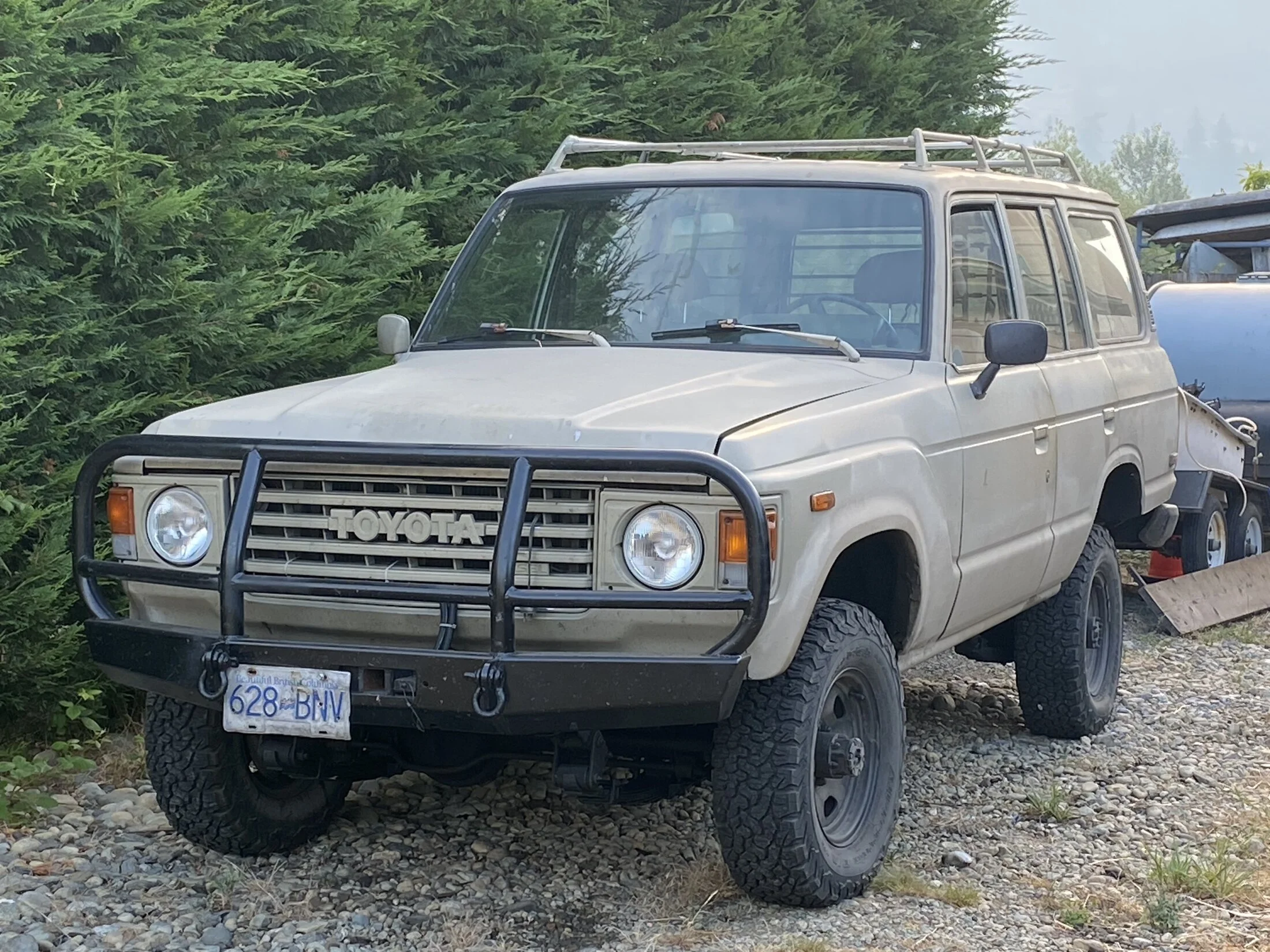

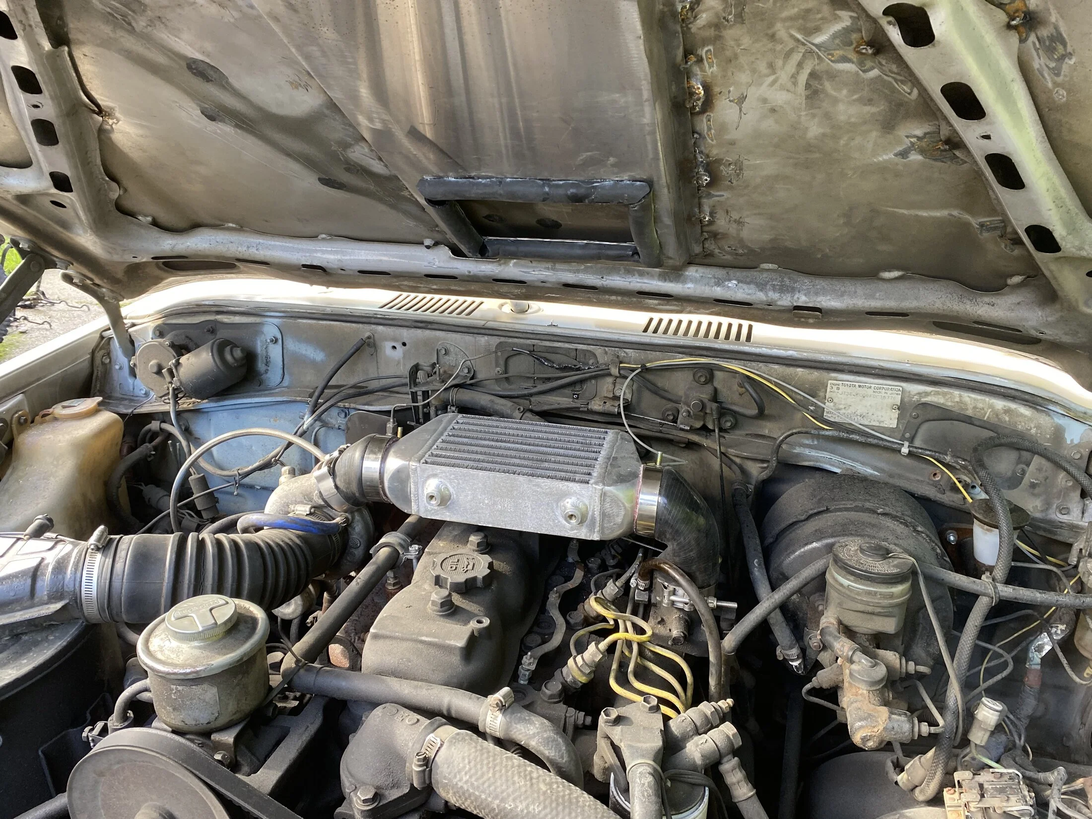

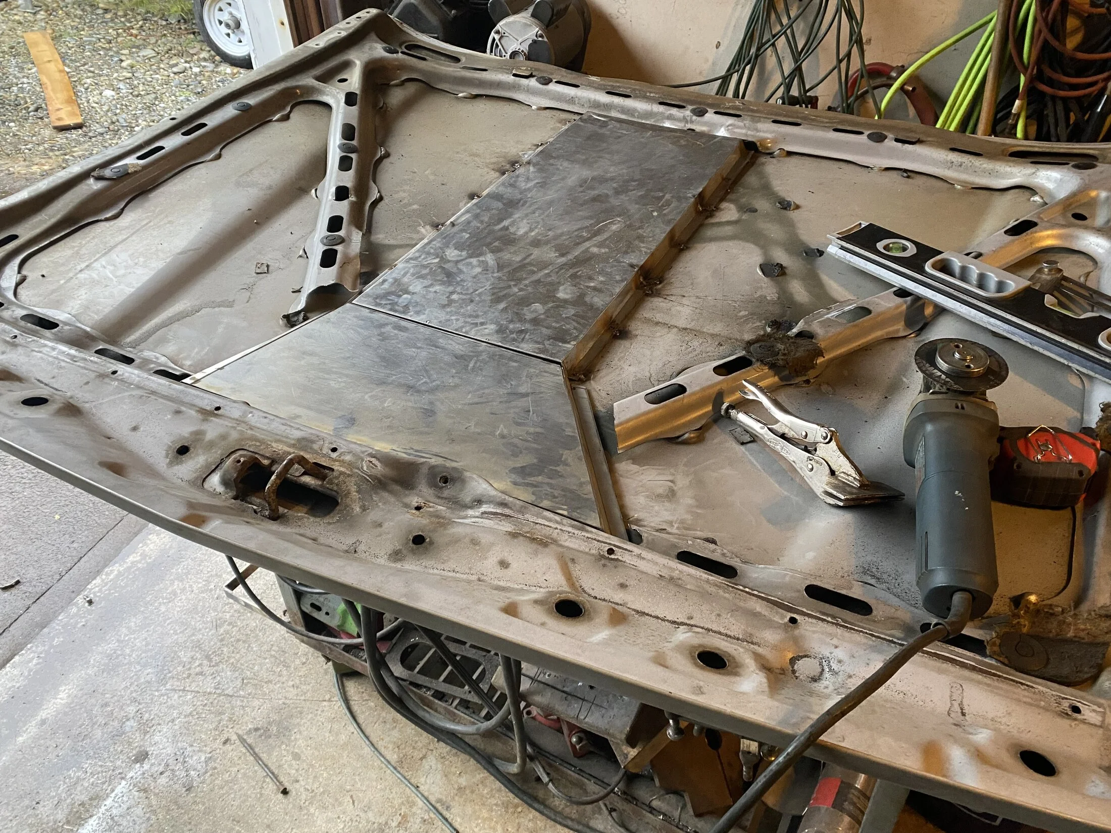

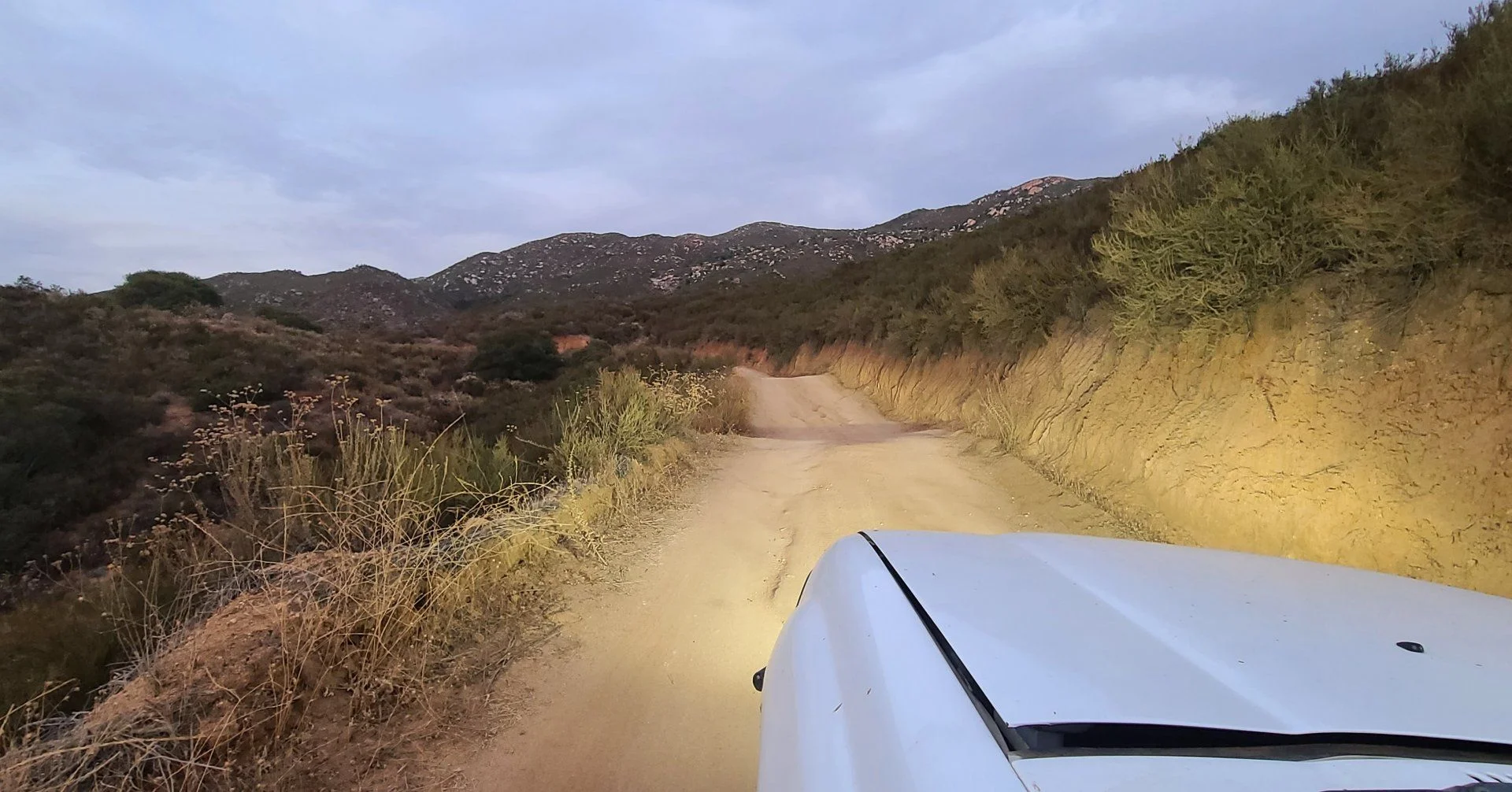

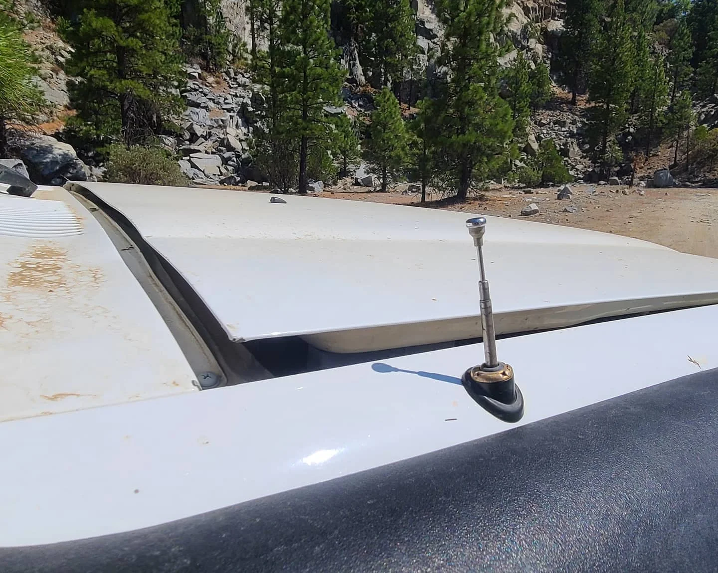

Mine’s a BJ60 but I wanted to follow up here because I originally came to this thread for inspiration.
Came to the conclusion using lengths of yarn taped to my hood at speed determined a centre mounted scoop was right in a low pressure zone and not likely to force much air threw.
So this is what I came up with.
View attachment 3760468View attachment 3760471View attachment 3760470View attachment 3760469View attachment 3760472
Definitely one of the most brilliant out of the box ideas on this forum. Perfection in form and function. Well done!
@Billyfj7312ht - figured you'd like this
Wow. What a great idea. It’s hard to make improvements without changing the factory look and this does both. My setup dropped temps but the size of my intercooler was responsible for most of it. There’s always pros and cons with each set up.
A front mount is great for 4WDing but run the risk of a stick or branch piercing it along with mud getting caught in fins. Also the amount of pipe work can create turbo lag.
A top mount like mine negates all those problems but at low speeds (4WDing) the airflow drops off. This is why my intercooler is 600x400x75mm and little pipe work needed.
My water temp and EGTs are very consistent no matter what I’m doing.
