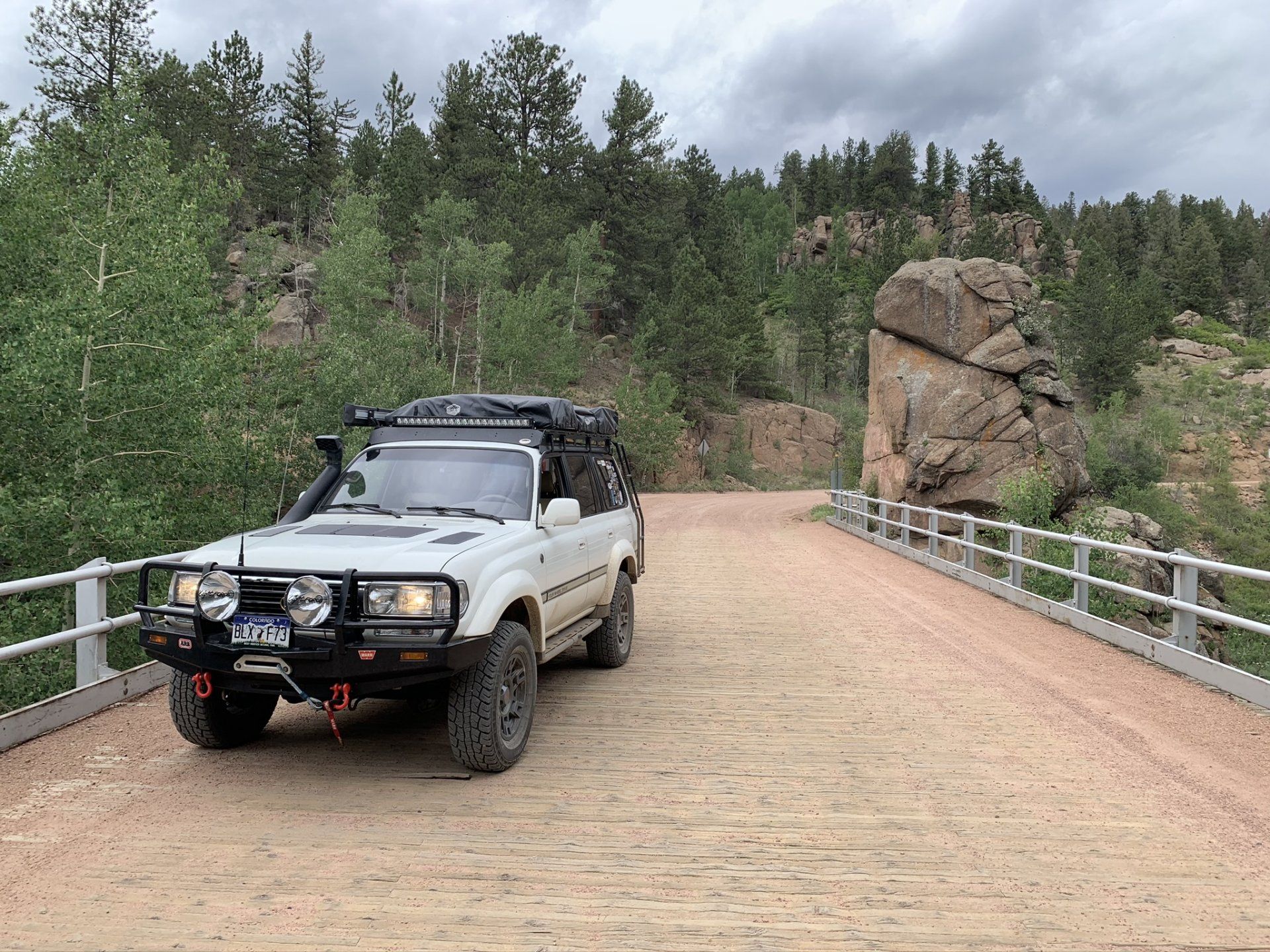

Here are a few of mine with a Subaru scoop... it provides air for my intercooler..

Any chance this would provide cooling for the engine in general? I dont have a turbo but any amount of temp savings, I am in.
I honestly don't think any hood scoops do anything to impact the actual temp of the engine. If you have a turbo under the hood then I can see vents helping, but scoops? ehhh
ya it will, I would suggest wrapping your exhaust with insulation till just behind the firewall too
Vents are more effective for shedding heat. Hood skewps are best when you want to passively draw cooler air into the intake system.
Thank you. Thats helpful. Would something like a vent work on a hood to shed heat? I have seen a guy on YouTube add vents and he has not quantified how it has effected the engine Temps but only said that he "feels" like its helped. I have the Ultragauge but I am not sure that would register a change in temp as it probably comes from the thermostat.
I've had a hood scoop for a couple years now. A scoop on it's own won't do much to help with actual engine temps. It will give a minor improvement in engine compartment temps but that really doesn't translate to a drop in coolant temps.
But, combining a scoop with vents (or using just vents) will be a better choice for trying to improve coolant temp. Reducing the engine compartment temps can help to lower coolant temps but a scoop (from my experience) won't be adequate to make it beneficial.
I don't have scientific data for what the temperature drop is in my engine compartment with the scoop AND vents but this summer driving on the highway I can see the heat distortion coming from the hood vents. And I've seen an actual drop in coolant temps. For the past few years in 90-100* heat that is common here in Utah summers my coolant temps have been pretty consistently 199-210*. I don't like running the truck any hotter than 210* so when it would get that warm I would turn off the AC, open windows and turn on the heater to get the temps back down. That was usually only climbing some of the canyon highways, but occasionally even around town.
Since adding the vents my temps this summer have been consistently 185-199* and the hottest it has ever been this summer so far was 205* while climbing Parley's canyon at 75mph while pulling my trailer in 101* ambient temp outside. That is a noticeable difference.
My theory is that the scoop is bringing air into the engine compartment and increasing the air pressure and help push the hot air out through the vents. The typical location of hood vents on 80s is a low pressure area for airflow so that also helps to draw air out.
If you don't want to do both a scoop and vents, I would suggest doing vents over doing a scoop. The vents have shown to be more beneficial.

Dude, thank you so much for that detailed response. I really appreciate your time. Would you mind telling me the specific vents you have in this photo? It looks great and I can't imagine they would not have an effect on the temperature of the engine compartment. And now I am definitely painting my grill and Headlight liners black. 🤙

@Box Rocket I too am interested in those vents and the scoop. Is it a full hood replacement or add-on?
Info in a build thread?
The scoop I'm using is the same one that @goranvolvo used (early 2000's Mustang) but mine's not backwards. ;) It did take a little shaping of the bottom edge to get it sit flush on the 80 hood.
The vents I'm using are reproduction versions of Range Rover Sport fender vents.
