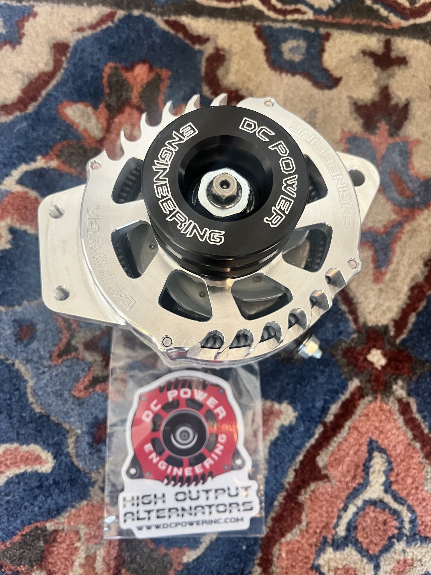

Alternator tech has vastly improved since these rigs were made. Time was, you had to drag race to get good numbers from an aftermarket alt, and most of them were overwound and subject to overheating and burnout. But you CAN now get more power in a standard-size case, AT low rpms. And a LOT more power in a bigger case. After exploring the Photoman bracket kit option (currently unavailable but on @NLXTACY's to-do list), I resolved to simplify and seek a reliable bolt-up with a good rep and no bracket needed. Turns out the best place to research this is not in 4WD forums, but car audio forums frequented by the kind of folk who drive speakers on wheels, and trigger seismographs at nearby research stations. They're also used in racing; the company does something like 90% of SCORE trucks and buggies. And a whole bunch of 1VD-FTV Cruisers in the Middle East (120-degree ambient).
Anyway, these are not your grandfather's alternators. Looks like I've landed on one of these, below. The pages just went live today; I've pasted spec sheets as well. When looking at the power curves, remember these numbers reflect ALTERNATOR rpms, not engine rpms. Ballpark, figure that's 3:1--so 2,000 alt rpms = 666 engine rpms.
Anyone actually purchase and install these units and can comment on their reliability?
I purchased and installed a DC Power Engineering 180A alternator in 2012 for my 3.4L Toyota Tacoma and it is still going strong. I've installed a 270A on my FZJ80 with dual batteries 2 years ago and my electronics absolutely love the higher charge voltage set point and current on tap.
