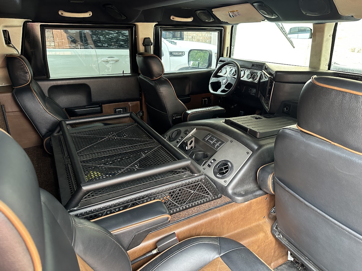

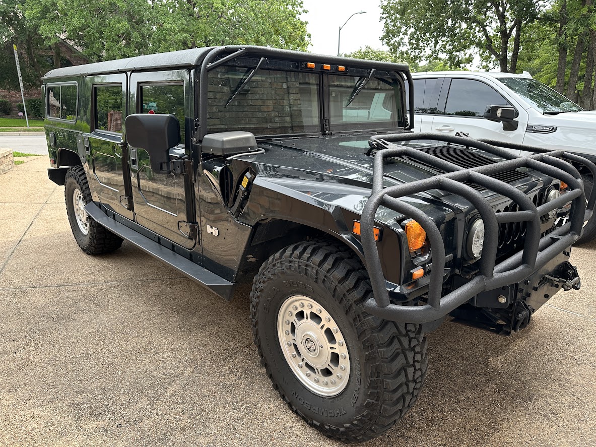

The H1 is fun to drive. And gets surprisingly good MPG on the 6.5TD. But lack of comfort and lack of good AC that performs like a modern vehicle should makes it tough to daily drive, particularly in Texas summer heat. But it is fun every now and then. I put it up for sale recently to make room for another Toyota project once the H1 is gone ;)
Thank you! :) And agreed.
Nice! Looks like you might have visited Mod Mafia for a few upgrades haha. I've always wanted one but my time in with Uncle Sugar showed me everything I need to know about them lol so it's very unlikely that I ever bother. I've had a Pinzgauer and a LMTV as well and both were very short lived for similar reasons but they all look cool as hell haha.
Agreed. It was on my bucket list of cars to own eventually and has been fun. But I'm ready for something else now that I got the H1 bug out of my system
