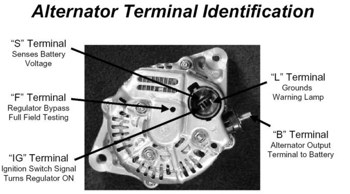

The "B" terminal in the image above is where you would increase the size of your cabling. You don't have to, but it is a good idea, especially if you are going to be making use of all the extra amps. For example, winching or recharging your batter from dead after getting jump started.
You can find some charts that explain the gauge/current/volts/length relationship.
There is also the portion of your fusible link which will likely need to have an increased capacity.

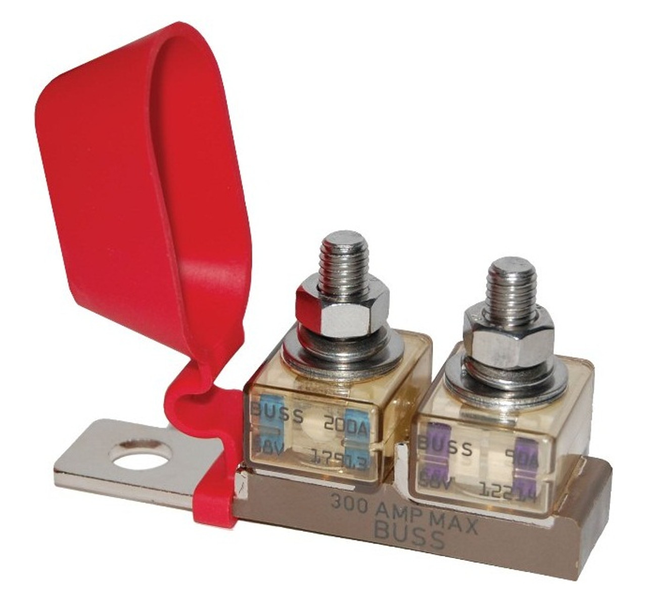

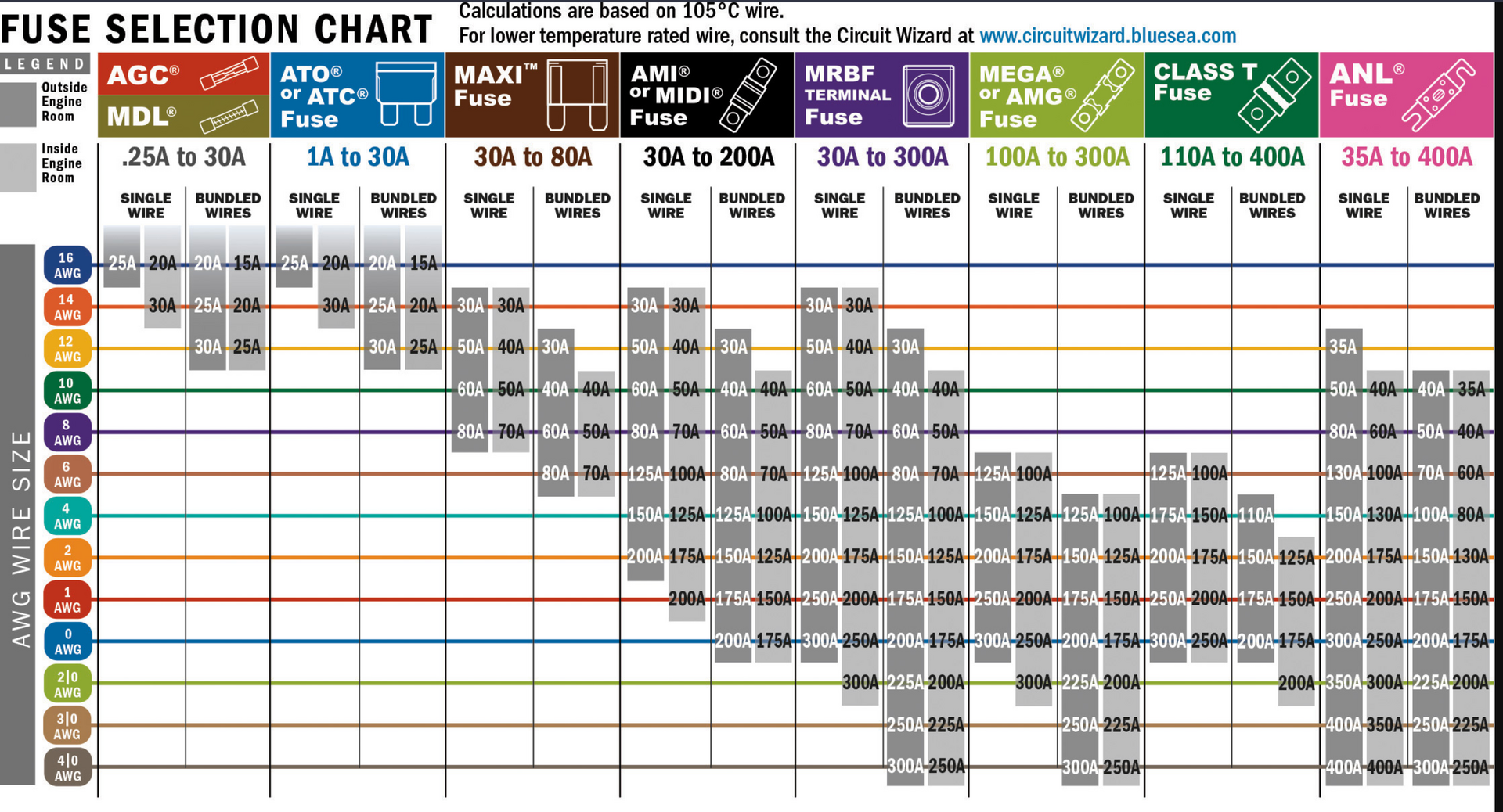

for my application, I wanted a simple way to add a fuse in a low-profile design so I went with Blue Sea MFBF terminals and a 300A fuse
More info here http://assets.bluesea.com/files/resources/reference/20010.pdf
choose fuse by wire length and Gauge and expected amperage needed
***Hint blue sea pretty expensive you can order from mouser.com under the Eaton brand and save some $$$$

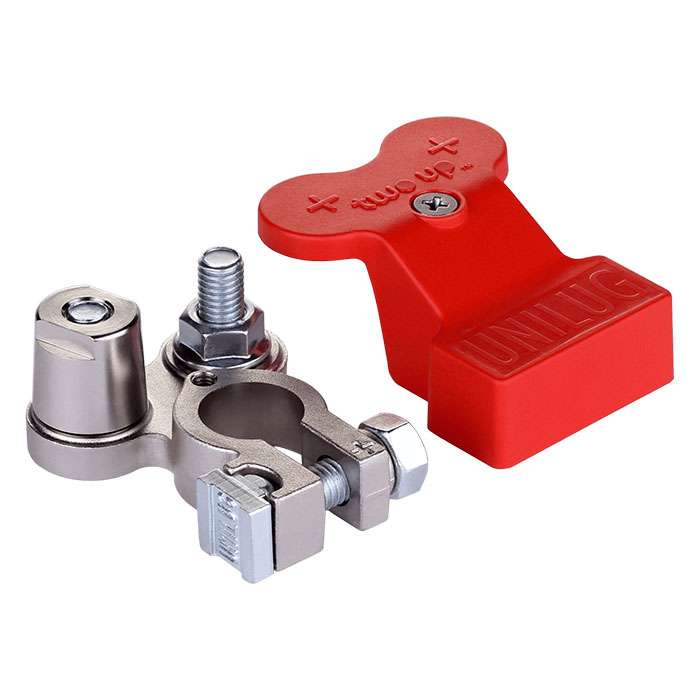

I use the same fuses. Paired with these battery terminals, they are awesome. I use the stud to attach the MRBF fuse blocks.
I use the same fuses. Paired with these battery terminals, the are awesome. I use the stud to attach the MRBF fuse blocks.
thats a cool terminal never seen one like that how is the stud isolated from the terminal without the mfbf fuse? you have more pictures?
i dont see any stud isolation so if were to put a fuse on that empty stud the fuse would have no protection but if using in conjunction with the mrbf fuse holder it would work great
The stud is not isolated. I meant attaching the item below to the stud to expand the number of fused outputs. The battery post is also removable, so you can have 2 studs on the terminal.
ok thanks for clarification that is a great terminal.
i was actually thinking of changing my terminal to a car audio terminal but the one you posted is great
